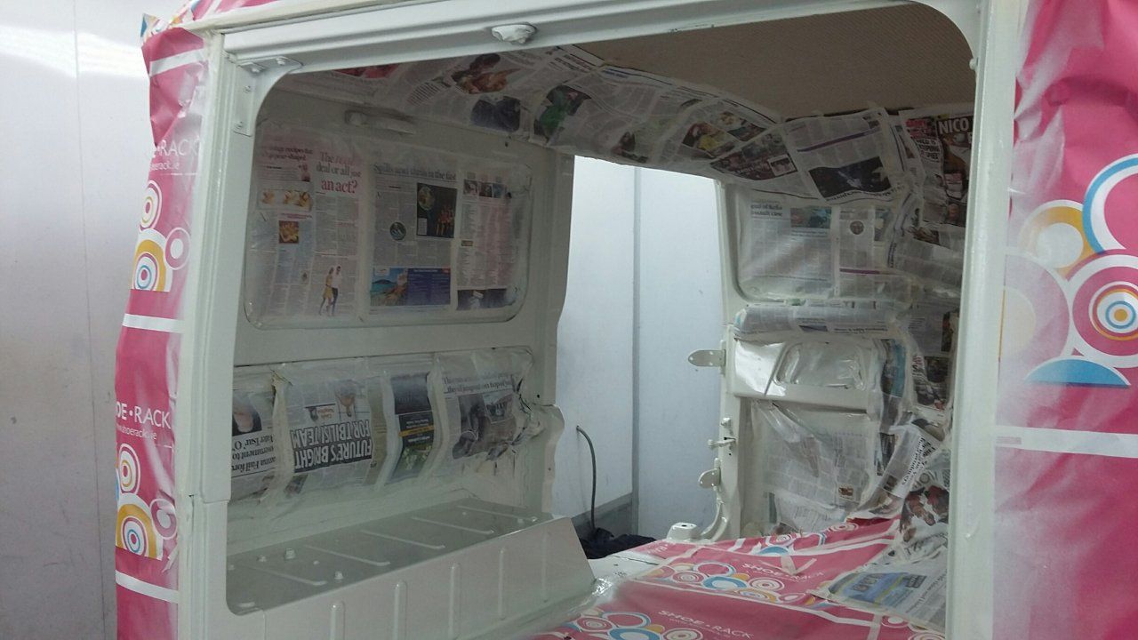

End of another week, some good progress I believe.
Seats have been repaired and cleaned, I know the new leather looks a different colour, but its exactly the same pigment as already on it, just 30 years younger??
Painted the bezel, front bumper and steps the same colour as OEM back bumpers .
Havent touched the bib yet.

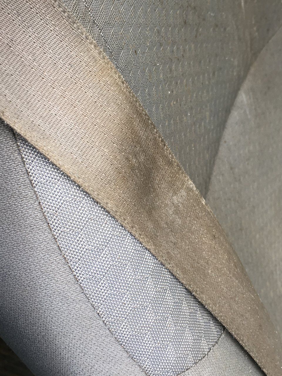

I am working in West Africa this week where we run a fleet of Toyota 2014 Hilux, pickup/UTE and much to my amazement I have just noticed that they have brown straps similar to the LX but cannot be sure they are the same colour, they look a little darker brown, cannot be sure until I take a sample back at the end of he week. Cannot believe I haven't noticed this before as I have been travelling in these vehicles for over two years and have never noticed that the belts/straps were brown. The seats and trim are grey leather but belts are brown? Guess you only notice when you are looking ???
I am going to bring a sample back with me in any case to compare? Will post a few pictures in the morning of the belts we have here.

Reckon I must have had a few too many when I posted about webbing colour, in the cold light of day and sobriety , the belts on the Hilux look more grey/brown than brown, in fact, the guys over here swear that they were grey when new and have faded to this colour. In fact the back belts look grey like seats :oops:
I will check mine when I get back at the weekend, I need to get new ones in any case for the bench seats, might as well keep them all the same, might just buy webbing to match OEM as close as possible as my upholstery guy is certified for EU regulations tests etc.
Will certainly look at the 75 belt options before I do anything.
