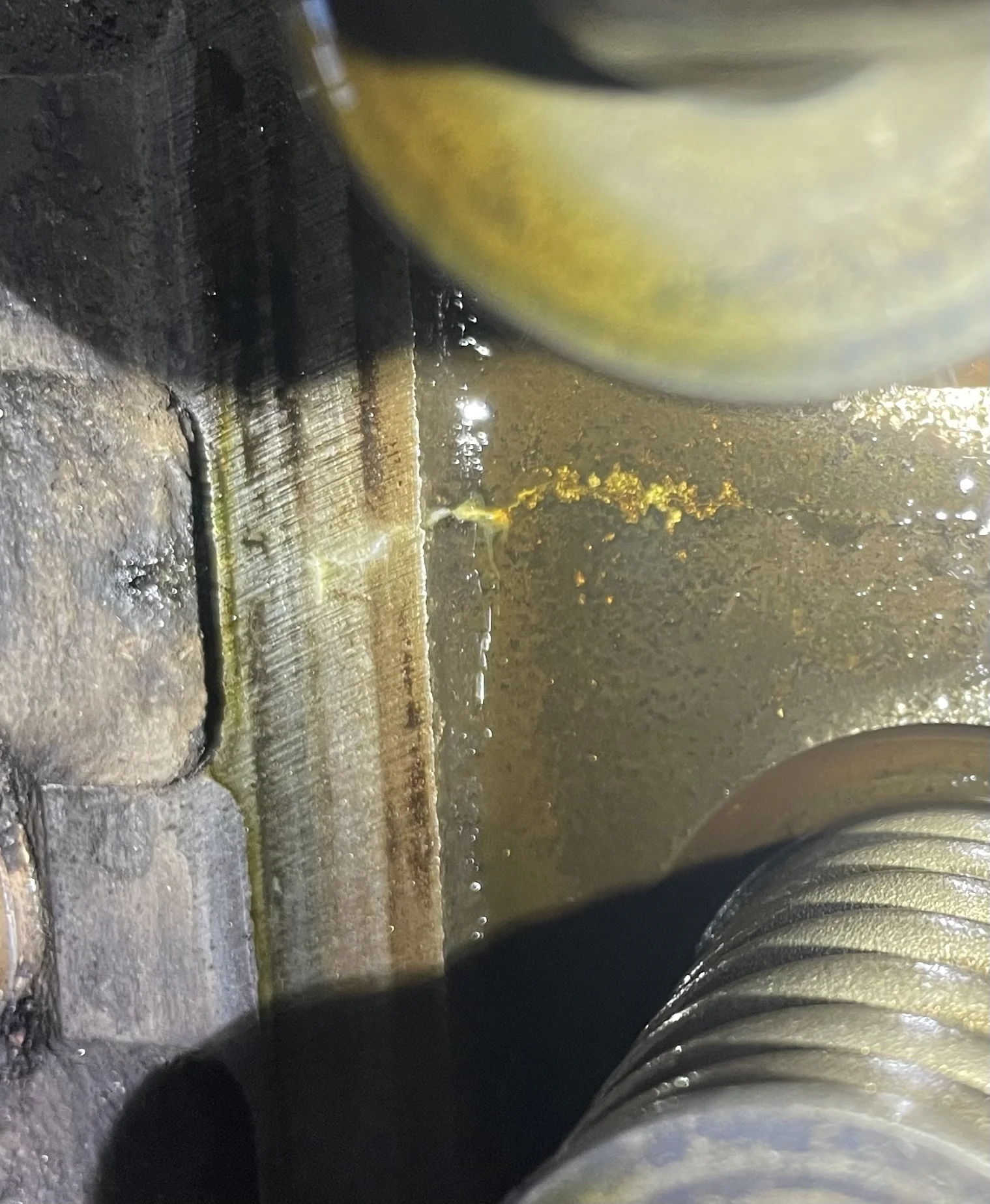

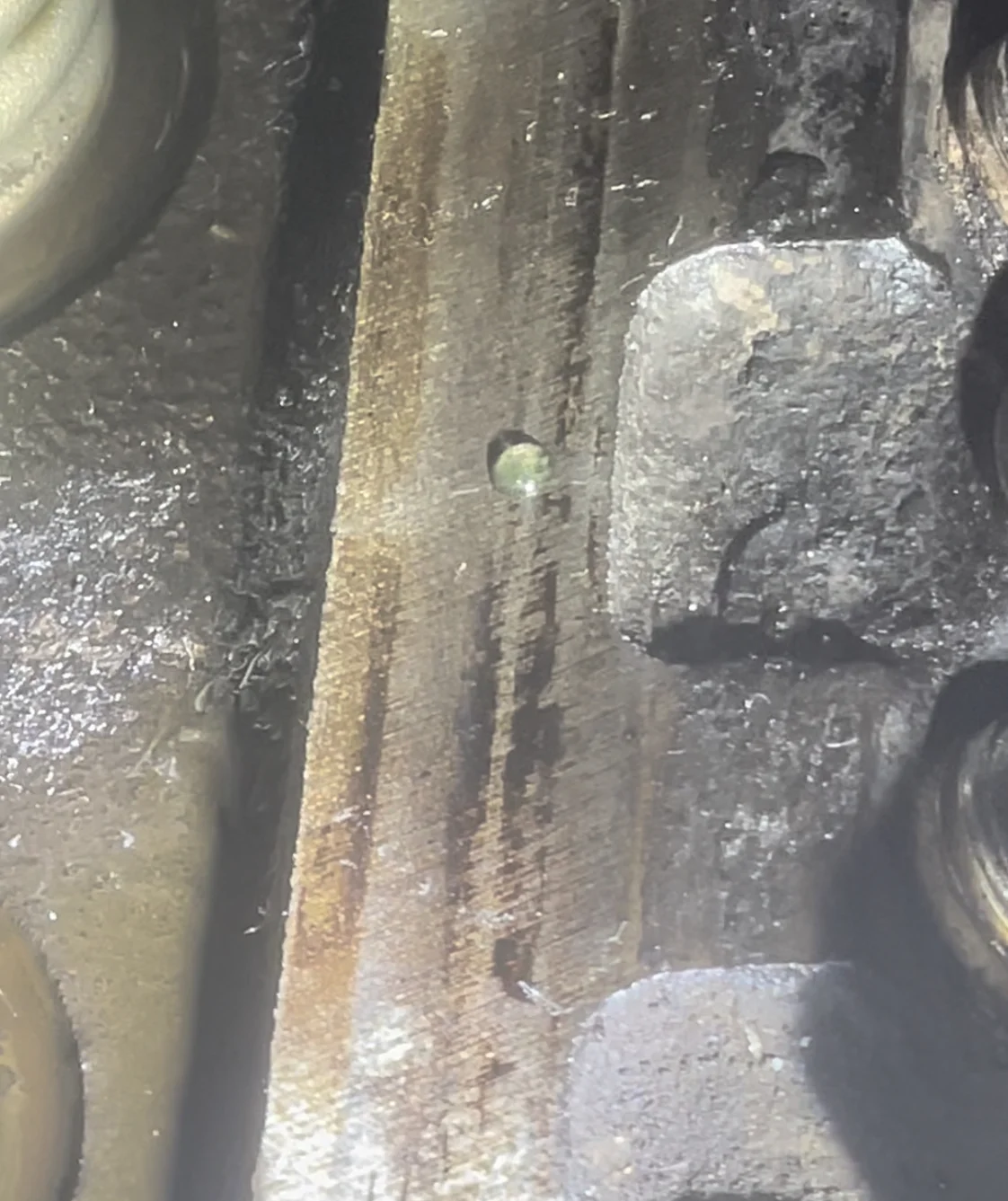

A cracked cylinder head. Maybe the 60 liked all the vacuum and exhaust leaks better😬
That bubble of coolant starts at nothing than grows as truck warms up then actually seals itself once at full operating temp.

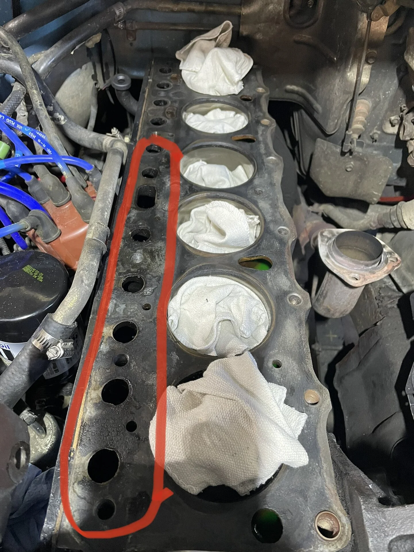

So this weekend everything is off, I have new refurbished head and all gaskets ready to go. I’am at the point of cleaning block surface a lot but some areas are crazy tough to remove left over head gasket material. I am using various scrappers and razor blades. But progress is slow. Looking for suggestions on ways to finishing cleaning the rest. Specifically the areas in red. How to get cleaned and not send crap down push rod holes.
It was slow and tedious for me scraping that gasket off mine and I have the engine out of the truck currently. Take your time and be patient with yourself. You’ll get it done. Just don’t let it frustrate you. You’ve come this far. What’s a few more hours to make it right?
I keep telling myself not to rush because I only want to do it one time, and it’s not my daily so not taking my time would be dumb.
Exactly. Heck, I’ve been rebuilding my engine since November and it’s my daily driver. I’m still not rushing it. It’s not worth doing it twice.
I used some carbide blade scrapers that worked really well. Definitely was a slow process.
Thanks for the suggestion, got one and it was exactly what I needed to finish cleaning the block surface.

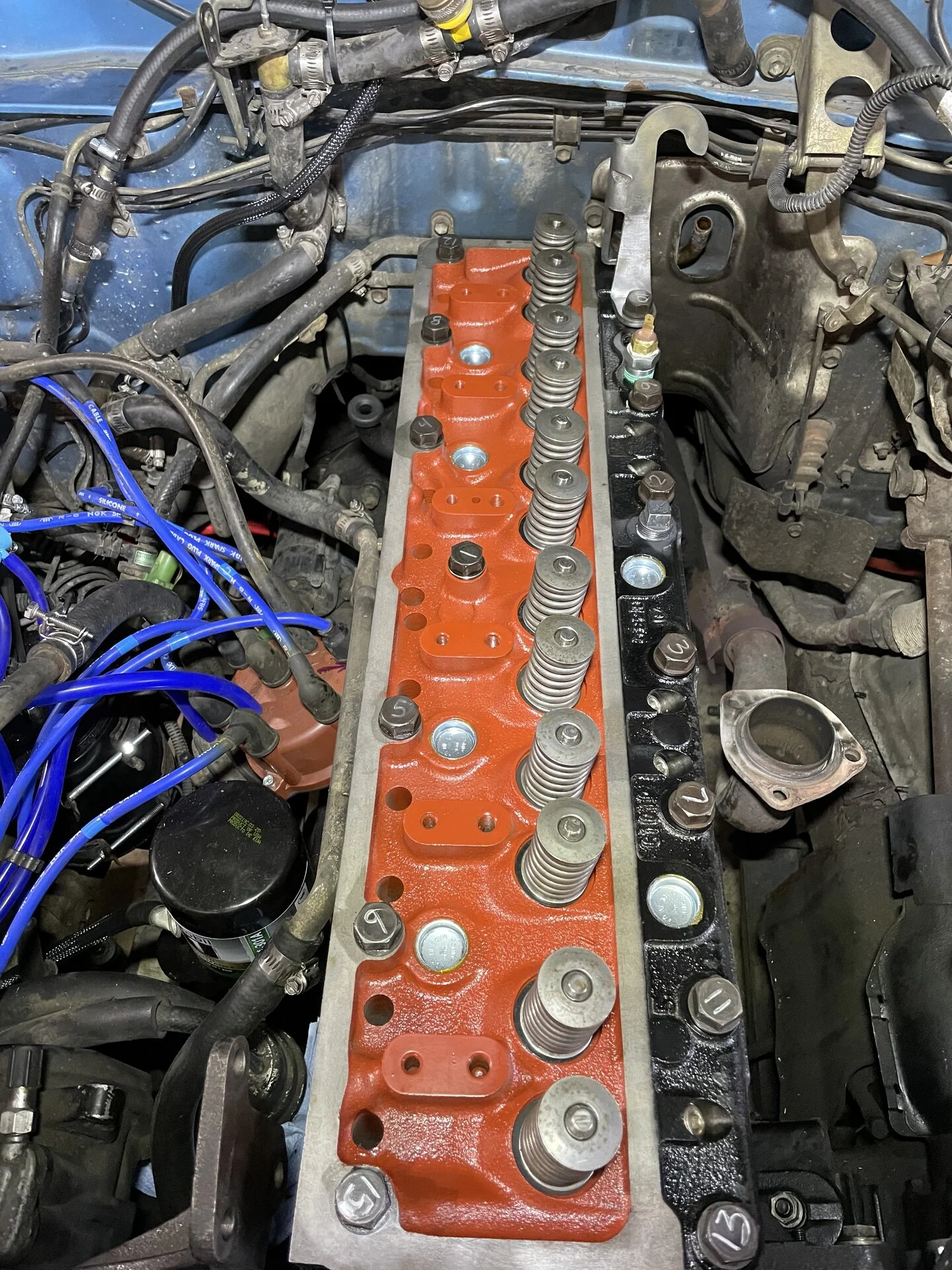

Progress has been made after three days of scraping and cleaning and then some more scraping and cleaning. New cylinder head is installed and bolts are torqued down.
That’s gorgeous.
Hope it’s not too late. Can you check the block to see it’s flat and in spec?
These work great for gasket removal without eating metal.
Yes , check the block surface with a straight edge. I looked at drill attachments but wanted more control over were stuff would fly, so had scraper in one hand and other hand shop vac. Then when I thought it was clean went back over with carbide scraper multiple times to get last small bits. Then went through a lot of brake cleaner on towels and kept wiping till almost nothing would show on shop towel. I tried to be as tedious with cleaning as possible. But my first time doing this, so🤞

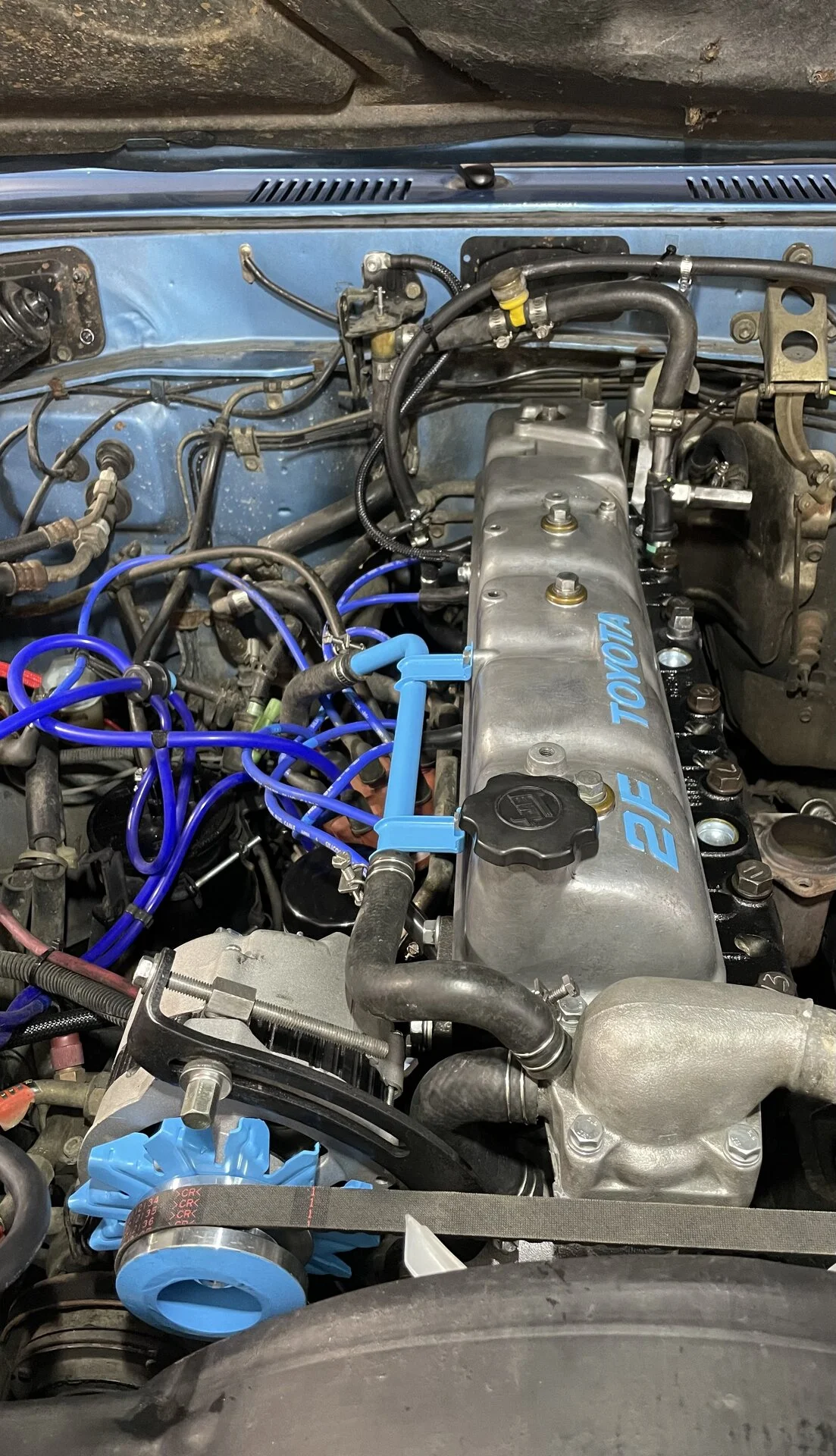

Finally some progress. When I pulled the old head and I didn’t immediately check the push rods. So when I did finally inspect them. Found a few, 4 to be exact not straight, slight curve. So had to order some OEM replacements. Finally arrived and got rocker assembly installed , torqued down and valves adjusted.
I dig the blue accents. Nice touch!

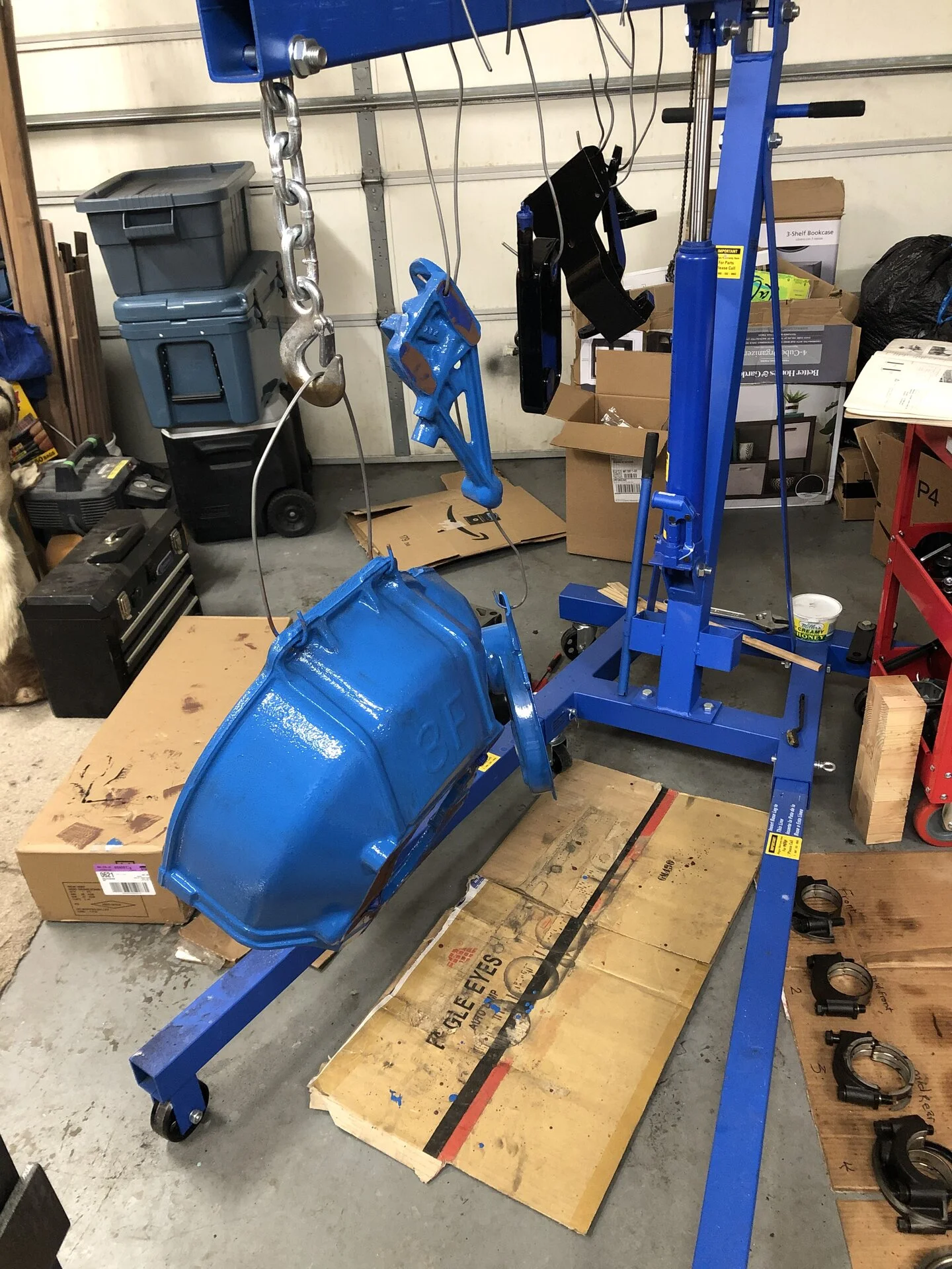

I’m in the middle of a full engine rebuild. It’s gonna be blue. Idle hands. Yes.
I like the blue. I can’t imagine doing a full rebuild.
It is a lot of work. It really needed it though. Will be worth it. At times I wish I had bought a prebuilt head like you did.
I hope you get a lot of miles out of your rig. You’ve done a ton of work and deserve it!
