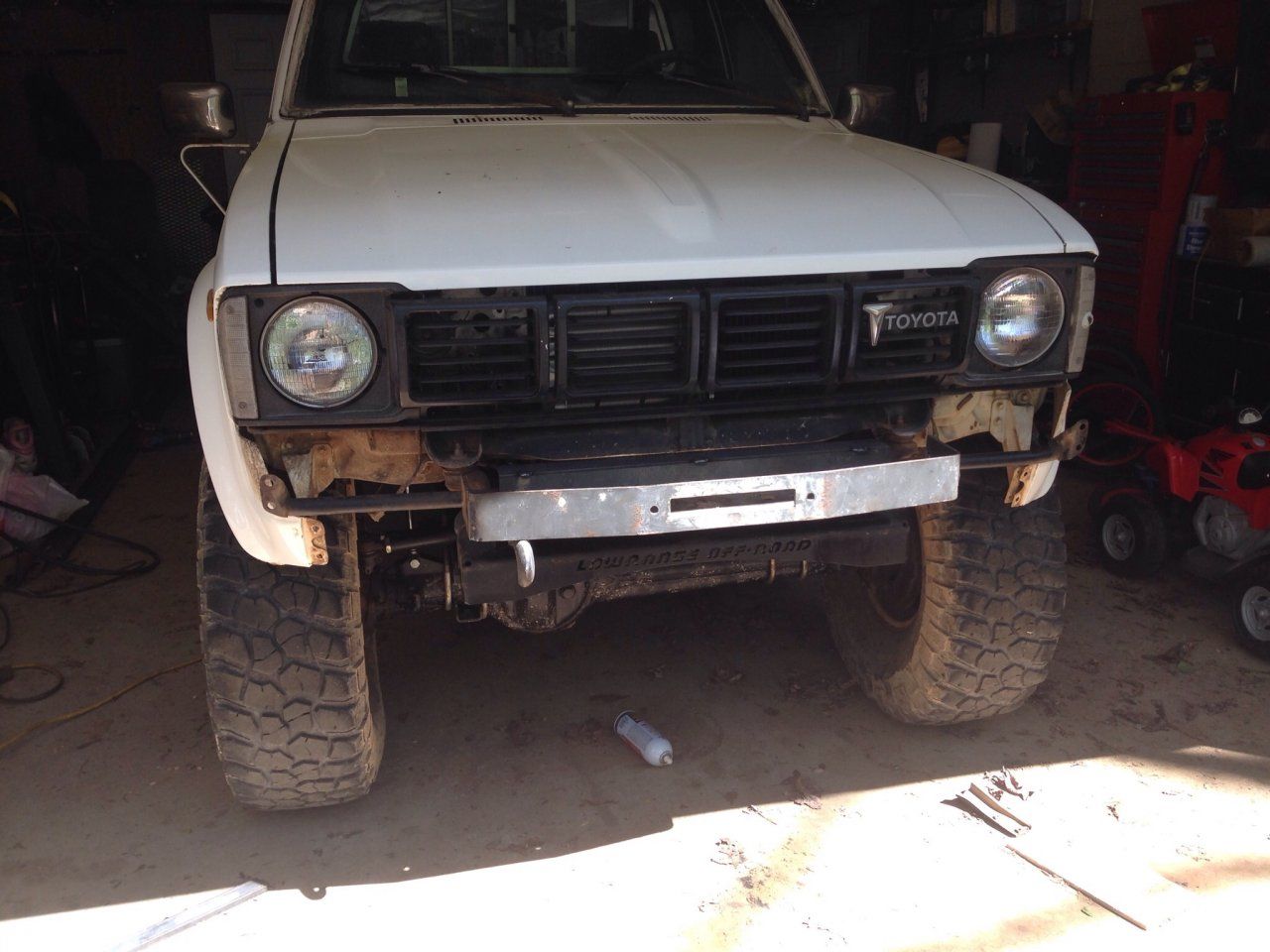

Beefed up the stock bumper brackets and got the winch plate tacked up and the assembly bolted on. I'll be adding more frame gussets after I get everything tacked together.
Looks good Tony. So how is it mounting to the frame?
The stock bracket has 4 bolts into the frame but I'm planning on adding at least 2 more attachment points (probably off the front crossmember) given the stresses it will see. Still trying to make it removable but I'm not sure that's going to pan out.
good thinking on the extra bolts!! Have plans for stinger of any type? Would suggest some sort of corner marker protection as well, it's a very vulnerable spot.
Got it mostly cut out and tacked into place. Next step will be to pull it off and gusset the back and weld it out. Surprisingly, I've got less than a 2'x2' piece of 3/16 plate in it. It took me a while to get the nerve to cut the fenders, but I think I like it.
What winch are you planning on getting?
