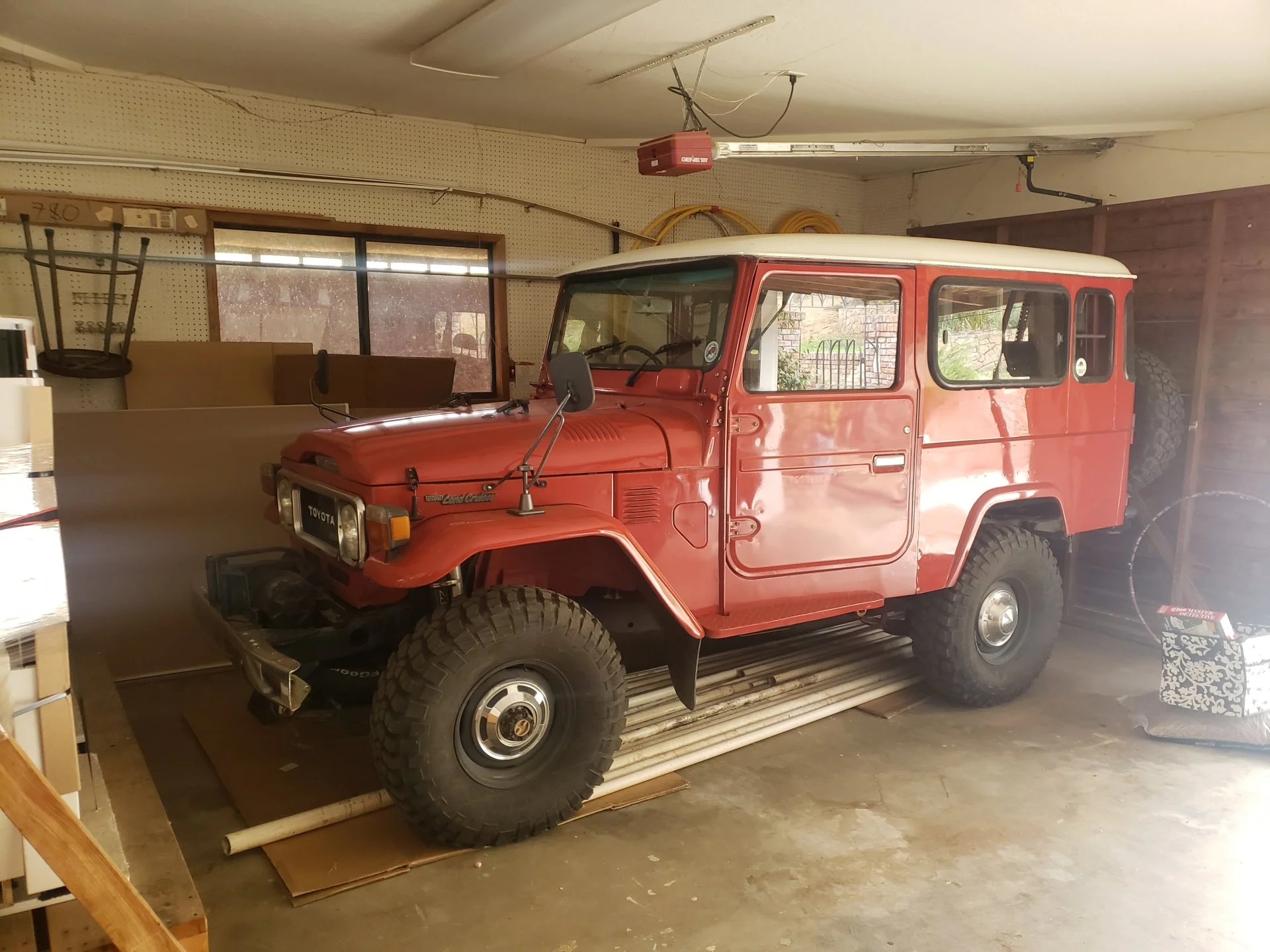

Not a real good picture but that is with 33 x 10.5 on stock rims

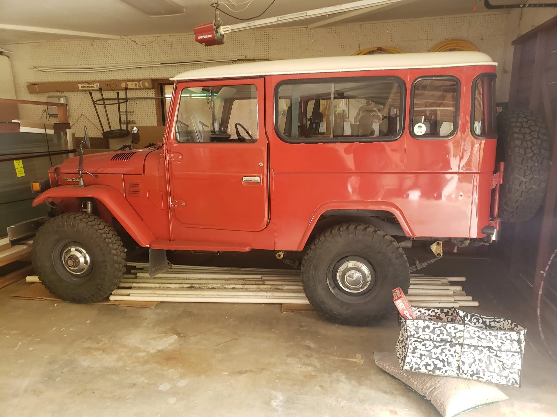

Awesome JDM truck @BarnFab!
...and put in good use too!
On that last picture the rear axle seems to be a bit front. I want to avoid that and have my rear axle to be at the right position
Funnily enough that is 100% the factory location so it is in the Right Position as you call it . You can move it rear ward to make it look more correct but then it would be wrong not right :)
:) and considering that OME is one of the truly best in the field so i believe you. :) thank you
