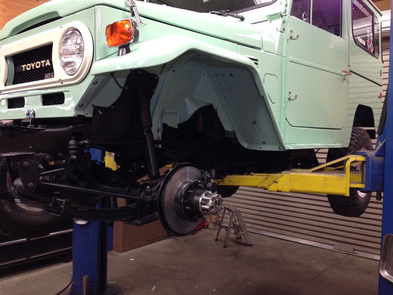

Disassembly and Prep:
- Completely taken apart everything off the frame. rolling chassis;
- All metal parts blasted and then coated in Epoxy primer (Amerlok; same stuff they paint cruise ships and submarines). Green, Black, Grey tinted depending on part color matched
- Finish paint is Cloverdale Armour Shield (single stage epoxy, it's a very hard paint). Most of this work done by Rust Blasters in Chilliwack. Final re-spray on Vancouver Island after assembly (paint shop local to Rob did the final finishing work, rhino-lined and sprayed underside of roof (no headliner), respray of roof, bib, body after assembly and fitting.
- Green is a 69/70 Hilux Light Green. I like the combination with the off-white of the roof & bezel and it goes well with the interior grey and black pieces. The bezel and roof are 'RV-White' which is a light cream color which I think coordinates with the green nicely.

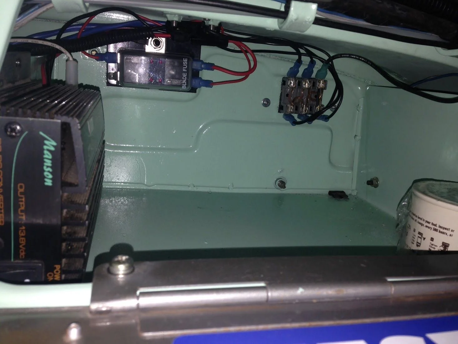

- Manson SDC210 24-12 volt converter in glove box (12V outlet in center console, and EGT require 12V)
