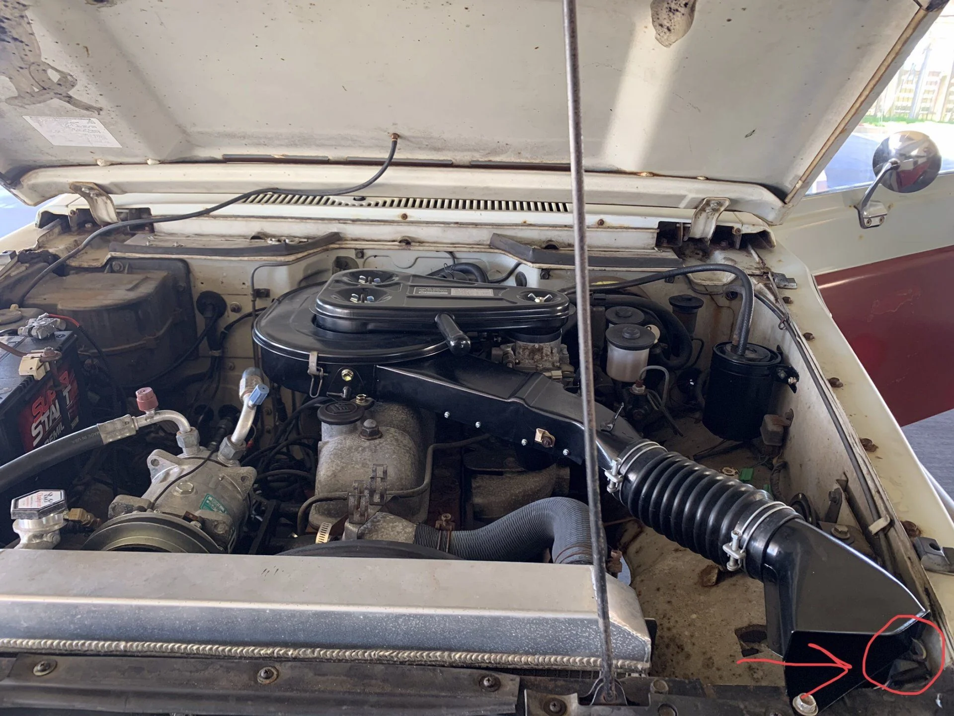

Best photo I have to hand. Hopefully I’m not steering you wrong but I think it’s right under the red circle.
Great and thanks for the pic. I like your engine compartment sorting. Interestingly my AC compressor is on the driver's side..
I looked there yesterday but in hindsight was dismissive of the thought of it being there, plus nothing really fit my mind's photo of what it should look like.
Knowing where it should be helps..eases the mental frustration and I havent even found it yet.. grins.

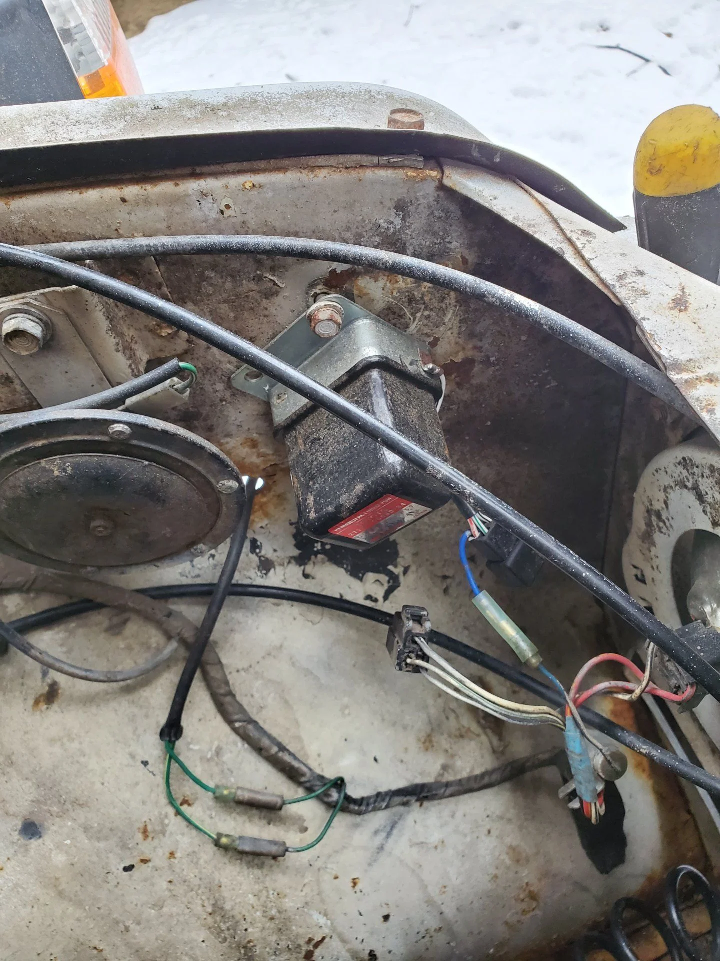

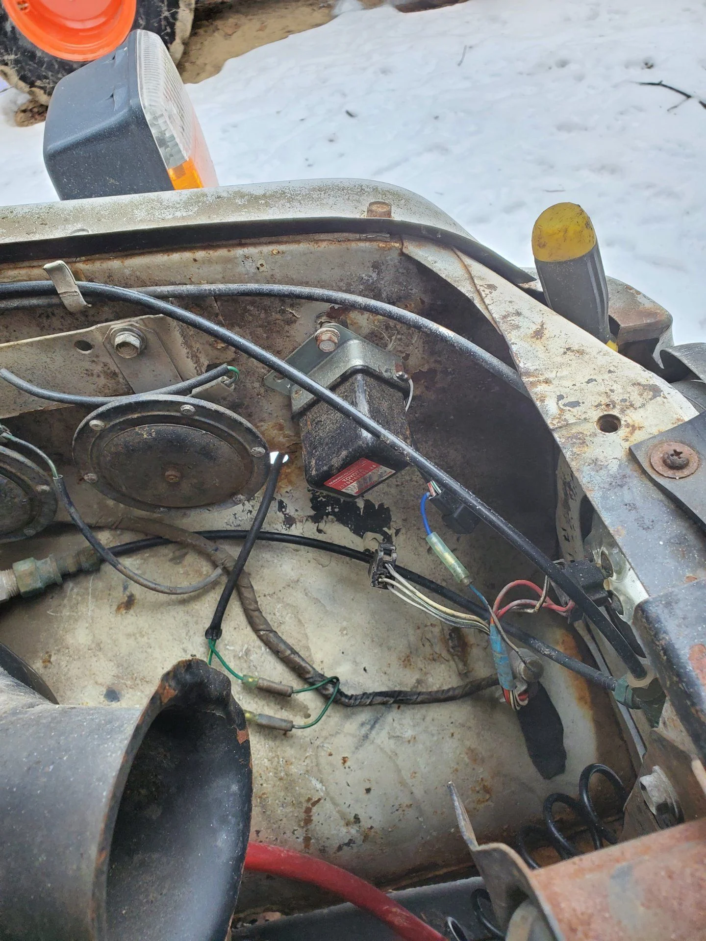

mornin' Bob,
Just got your pics as well... I'm convinced I must be looking right past it, not recognizing it for what it is..
I'll advise this afternoon and thank you !
I was looking right past it. Basically lack of information on my part coupled with the presumption it was located elsewhere.
Exactly where it should be.
I would have been bit had it been a snake,
Thanks for the assist.
