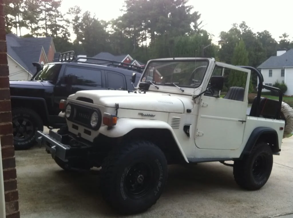

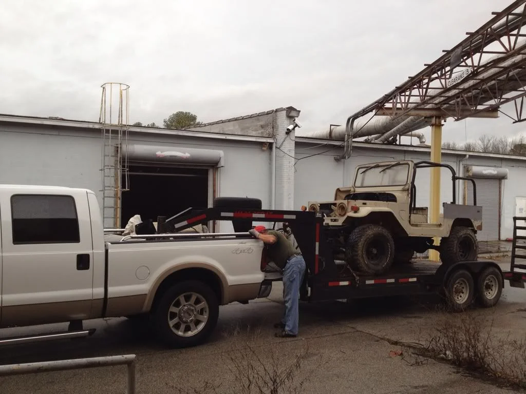

I was a senior in high school and decided I wanted an old Land Cruiser. I did not want a project, rather one to slowly learn the ropes and go So after looking at a few trucks on craigslist I pulled the trigger on a '77.
It soon became apparent that the truck was in terrible shape and needed lots of work. What do I do?.... Sell it and get a better one?.... NO!.... Start tearing it apart in the garage! I will just hit the main problem areas and not dive too deep.

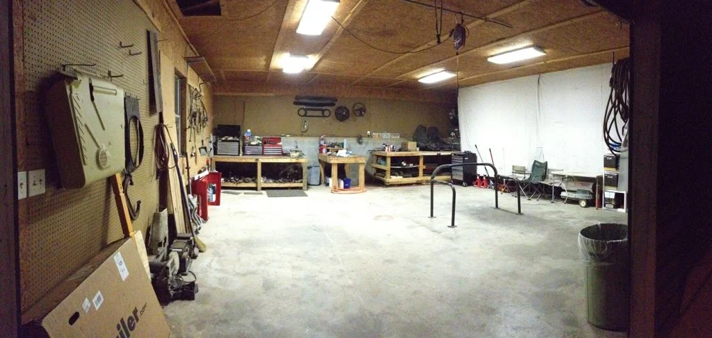

At this point I was politely told to get this s*** out of the garage, so lucked up and was able to rent a couple bays from a neighbors shop.
I think this is where I probably said my first, "well while I am here". So now what had started off as a simple fixer upper, has now escalated into a full blow restoration. On a high school budget. Here goes nothing!

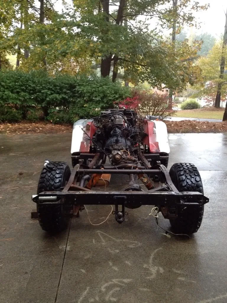

At this point I came to the realization that the body needed a TON of work. Multiple coats of bondo, holes, and even a borrowed street sign incorporated into the floor pan. Ill focus on the frame for now. Wire wheel and elbow grease.
Many many many hours of wire wheeling, POR15 metal prep & paint later I ended up with something like this:

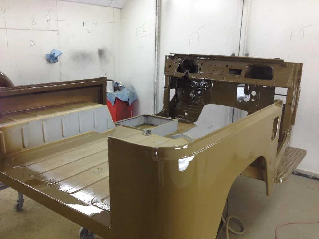

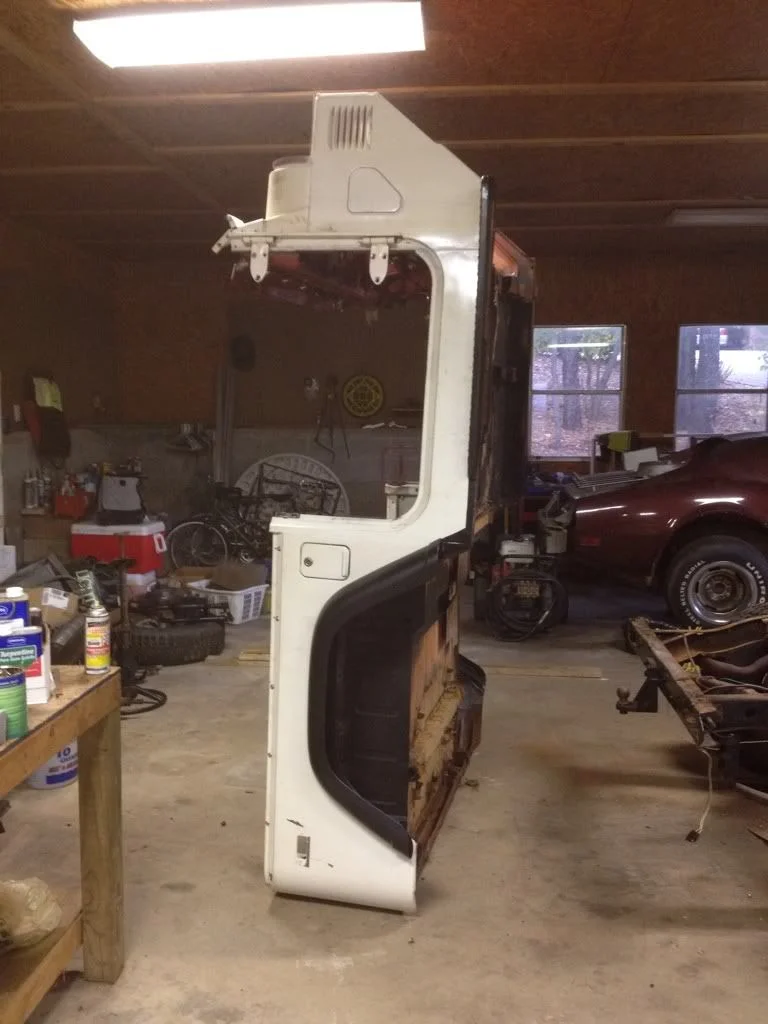

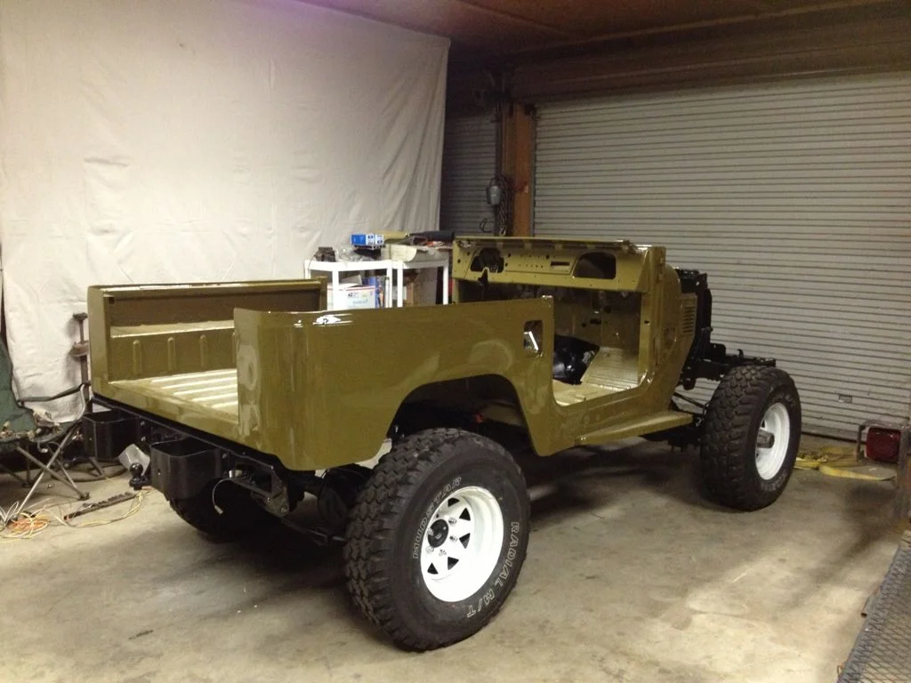

Turns out the body was in terrific shape, only needed some slight quarter panel patching. Saves me some work on my rusty tub! Lets get it shot with some primer. Now some may notice the tool box on the floor. It is a 1971 tub, in hindsight I probably should not have done this, but at the time it really did save my ass on the metal repair. I think it makes my build unique to me, but it defiantly led to some head aches down the road!
Its 2012 and I headed off to college, so not much happened for the first couple years :beer:
Well I did manage to get it painted:

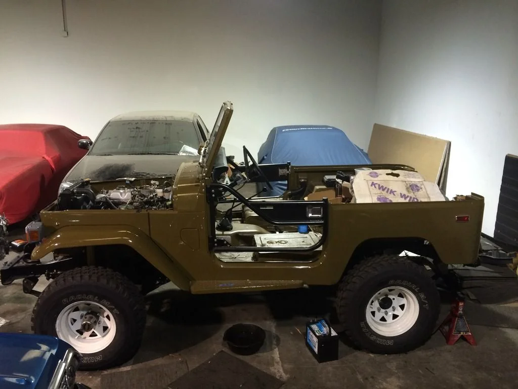

Around 2014 I needed to get this thing going. I moved it to a friends auto shop and with the help of their mechanic we got it some what put back together. Even drivable around the parking lot!

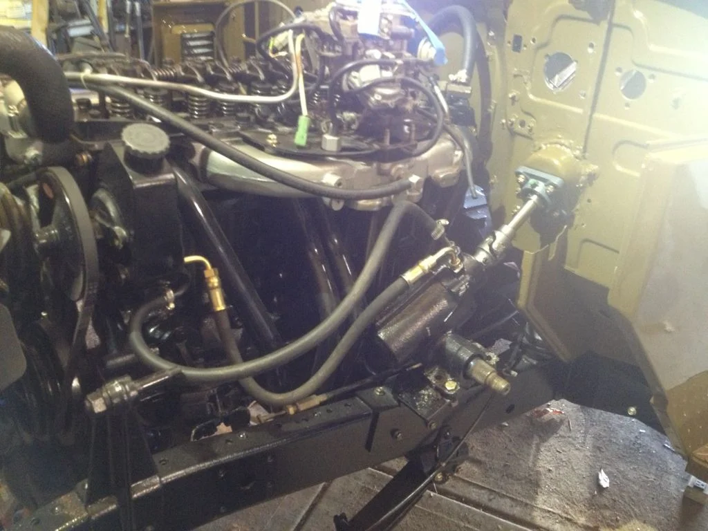

At some point it got power steering!

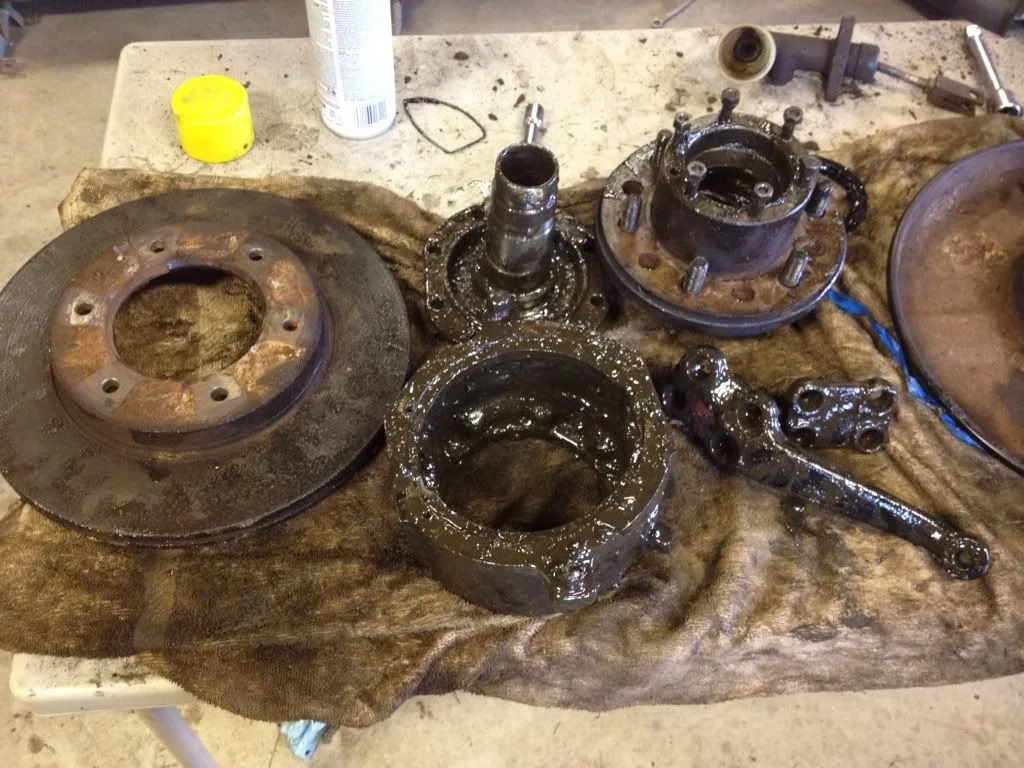

Also at some point in all of this I rebuilt the front knuckles.... I hear you can't be a cruiser guy until you do this...

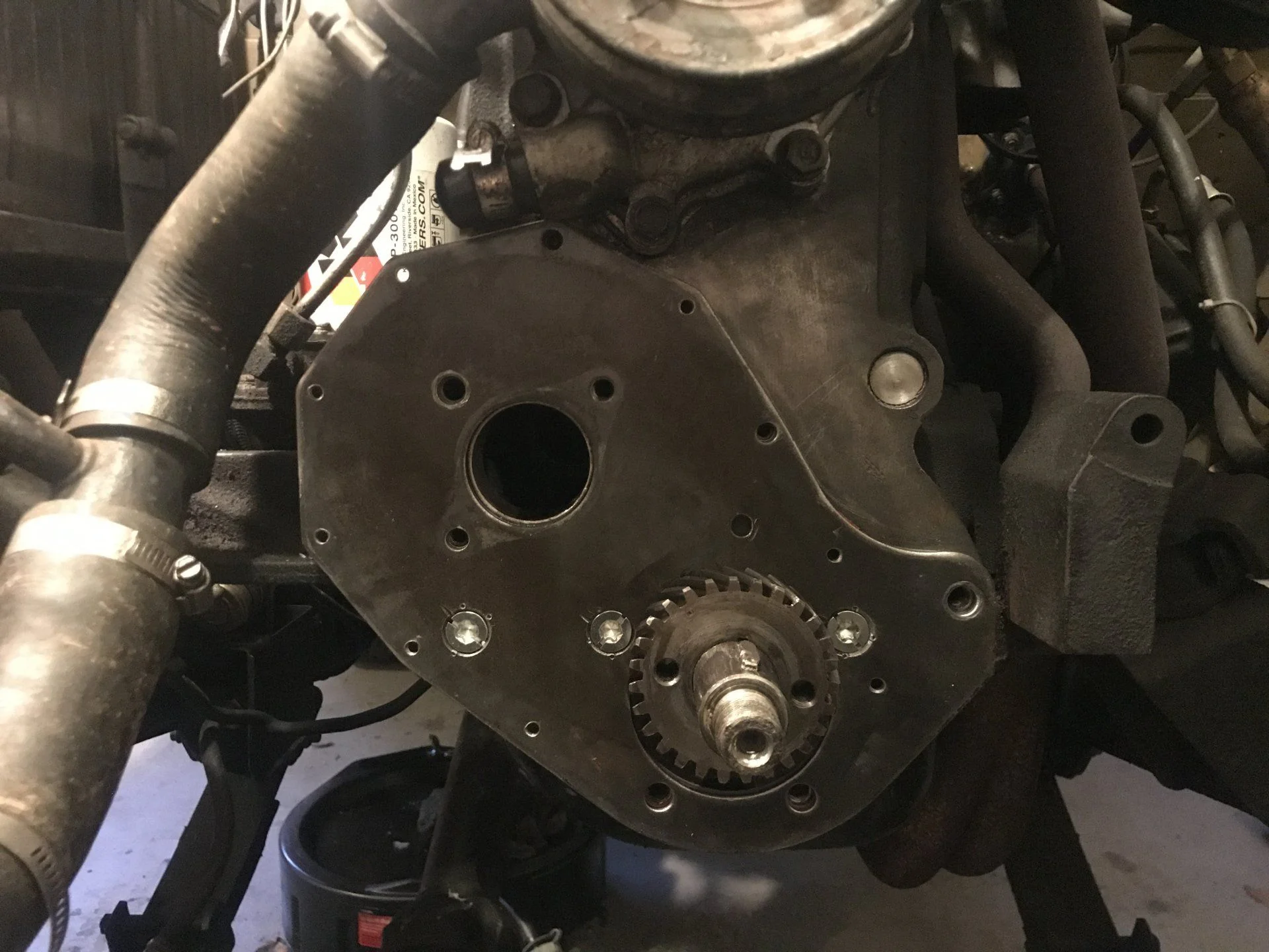

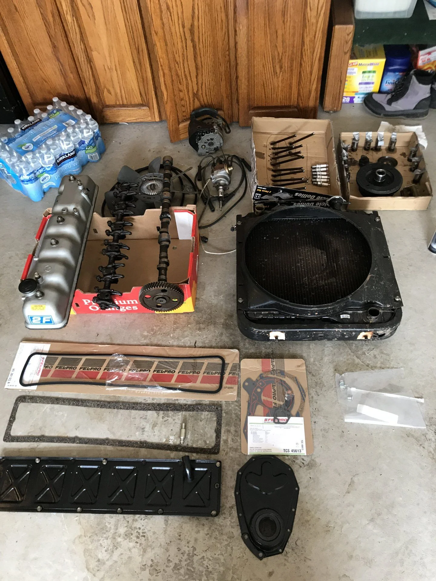

Figure I should tackle the leaky timing cover, I can only put it off for so long....

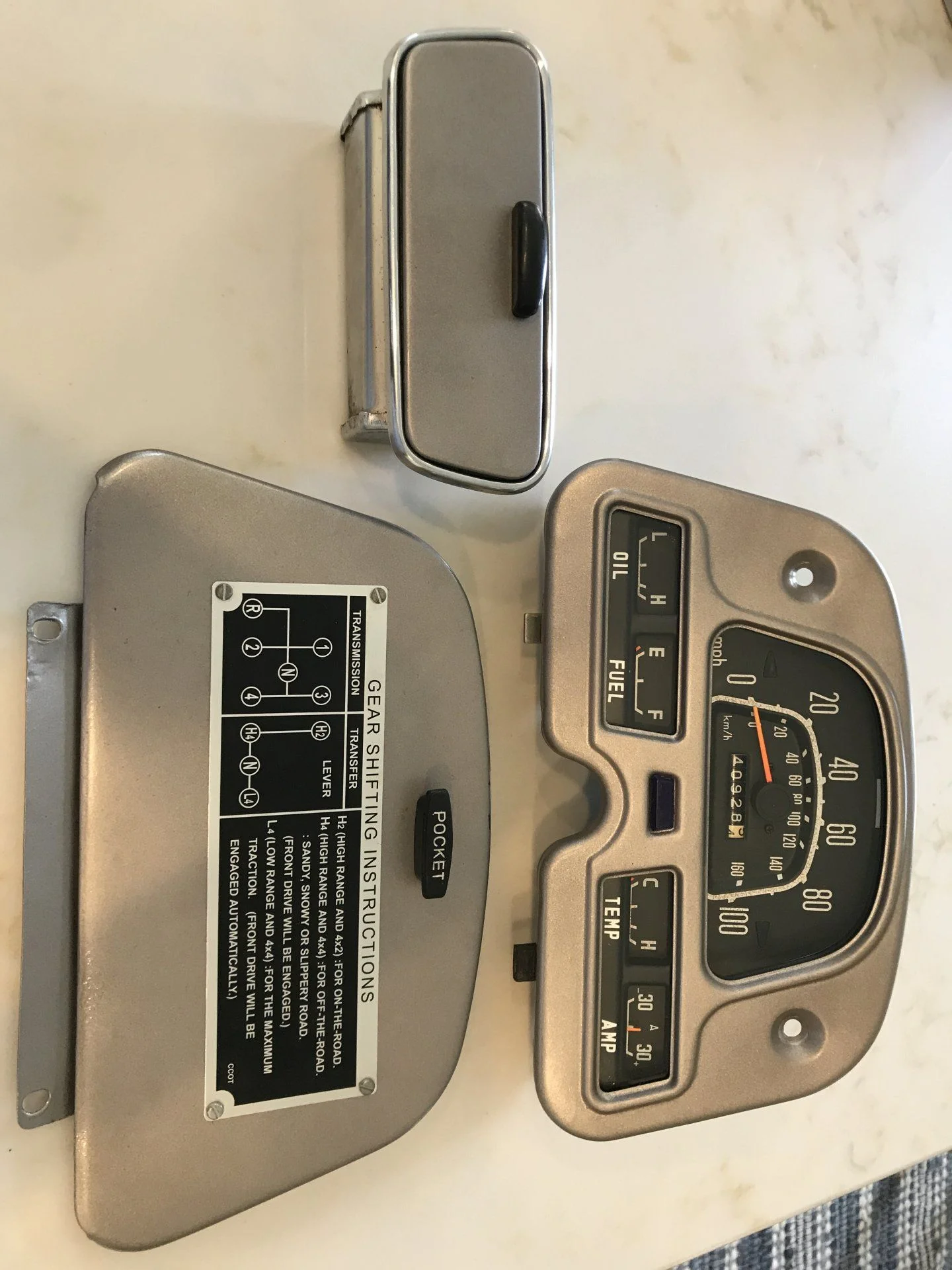

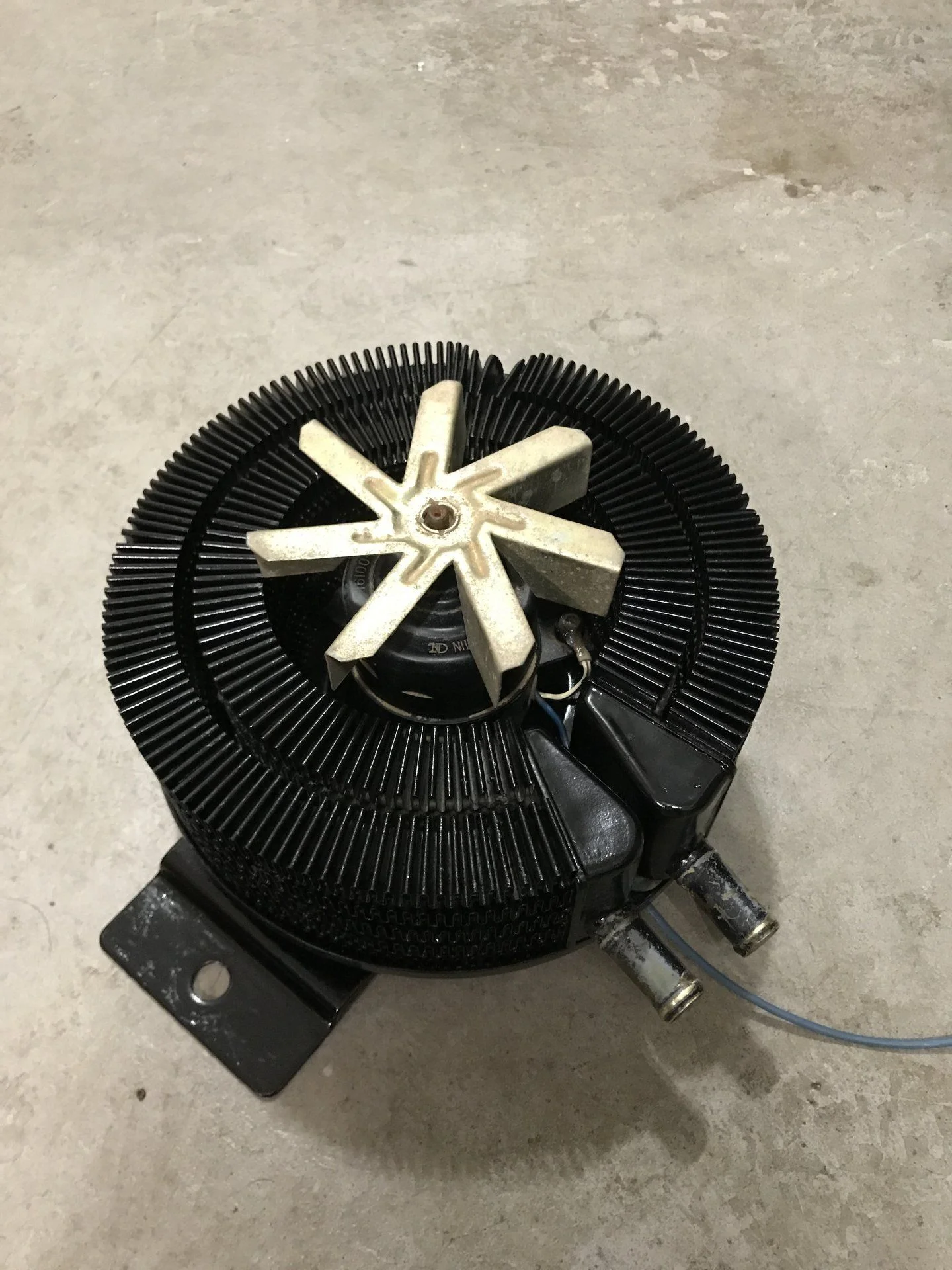

Cleaned up my dash items and rear heater:

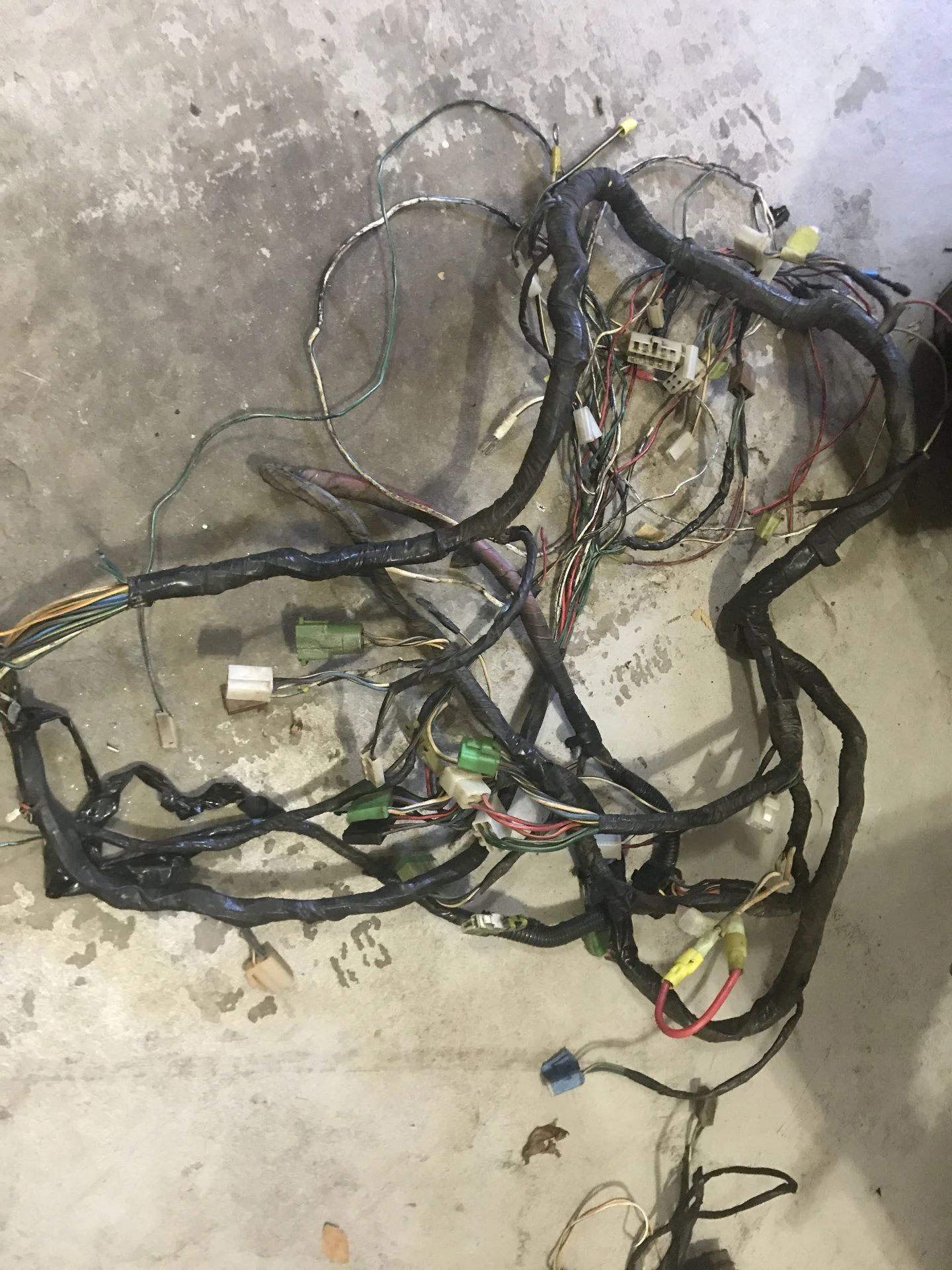

Things were rocking and rolling at this point, so naturally something needed to go wrong.... One of the last things on the truck I haven't touched were the rear axle and wiring harness. Ill let you take a guess which one failed:
Don't worry, we deal with the rear axle soon....

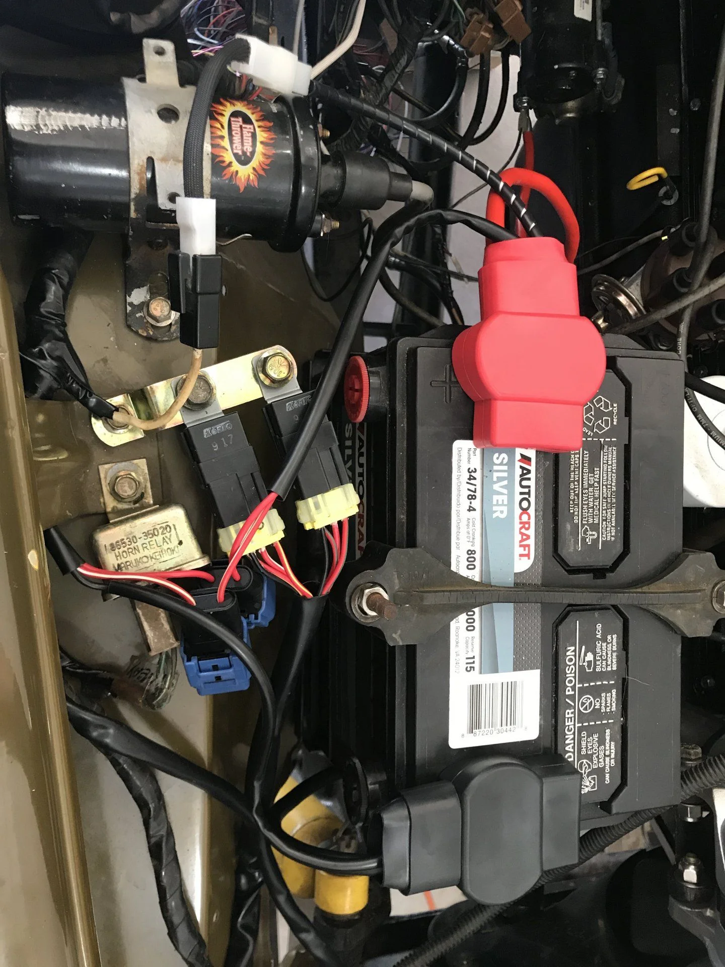

I tracked down a nice used harness, and swopped it in along with HD battery cables and some nice finishing touches from @Coolerman. Easy!

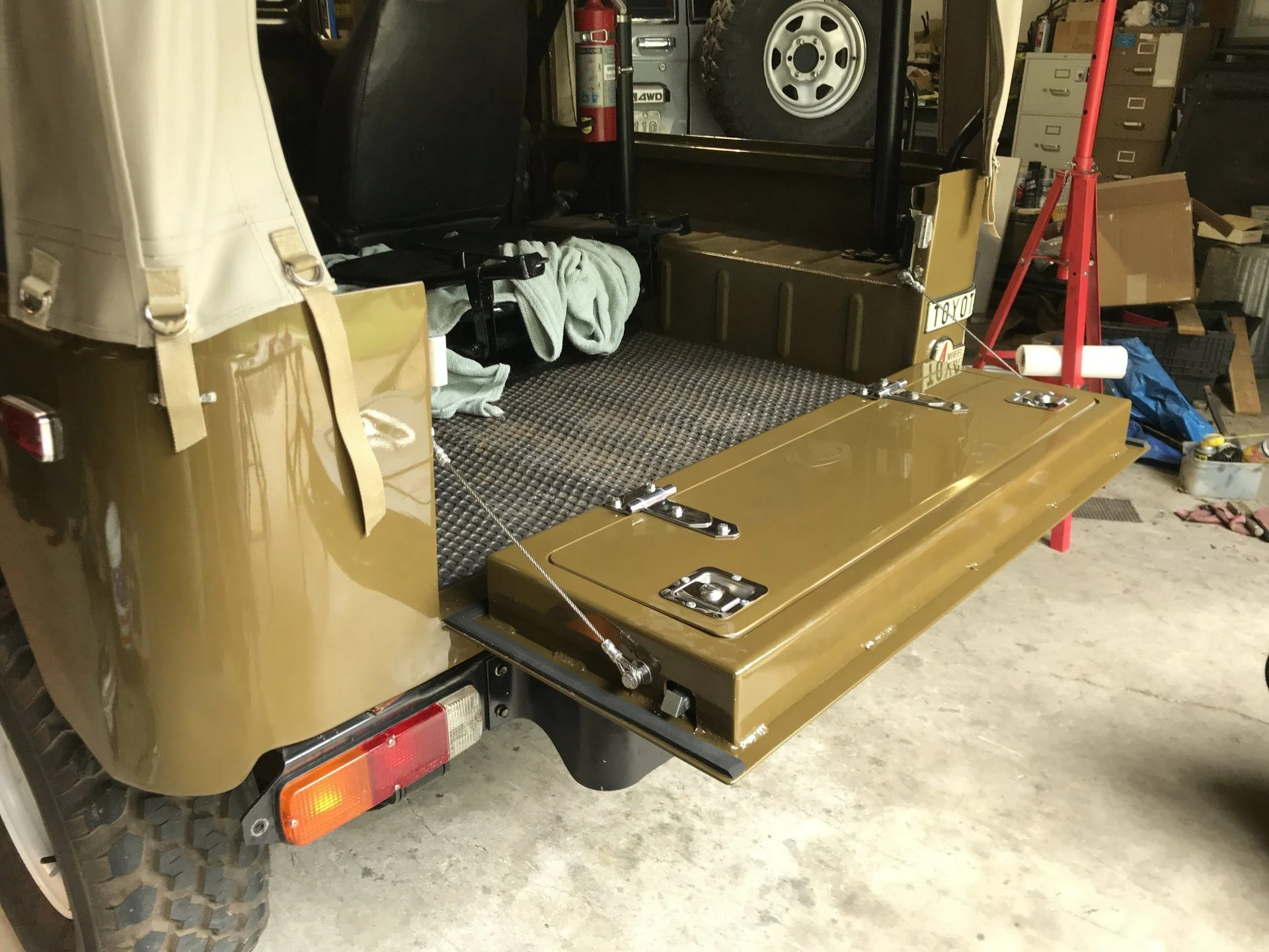

Also got my tailgate mounted. Starting to feel like a finished truck. Thanks again for the help @LDowney !

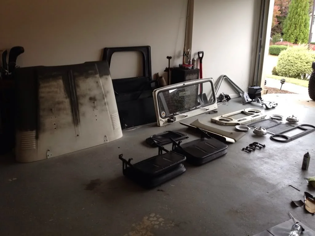

Oh yeah, I finished rebuilding my doors and got them mounted. If I never have to put weatherstripping in these doors again, I will be quite content. Never again.

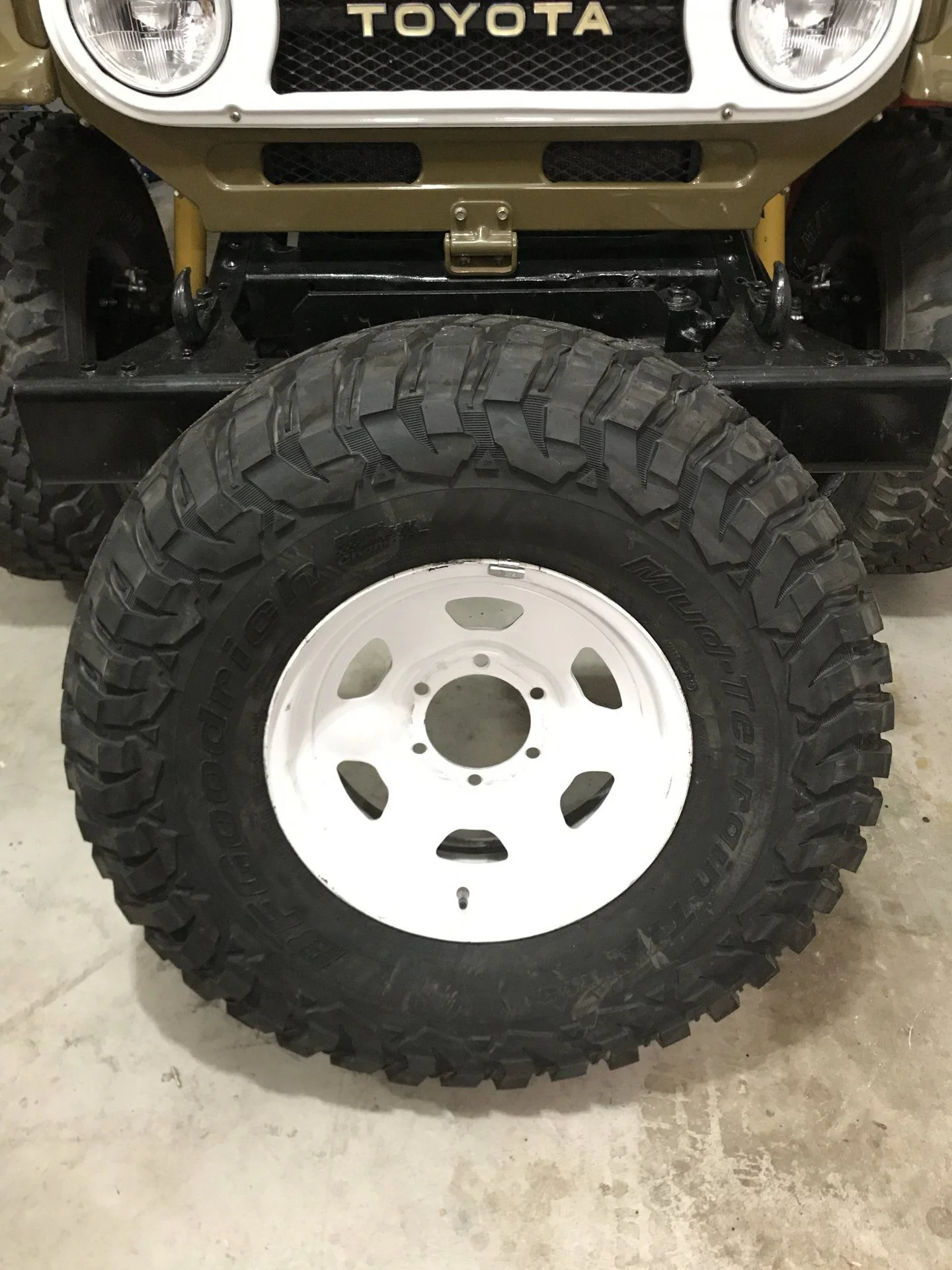

So now that I've got the truck back on the road, its time for some new tires. After all the ones that came off were 10 year old Chinese tires... yuck!

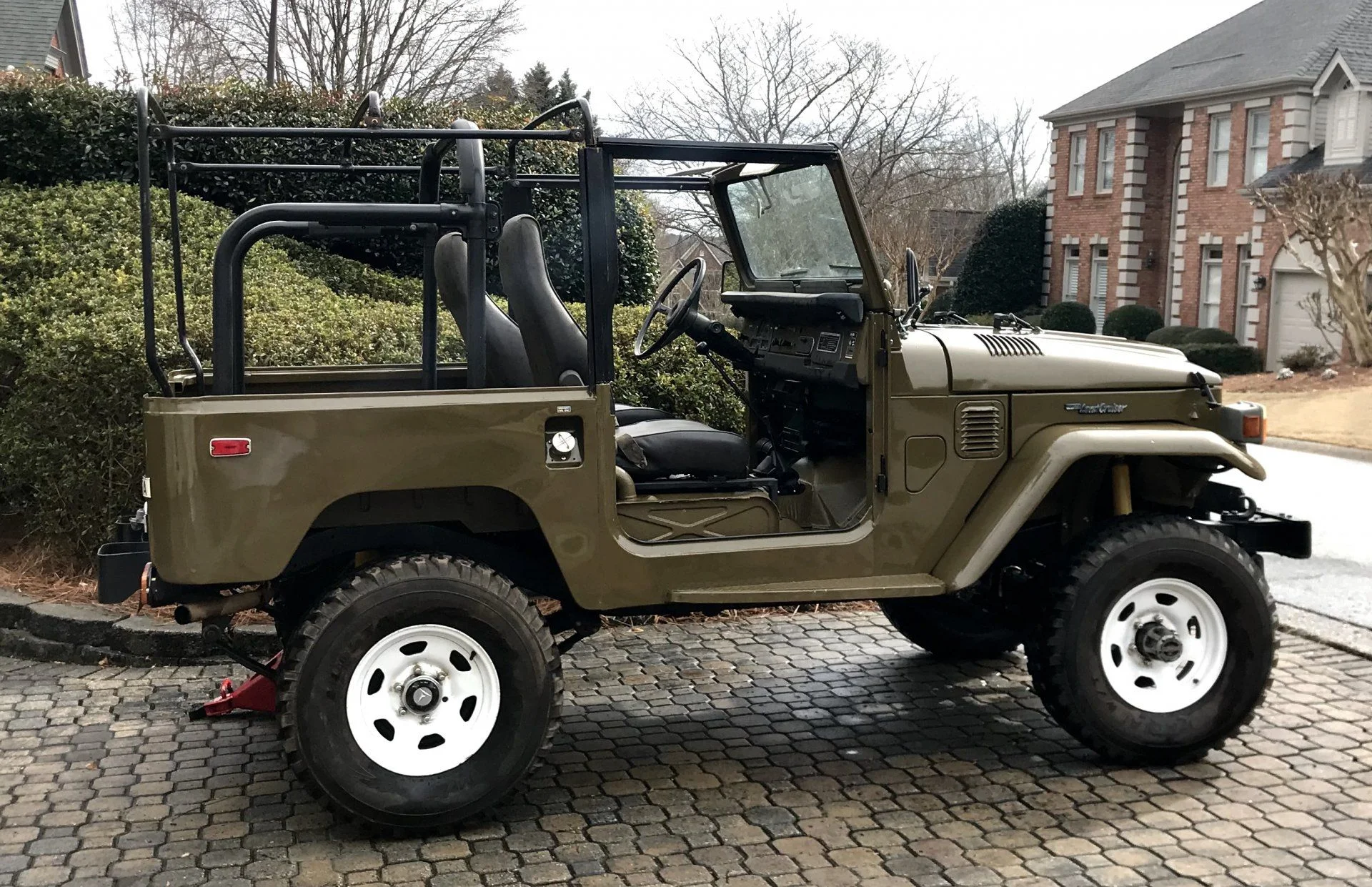

All of this work, plenty not pictured, has gotten us here. Feels great.
Ive got my antique 4x4 all fixed up and running well, it'd be a shame to leave it in the garage. Time for its first real putting in quite some time.

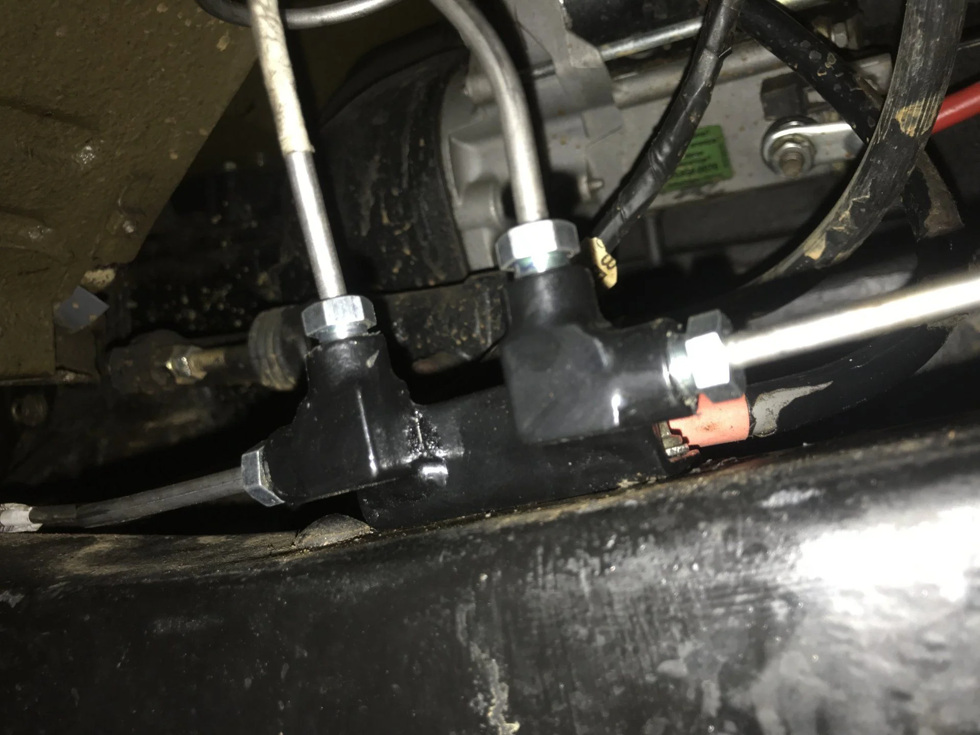

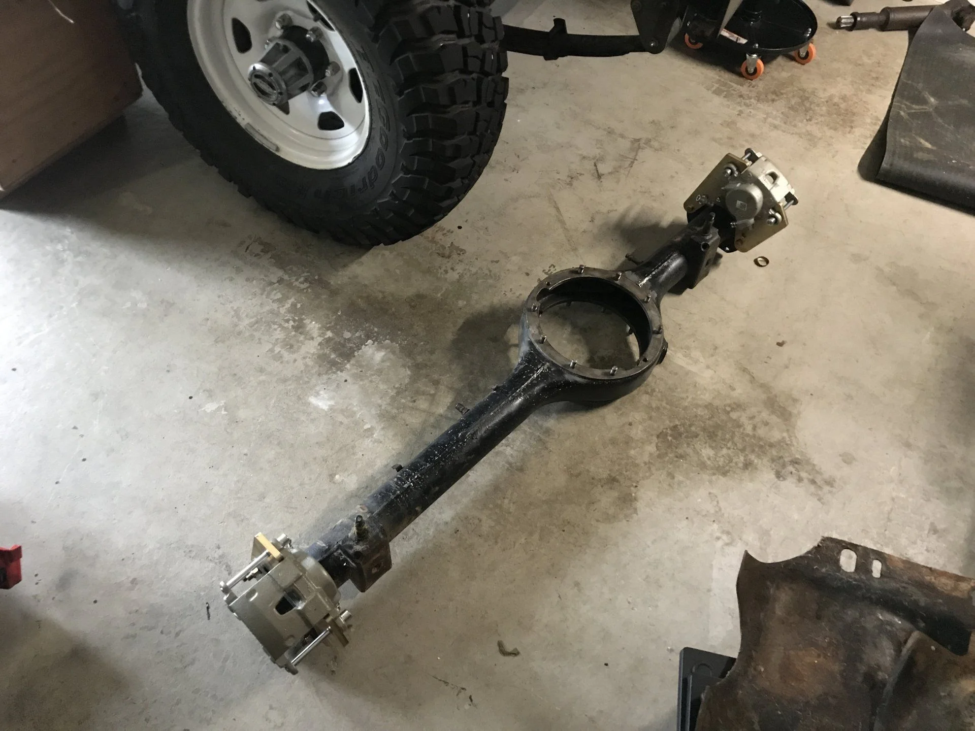

On the way home from the mountains, I had some carburetor issues. For what ever reason, my secondary decided to not work. Doesn't make for a fast drive home. Off with the carb and back to Marshall. While it is off getting looked at, why don't I change out my brake likes with these stainless steel ones Ive had sitting on the shelf for quite some time. When I get to the rear drums, they are nasty. Time for a rebuild as well. Well turns out for the same cost I could go with disc brakes. I am not 100% dedicated to stock, so this was an easy decision.

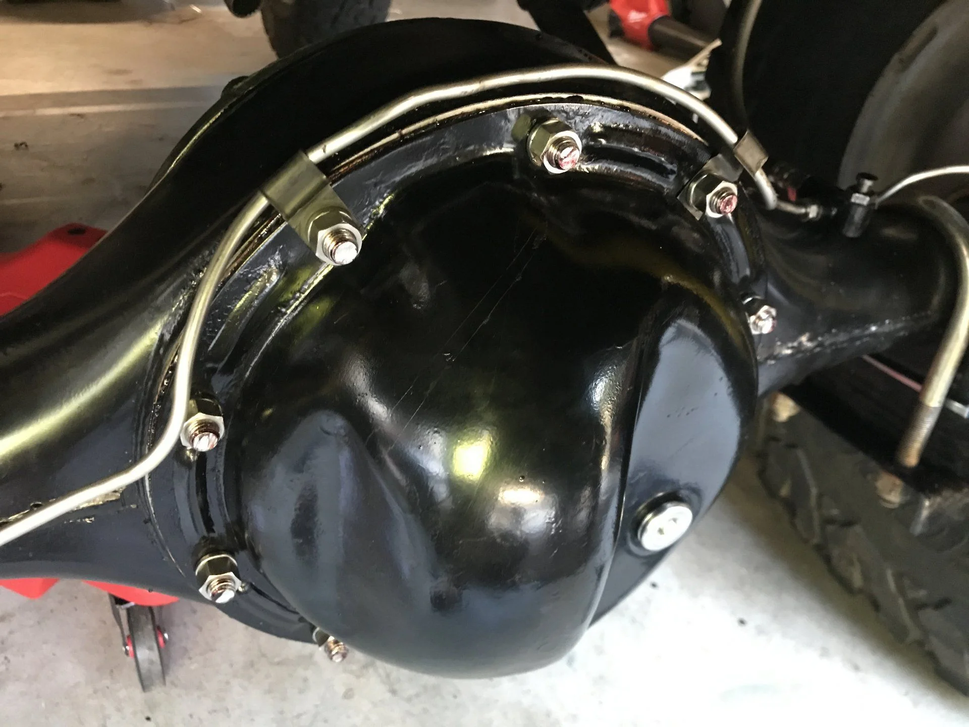

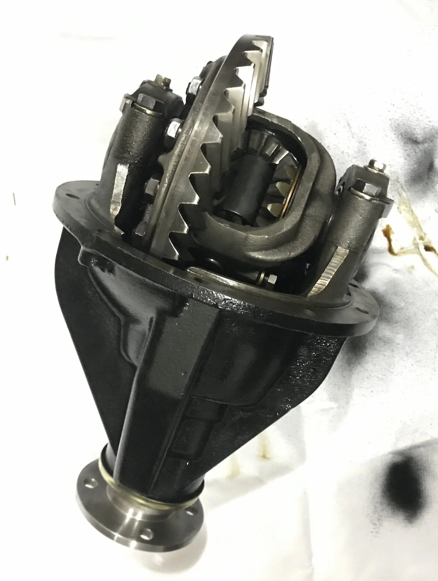

Pulled my diff to find all the gears to be pitted, and the bearings not rolling so well. Luckily I found a replacement diff in good shape. I checked all of the internals, replaced the seal and washers, and cleaned the housing.

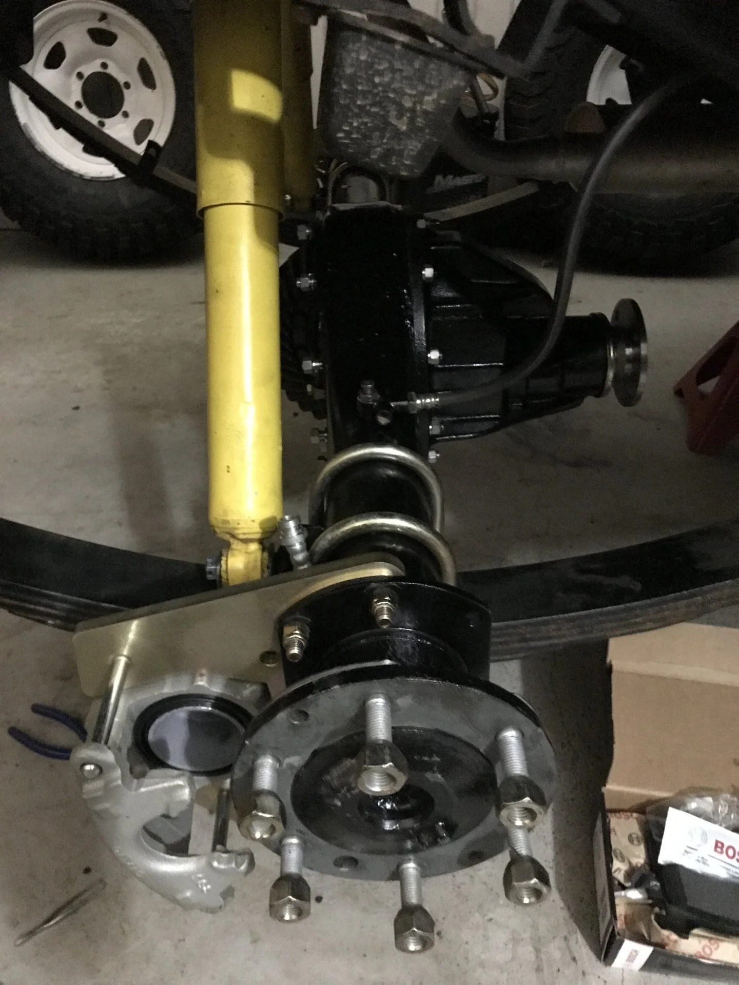

Since the axle is pretty much stripped, why not pull it and clean the entire thing up. "while I am here". New bearings, seals, studs, etc...

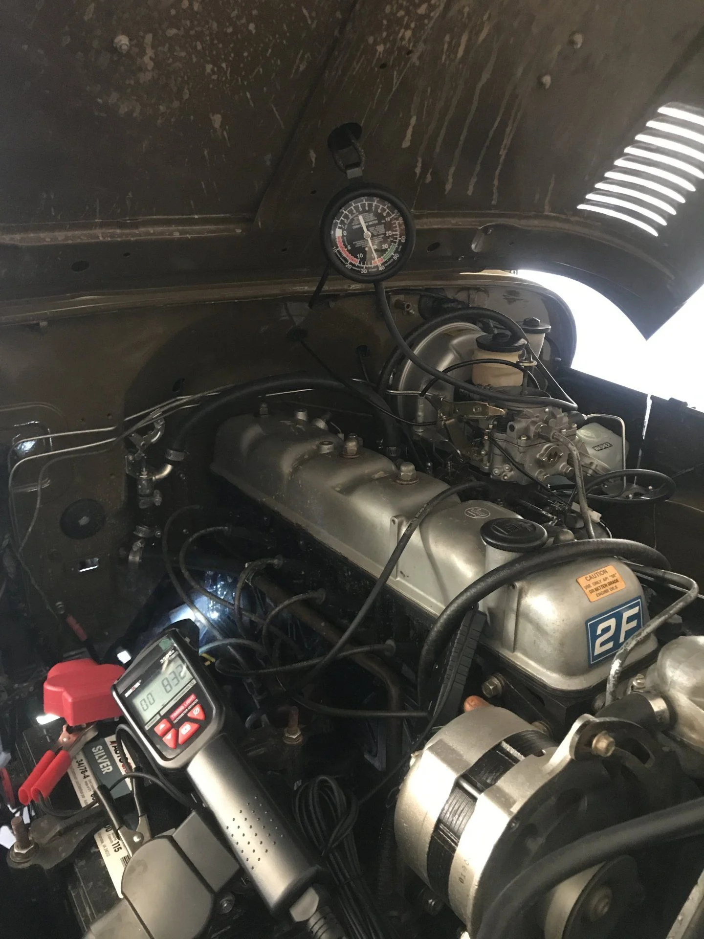

And what did I do today?.... Lean drop the fresh carb, and test drive. Runs great! Still need to bleed some air out of the brake lines though. Ignore the low vacuum, I am idling at 19", 650RPM, slightly advanced timing.

Got a question on suspension and tires.
4” kit from TPI
2deg rear axle shim
BFG km3 33x10.5r15
