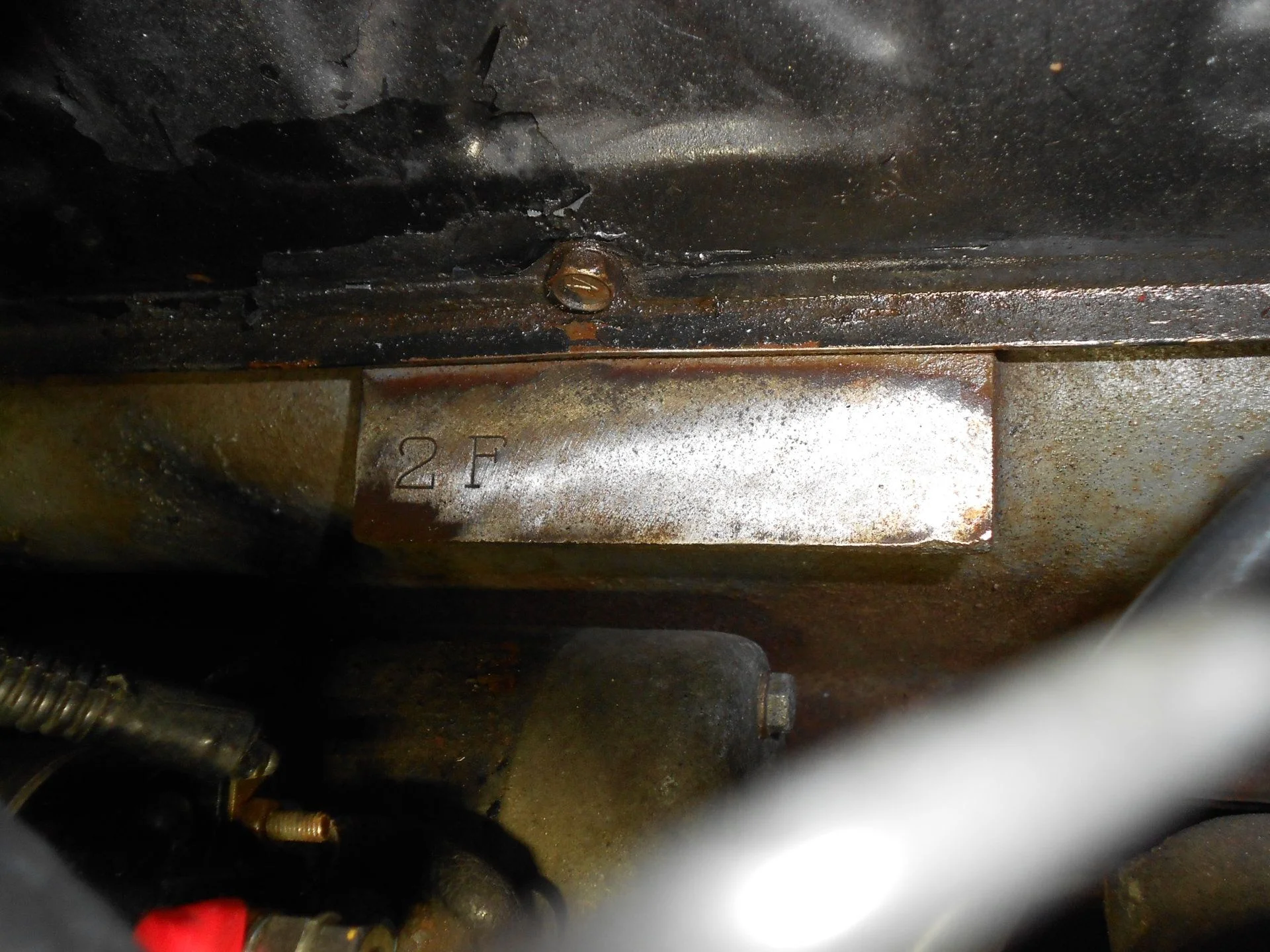

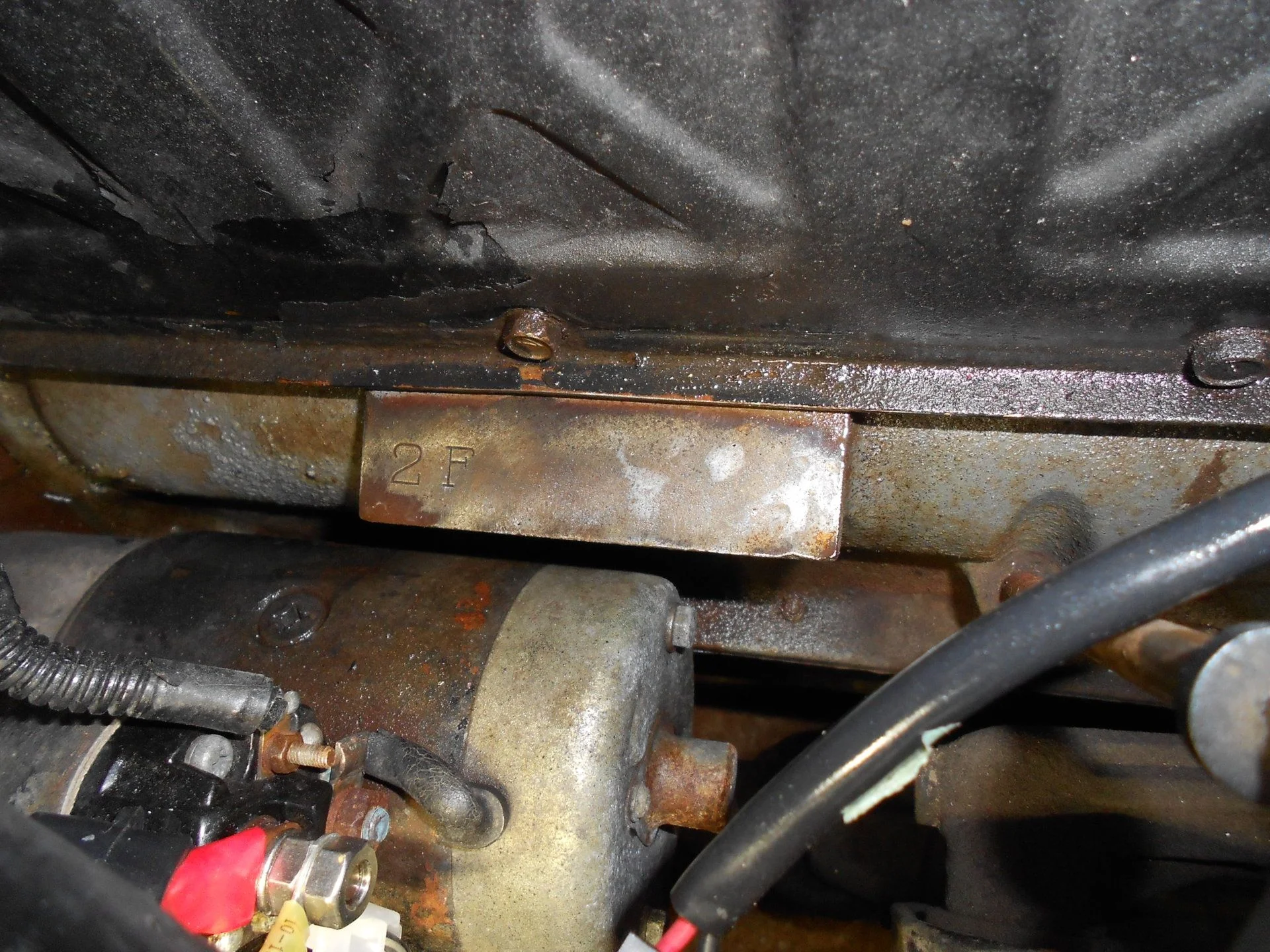

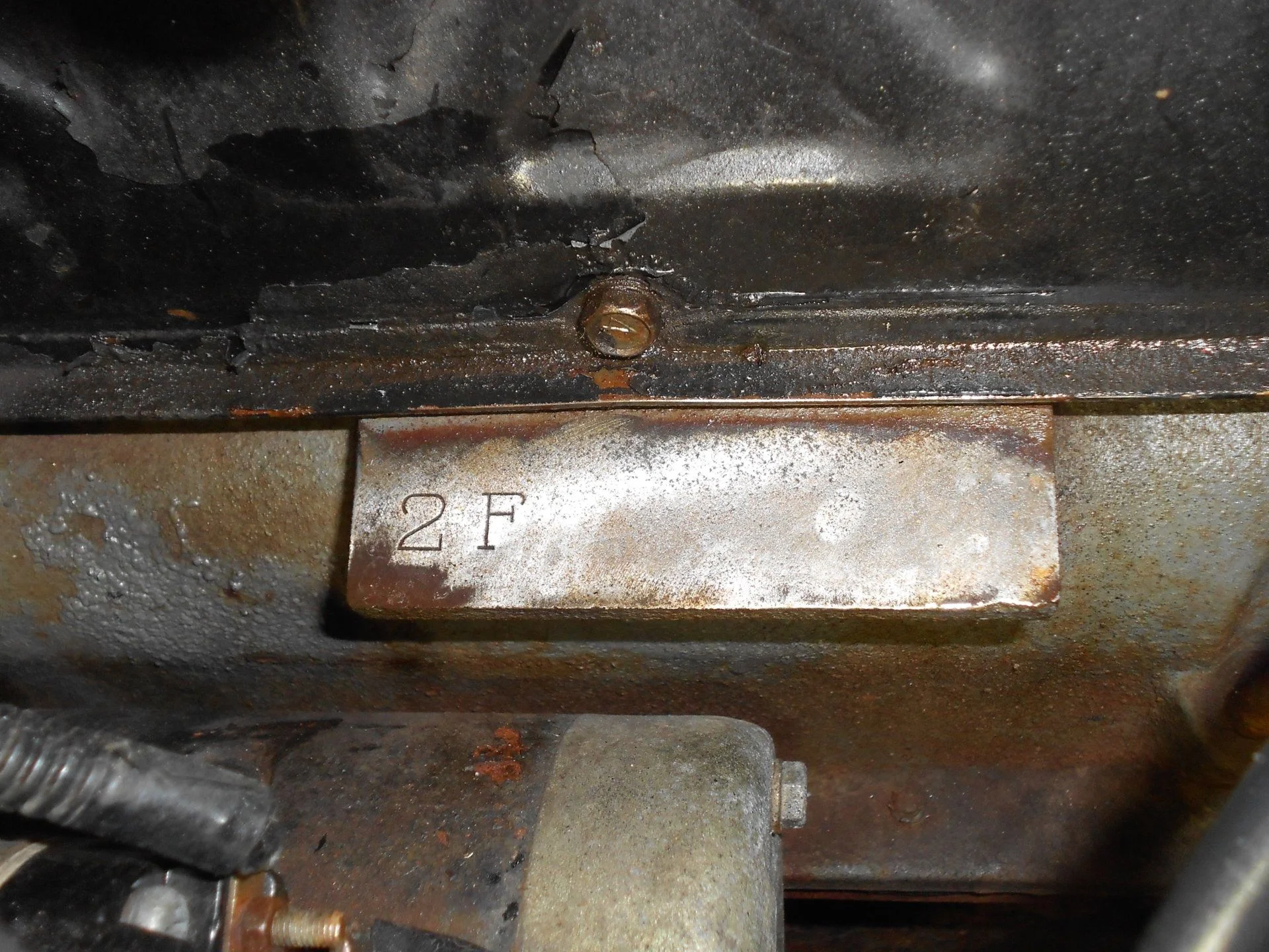

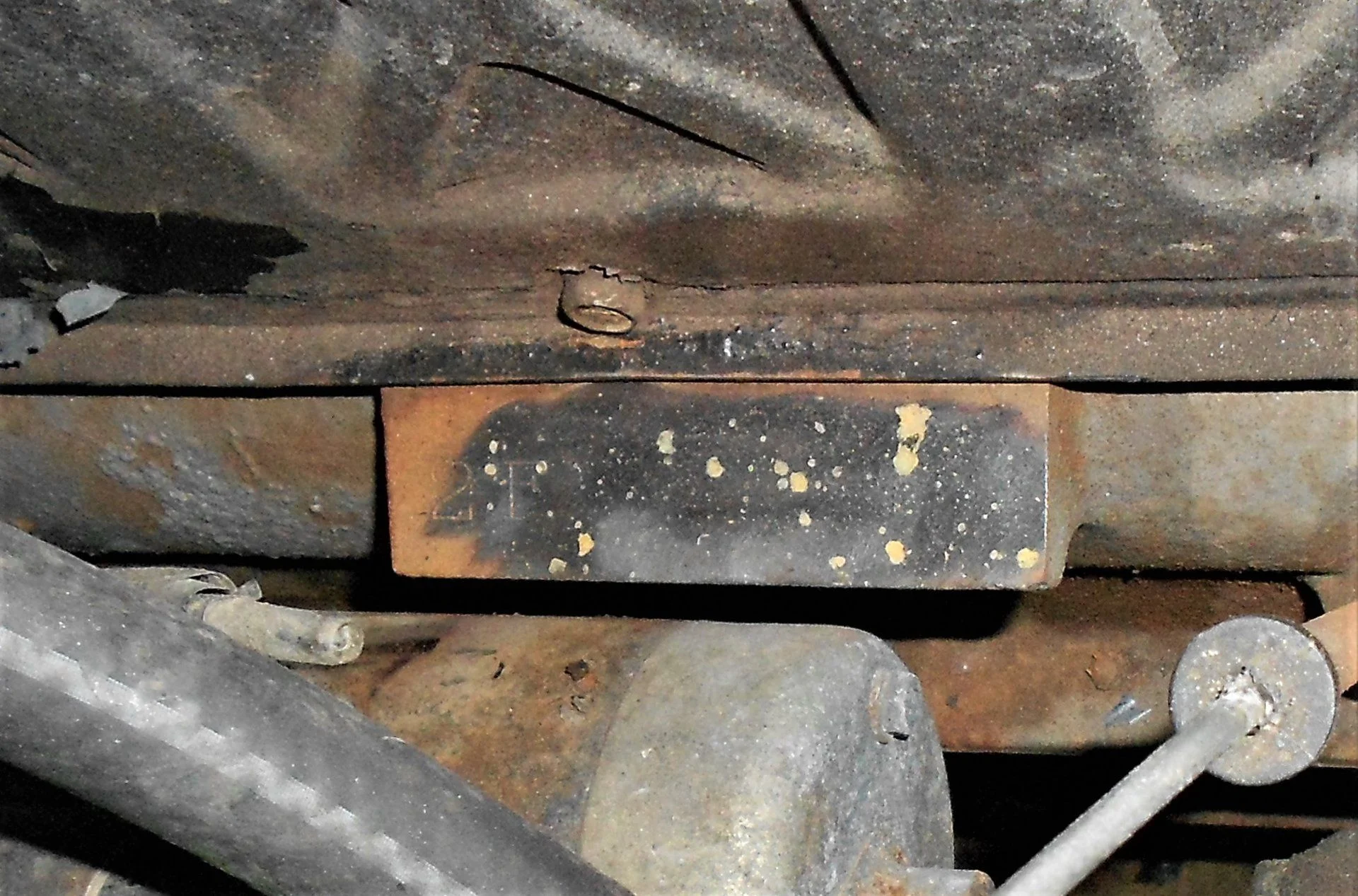

This is in a 1/79 FJ55LG-KA i work on regularly
i would love a fresh perspective from anyone ?
but in the Mean time i WANT Taiichi Onho's Hat BAD .....................:popcorn:
note: i did polish lightly with scotch-bright , it's a Definite Blank and 2F

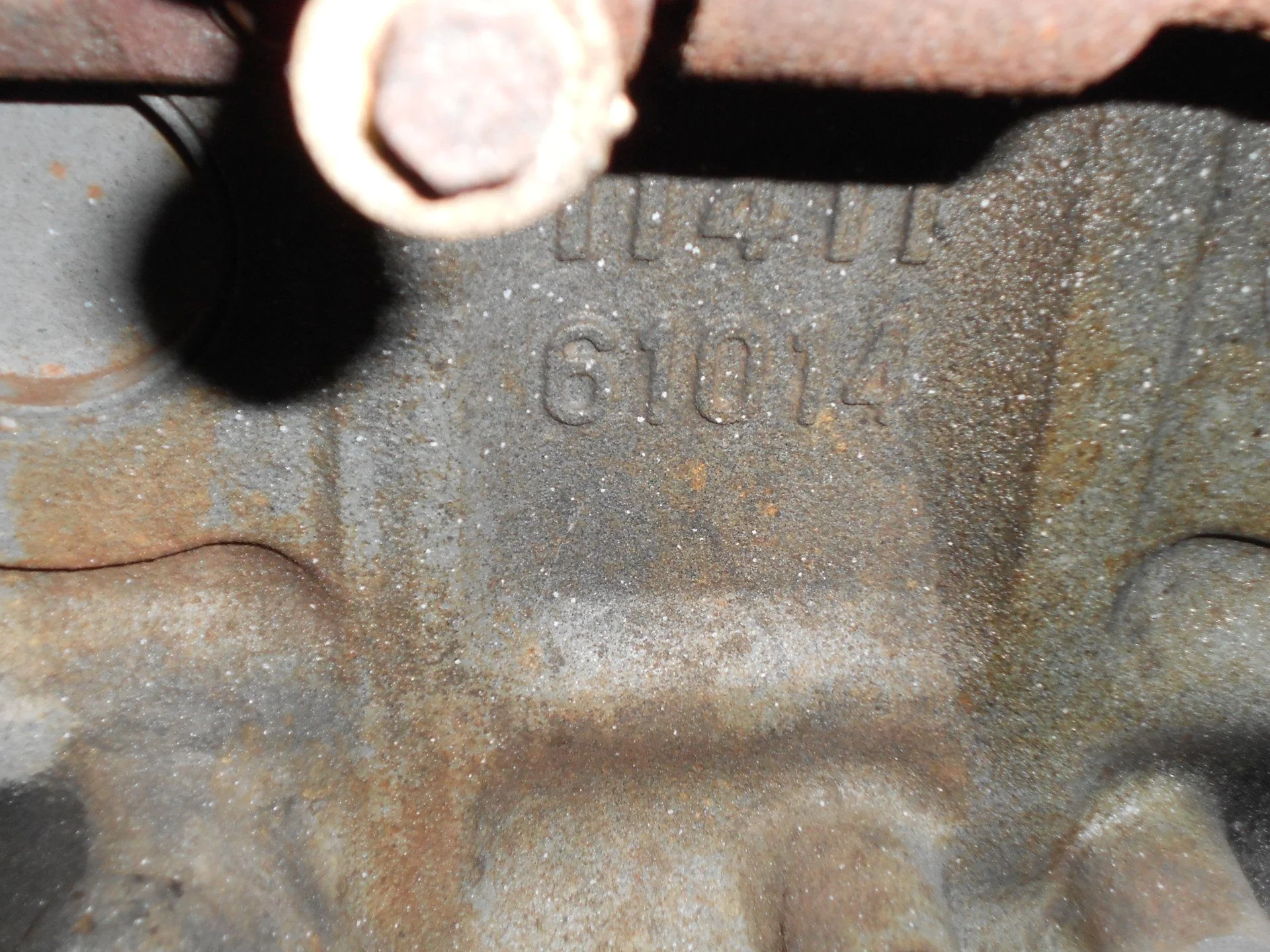

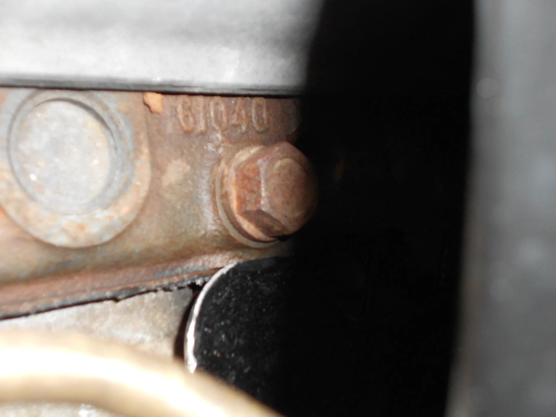

@RAGINGMATT
That’s the part numbers not the casting number
The casting number is further back toward the firewall on the same side as the part number
thanks !
i have to wait till day light to get those , Never knew about the casting numbers on a 2F
simply amazing !

@RAGINGMATT hit me up with a private message I can help you with the casting number ... but I think you’ll get it :)
