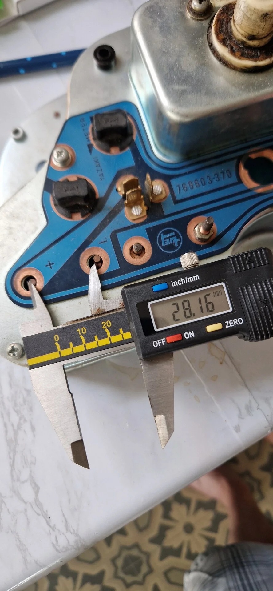

Can someone give me the dimension between the two posts on this amp gauge?

28mm Centre to centre.Can someone give me the dimension between the two posts on this amp gauge?

Thanks for the pic and dimensions. I may be mistaken but this looks like the mounting for a 50 amp gauge. I've read that the 30 amp gauge has a different post to post dimension.28mm Centre to centre.
Holes in the pcb are 6.5mm
The studs look like M4
