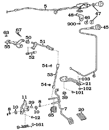

For the pics linkage, the linkage on the carb it's-self or the linkage from the pedal to the carb?

Oh, and i was looking for pic of pedal linkage to carb.
Couldn't get any good pics of the linkage, so I default to $OR. Just can't get a good angle to see all the parts. I lucked out that the PO used the stock linkage with my Weber carb, so I didn't have to hunt that stuff down
A pretty good diagram if I do say so
