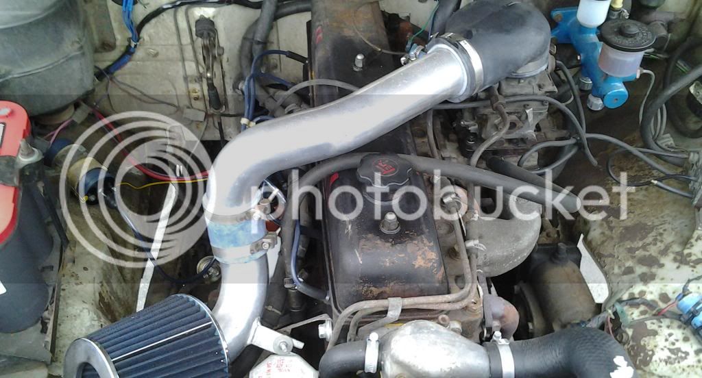

Here is an image of this beauty, rust in all the spots it should while being outside in the PNW.
A stock '73 engine would have a vacuum RETARD dizzy. If that is what you have, just cap off the vaccum source to the dizzy and run it on the mechanical advance until you decide on what to do with it. Post a pic of the dizzy, we can tell you if it's an advance or retard dizzy.

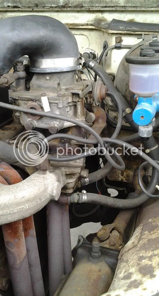

Aisan carb?????
You can see where the engine number is stamped in this pic...above the starter and behind the dipstick. Clean that off and read the number, it wiil tell you what engine and when it was made. Read the name on the carb, is it Aisan? Show us a pic of that carb too. You have a vacuum retard dizzy. Dizzys are either vac retard OR vac advance, not both. If you want a vac advance dizzy, you need another one.

You need a new buddy. Aisan is stock LandCruiser, (Japanese, not Chinese)

Here is a photograph of the carb, after squinting my eyes enough I could see it is :Aisan", the rod that connects to the linkage is loose and the rubber around it is shot:
Here is a full engine shot:
