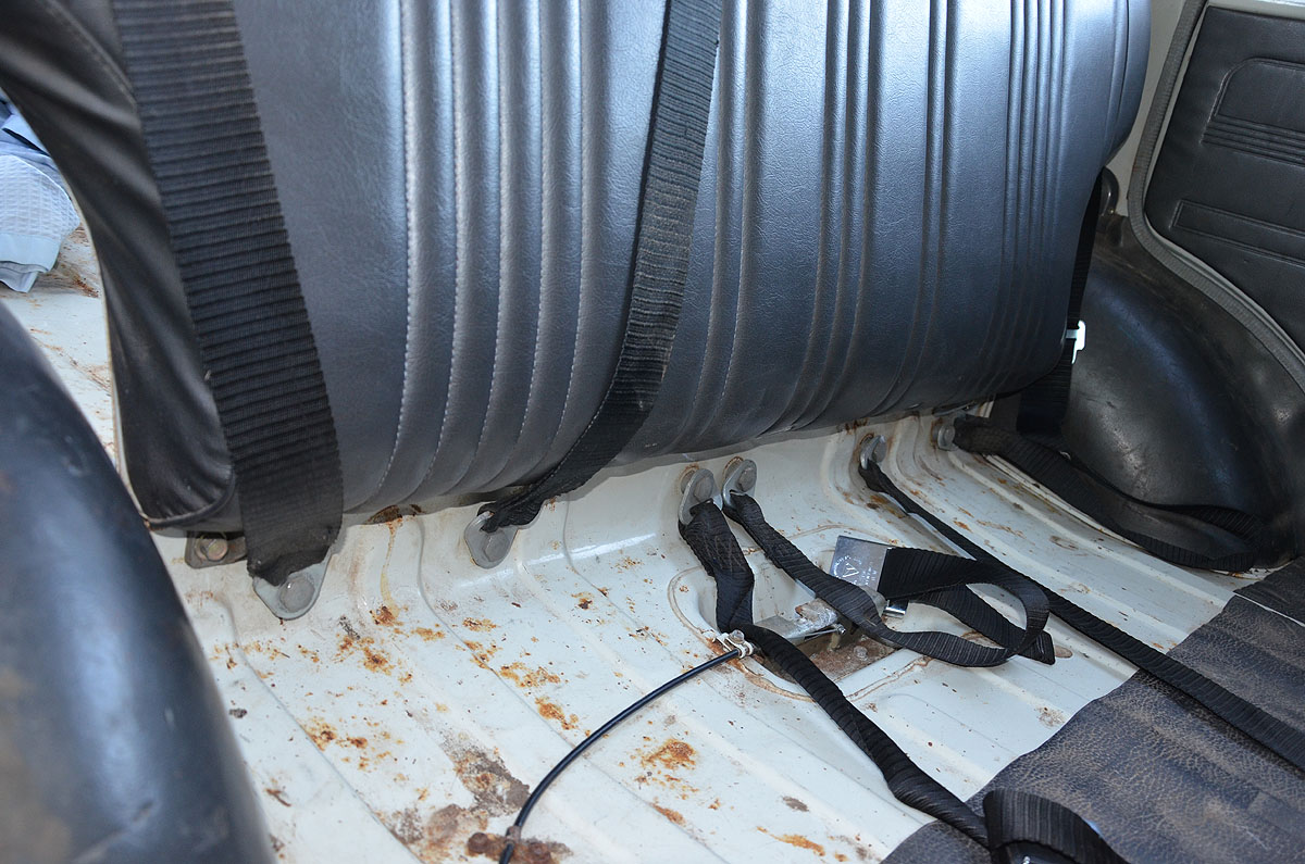

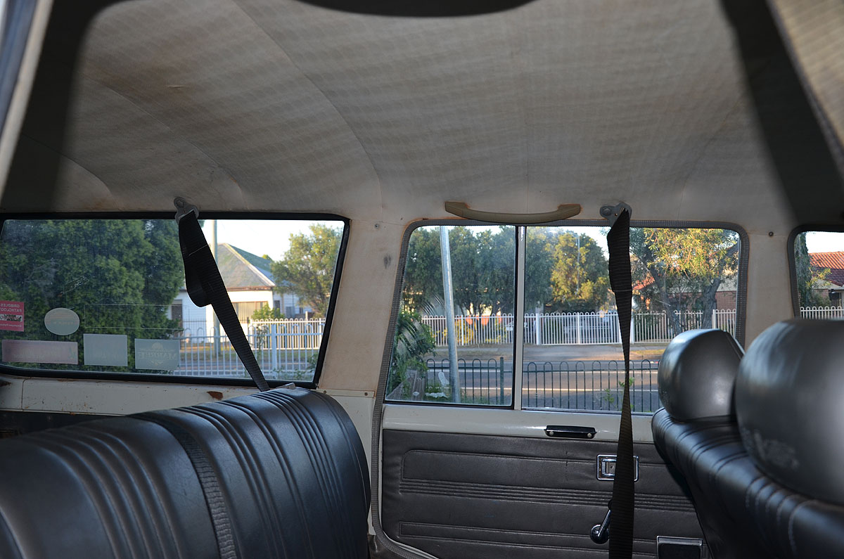

Pablo,

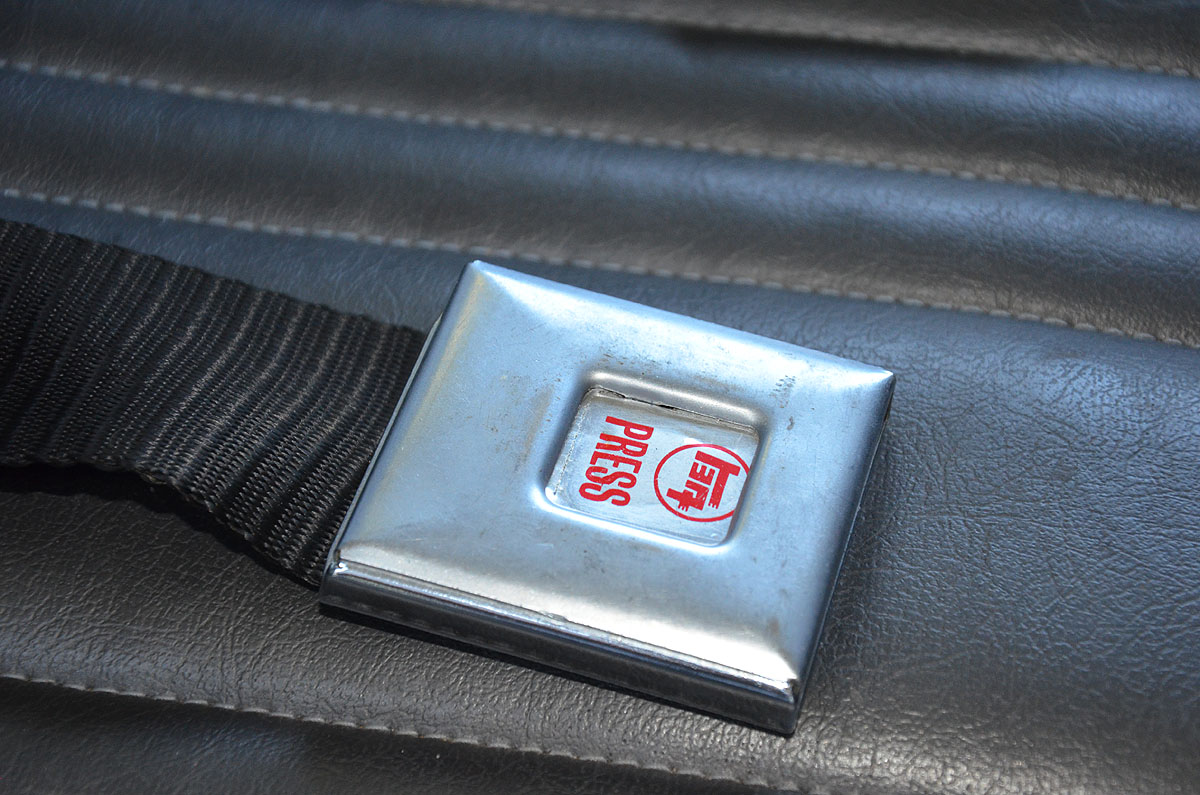

Here is where the belts mount. They all have the TEQ logo so I assume are factory fitted and Genuine Toyota items. Pretty sure they were a compliance item here in Australia by 1974.
Pablo, Here is where the belts mount. They all have the TEQ logo so I assume are factory fitted and Genuine Toyota items. Pretty sure they were a compliance item here in Australia by 1974.
Thank you. So they look to be adjustable, not retractable, in front and rear?
I can feel those rear anchor points, I would love to get a seat of those rear belts. Do they connect with the lap belt at the buckle?
Also, I have see a Pig from Oz that had the seat-belts for front mount on the actual B pillar. Have you ever seen these?
Pablo,
The belts are adjustable ones for all 6 passengers. The B pillar bolt belt fitment was done on a lot of cars that came in around the same time as belts became a requirement. Locally made vehicles here did not have the mounting points for the belts, so it is how they were all done to meet the social or legal demand to have them.
A lot of the places doing this work did not realise that every pretty much any Toyota after the late 1960's had the factory mounting points in place so rather than look for them, they just did what they did to everything else. Another reason this happens is when people want retractable not adjustable belts, if you dont mount them vertically they are harder to unwind (but do work fine IMHO).
Engineers here push for retractable belts when you do conversions, but the actual requirement states lap sash not retractable. If you know the actual guidelines and not just what your engineer wants its easy to get adjustables approved and no new holes are required.
Its a shame as even my old 1970 Crown wagon had the Seat belt mounts in it (even for the 2 children intended for the dicky seat in the boot)

Wow nice find!
Those seatbelt placements in between the b and c pillars, and the one that is above cargo window look very odd. I don't doubt that they came from the dealer like that but I haven't seen another FJ55 with them.
My retractable front belts are directly in line on the b pillar, and same with my adjustable rear seat belts which are on the c pillar (1978 model).

Thanks for the reply!
I am trying to discern from your pictures if the rear seat outer shoulder belts must attach to the lap belts, like what I am guessing your fronts do? My adjustable 3 point belts for the front have a fastener for the shoulder belt to clip to the lap belt before you buckle. This means you can wear the lap belt seperate from the shoulder belt.
The material looks different than the material in my belts. do you think they were replaced at some point?
Wow nice find!
btw if you ever want to let your front bench go let me know!
Those mounts came from the factory that way. If you push around on your headliner you can feel the mounts. I have the front and rear mounts in the same positions as the pictures.
I did see an Aussie Pig with 3 point belts on the B pillar. It sounds like those are an aftermarket install.
Hi Pablo,
I understand your question now. The shoulder strap on these does not clip into the sash separately.
My MS51 2 Door crown coupe had those, very cool style of belt. These are your typical non retractable Lap sash belt. These are much the same as in my 73 Celica had so I am pretty sure they are a factory fit item.
Hi Pablo, I understand your question now. The shoulder strap on these does not clip into the sash separately. My MS51 2 Door crown coupe had those, very cool style of belt. These are your typical non retractable Lap sash belt. These are much the same as in my 73 Celica had so I am pretty sure they are a factory fit item.
Okay, so somewhere on the belt is a fastener that connects with the buckle? If you see a set would you grab them for me? Thanks!
