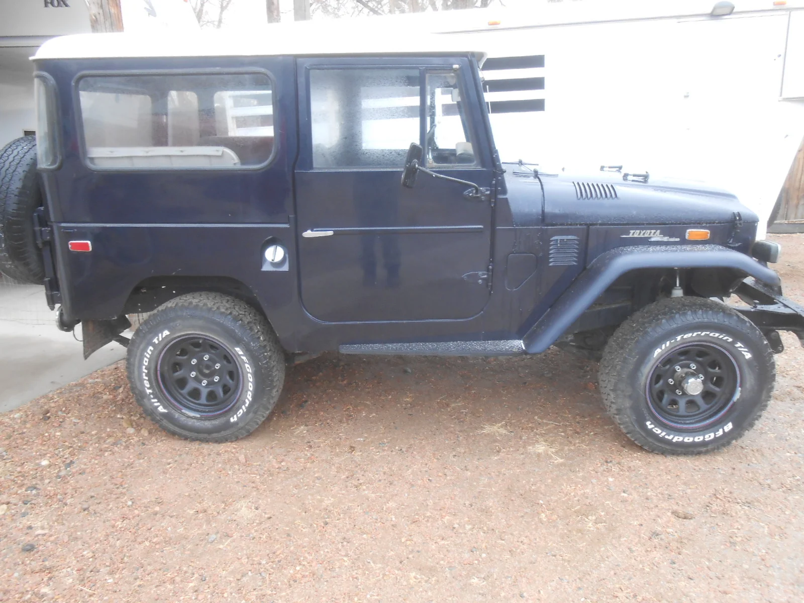

I'm interested in a 1972 Toyota Landcruiser FJ40 posted in my neck of the woods a few days ago. My dad isn't really a car guy, so I'd like to access the collective wisdom of the group.

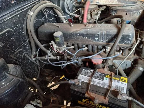

21.5K miles. Guys says it starts and runs "good." Needs a clutch master cylinder ("current one leaks onto floorboard") and a valve cover gasket (from email with owner).
Rust: "One quarter panel has about a half dollar cancer spot coming through, nothing anywhere else"

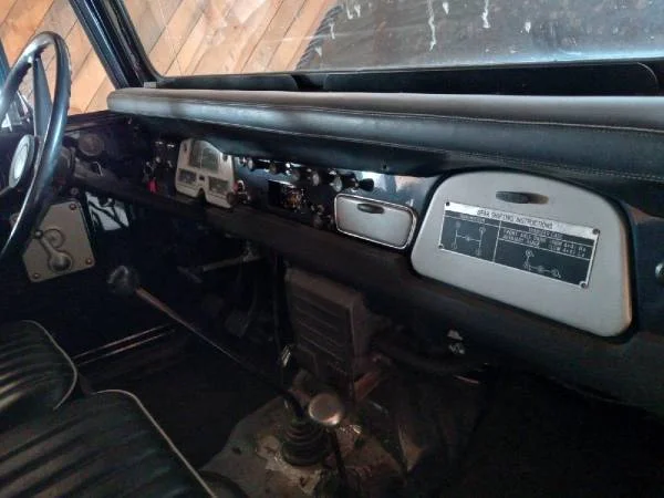

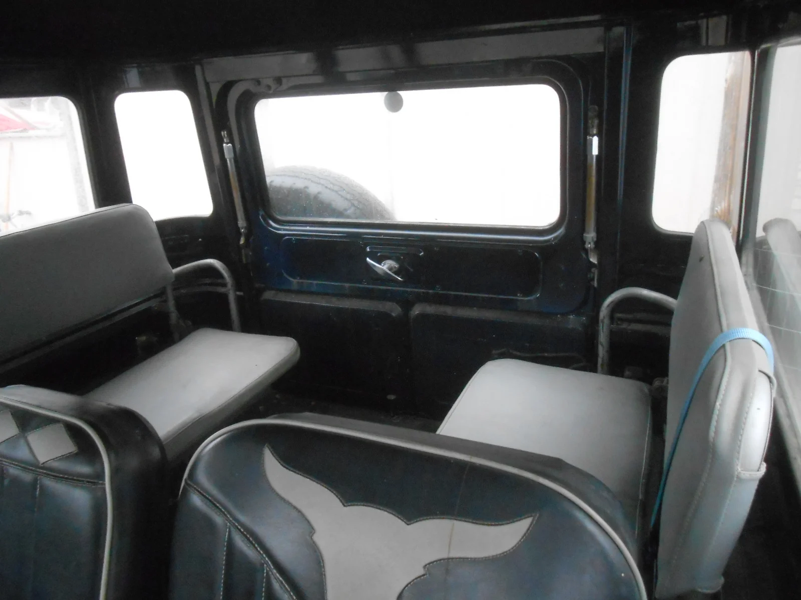

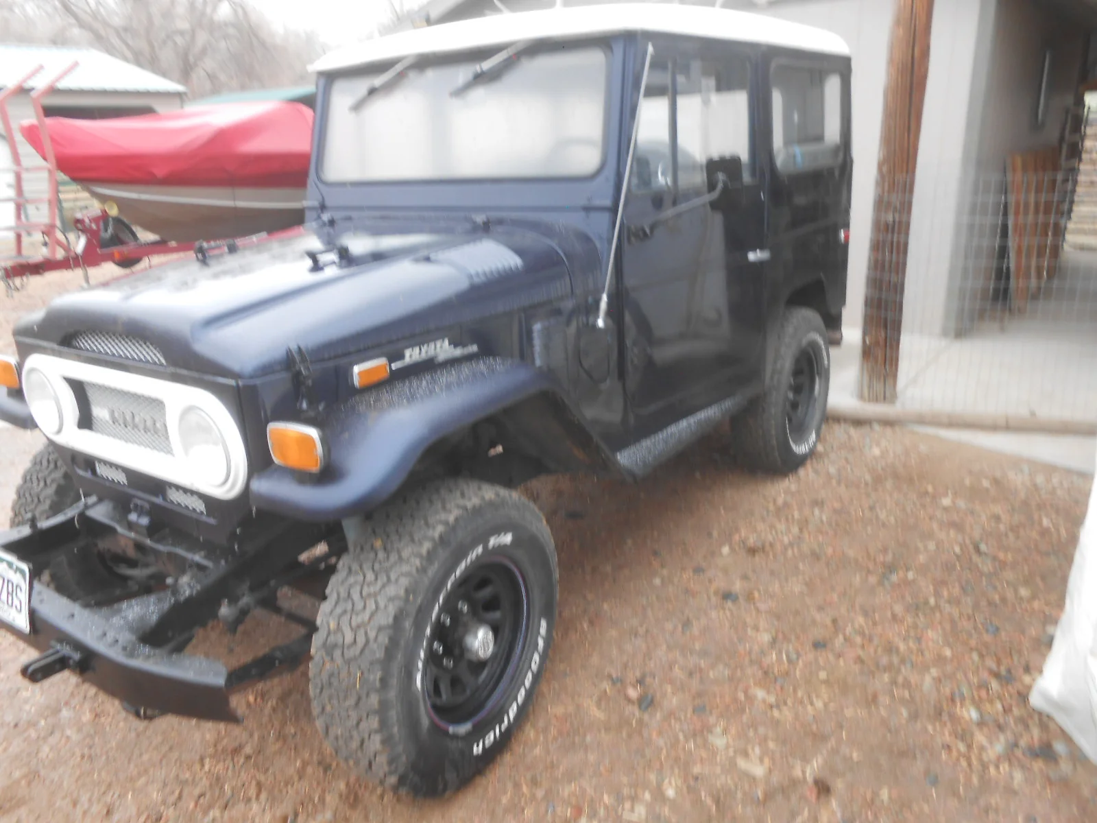

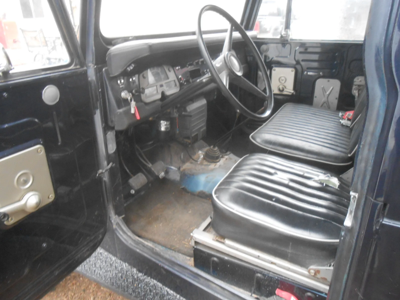

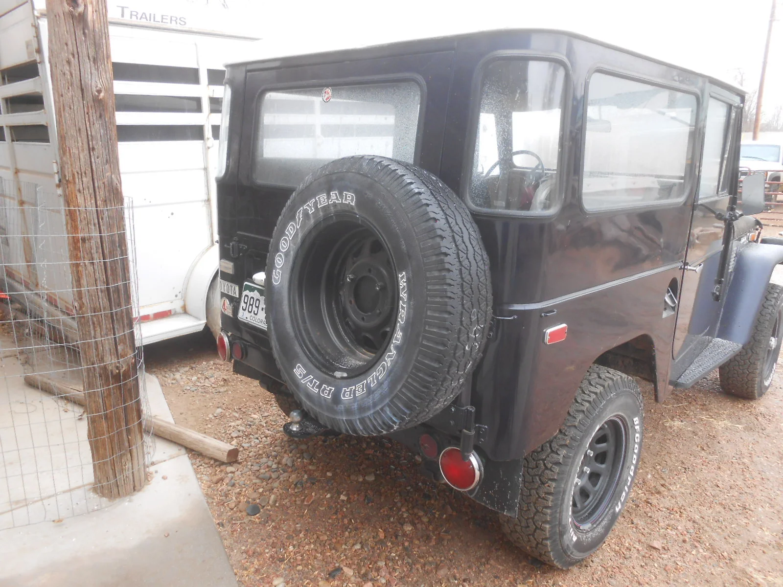

Overall a pretty nice looking truck there for $10k. Can't tell too much from those photos, but I can see its a repaint so look for bondo. The tranny hump is a different color and appears rusty around the base. The front driver side tire has oil on it, should add new wheel cylinders to your list. Also, I would be careful trusting anyone who told me there was only 21,500 miles on that truck, that is highly unlikely.

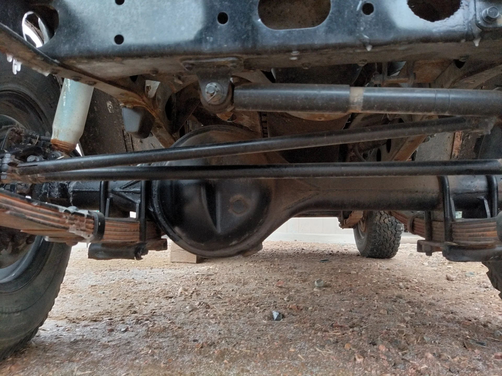

Probably some bondo with the repaint. Look underneath in the back carefully. That won't keep you from driving it. Estimate a couple grand in parts to baseline it and undo po mistakes.
Front seat upholstery is cool.

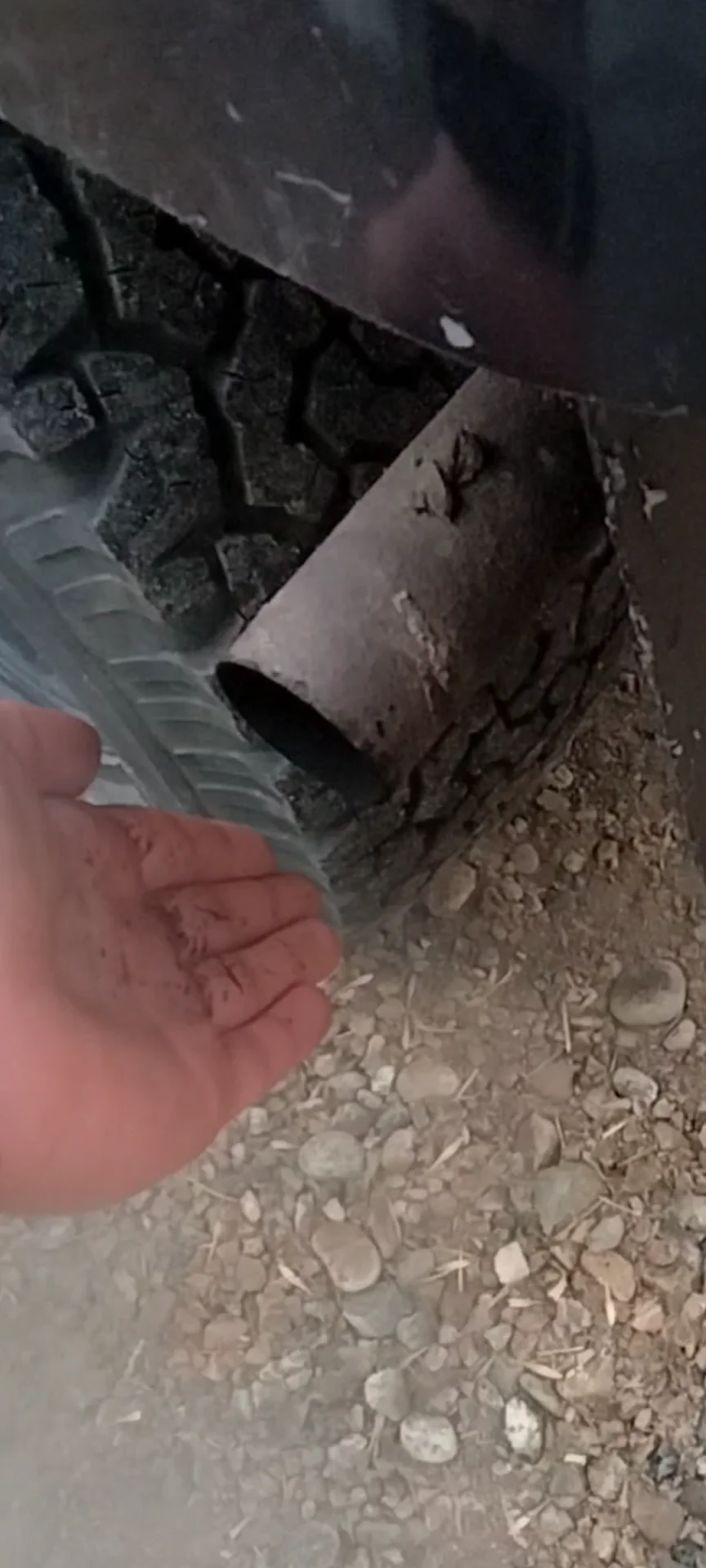

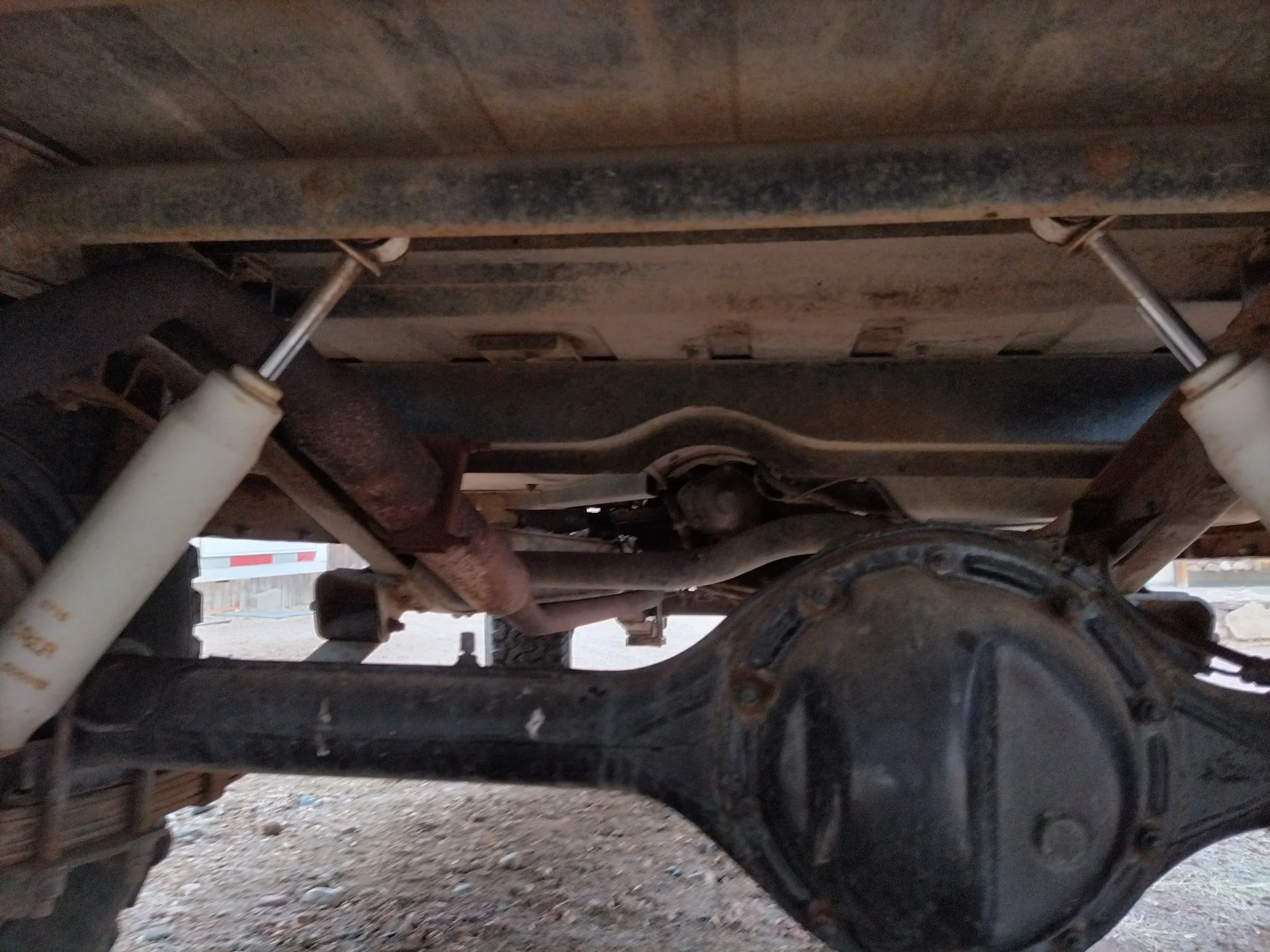

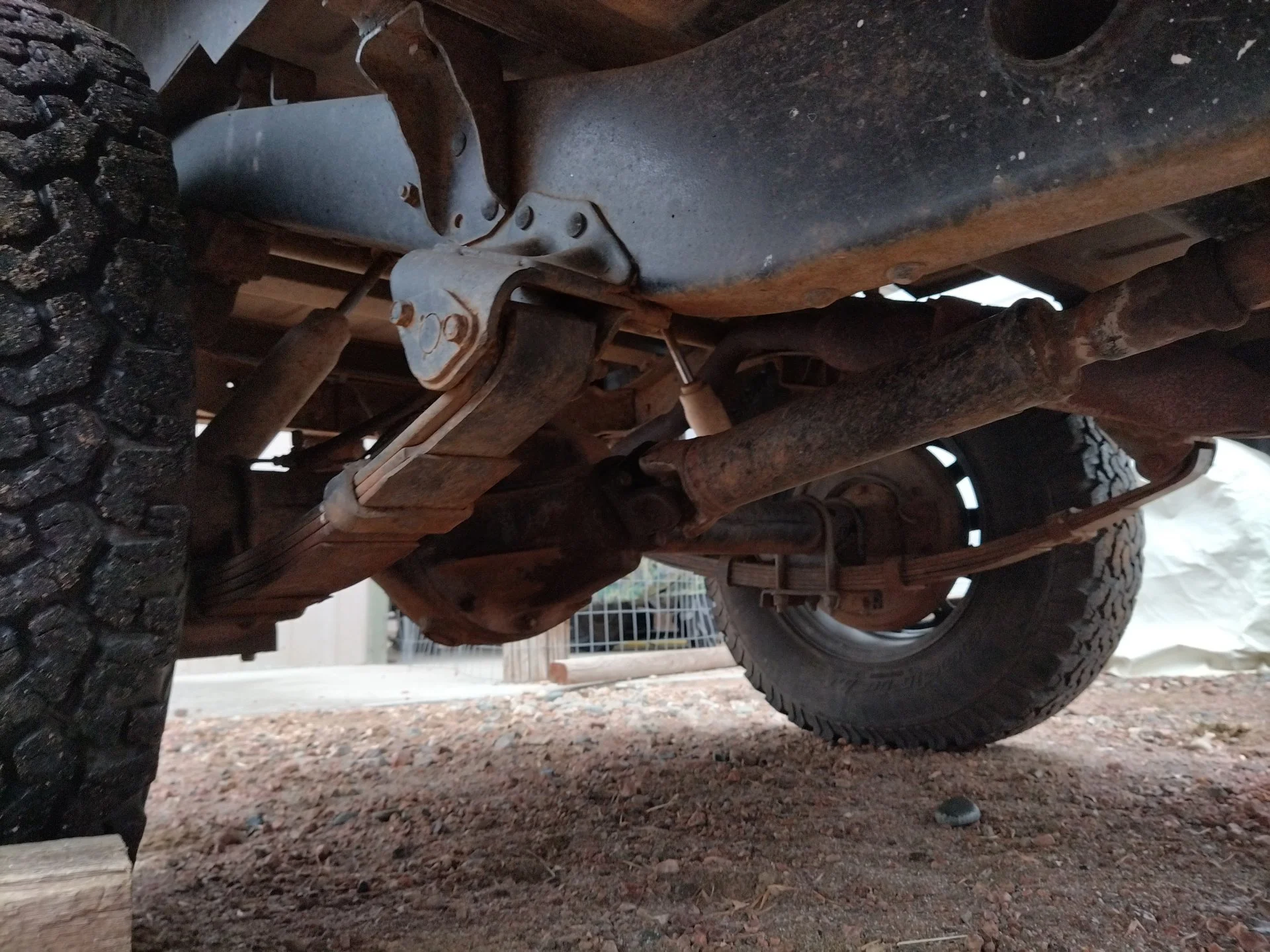

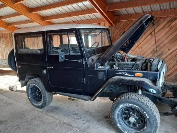

Looked at this truck last night. Here are a few more pictures. Not sure I'm interested.
- Hood not original
- Owner knew very little about the vehicle or its history
- Front end body panel alignment issues and signs of Bondo work
- Oil spitting out of exhaust.. (Thoughts on this one????) Possible head gasket???
I'm researching buying my first one, so take my opinion with a grain of salt, but:
TBH, the underside doesn't look that bad, imo.
The black goo spitting from the exhaust is pretty normal on start up. May just be rich mixture or even a little bit of worn valve seals. All my carbureted cars do this.
A bad head gasket would be white smoke and smell like antifreeze.
A skim coat of bondo is normal at a bunch of repainting shops; did you try a kitchen magnet against the suspect areas?
I'm not super familiar with FJ40s, but I think panel misalignment is pretty common and correctable. I know on an FJ55, panel misalignment came standard. ;)

Grab a fork. That sucker is done. Honestly it all depends on the price. I often buy these and the seller didn’t know what he was getting into and knows even less about the vehicle. If it’s over 7500 I would walk away.

I agree.. thanks for the input. Seller is pretty firm at $12,500.
Also forgot to mention; pulled a spark plug and it was quite fouled for looking like a newer plug. Between that and the oil from the exhaust (was both oil and wet carbon).....
I think I'm out on this one.
