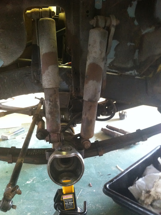

Front axle is torn down, and the parts are cleaned. I had the easiest time seperating all the birfields from the axle. I did not have the required pipe or a bench vise, so I improvised and use a piece of 90 degree steel stock. I held the axle against the inside of the stock and slammed it on the ground, off came the Birfiled lickity split. I did six of them in about 5 minutes.
Here are the cleaned up parts awaiting a delivery from Cruiser Outiftters of Utah, Thanks Kurt.
Here is the pile of spare crap left over from collecting too many parts after finding the donor axle to be less than adequate.

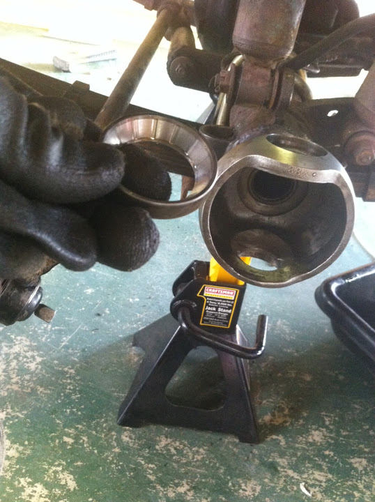

Btw is this the result of getting the preload wrong? I am really glad I decided to rebuild the front birfields. All new bearings are also on order from Kurt.

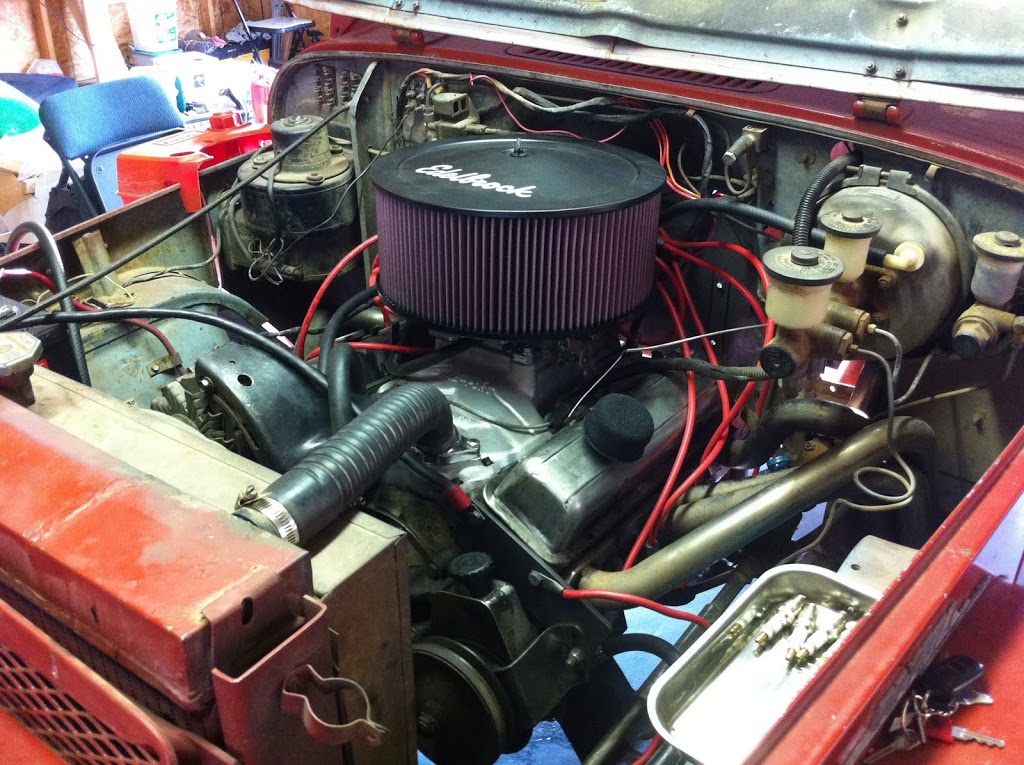

I went from this
to this
Unfortunately I had to remove the hood support bar to get the air cleaner to fit with the hood closed. It didn't seem necessary anyway, as the hood can just be leaned on the windshield for access to the engine compartment.

How much space is there between your valve covers and the firewall? It looks tight... Which may lead to overheating problems.
I'd recommend 3" or so... https://forum.ih8mud.com/40-55-series-tech/448066-sbc-swap-manual-steering-2.html
In my case, 3.5" would have made the front and rear driveshafts interchangeable... Changing the #5 plug, maybe not so possible though.:D
Bikersmurf, the passenger side valve cover is almost touching the firewall. I will not be addressing that anytime soon, though it does weigh on my mind. (after reading some of your thread, I think Isee why the engine is so far back though, I have no heater issues witht he shifting levers.) The SBC install was done in the 80's by my stepfather. It has worked fine in the passing years, so I plan to concern myself with more pressing matters like the never rebuilt front axle. The races were all in sorry shape.
congrats on starting up the build again. A couple of things:
There appears to be fuse holders on the firewall on the PS and they are not stock,
The blinkers should be removed and replaced back on the fenders where they belong imho.
Not sure if that shroud is going to function as you want it but cant see the other side to see how close it is to the fan and how far back it goes.
Lastly, get some supports for those plug wires, they will melt pretty easily on the headers.....
