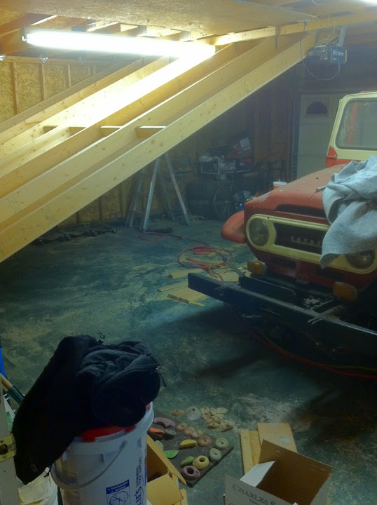

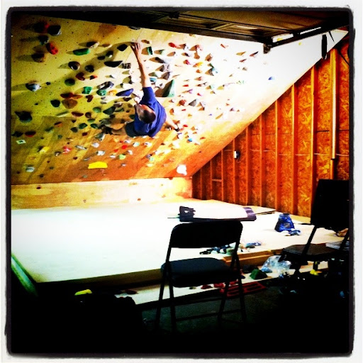

So what is the first thing you do when starting a Cruiser project? Build a climbing wall of course.
Which as you can see is quite steep.

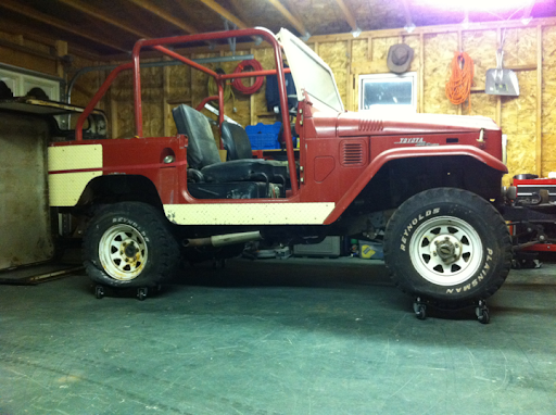

Second order of business, flip the bezel
Once the bezel is righted, whats next?

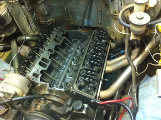

So we should probably address the engine. This Cruiser has a 350 Chevy in it, with unknown engine modifications.
The New HEI is in place to make sure the firewall would allow it to be there. Fortunately it fits.
I was told it has an RV cam in it for Torque, and the intake is an Offenhauser Dual Port which is paired with a Eldelbrock Carb. I unfortunately broke off a bolt head trying to assess the thermostat. Thus the engine got torn down more than I originally planned. At least at this stage of the project. I was extremely happy to see how clean all the valves and the interior of the engine were after an unknown amount of use and five years of sitting.
After media blasting and having a machine shop get the broken off bolt and broken off easyout the engine looks like this. BTW the Carb is fully rebuilt and the offroad kit was installed.
