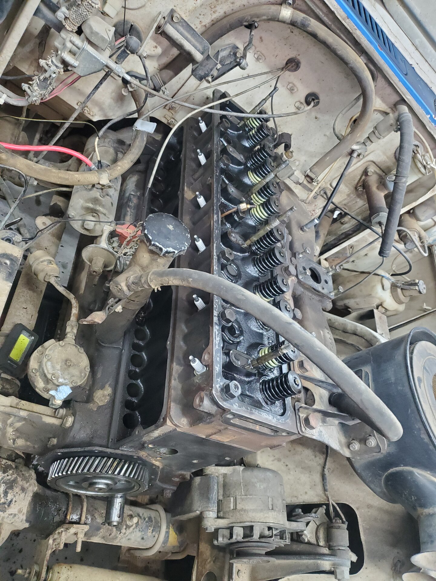

Today was productive, pulled the pushrods, lifters, rockers, fuel pump, and the cam out to reseal the front of the engine.
