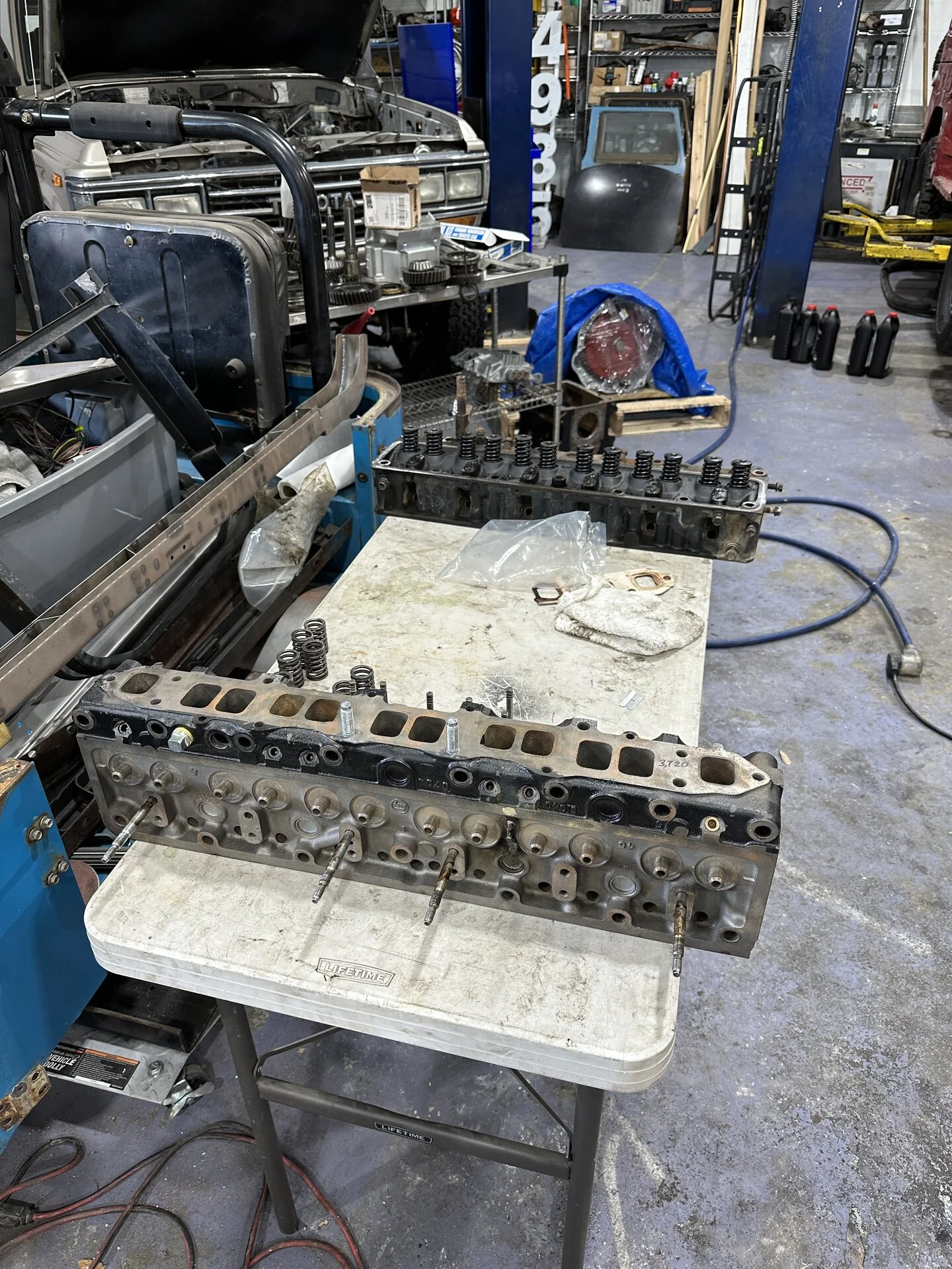

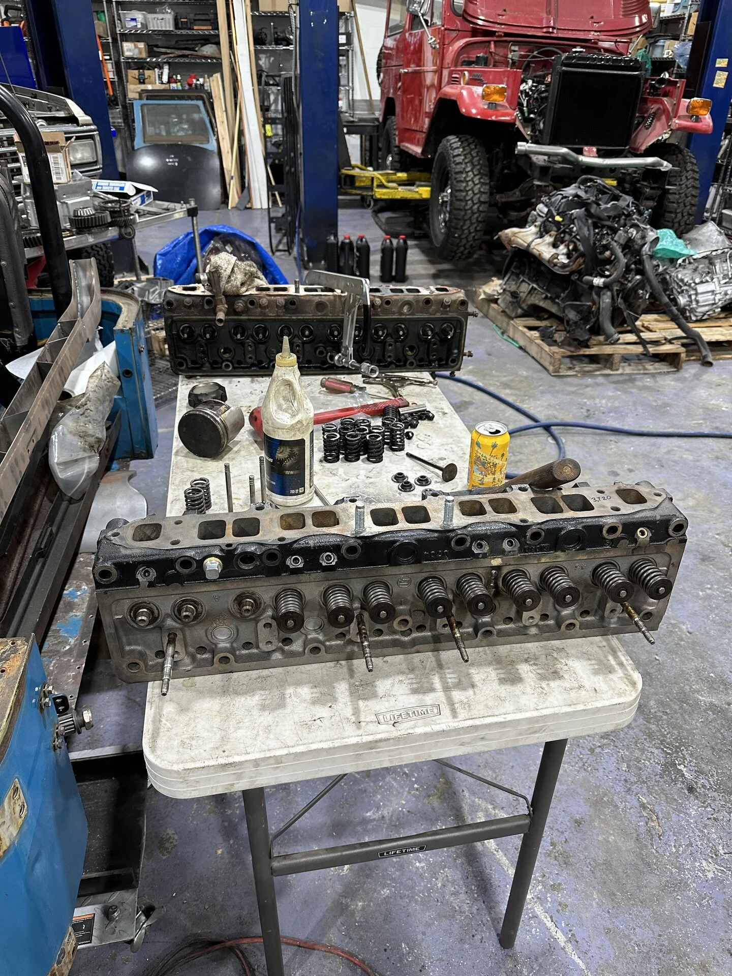

Update spent some time last night at my man Cruiser Matt’s shop last night re assembling a fresh head he had laying around. And was willing to part with. You know this guy is one awesome individual. Not only is his shop a candy store for parts but he will give you the shirt of his back to help you out. I have seen him do it for complete strangers and he does it time and time again for me. If you need anything do yourself a favor and hit him up at info@cruisermatts.Com or his website www.cruisermatts.Com.

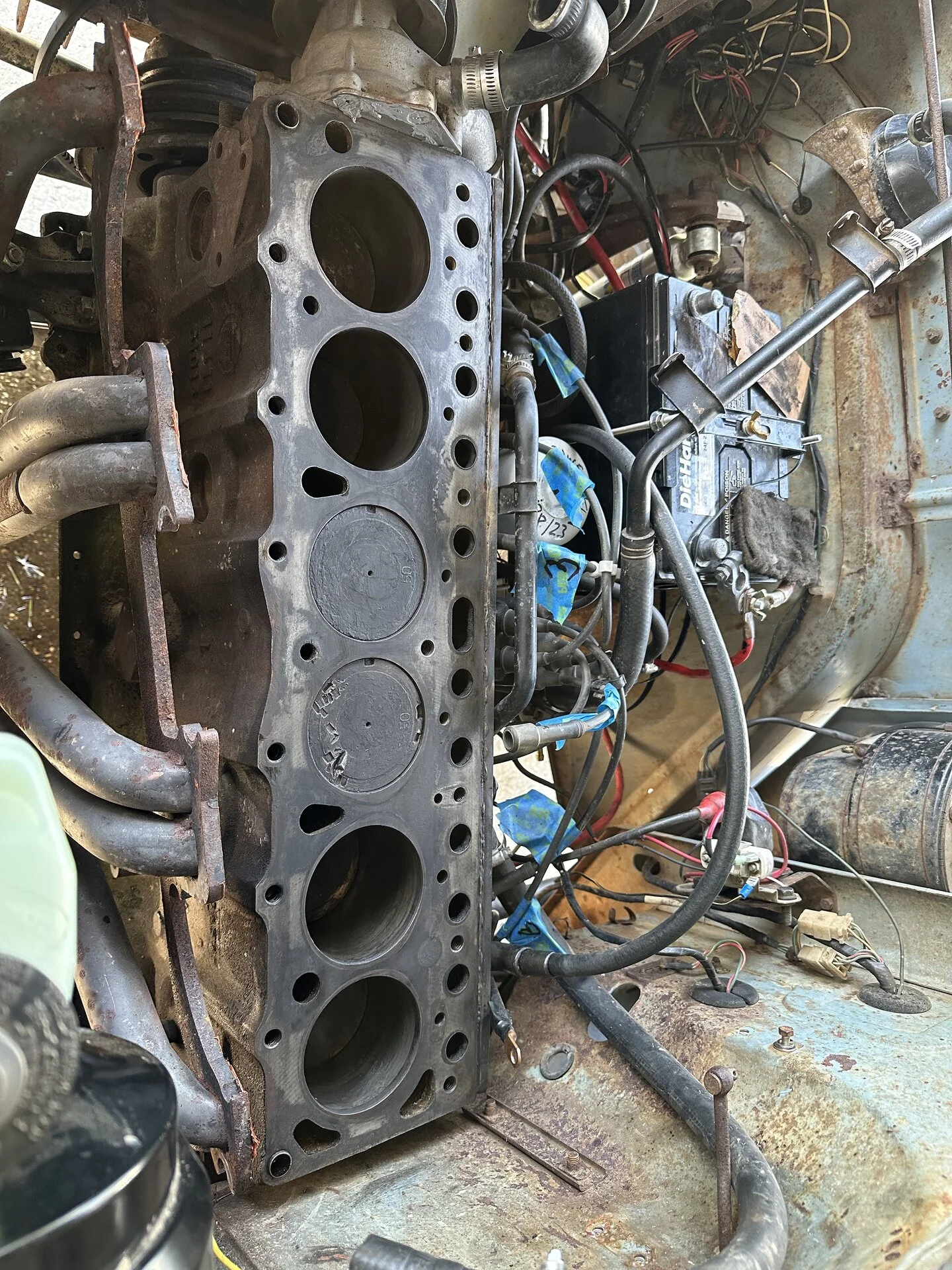

Today I spent some time cleaning my block and installed a nice head gasket from rock auto and new oil pan gasket. And mounted the head I got assembled last night. I did not change out the piston because I’m going to rebuild this motor. What I’m trying to do is get it back on the road so I can finish my LS swap on my daily.

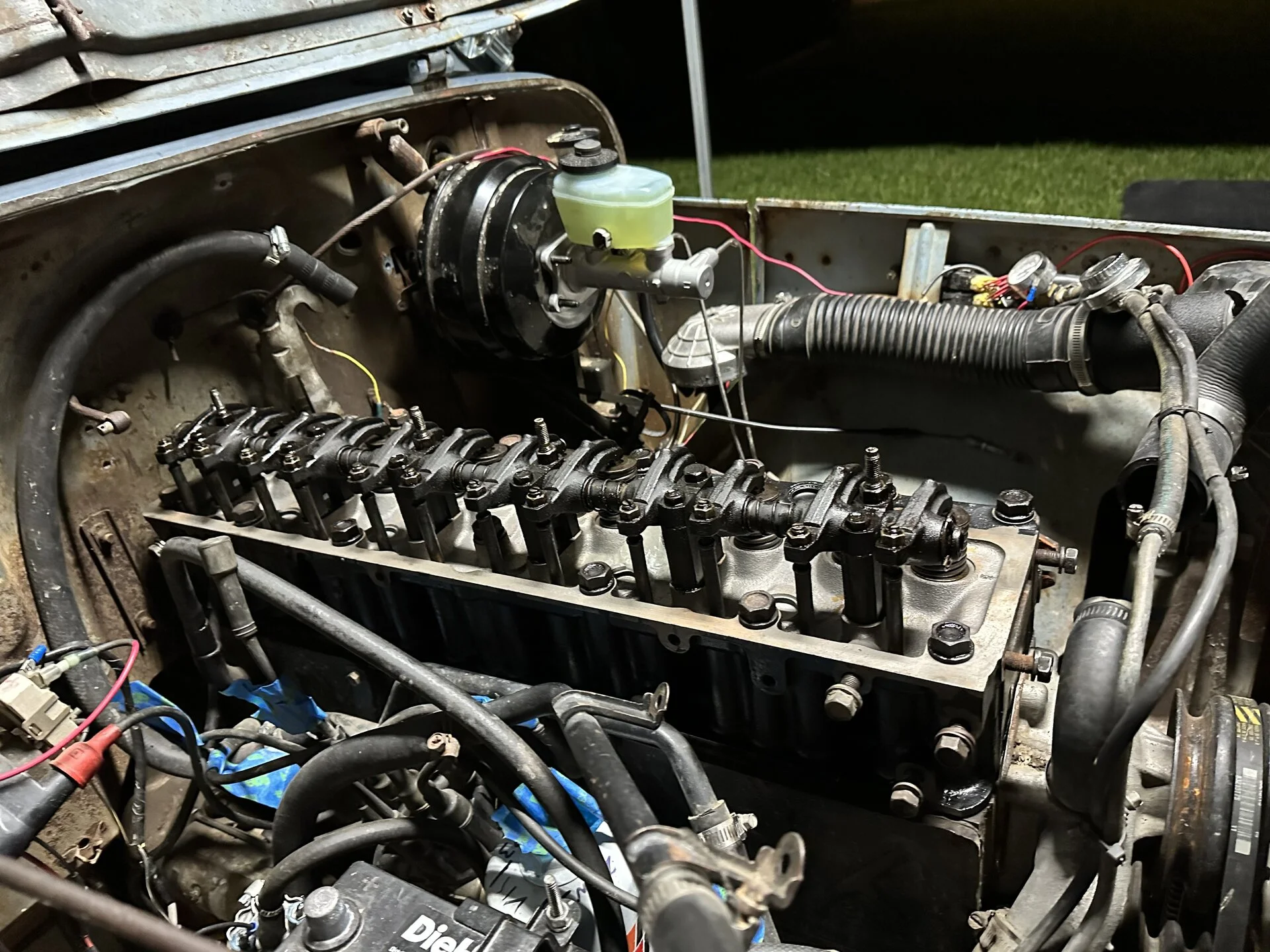

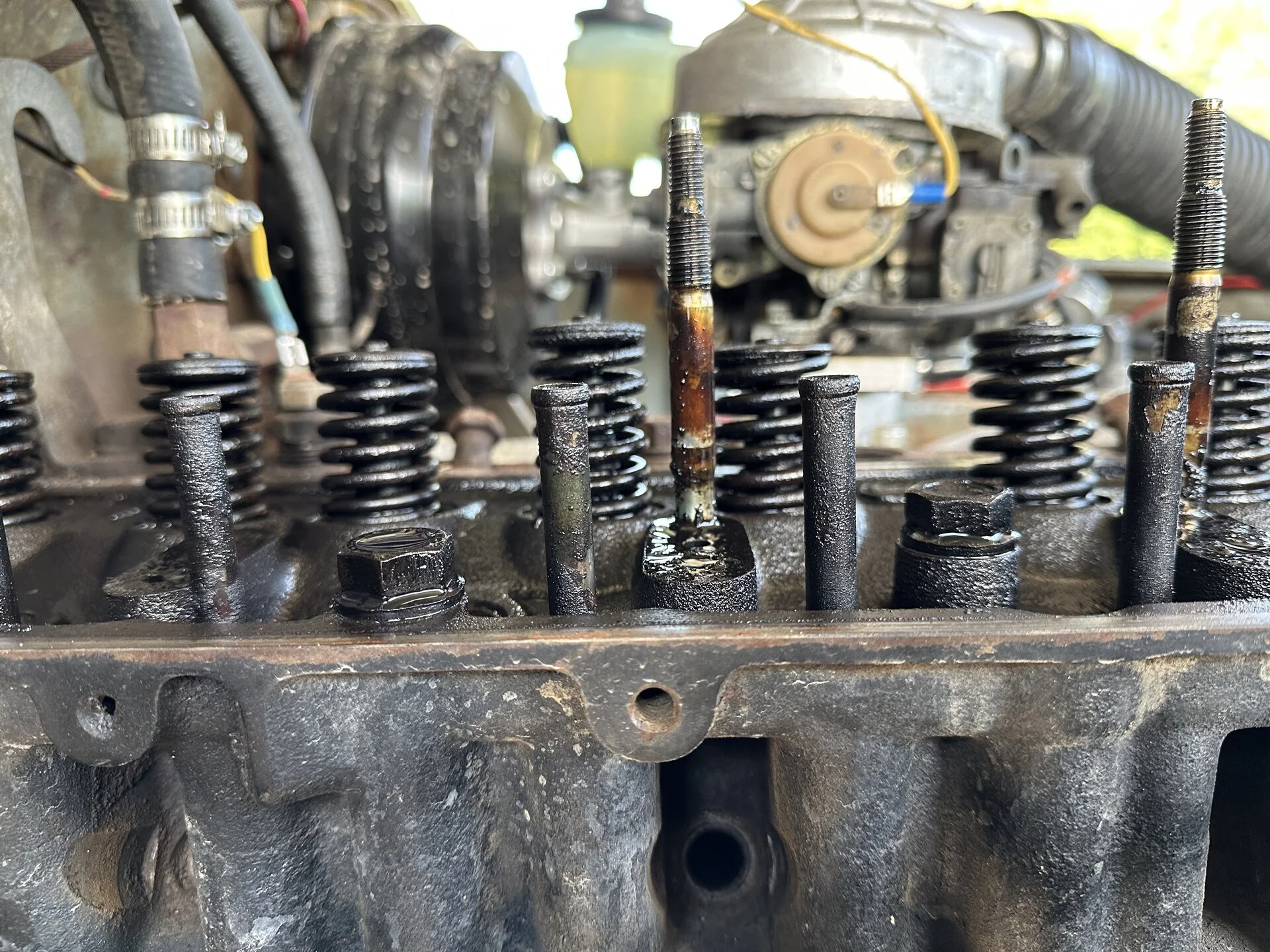

Update so I looked at the top of the pistons some are oily so are dry no damage. I took the rocker arm assembly off and still no change. The motor is locked up and will only rotate 180 in either direction. I pulled the push rods all look normal. So the only visible thing is the Exhaust port on cylinder #4 is higher than all the rest!
- Cylinders #3 and #4 have coolant Jackets on the sides ONLY ....
- Cylinders #1 and #6 have them on three sides
- Cylinders #2 and #5 benefit from the extra stable cooling of #1 and #6
- hence why every single F1.5 and 2F i have ever rebuilt / restored , needs Valve Seat work , New valves or Guiges or all three on #3 or #4 cylinders all the time
- this IS why that seat failed like that after 1/2 a 1,000,000k on it .....
- also , that WEBBER dumping all the added FUEL , creates well more , hotter Cumbustion Right ?
- some times MORE is TOO MUCH , Gas is one of those too much is BAD topics ........ :confused:

I except it will be fine since it was running fine before and the damage didn't occur while it was running. Which was very lucky.
We don't know though... the idea here is to just keep this thing running for a few months while we rebuild another engine the right way to be the long-term powerplant.
Hence the rockauto headgasket instead of OEM, etc

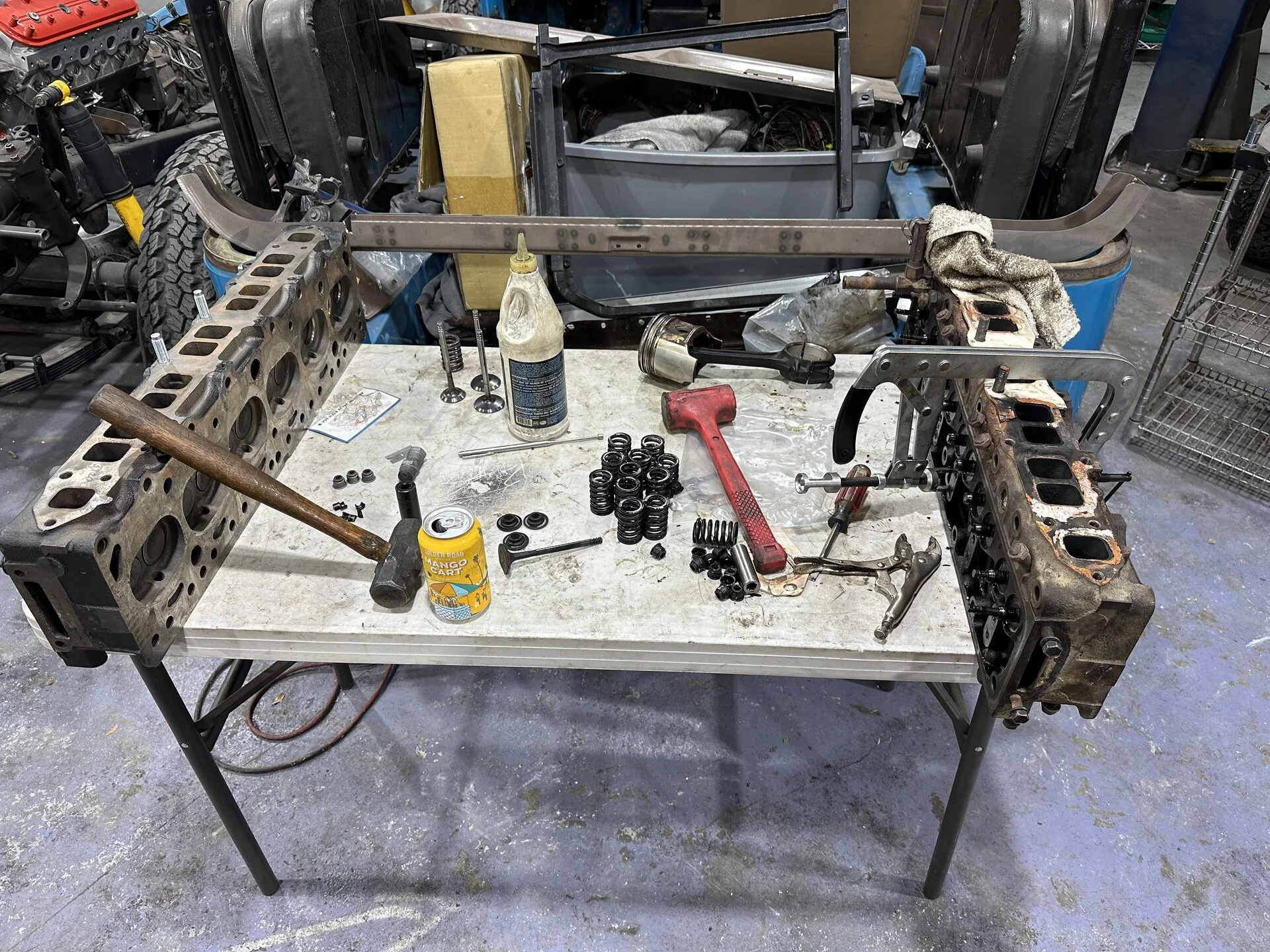

The "new" head is actually one I had fully rebuilt that ended up having a cracked coolant passage. I brazed the crack and then Austin smothered it in JB weld and hopefully it holds up
I like the “proving” you can get a nearly destroyed block, piston, and head running to get back on the road for a time! Fun project! The heck with those n’th degree rebuilds!
Oh I forgot to mention the best part I JB welded That is the best part It’s going to be fun as s*** driving it around town!
