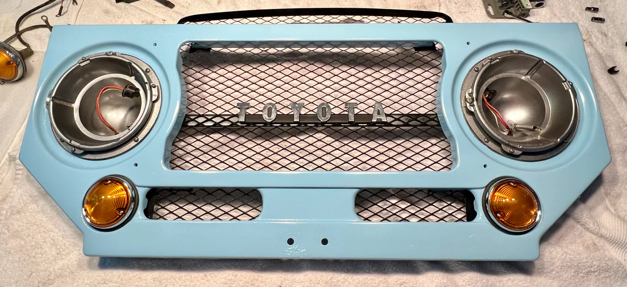

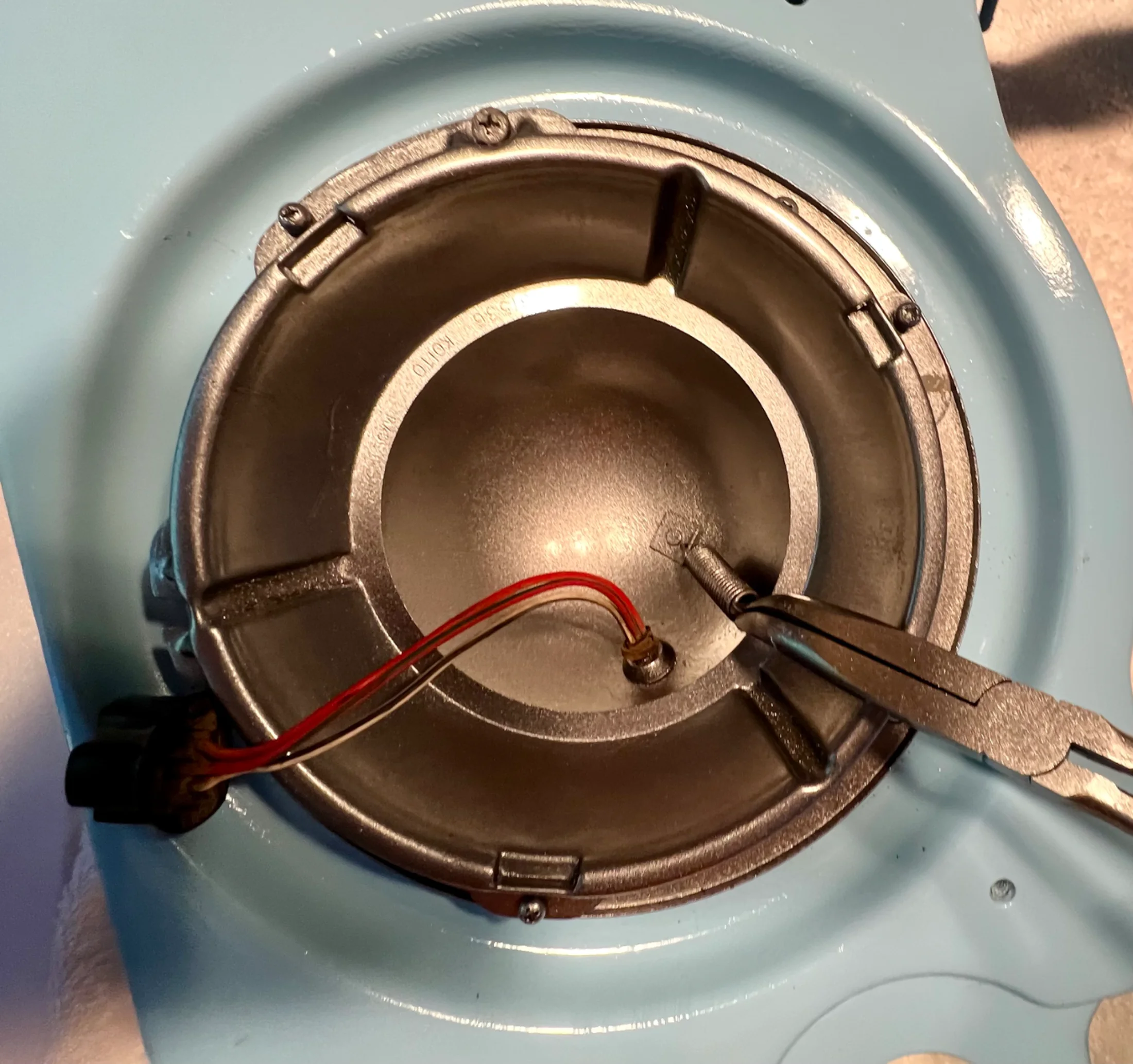

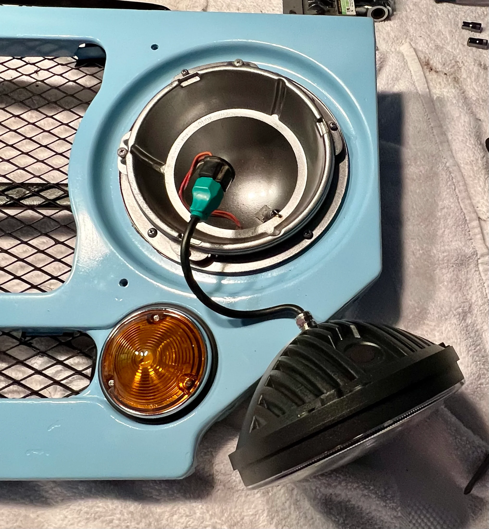

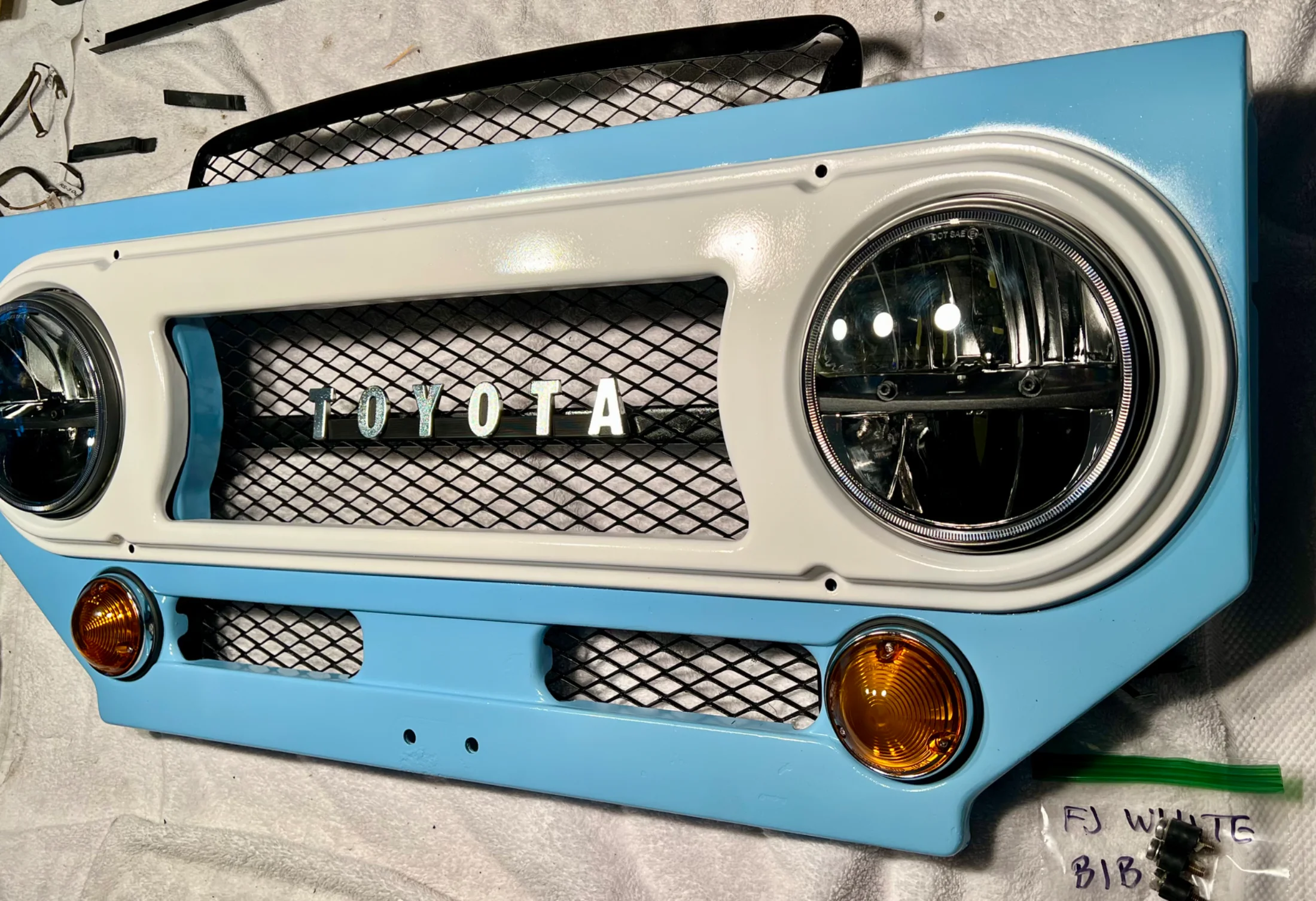

Now time to add the headlight and headlight trim retaining ring.
Notice there are 3 dents along the inner bucket edge, corresponding to the trim ring hold down screws. The headlight has embossed lugs on the back side that match up with the grooves and ensure the light is straight and right side up.
Plug in the headlight to the plug in the outer bucket, match the light lugs to the inner bucket indents, and set the headlamp in place.

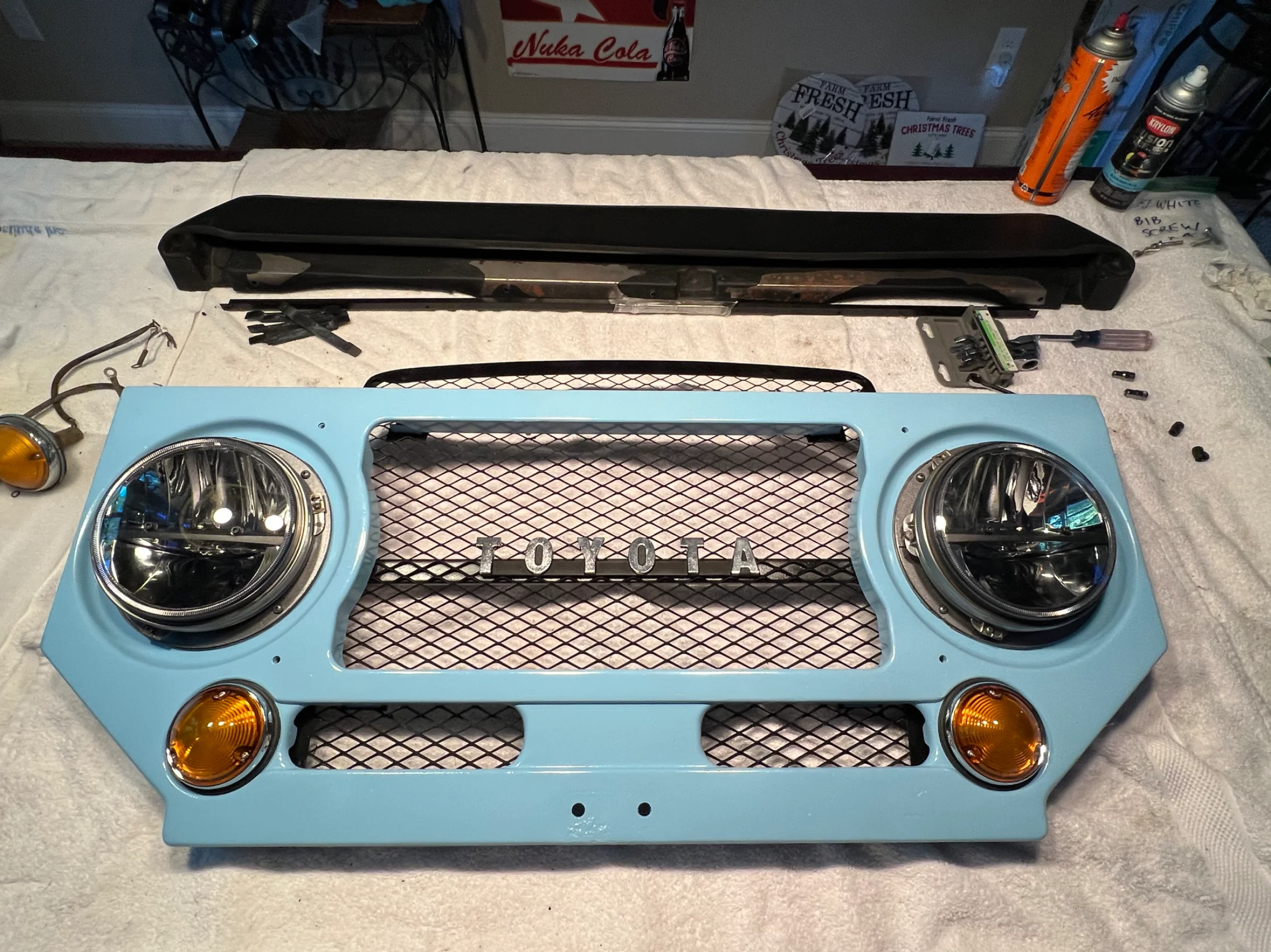

While I was putting headlights back on the bib, I also fastened the restored TOYOTA rear grill to the back. Also put the new OEM turn signal lights on.
With the new headlights in, secured by the trim rings. I bought the LED lights from City Racer LLC that have been recommended on this forum.

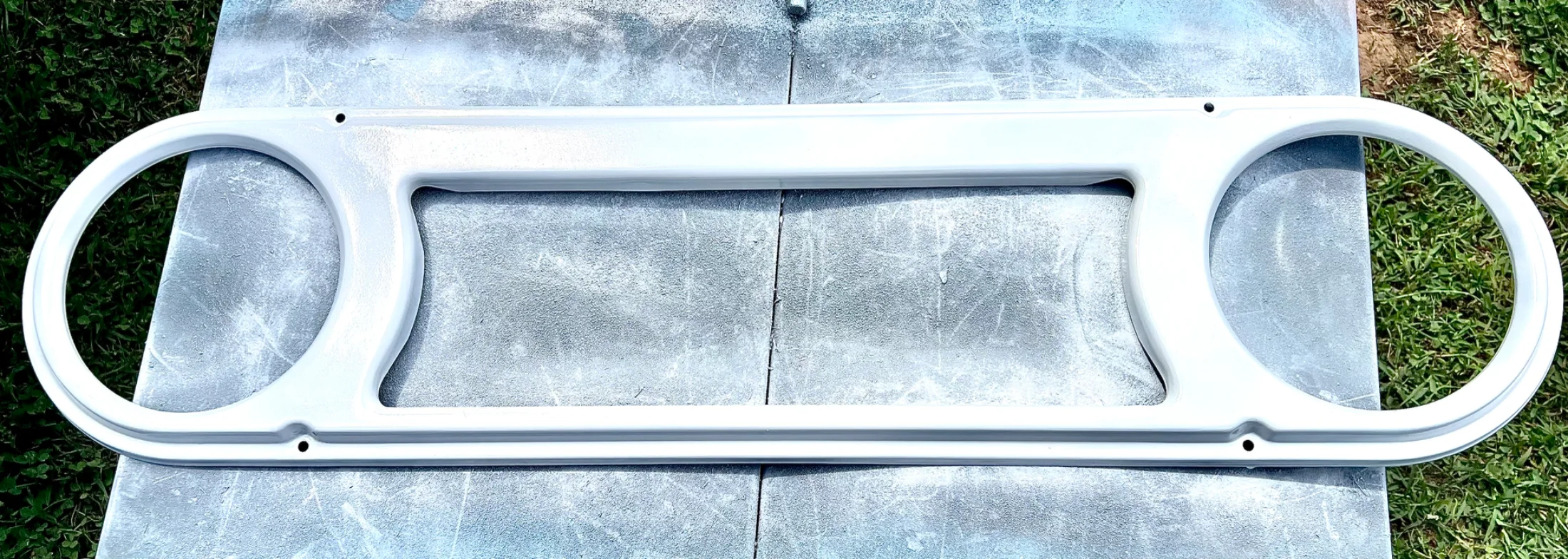

Time for the front bib grill!

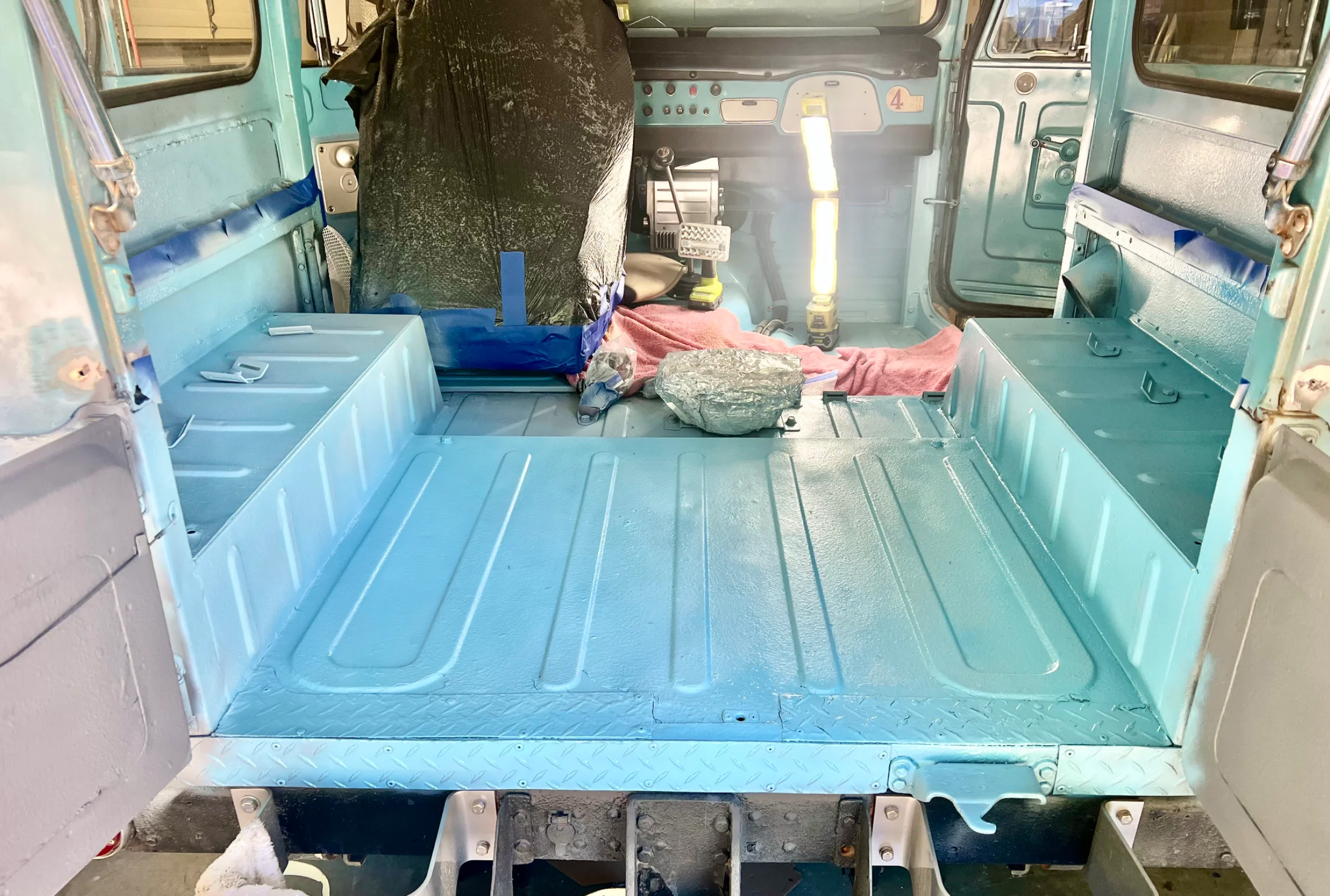

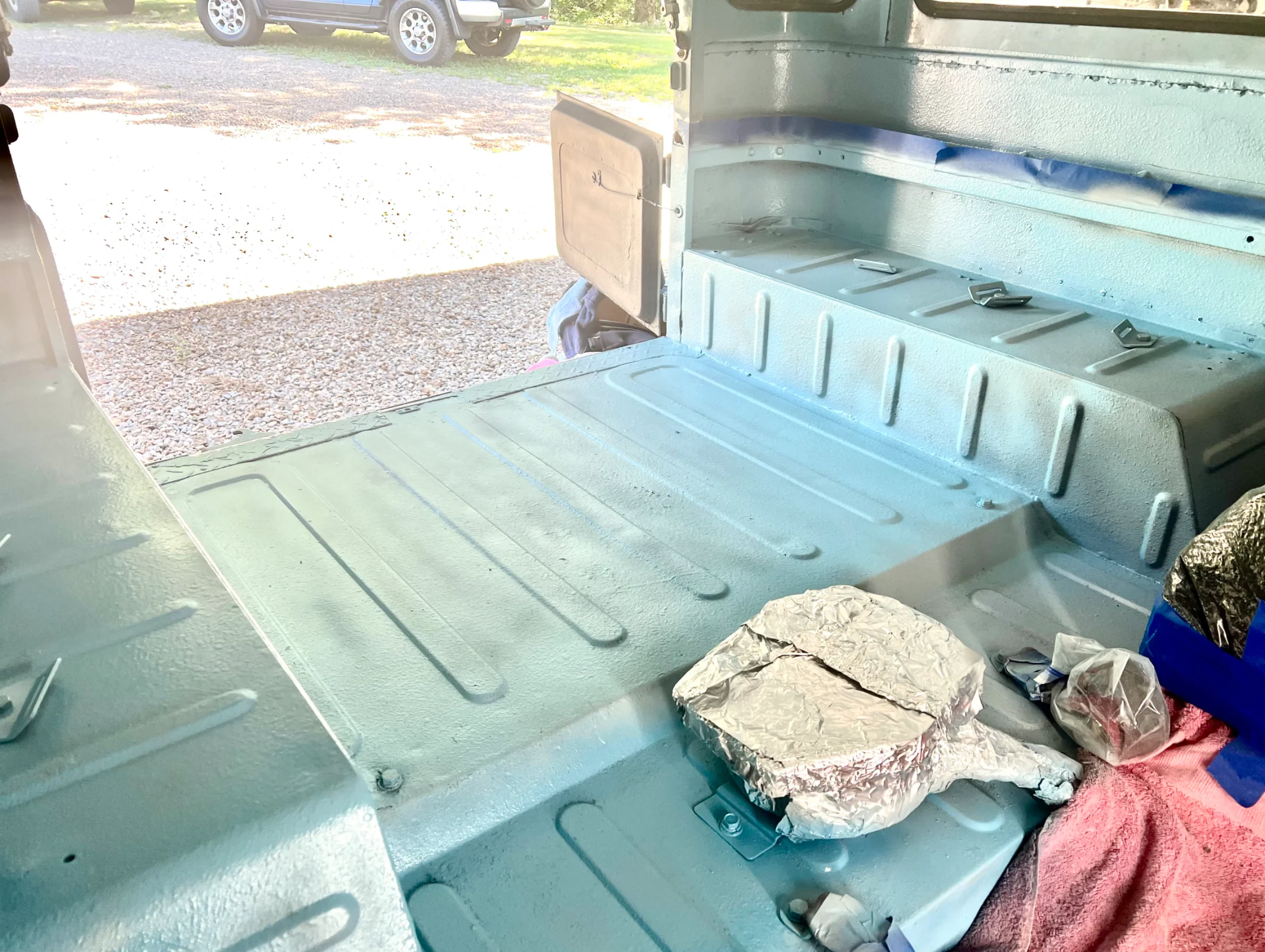

Paint Jolene’s Rear Tub and Walls

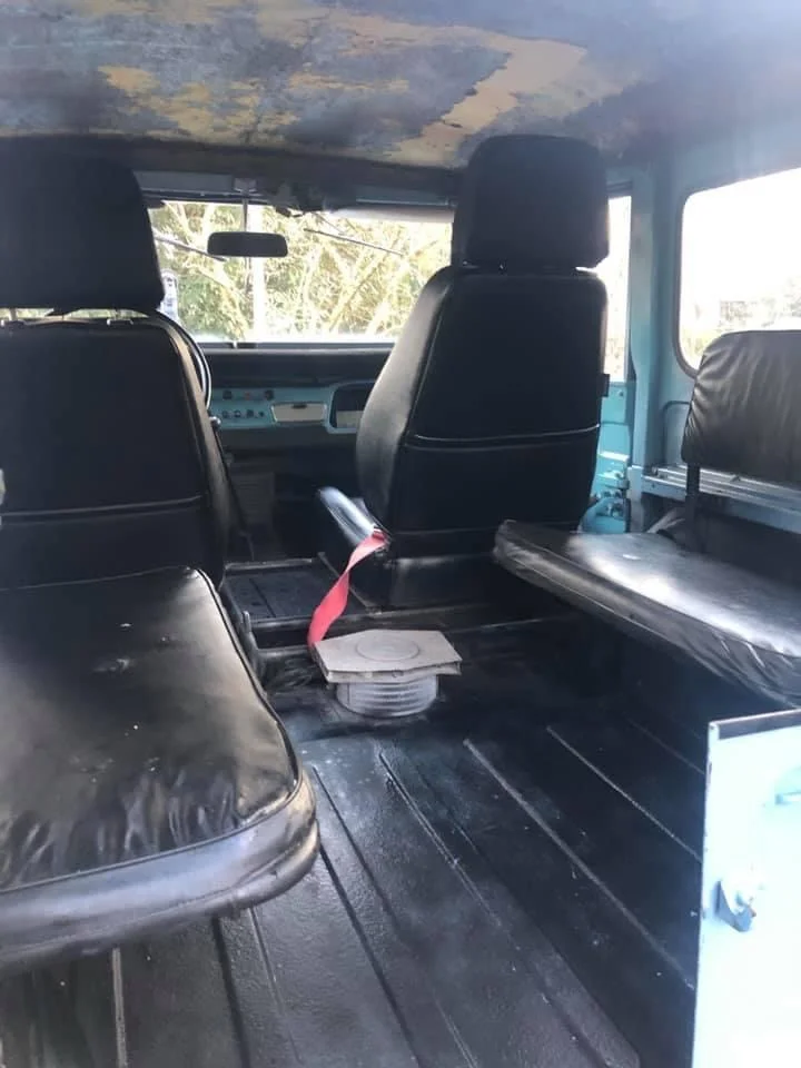

When Jolene first came home with me she had all black interior. The tub, floor pans, transmission tunnel were all black bed liner, old enough to be peeling in many places.
After pulling the gas tank and swapping in a freshly built F engine, I am gradually restoring the interior tub floors and transmission tunnel cover to a more original light blue.
The front looked good. No way I could not update the rear tub as well.
Clean, grind, sand, prime. Starting the color coat:
Slowly building up color finish… Hitting some rust areas with silver POR-15 which is an excellent primer.

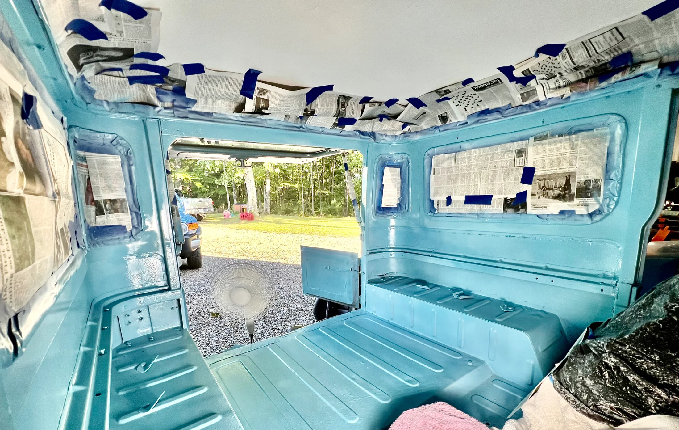

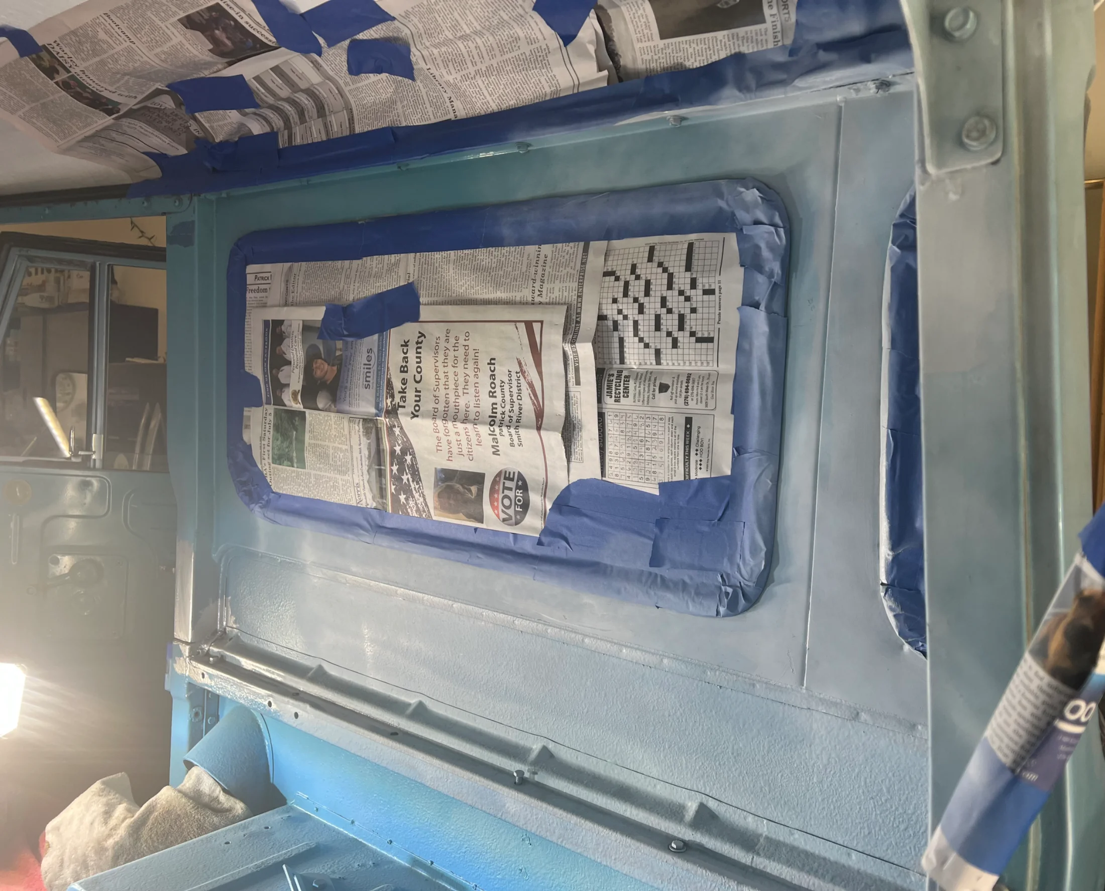

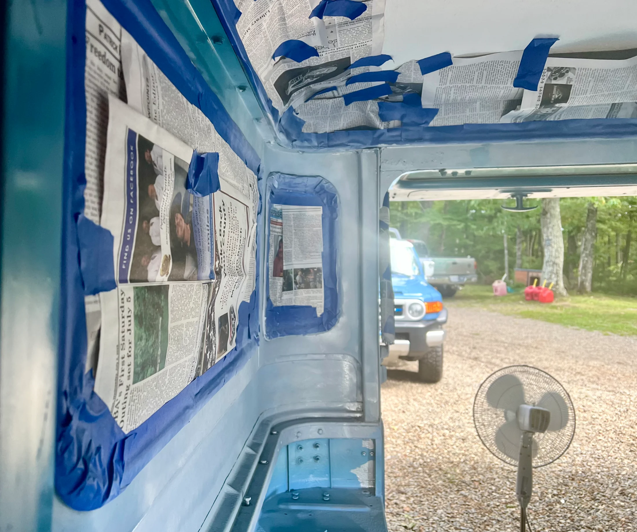

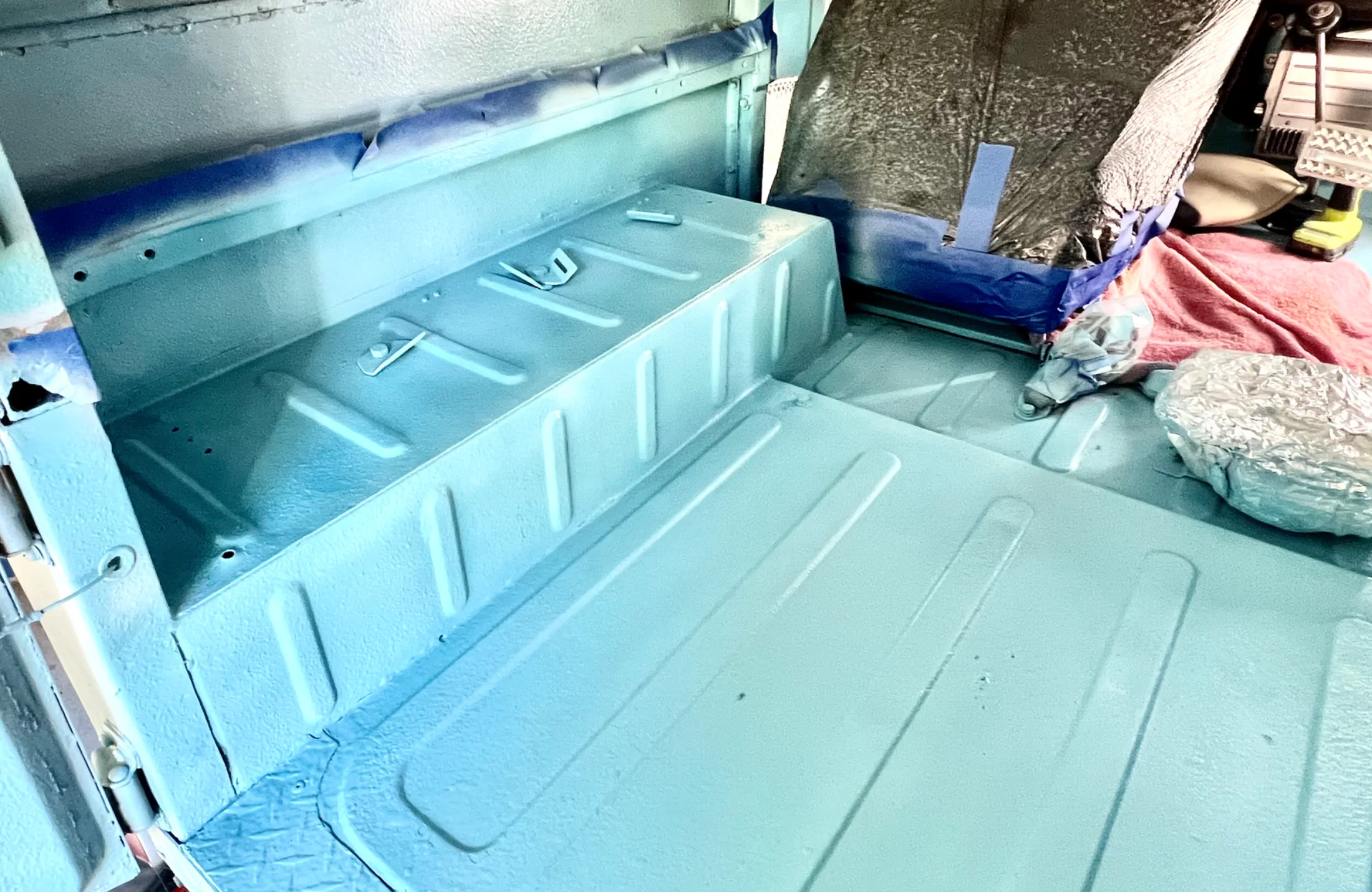

Still putting color down on the tub floor but needed to tape up the windows and walls and ceiling.
Sanded and applied POR-15 again to rust spots found. Primed and then started putting color up on the walls.

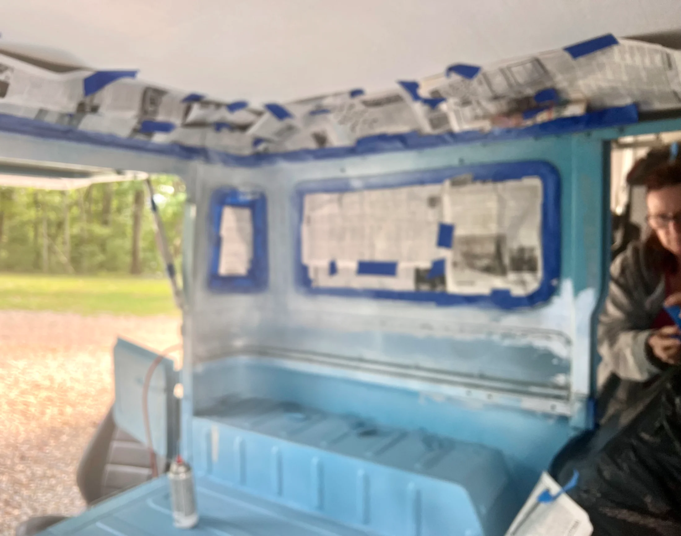

Below: my amazing assistant and prep taper hard at work.
Priming and POR’ing…
Beginning to apply color coat on walls over primer.

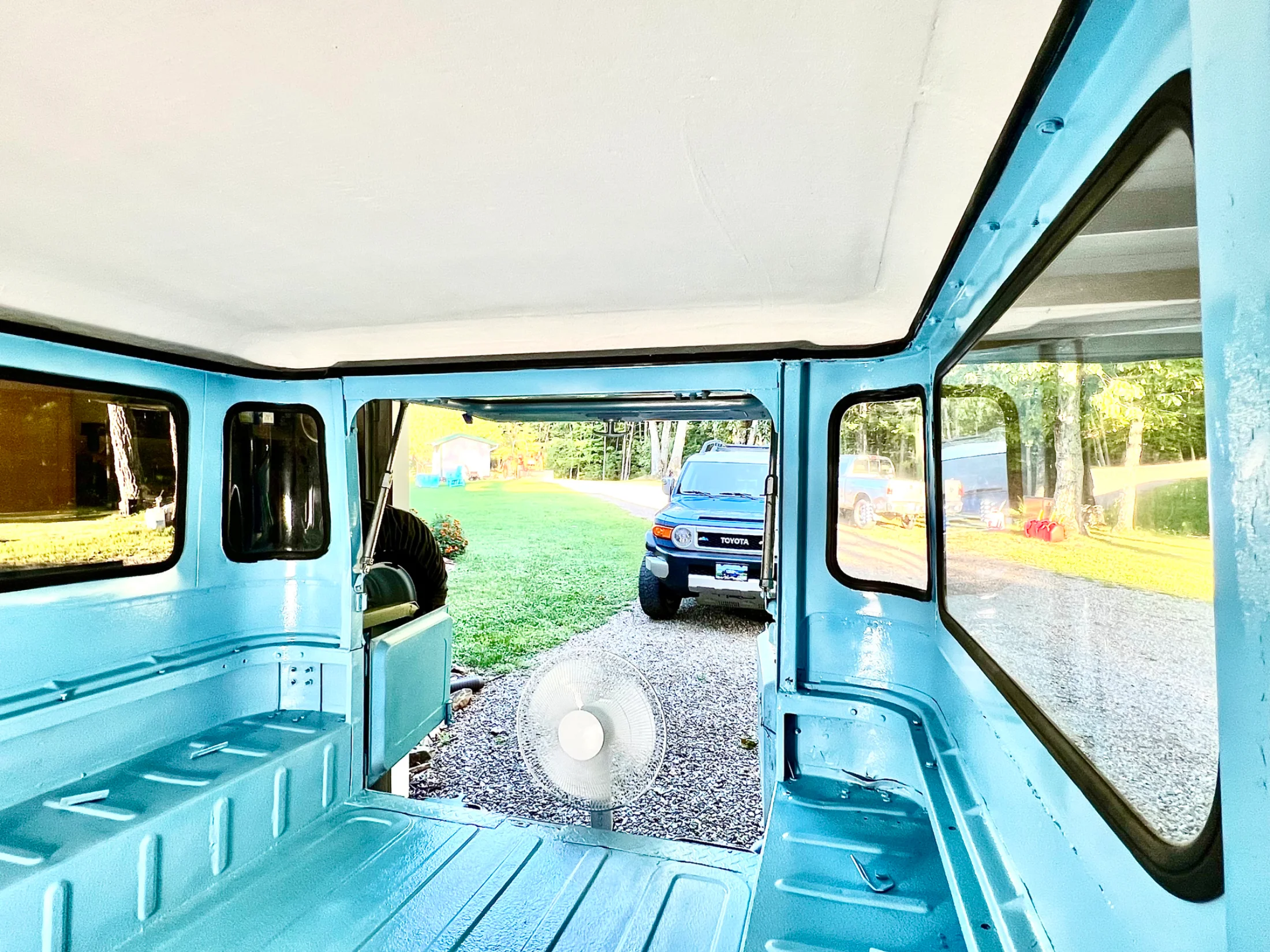

Jolene’s baby sister can’t help but peek around the corner and admire the old girl’s spiffy new interior look. Last coat of clear drying.
Color coat is done. Clear coating now.
With clear coat.
Stupid finger.

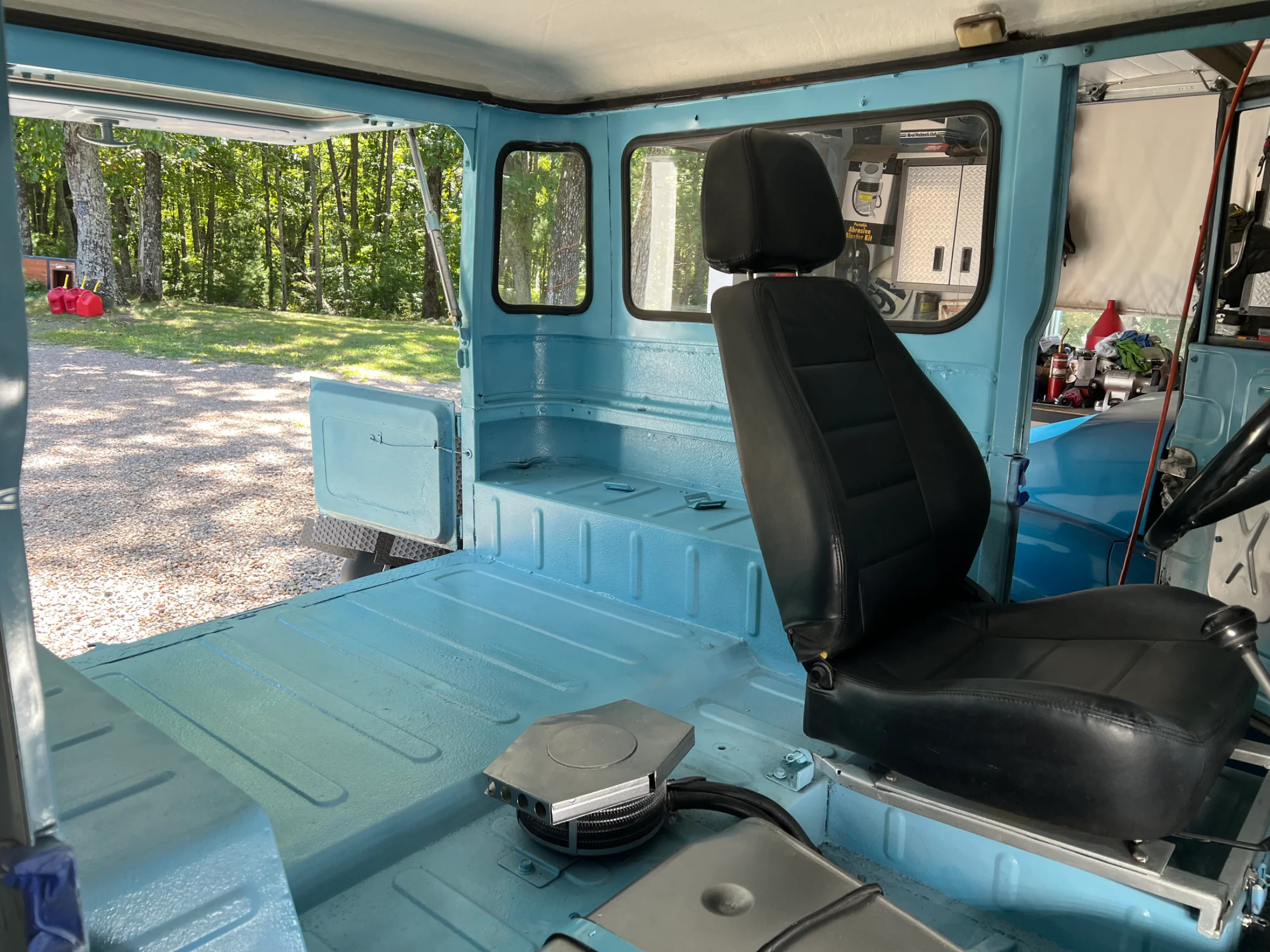

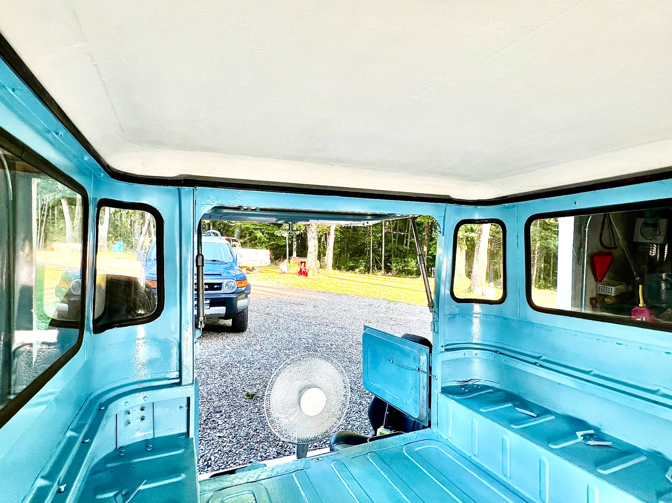

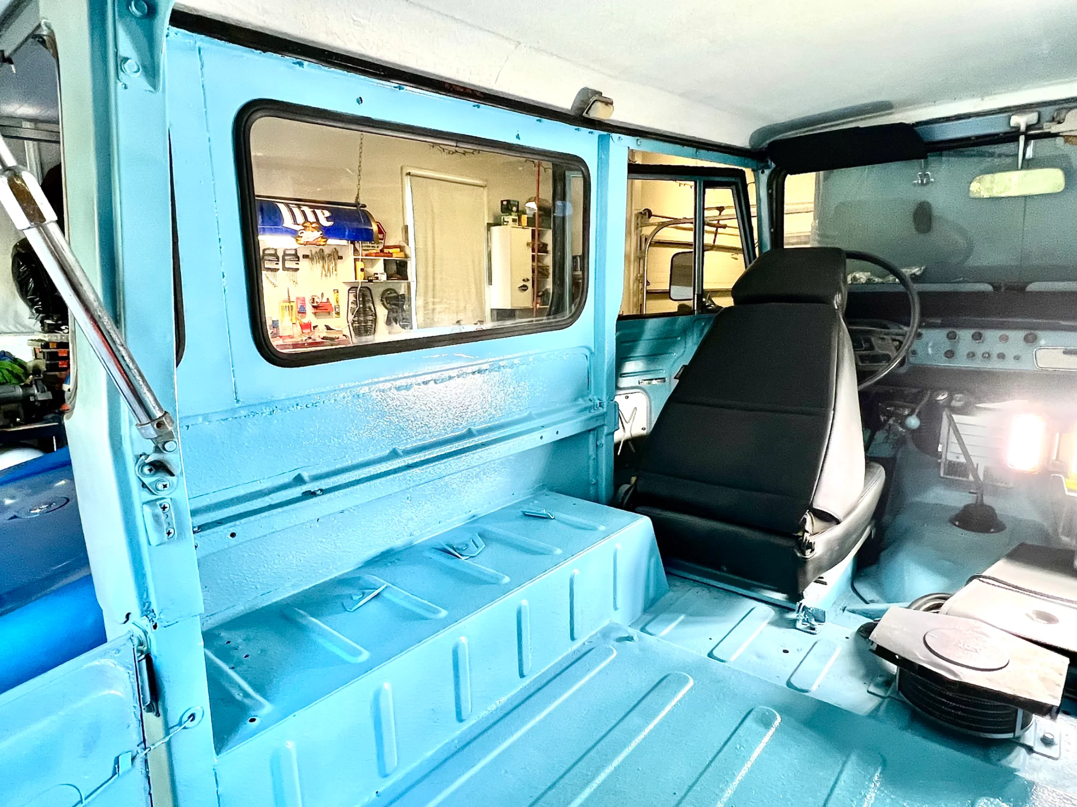

Now this is looking much better.
Say no more to the dark interior! This truck is busting out with positive energy.

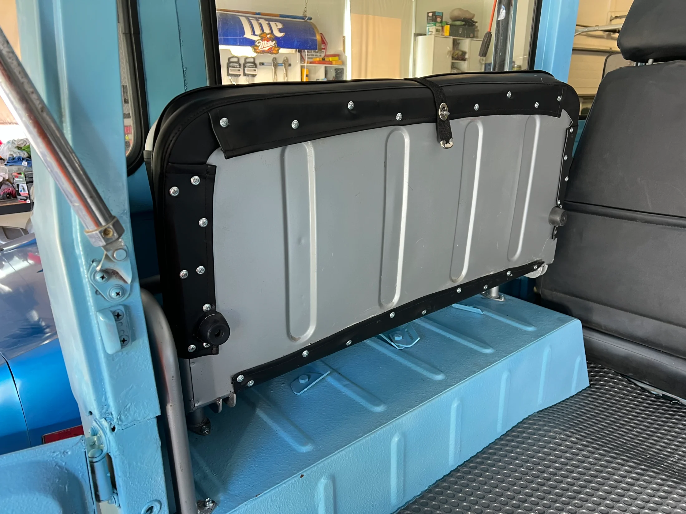

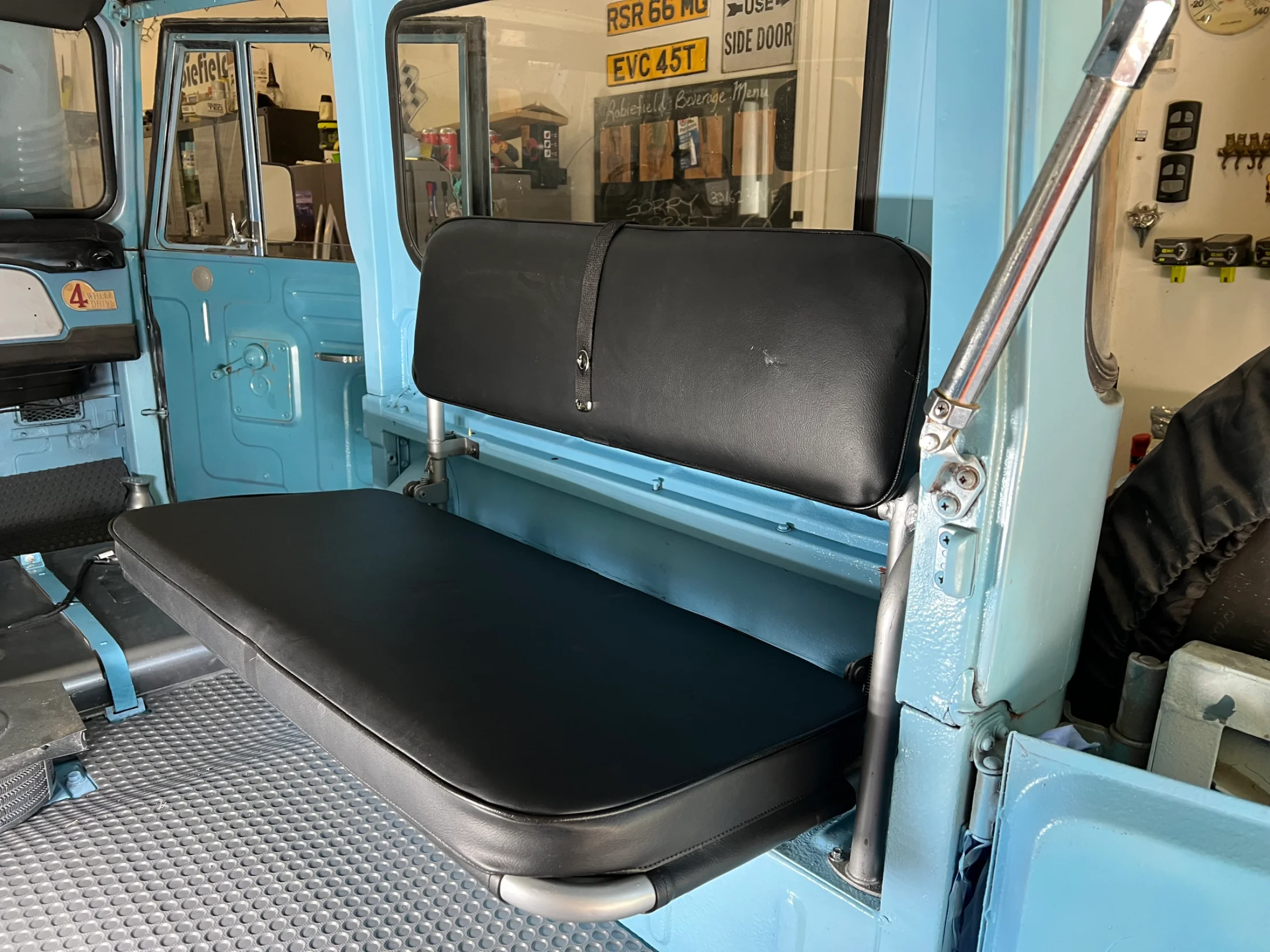

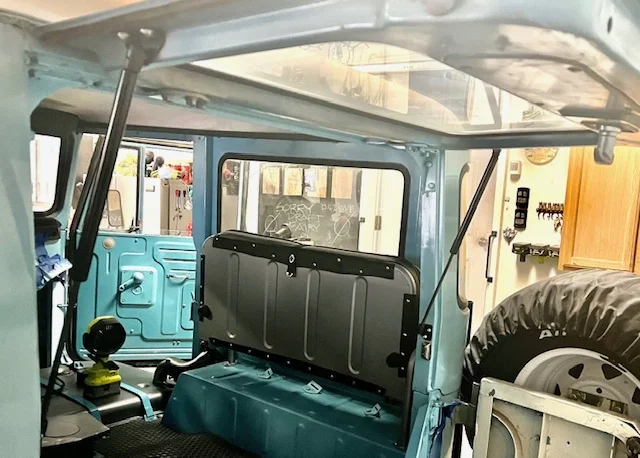

Jolene: Install Folding Rear Bench Seats

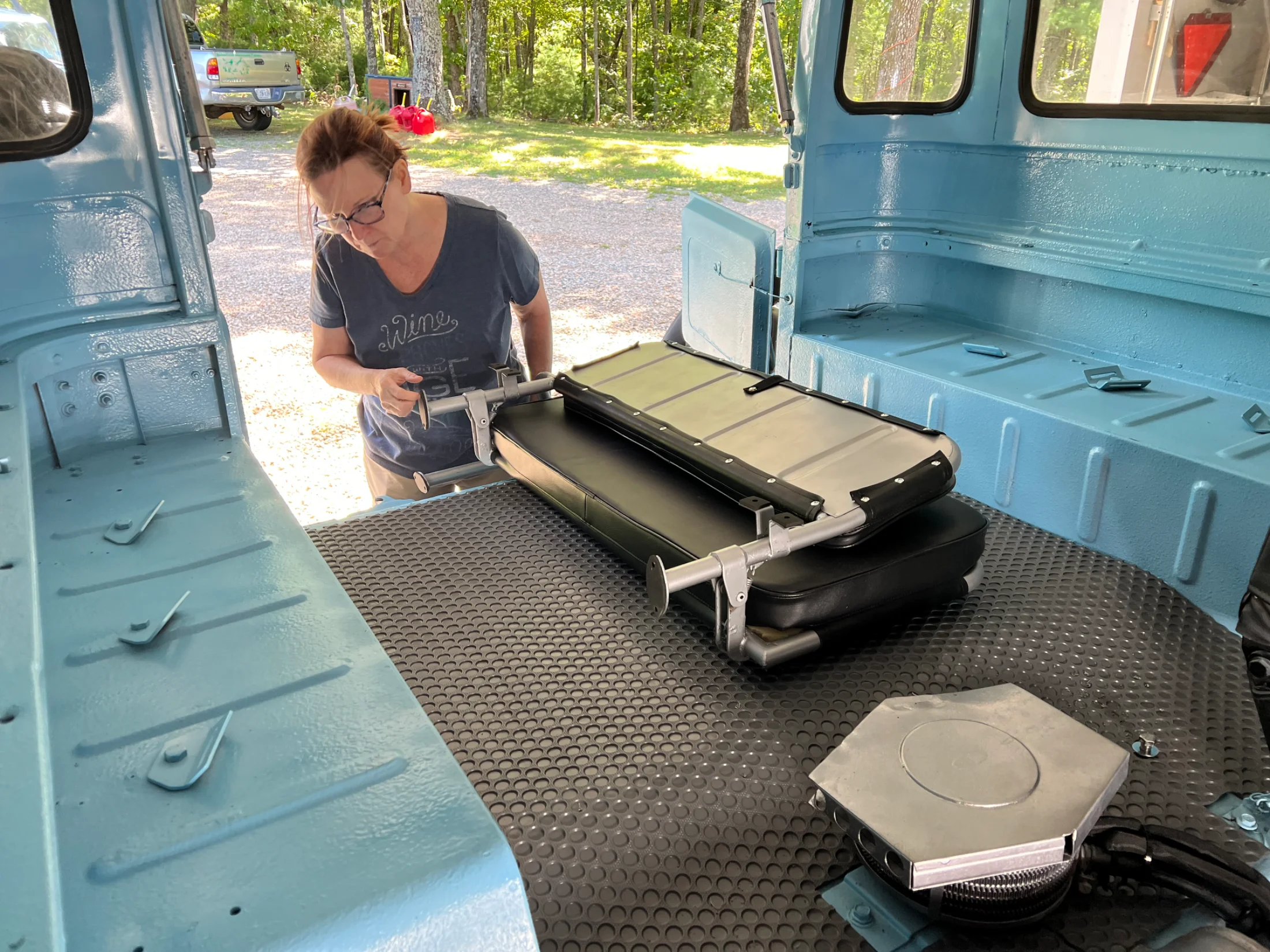

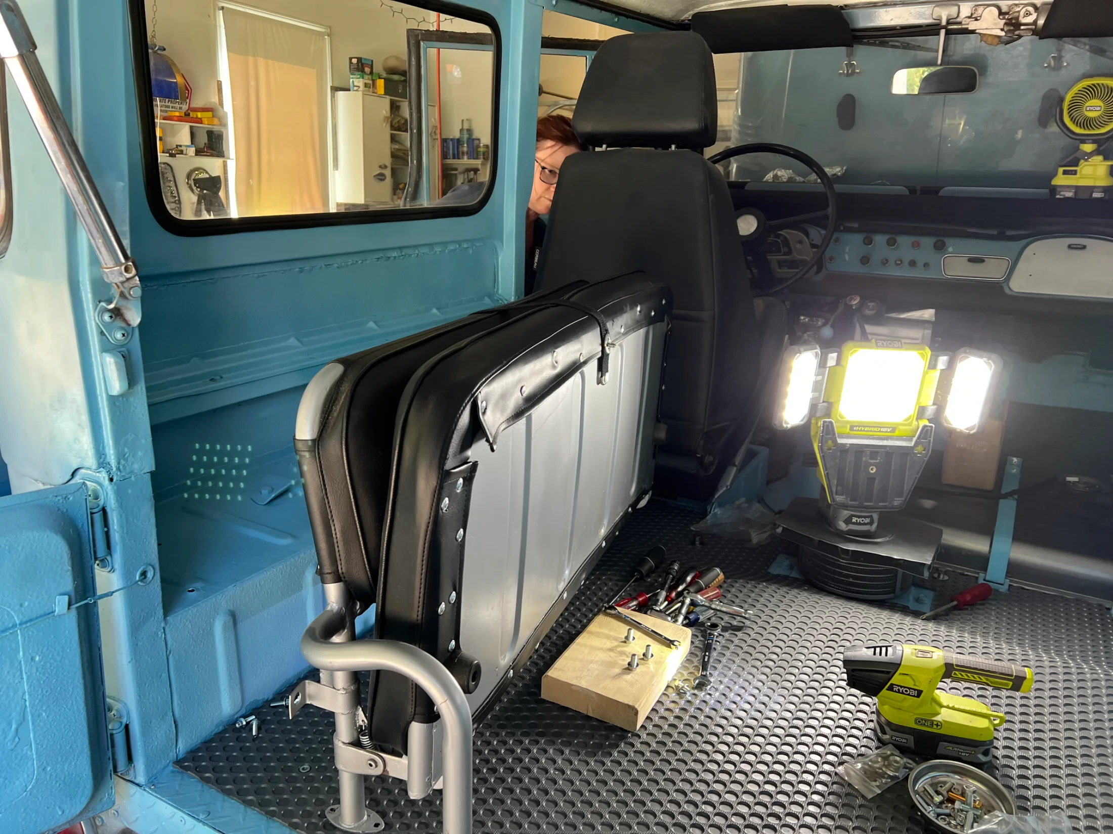

With the rear tub now painted and clear coated, time to install the folding rear jump seats.
Two winters ago I pulled them out of the truck and did a full off frame jump seats restoration. Full reupholstery. Came out nice. They sat in the basement while I was beginning the quest for a fresh built F motor. Time for them to graduate from basement back to FJ40.
It was a bit challenging to do the reinstall. The two back brackets on each seat got bent out of alignment in the hustle and bustle of basement life. When we threaded the foot bolts through the floor first, the back brackets weren’t even close. When we threaded the back brackets first, the foot bolts weren’t even close. Eventually I straightened the back brackets and once properly straightened, both the back brackets and the bench feet holes lined up very closely.
Through practice, the best way to reinstall the jump seats is:
1) Straighten back brackets on the jump seats.

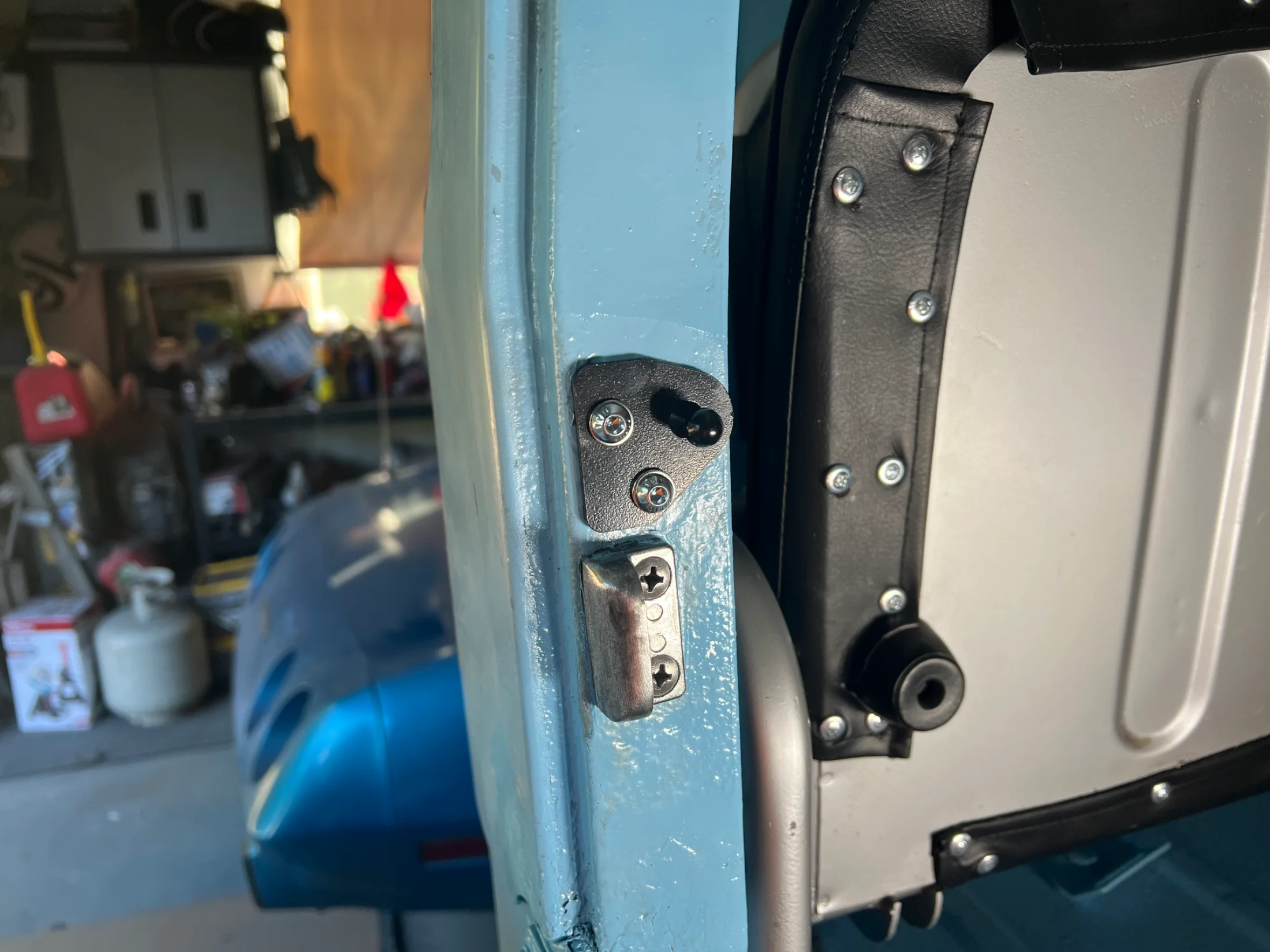

2) With jump seat partly open, loosely attach the 2 M8 1.25 x 30 bolts for each back bracket into the tub wall. Two bolts per bracket, four bolts per bench.
3) Use a small Philips head screwdriver or Allen key and insert through one of the two holes in each of the 3 bench feet. Do one foot at a time. Wiggle the bench so the foot holes are close enough to the fender holes to work the aligning key tool in. The key should go through the both the foot hole and the tub fender hole. You can wiggle the tool in the bolt hole until the other foot hole lines up just right with the fender well hole. Put an M6 x 1.25 x 30 bolt through each open hole on each foot. After 1 bolt is in all 3 feet, remove the tools from each of the 3 feet one at a time, replacing them with M6 bolts.
4) Tighten the 4 bracket bolts. Easiest to do with the seat partway unfolded.
5) Thread washer / split washer / M6 nut from under the fender well onto each of the 6 M6 bolts securing the bench feet to the fender. With a partner, tighten the 6 M6 bolts.
6) Open close the seat with all tightened bolts and check for possible interference between the bottom seat and any seat belt anchors remaining on the fender well beneath the seat. If necessary loosen the seat belt anchor bolts and rotate the belt anchors until there is free movement clearance between the seats and the belt anchors.
Repeat for the second jump seat.

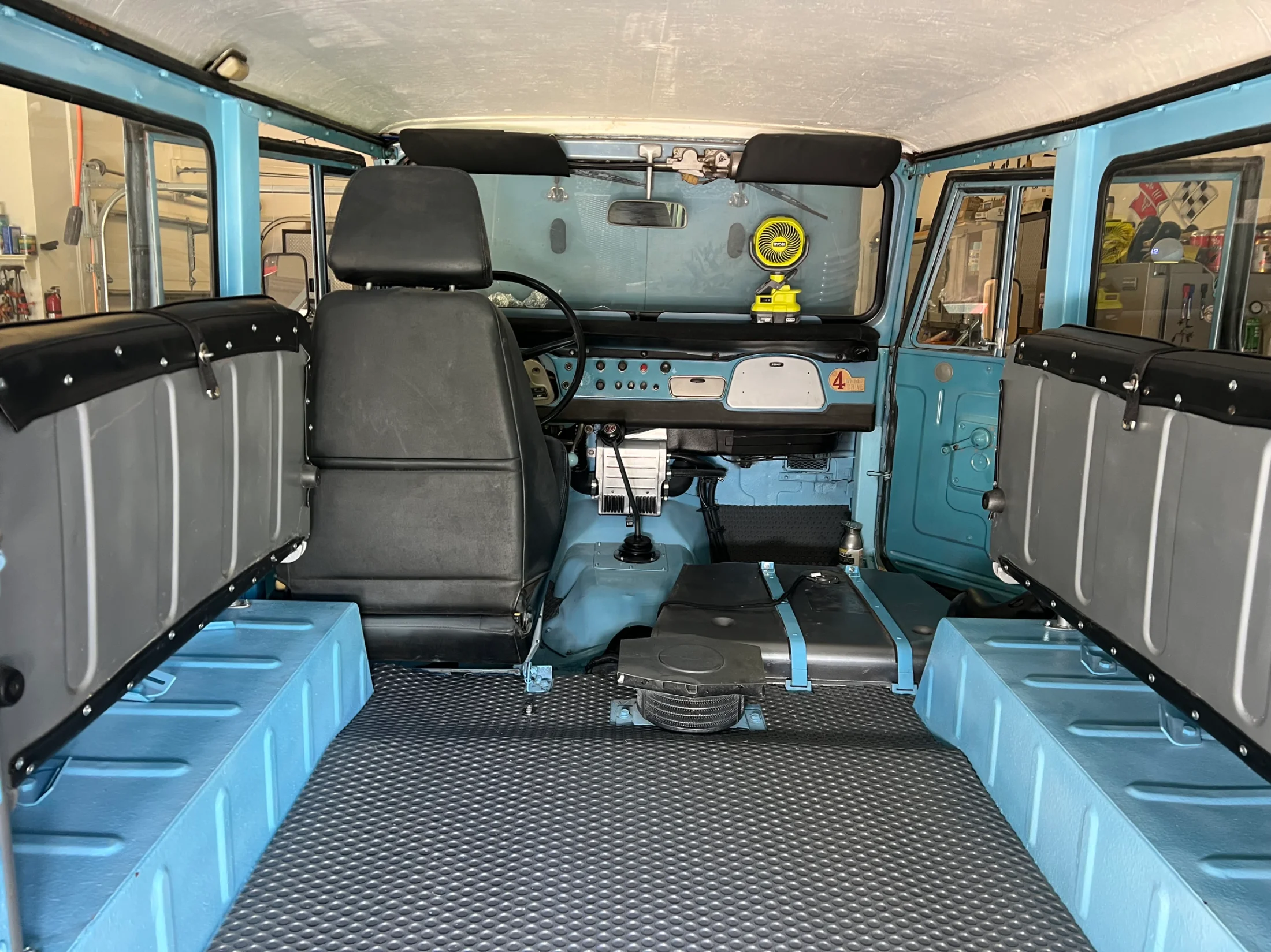

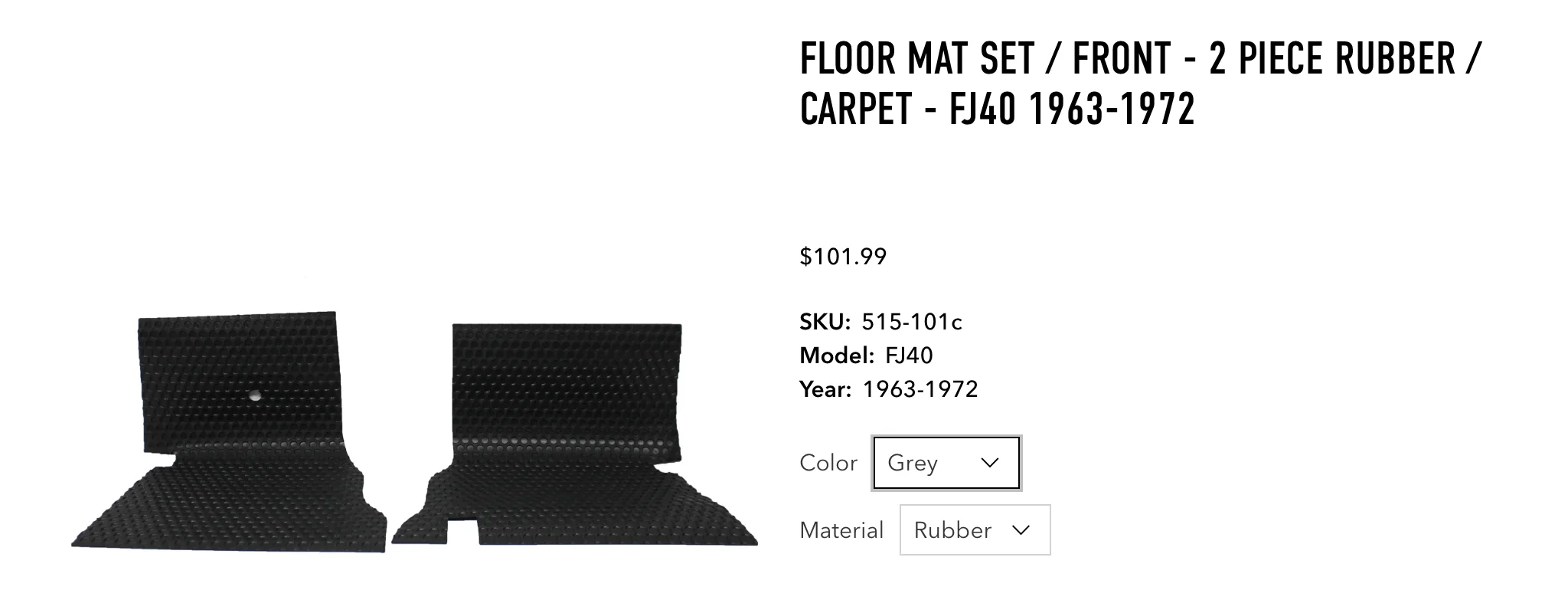

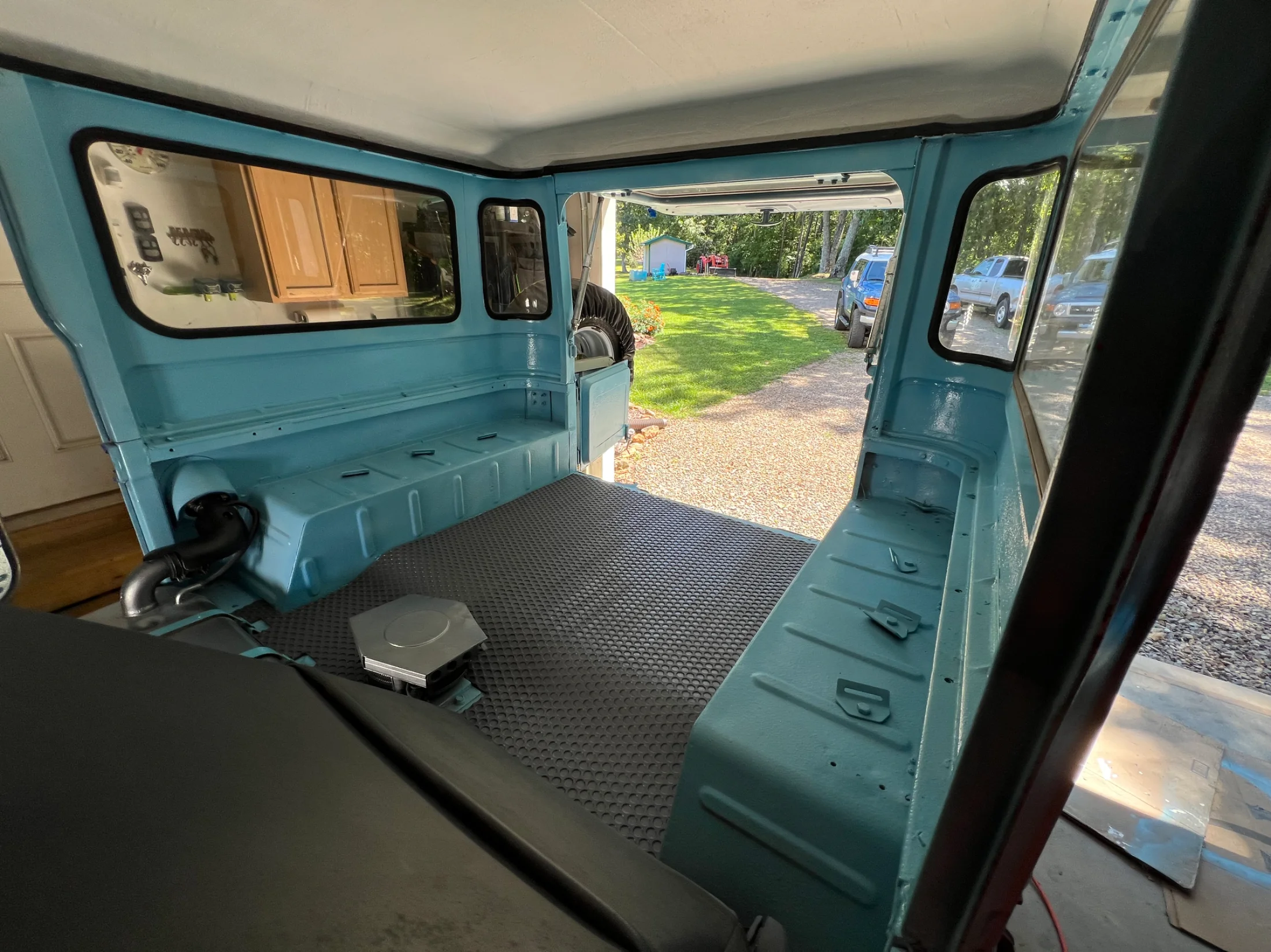

Jolene Interior Mats

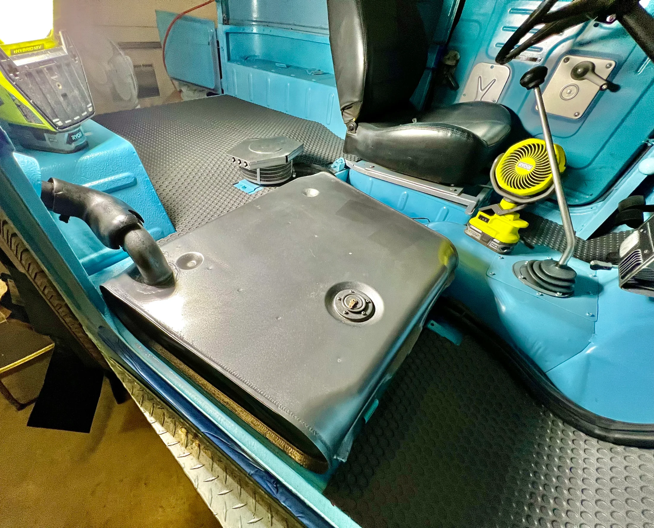

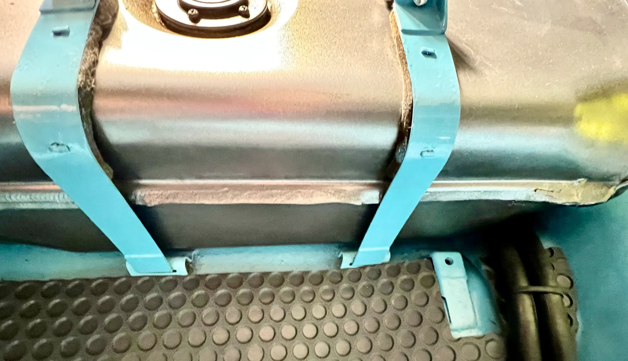

I do like the brightness of the light blue rear tub floor and front footwells. But let’s get real: That sheen won’t last forever, not hauling things in the rear tub and getting in the truck with muddy boots. I wanted a removable rubber liner I could remove and rinse at will. Gray, if possible.
Found these at Cruiser Corps. They are advertised as laser cut and turned out to be spot bang on. Very pleased with the fit. Tight, precise, no movement to cause abrasion underneath. Had to cut two small holes for seatbelt anchors and three small notches for the passenger seat feet. Easy stuff. Did it with kitchen scissors.

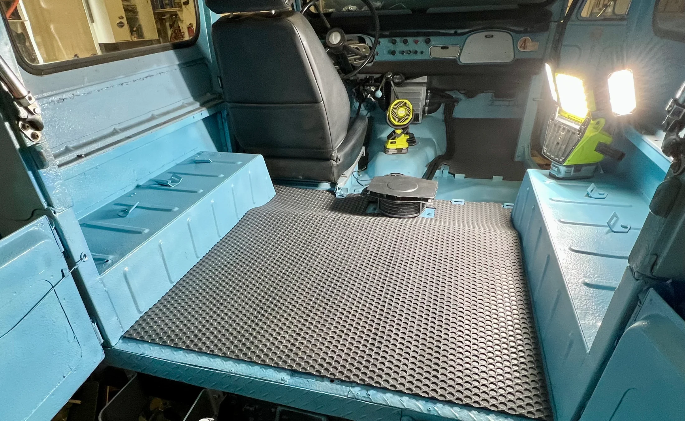

The rear mat fits just right between the fender wells. Room left at the rear for the rear doors to close. Precision is excellent.
I did not have to cut any of these notches. They were all dead on.

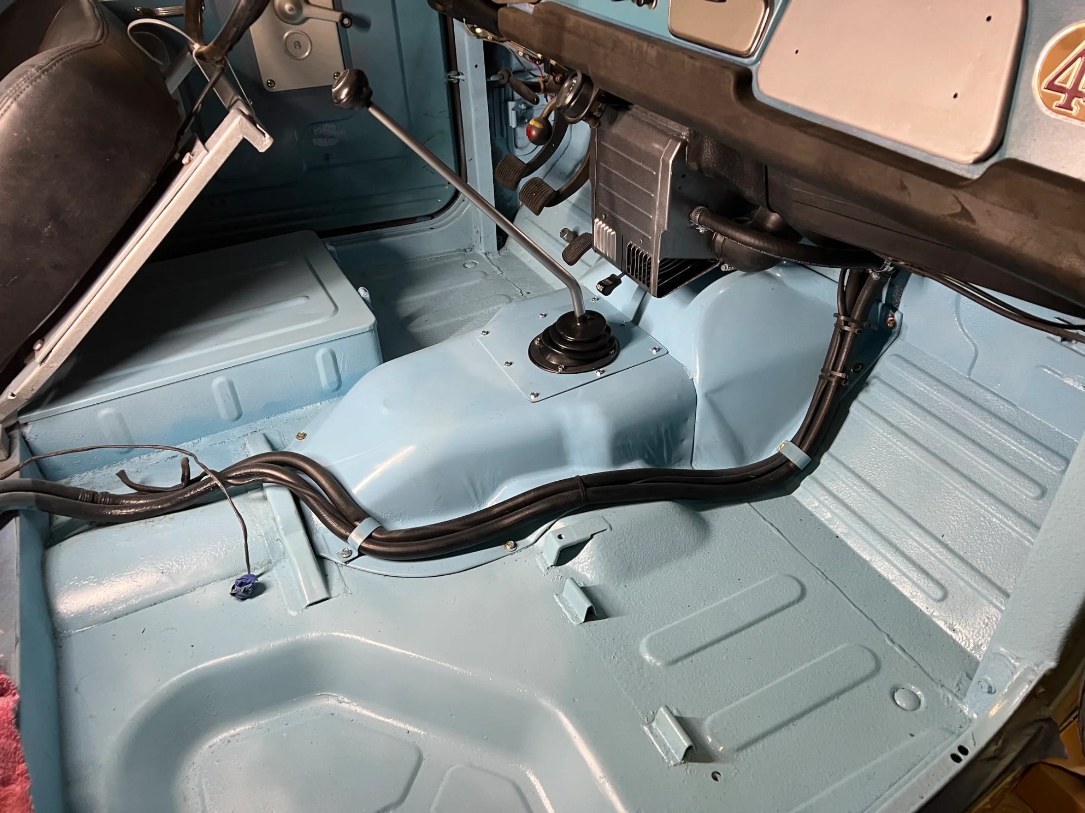

Passenger footwell mat here follows the transmission tunnel curve exactly. A+ fit. Very happy. Cutouts for passenger seat foot and dash support. Follows the inside of the door well perfectly.

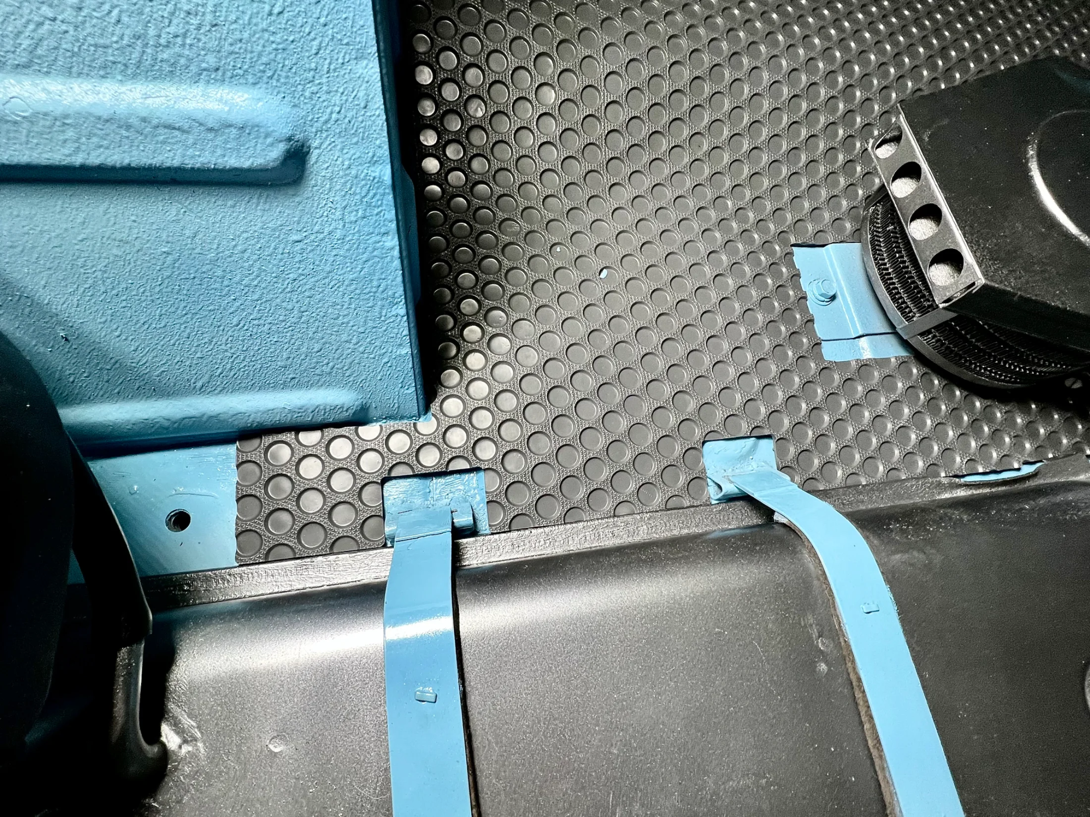

Great passenger footwell mat fit, butting right up to both tank strap anchors, leaving a notch for the raised passenger seat foot, and then following the curve of the transmission tunnel.
Here is where the rear tub mat cutouts do a great job fitting around heater as well as the rear tank strap anchors … and then following the profile of the passenger fender well.
