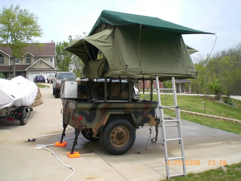

I like your design. You may want to add some stabelizing jacks to the rear if you are mounting your RTT to enter it the way you have in the picture. I used some trailer jacks I got off of e-bay. I also added another set to the front as I think it feels more stable when in the RTT.
I can vouch for those jacks. Makes a big difference.

I gotta agree with Kenny and Johnny on the stabilizing jacks. Personally, even with the jacks I'd still be nervous about the idea of having the RTT cantilever off the back of the trailer. Much better to go sideways IMO when the RTT opens.
Stacking the wood on the rear might be OK when the rest of the trailer is fully loaded, but it's still a lot of weight that far behind the axle. It will aggravate the tendency of a rear-opening RTT to unbalance the trailer when it's deployed. If you unload it at camp, then my concern lessens considerably. It's just that you may end up stacking something else heavy back there and it will be problematic whether it's wood or whatever.
I think if you move some weight to the tongue as a balancing feature you'll be fine....coupled with REAR JACKS...which IMHO, are essential if you'd like to flip the tent over the rear. If your planning to have you're awnings open up and your standing under them (I think you're going to need 6' min.) the room under the tent is invaluable, for dressing or a potty room for the gals.

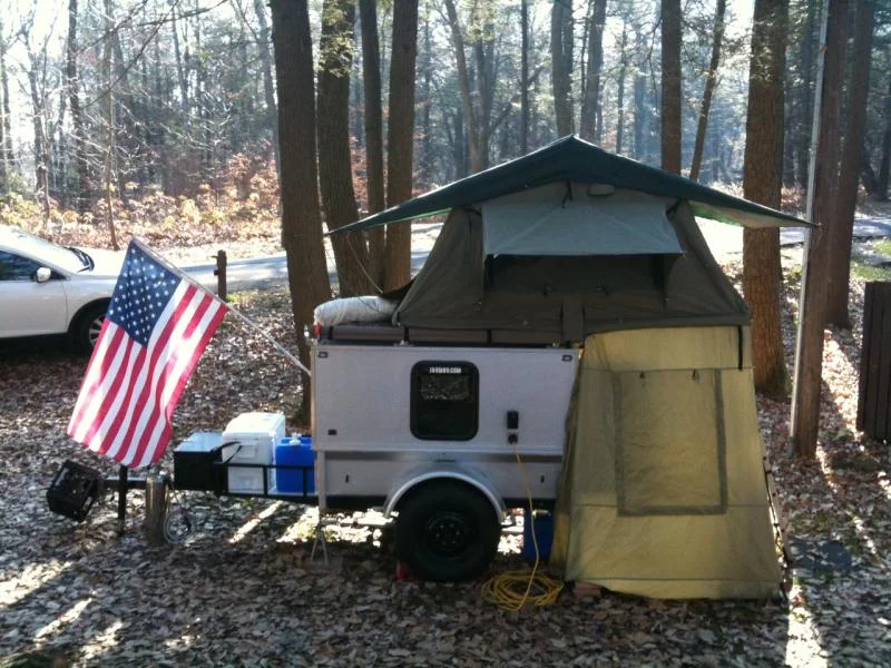

Heres a pic of my last camper...but notice I had about 300 lbs of tongue weight.
I also made my own awnings, but not a very simple design (seems to be a trend)
