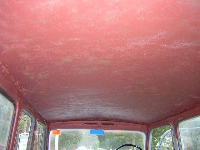

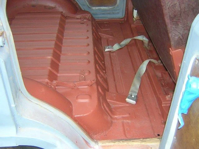

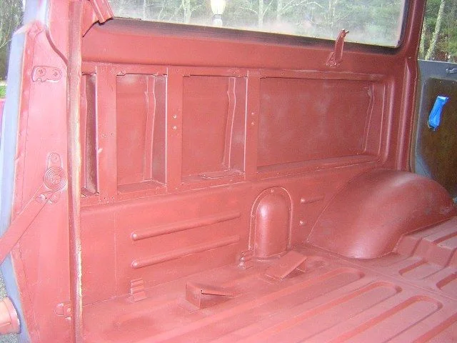

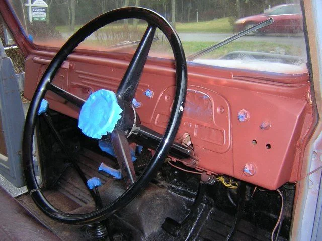

Today went great! I pulled the rear seat out, headliner, and crosspieces that hold up the headliner. The inside of the roof had a thin layer of surface rust so I did a quick sand and hit it with the red rustoleum primer. I did the entire interior including the dash in primer red. I actually like the color and I'm considering keeping it like that. Sure is cheap to touch up!

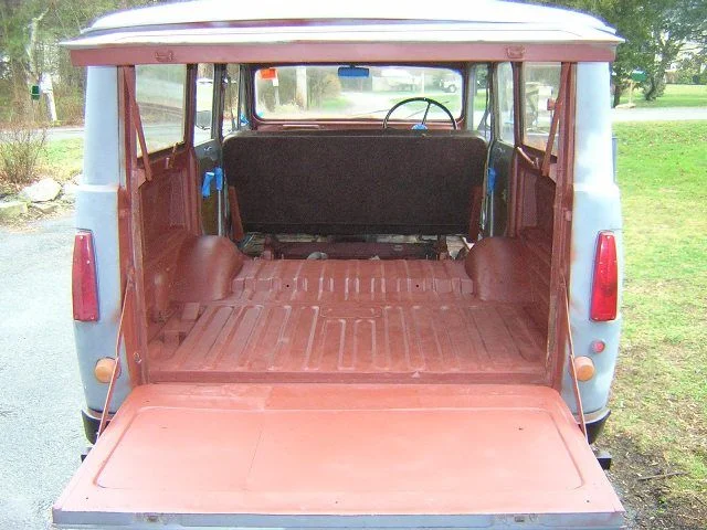

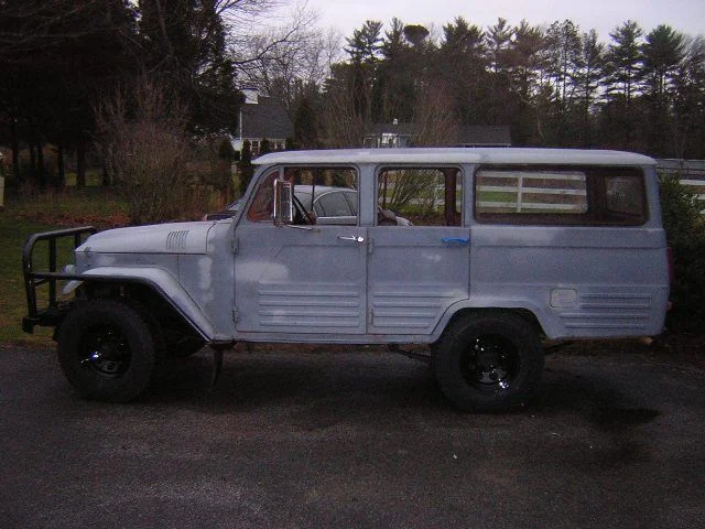

GOt a ton of work done. Primed the entire interior. Took you the headliner. snaded inside the roof. primed the dash. removed the back seat. Painted the bezel. Painted the cruiser emblems up front.
I got the new tires from SUmmit racing and the back spacing was wrong so the rims scraped against the tie rod ends. Guess I need spacers.....hope that will do it.

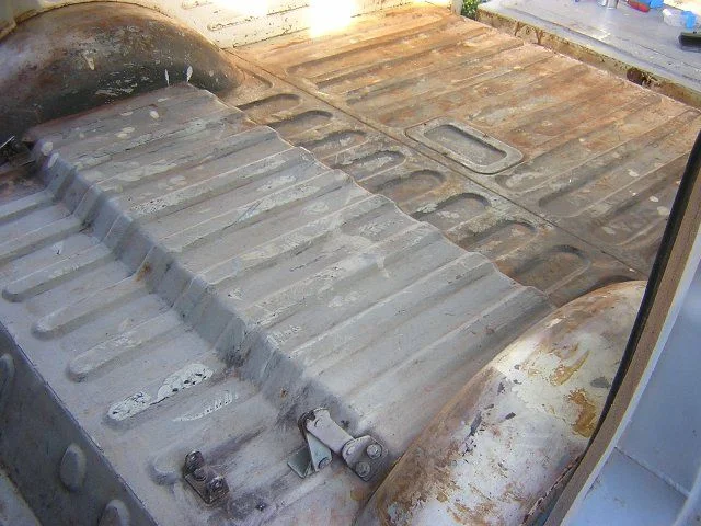

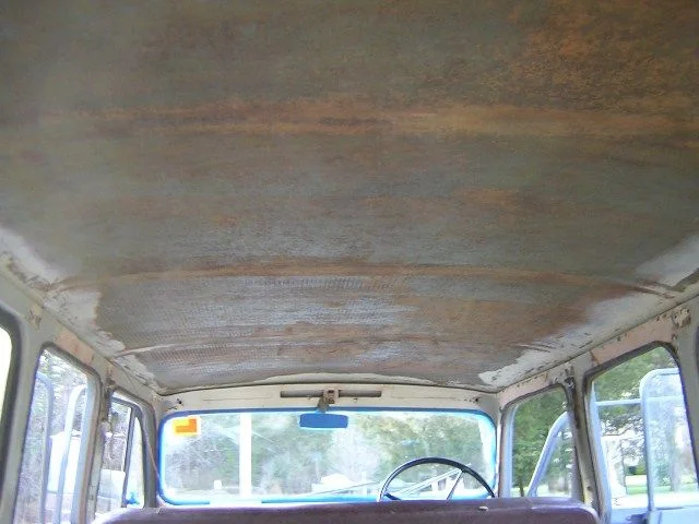

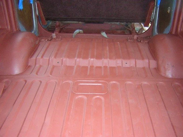

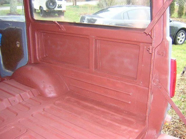

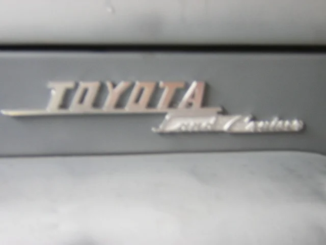

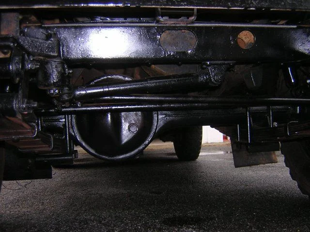

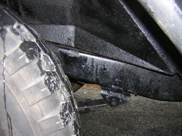

rust prevention
more rust prevention....

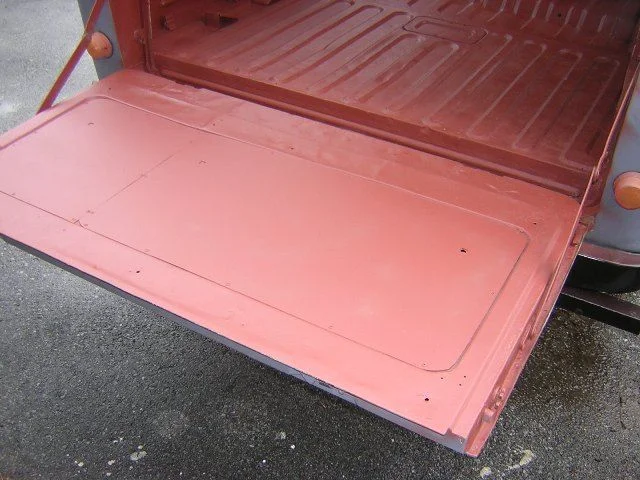

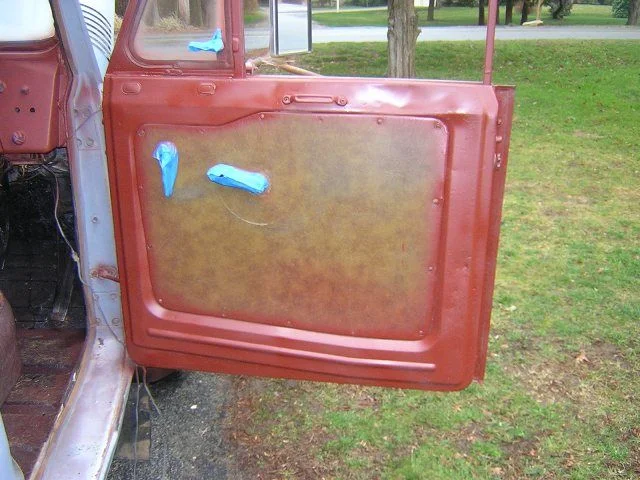

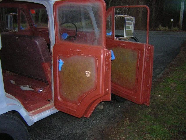

I used odorless mineral spirits. I'm going to re-do the door panels so I didn't bother taping them off. I cleaned up the glass this morning....took about 20 minutes. Faster than taping actually.
I'm going to have to re-paint everything and probably do another primer coat eventually. I just wanted to stop the rust before it started.
