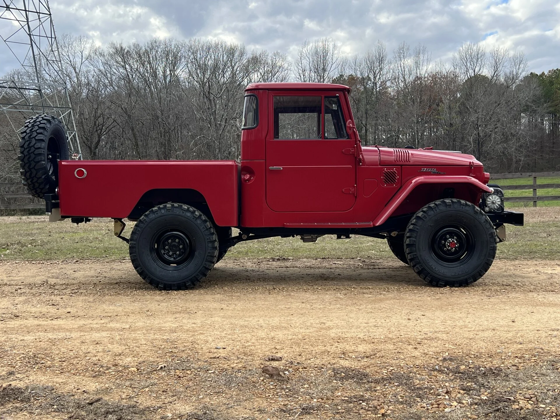

The swampers are even better in person. They sound so good going down the road.
Totally!
Haven’t you caught me on I10 more than once?
Yeah, I sure have. Passed you hauling the red one west around the same time of day about 20 miles further east of where I saw you this time. Hard to miss!

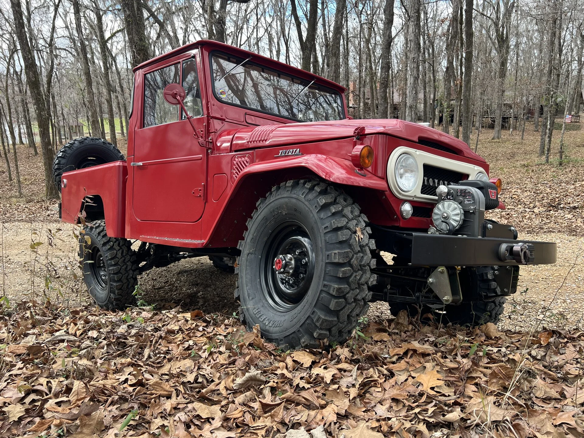

I found the rattle. The hole I had for the transmission was not large enough so when you torqued the motor it was hitting.
Fixed.
Added a matching pair of shackles on the front. The ones on there were stock length. These are the 4.8”‘that Man A Fre sells.
I measured caster before. With the 4* shims it was 3* positive. Now it’s 1* positive which is back to stock. Took it for a drive and it tracks perfectly.
View attachment 3530622View attachment 3530624View attachment 3530625
I like it.
Flexed it up. Nothing hits. Rear is close though. View attachment 3530626
