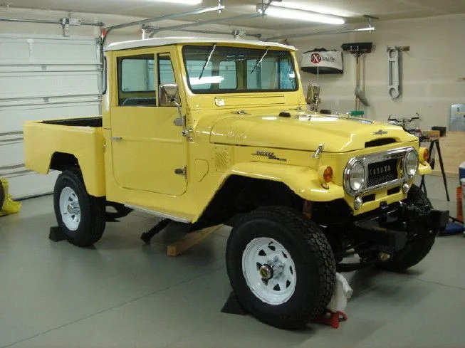

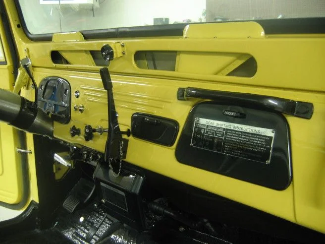

After six years I'm finally getting close with this 45. Ready for the muffler guy and finally get to start this truck for the first time. Don't know what would have happened if I had not taken a hundred pictures while taking it apart. Too many mod's to mention. Too many dollars to mention.

steering

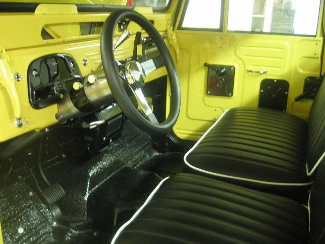

Ilove that you kept the uncut tranny hump; wit what I presume is an automatic transmission. What calumn did you use? And i you happen to have a part number (or at least mesurements, like 32. vd 34" etc.), I would appreciate that too (I am torn between the Ididit and the flaming river ones). Love the wheel too.
Also, how tricky was it to relocate the pivot of the transfer case shifter (the hard linkage portion) when you went to an automatic?

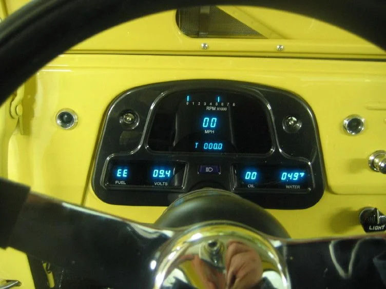

Very nice, Sanitary, looks very simplistic but I am sure that is incorrect. Is the instrument panel LED?
I used the IDIDIT column and I think it was the 32". I have a box of receipts
that scares the hell out of me but I'll find out for sure. As for the transfer linkage. I built a simple "L" bracket and mounted it on the frame directly below
the linkage comming down from the firewall. Chewed on that one for a long time but ended up as a simple alteration. So far anyway.
I sent the cluster out to Dakota Digital.
I found the invoice for the Ididit column. I purchased the column from Centech
Wiring Co. along with the wiring harness I used. Their part number for the column is #i1333 and stated as a 33" column.

Beautiful truck. You can tell just from the pics that you really took your time and did it right. That cluster is something else. Never seen that done before. Excellent job!
