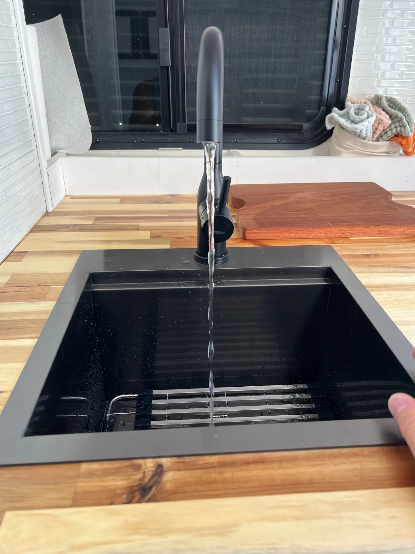

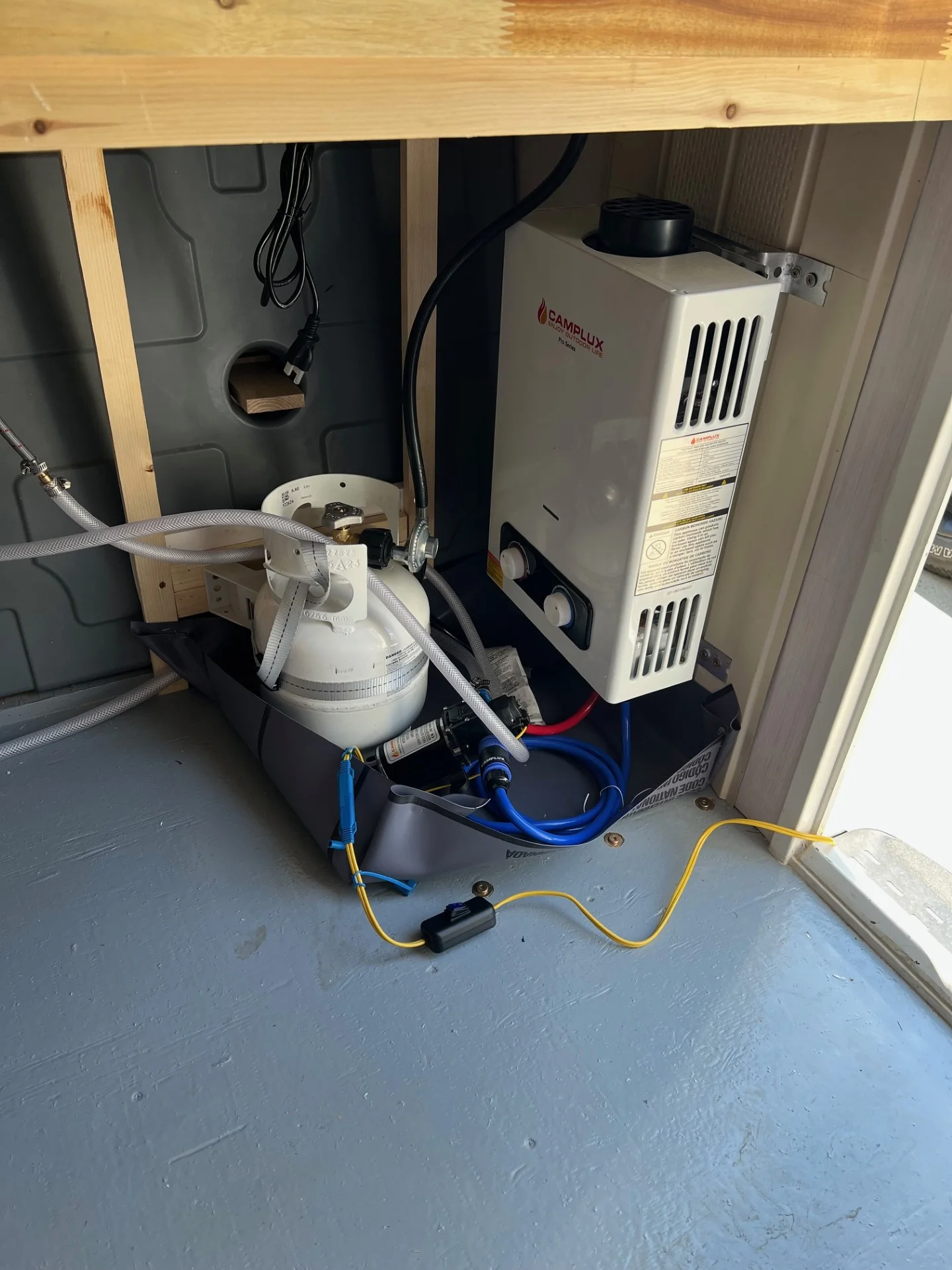

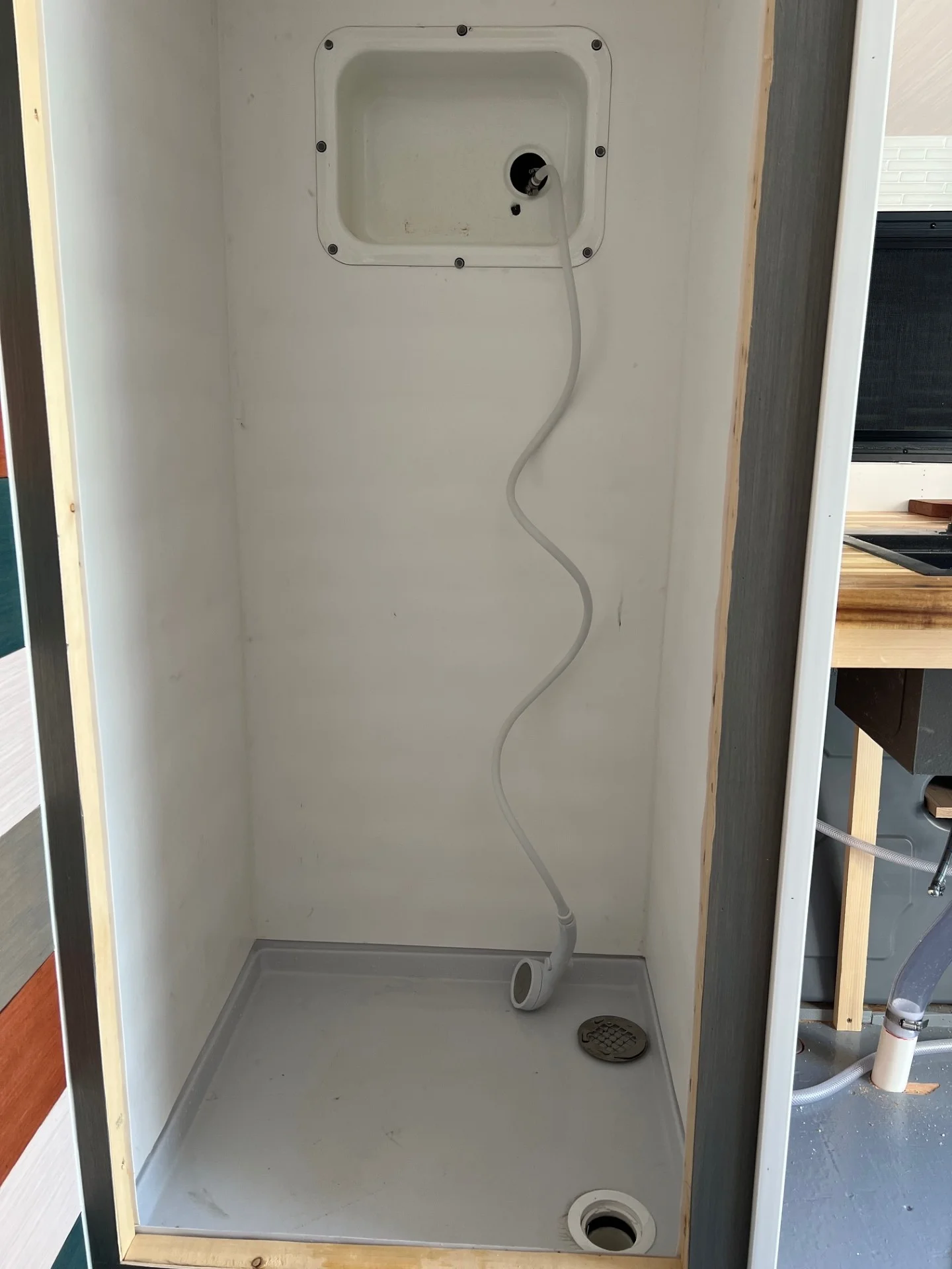

Made a makeshift catch basin for the connections under the hot water heater and tested everything. Connection to the shower head isn't sealing correctly and leaking so pressure was low but otherwise everything was good. Water seemed to be draining correctly out of my drain line.

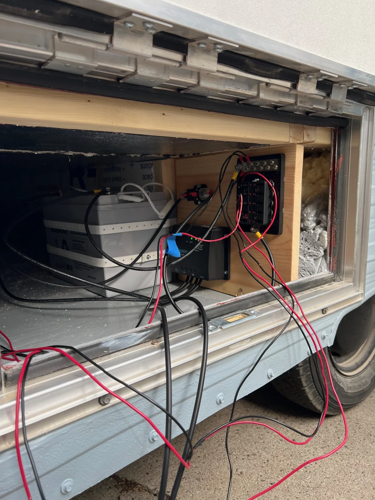

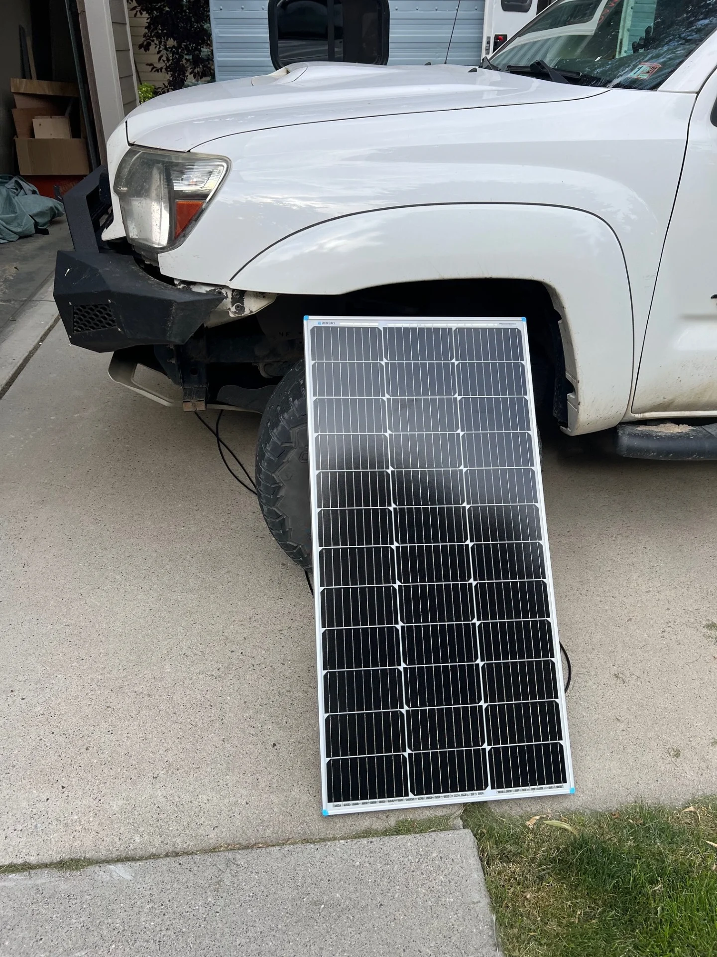

I also got a good portion of my solar setup done this weekend. Currently have one 100w panel which I am going to leave mobile and position for the best sun for now. Need to do some cleanup on all the extra slack in the wiring.

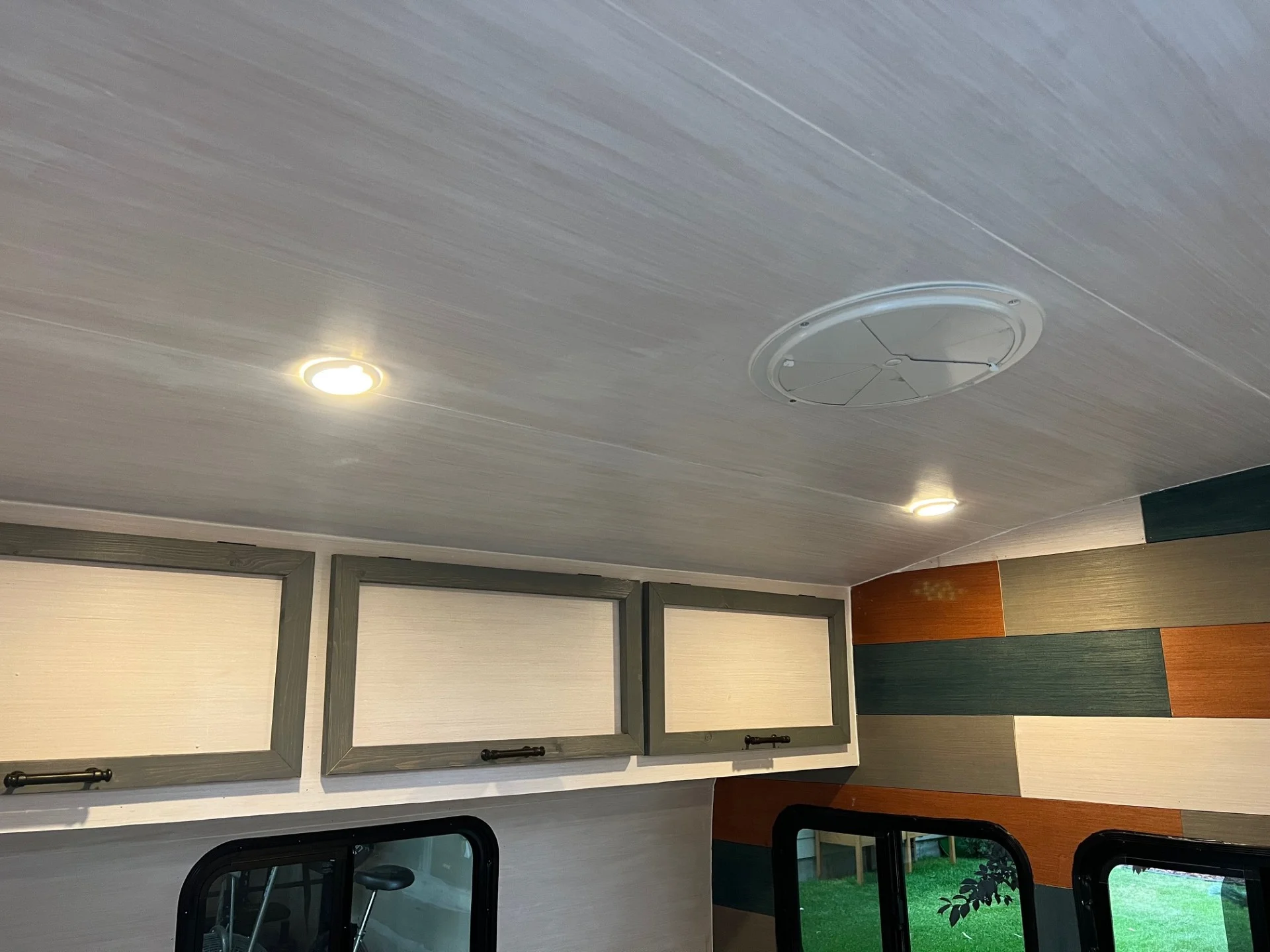

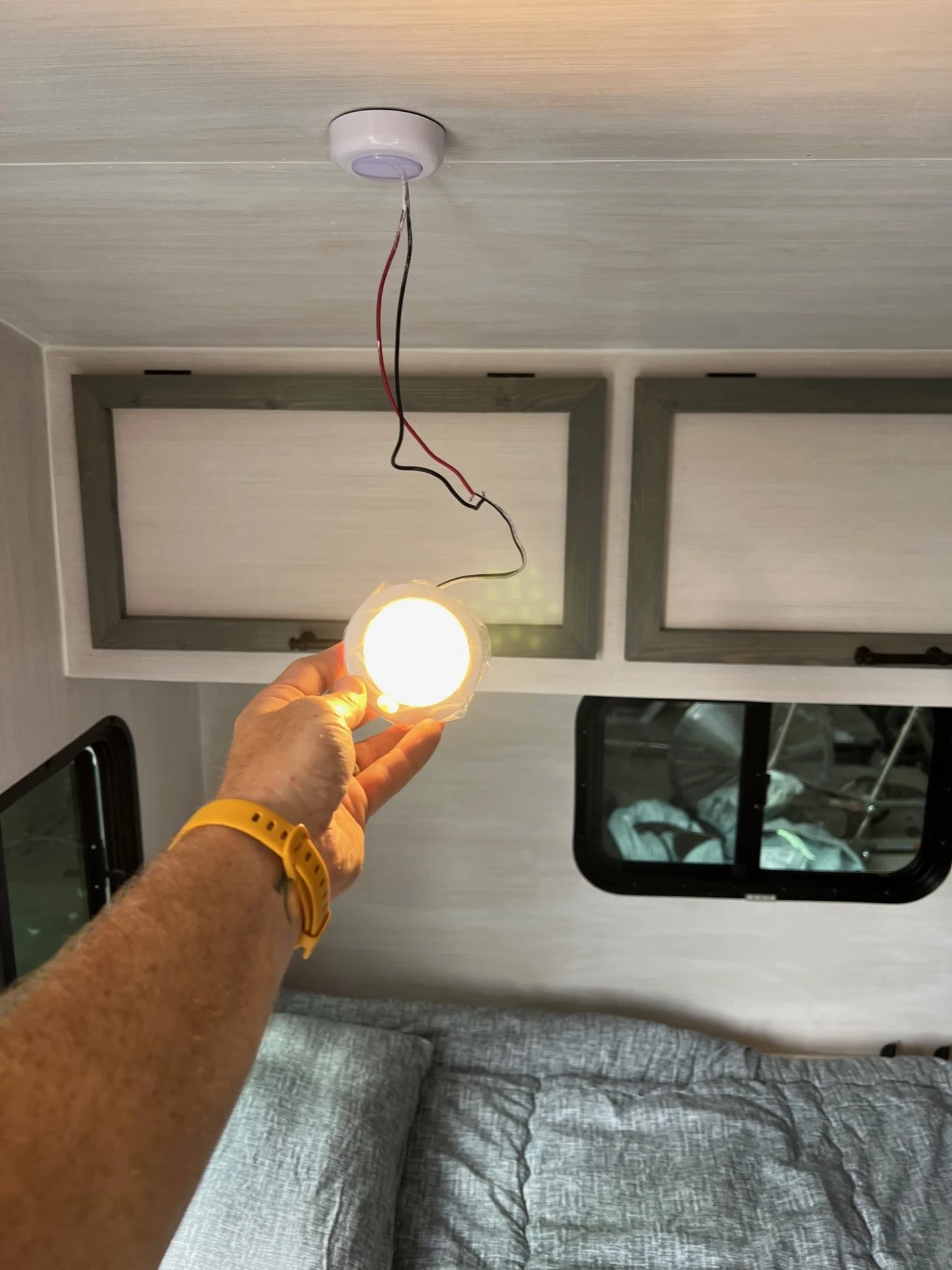

Got lights and USB's connected to the wiring I pre-ran and removed the temporary tap lights.

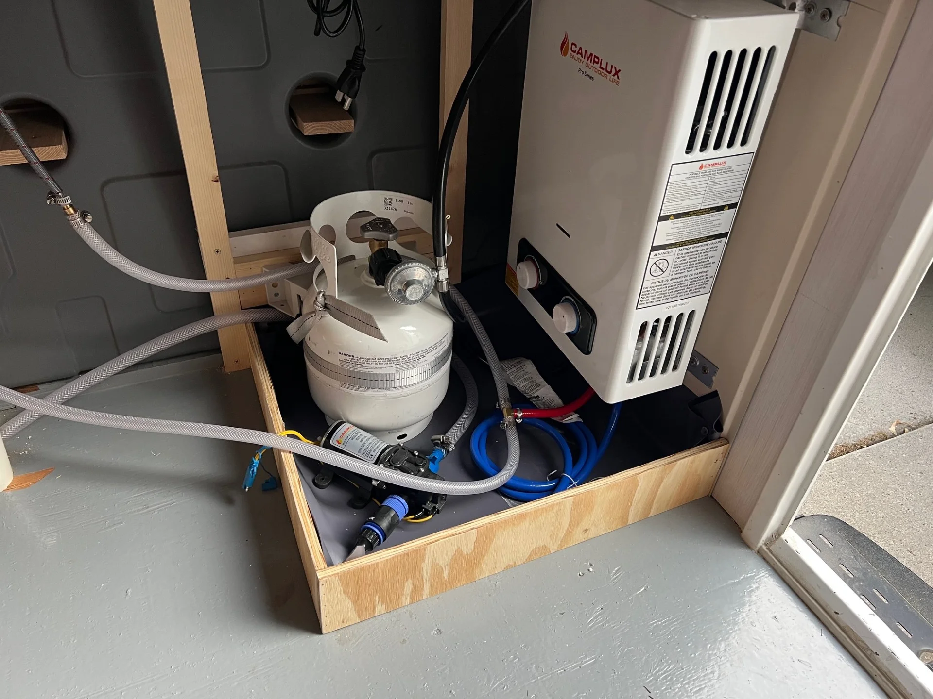

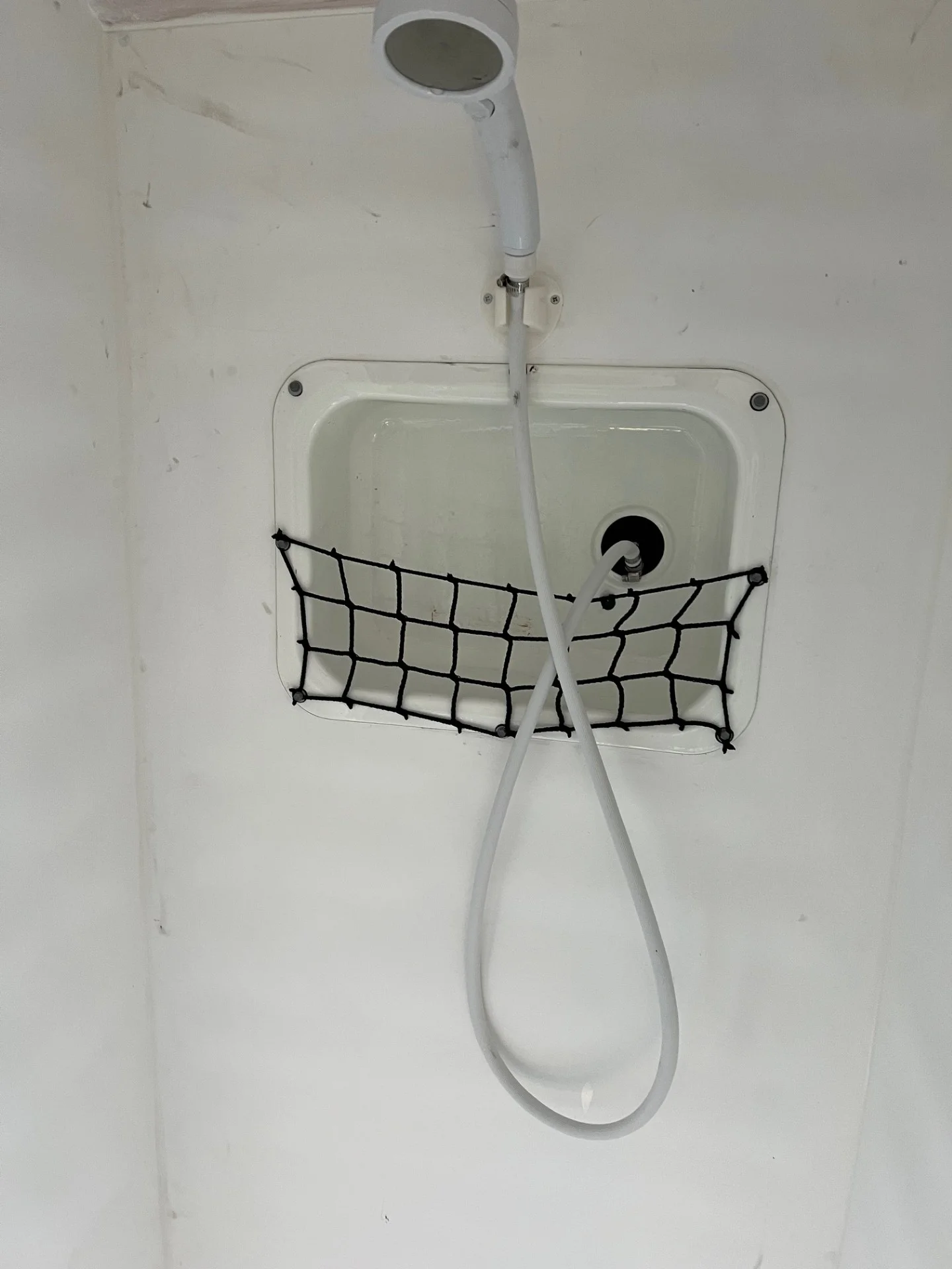

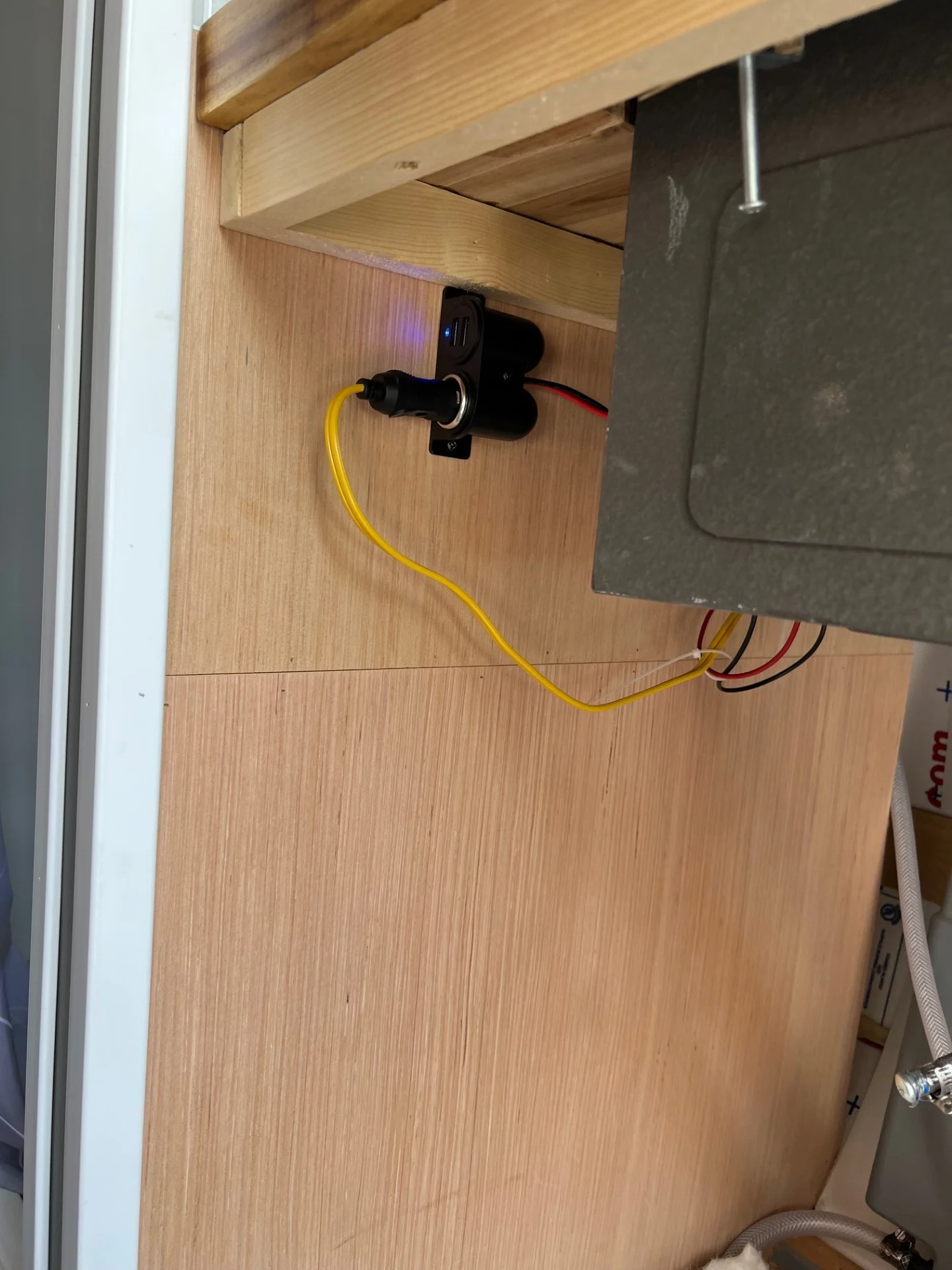

Got a few more things buttoned up on the camper this weekend. Ran new wiring for this cig lighter so that the water heater can be connected to the solar system and inside the camper. Re-tested everything and got the shower head to stop popping off, also added this net to keep all my wifes bottles in the shelf when in use.

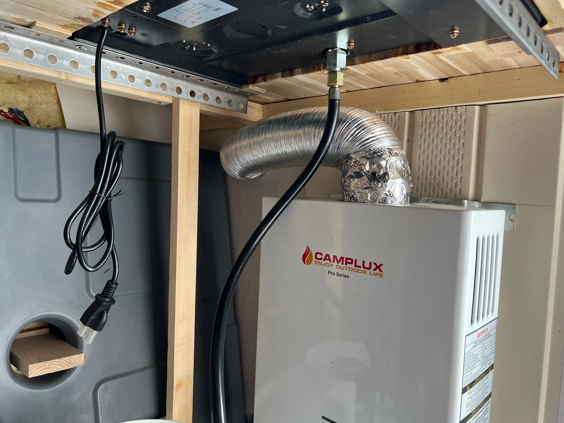

Finally got around to venting the heater as well. Not my best caulk job on the outside but I'll clean it up next time I work on it.
