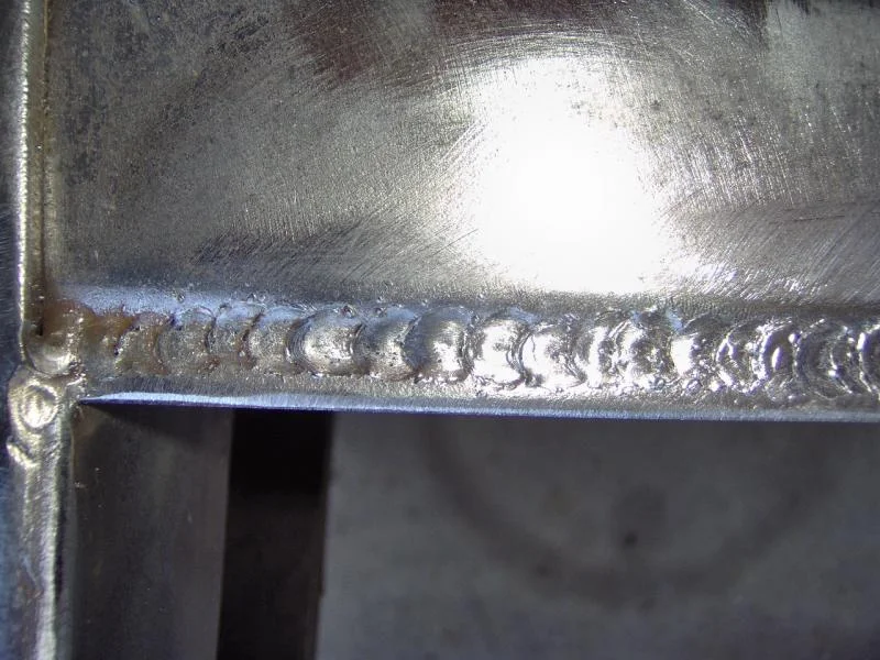

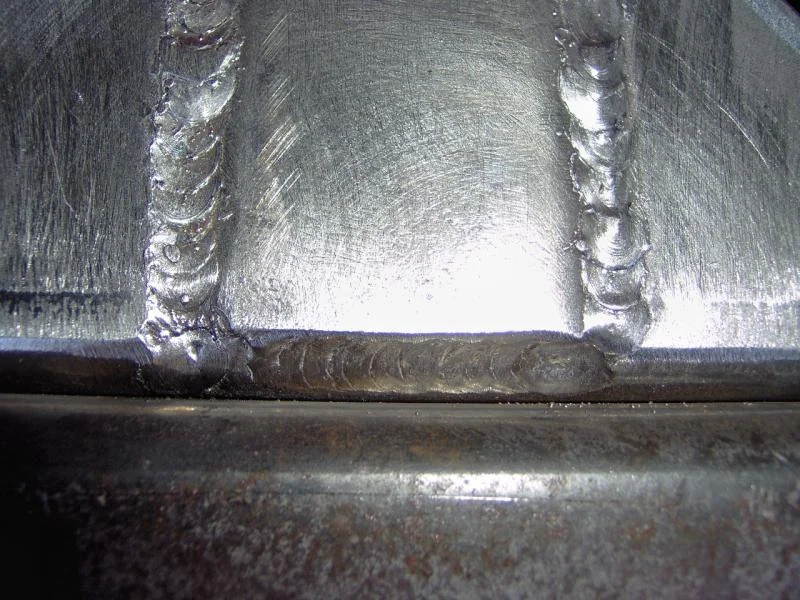

Some Progress...

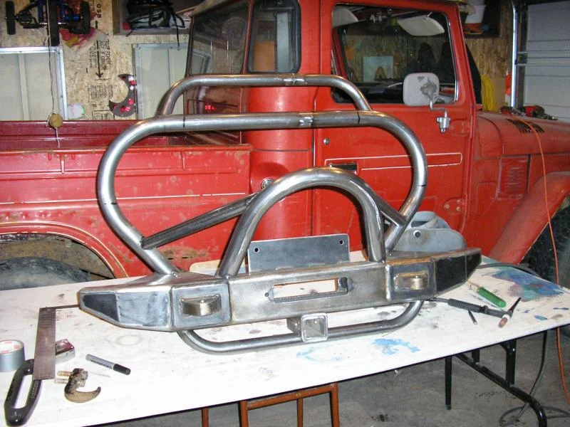

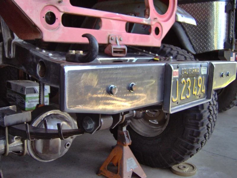

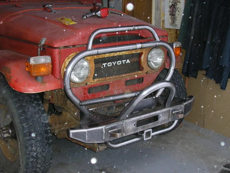

I've got a few pictures to share. Had some time a couple weeks ago to work on the front bumper, lincense plate holder, and front frame bracing and boxing.
Yeah - that'll knock over some trees ;)
Great quality welding there - nice fab. Are you gonna counterbalance the rear so she rides level?:D:D
I'll be making a rear bumper as well so that should even things out. :D
Actually, IMO, the bumper is not too heavy. Its 3/16" wall 2x5 tube and about 42" long. Don't know what it weighs exactly, but calculated to be about 30 lbs.
The crossmember behind the bumper is also not too heavy, its also 3/16" thick and calculated weigh is 14lbs.
Just buggin ya:D My bumper is 1/4" wall 3x5 tube 24" long with 3/16" "wings". Plus the 2" .120 wall tube and 3/16" mounting brackets - mine bolts on with 10 1/2" grade 8 bolts :hillbilly:.
And yeah - I'm doin' a rear bumper, sliders and interior roll cage too. Prolly add 350# to the truck:grinpimp:

Nice work! An integrated winch mount and fairlead too! Very nice. I like the outer bends in the bumper and thought about doing something similar to that as well but I got lazy and decided mine looked good enough as a straight bumper and I really needed to spend time on other things like an engine and transmission. ;)

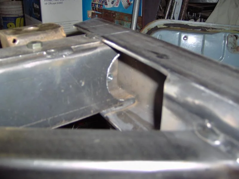

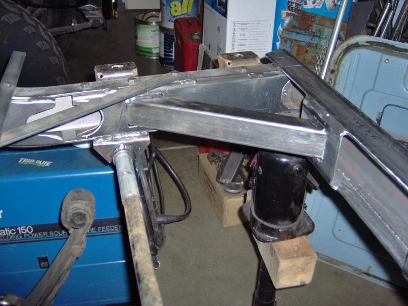

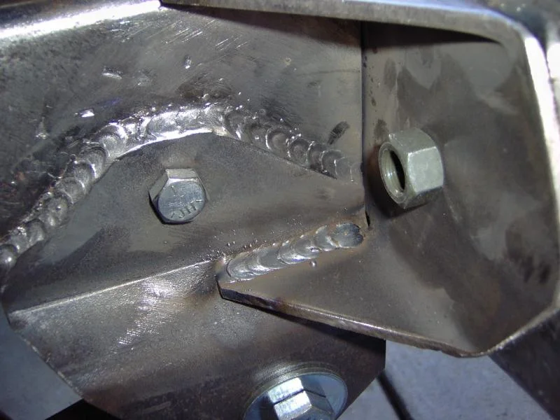

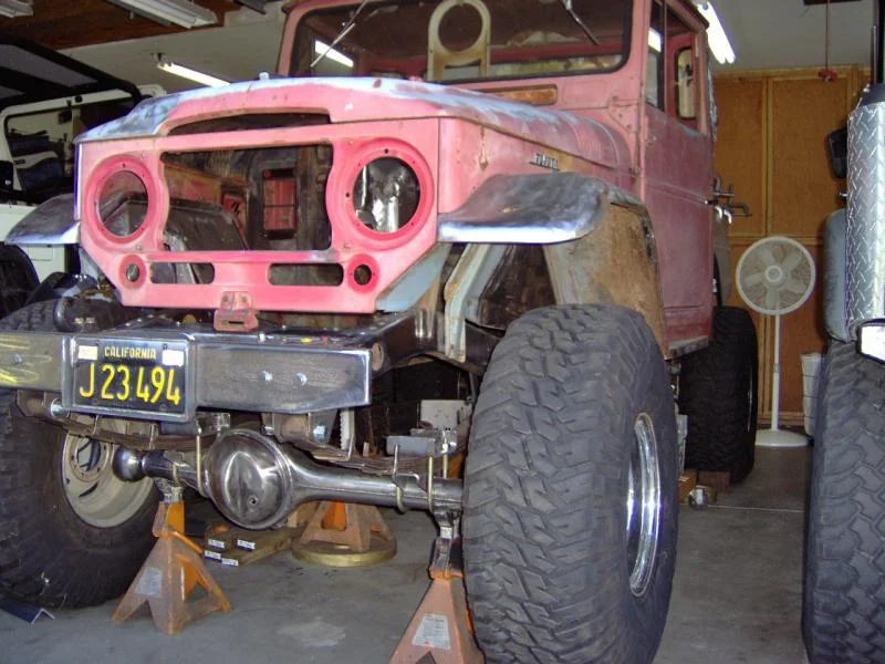

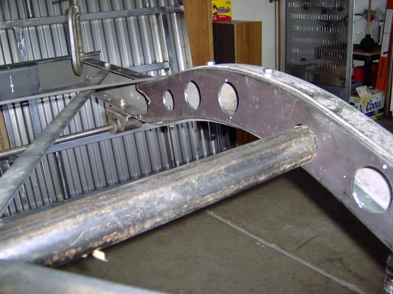

Had some time to work on the 45. Blasted the rear part of the frame so I had some clean metal to work with. Was able to fab up some custom frame boxing pieces and relocated the shock tube/frame crossmember forward to match the rear axle relocation. Also made up a new rear crossmember. I'm also adding more boxing to the very rear secitons of the frame rails and also adding triangulation to the rear corners. I'll take a few more pics and post them up a bit later.
