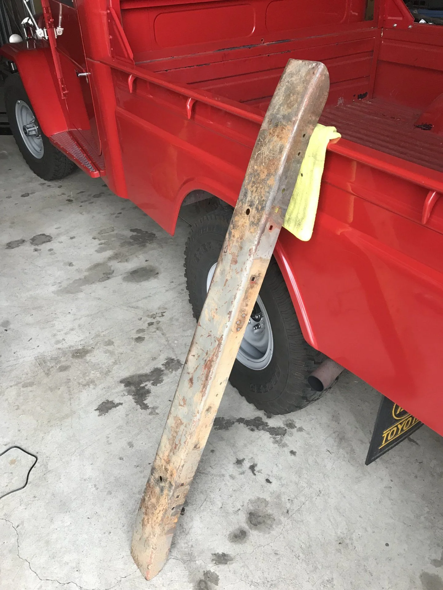

Hopefully the rear cross member and braces will be done this week, and fit. There is some dimensional specificity (word of the day lol) to left and right for these which the machine shop had a bit of a hard time understanding.
On some days I think it would be good to fill the frame channel with concrete. :hillbilly:

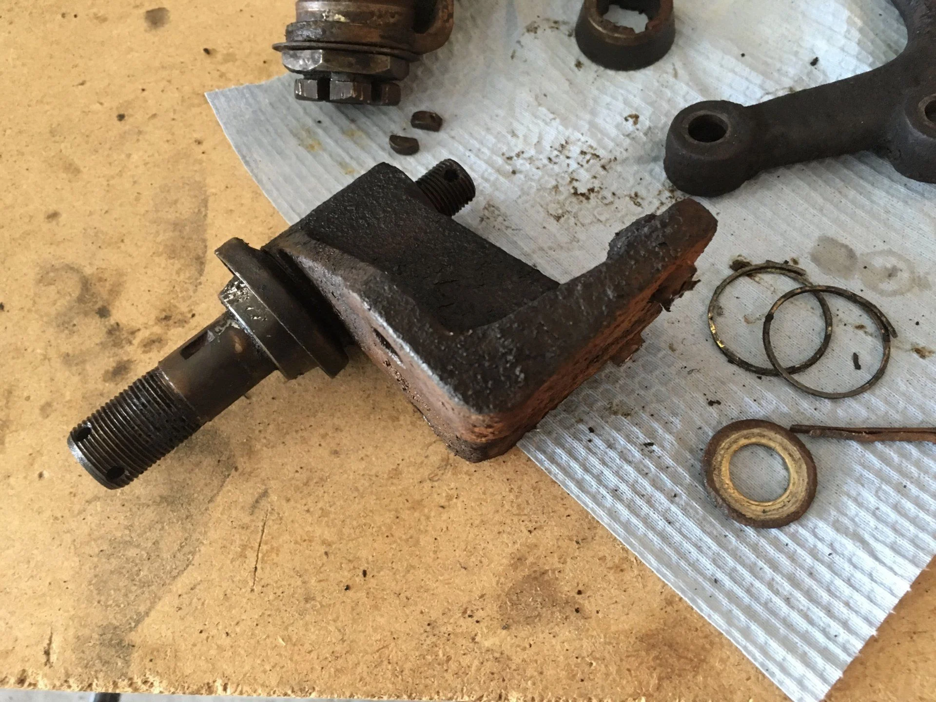

So while I continue plinking on the frame, decided to go full rabbit hole and pull the center arm, etc. and rebuild it. Just cuz. So now I get to bang, do some more chemical warfare and napalm attacks on the center arm shaft, and more banging. One of these days I'll start putting stuff back on. Yeah, right. Picked up the rear cross member and supports from the machine shop, tomorrow will fit check. Fingers crossed (and stained, and bloody, and stiff/sore).

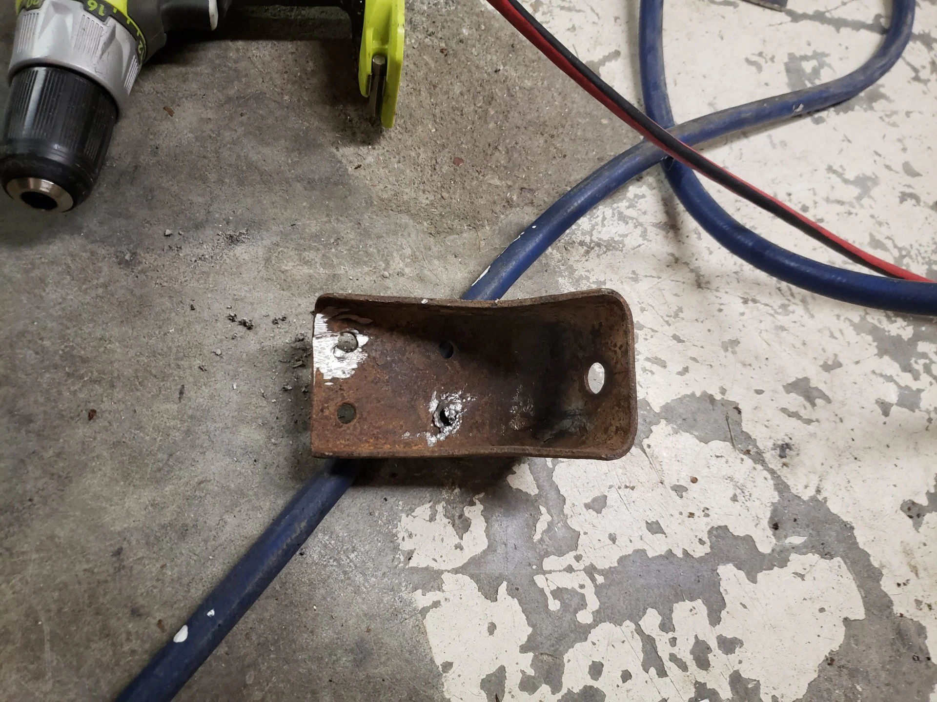

So I drilled out two rivets and took the bracket and remnants off. Still can’t get puller to fit. So it’s soaking in a bucket of Ed’s red. I might look at it again this year.

Freezing+Heat Part One no go. Managed to kind of get the smaller puller on (2 ton, that should be enough, lol), not a lot of bearing though. Put the propane heat on it, no go. Tried several times, no go. Wrenched on the stuck top bushing, it’s toast but not budging like the shaft, shaft ok just stuck. Unfortunately the upper dust seal ring is in the way to get better puller bearing. Even if I can get the bushing off, the seal ring won’t come off unless the shaft is pulled or it’s destroyed. Can’t destroy it though because they are NLA. Back in freezer. We’ll see.

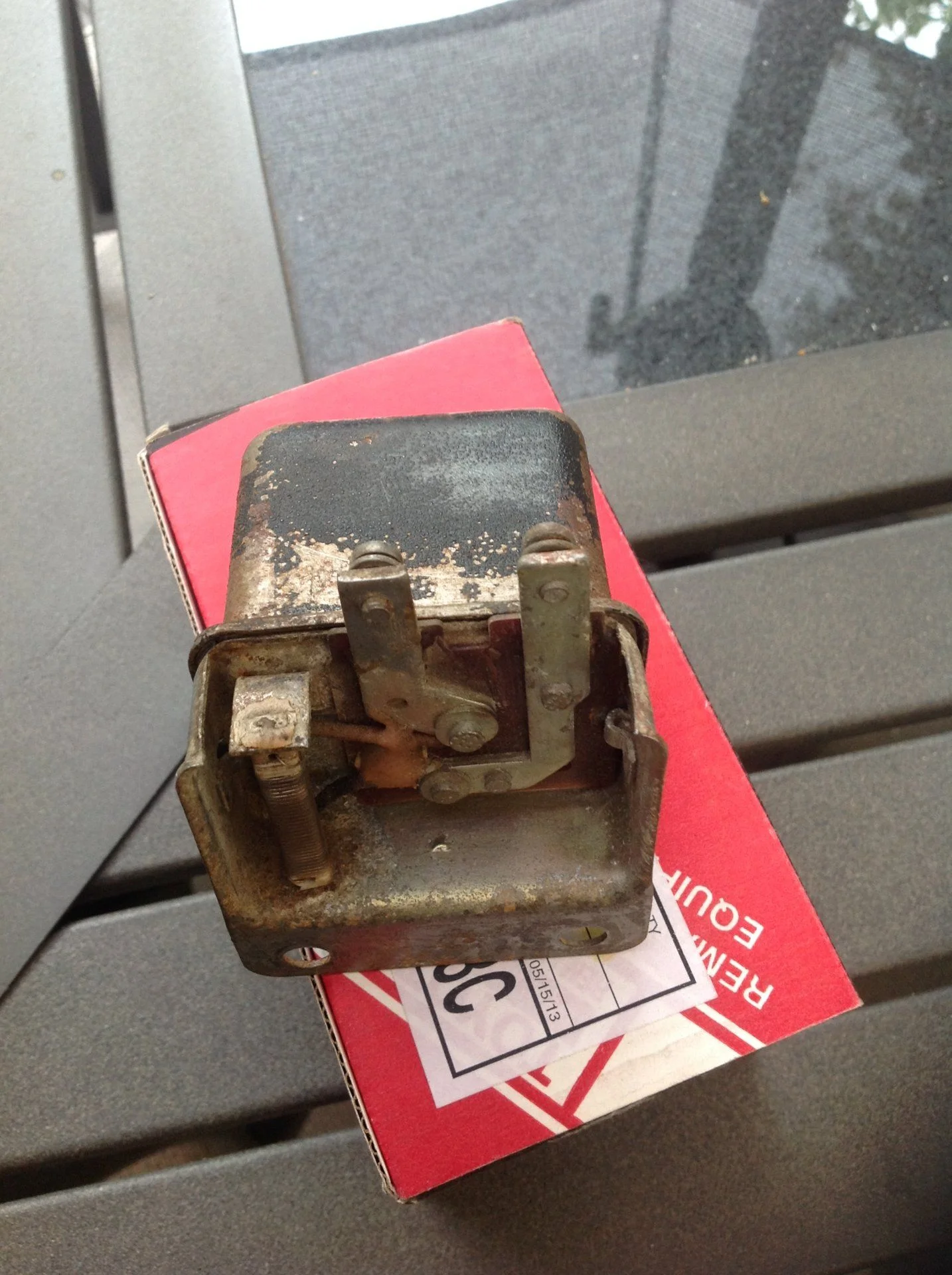

Good morning Paul, the Salem thing may work out. I travel to Portland often to see in-laws. I also have a working voltage regulator I took of of my 65 when we did all the work. Your welcome to it if you want it. Just needs a little black paint and cleaning...
Mucho gracias again Mark. The VR is perfect. Will that work with an alternator, I think from a ‘67, as my rig didn’t have anything, alternator or generator? Let me know when you might pass through Salem, I can let my BIL know and he can meet you at your convenience. Paul

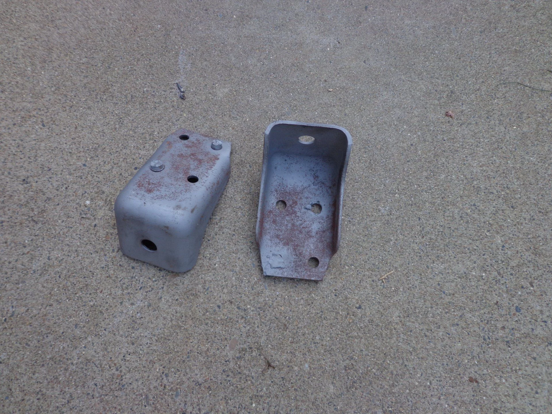

Just curious, are you going to re rivet that center arm mount ? I was able to pull mine without removing the bracket.
No, bolts. What did you use to pull yours?
