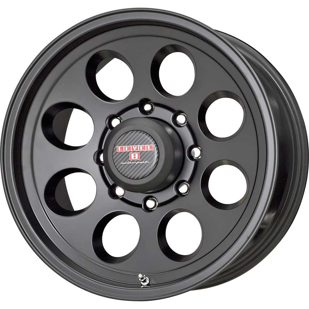

Level 8 Tracker
16x8.5
6x5.5 Lug Pattern (Obviously not represented in the pic below))
Bore Size 108mm
Offset -25 = (3.77 Backspace)
Well I finally got wheels. These 100% fit with no spacers. :)
Brand: Level 8
Model: Tracker
Size: 16" x 8.5"
Bore Diameter: 108mm
Backspacing: 3.75
Finish: Satin Black
These clear the calipers and have about a 1/8" between the tie rod ends.
I bought them through discount tire direct. Here is the direct link if anyone else needs wheels in a 16".
http://www.discounttiredirect.com/d...ProductSize.do?pc=64078&typ=Truck&tmn=Tracker
And here is a pic of them. They Work!! :cheers:
