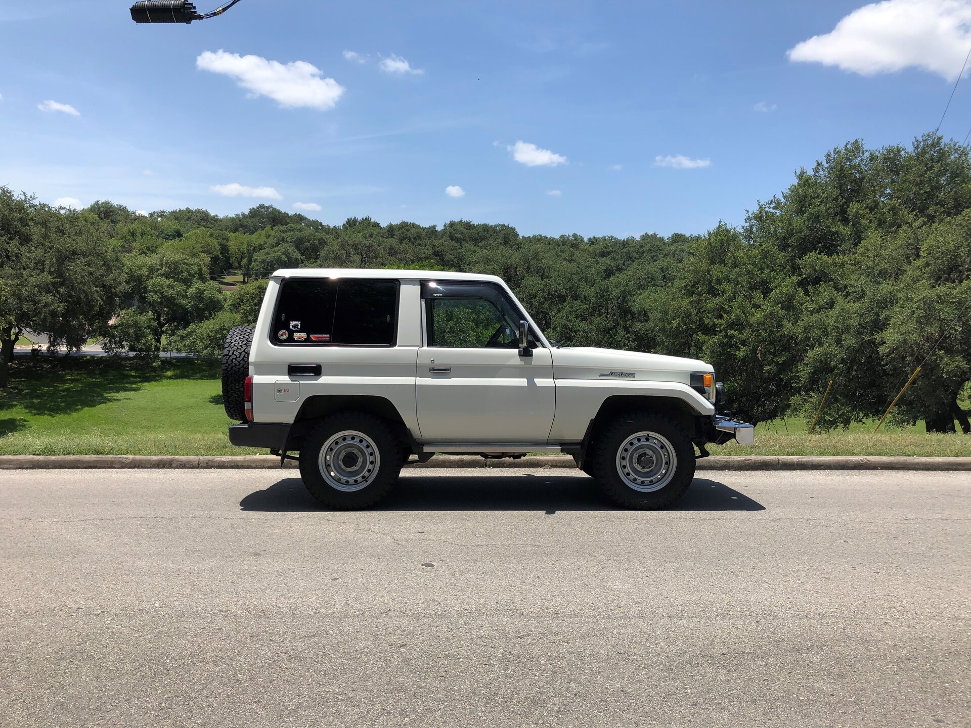

If you really want steel wheels with the look you desire. You can run these non US spec hilux 17" steel wheels. I have a part number somewhere but they are not easy to get here. @Honger runs the same wheels.
Here they are on my former PZJ70 that I owned. No spacers.
The Nomads should fit fine in wheel well without any contact on steering parts
