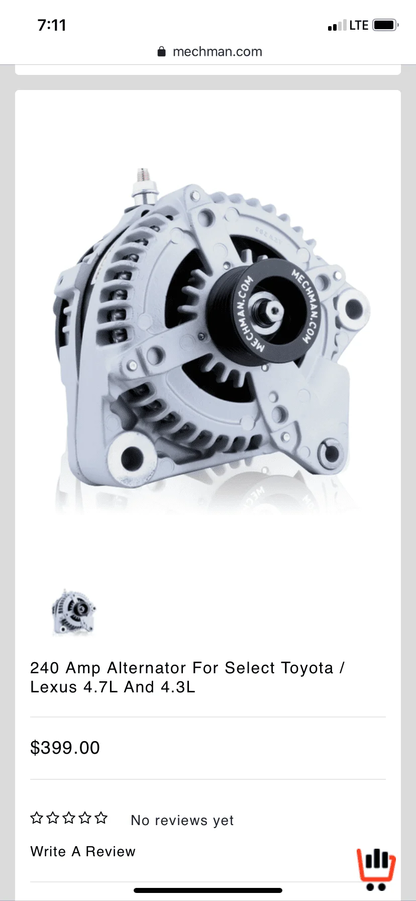

There is a YouTube video of Gale Banks (Banks Engineering) receiving a Mechman Alternator for a Pro monster truck his company supports. I wondered if they make one for the 1FZ. Searched the Mechman site and no luck however, they have one for the 4.7, specifically in the 2003-2009 Sequoia. 240 amps!

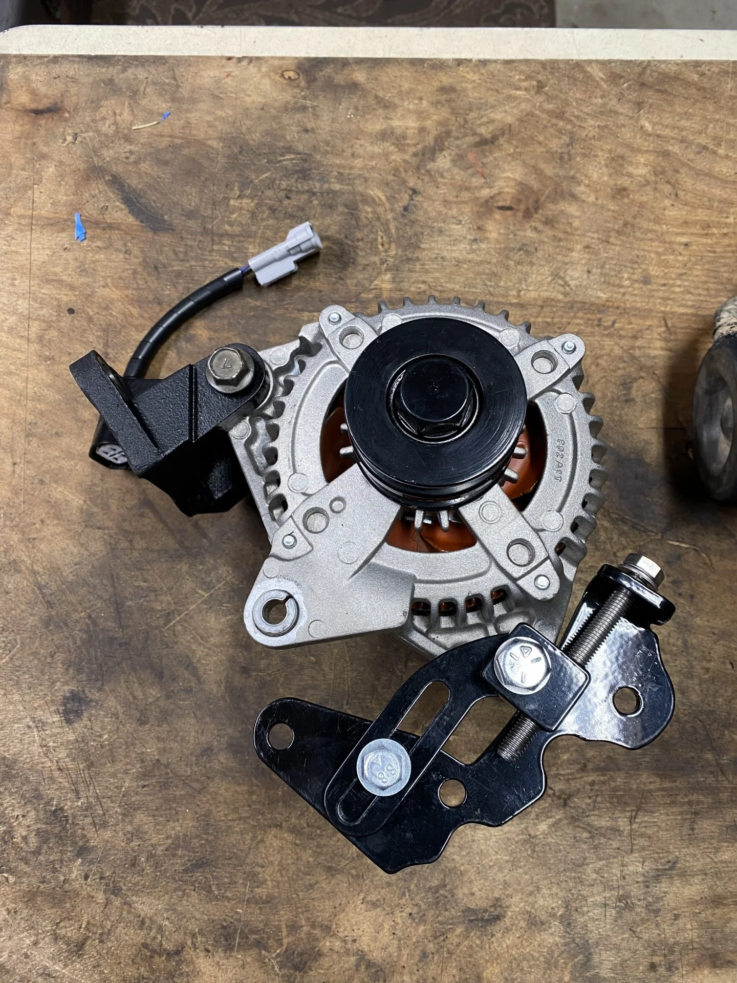

Photoman’s bracket and a Sequoia 150a has been on my rig for the better part of a year now (awesome craftsmanship and support btw).
Might be an option for those heavily dependent on electrical power. Fit factors would be: case size and shaft size. I am going to call Mechman to see if they use the stock shaft size. If so, Photoman’s smaller pulley will fit.

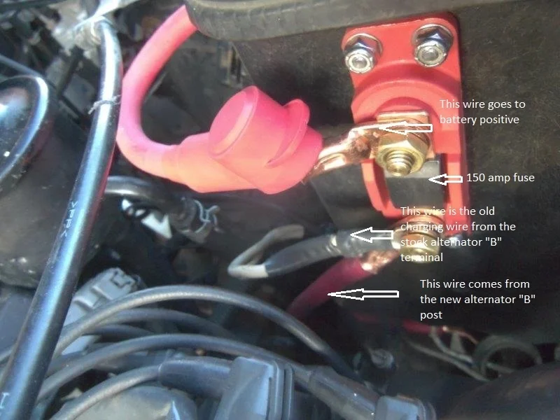

The new wiring I figured out is to take the stock white wires from the alternator and connect them to the fuse block with the new charging wire. It is important to connect them on the correct (alternator) side of the fuse block. This eliminates trying to get the two ring terminals on the alternator "B" post.
The new fuse block comes with a clear cover. Mine did not. I put both wires in a boot for protection. All pictures do not have wire loom etc to hopefully get better clarity.
works good
Edit to add - The length of the two wires is 16 inches ring eye center to center for the charging wire and 12 inches on the wire from fuse holder to battery positive. I think because of the short lengths involved here, number 4 wire should be good and would be easier to work with than the number 2 I used. Three of the ring terminals had a 5/16 inch hole and the one for the alternator "B" post had a 1/4 inch hole. Also if mounting the stock alternator wires to the fuse holder, the stock ring terminal hole size has to increased to 5/16 inch. A step bit while holding the ring terminal with vise grips works well.

The large alternator terminal, the "B" terminal, should have just the new heavier charging wire on it. This heavier wire should then go from the alternator "B" post to one side of the new 150 amp fuse block. On this same fuse block terminal should be placed the old charging wire that was on the stock alternator "B" terminal. That stock ring terminal should have two wires in it. A heavier wire and a smaller wire. From the other side of the fuse block, a heavier wire goes to battery positive.
In the Main/Am1 plastic box, one fusible link should go to AM1. The other fusible link has it's own plastic connector. In the stock setup the blue wire fusible link used to connect to Main in the Main/AM1 plastic box. On this Main terminal was the white wire from the alternator "B" post that has now been moved to one side of the new 150 amp fuse hence no need to connect up the blue fusible link.

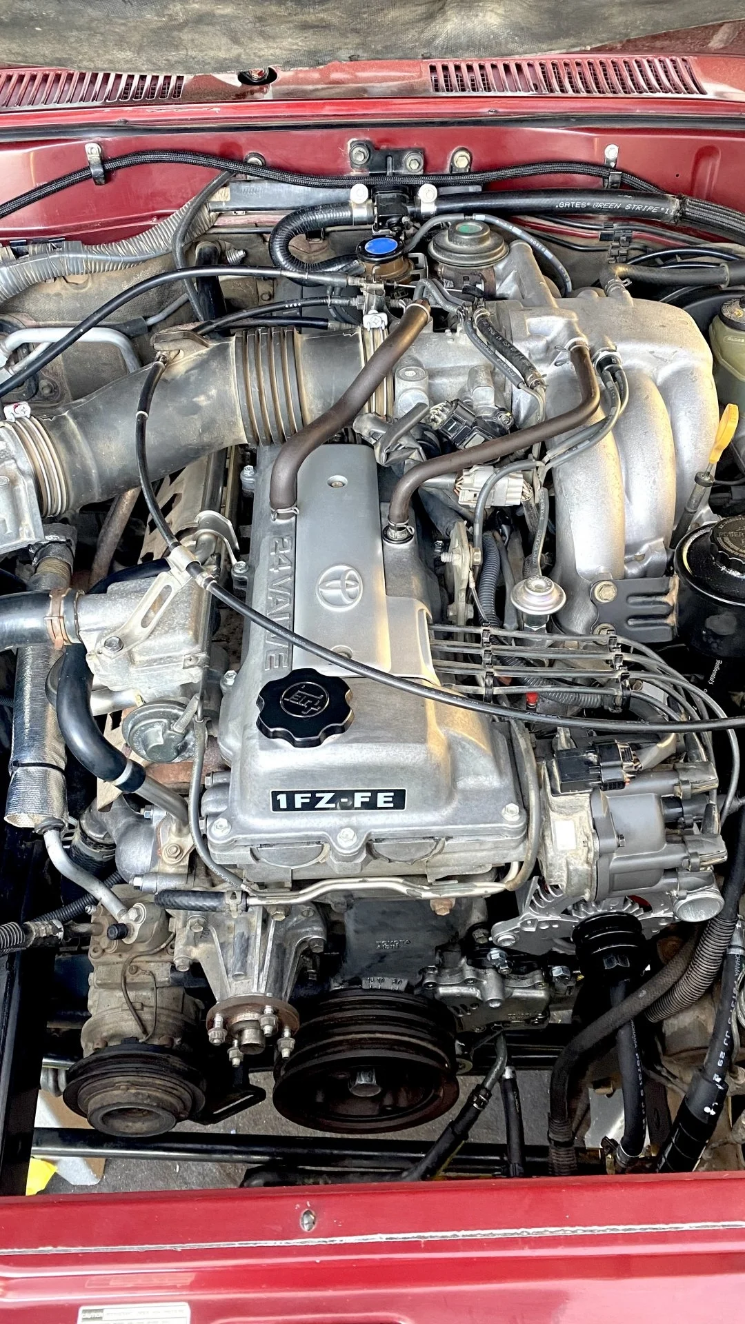

Another happy customer. Thanks @Photoman the kit and small pulley have been working great. I had the kit for a few years and finally felt like it was the right time for the upgrade. Got the reman alt from Rock Auto also. Upgraded the wiring to the battery also with a AMI fuse and 2awg wire.
Thanks. Nice pictures and a clean motor.
