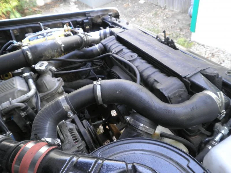

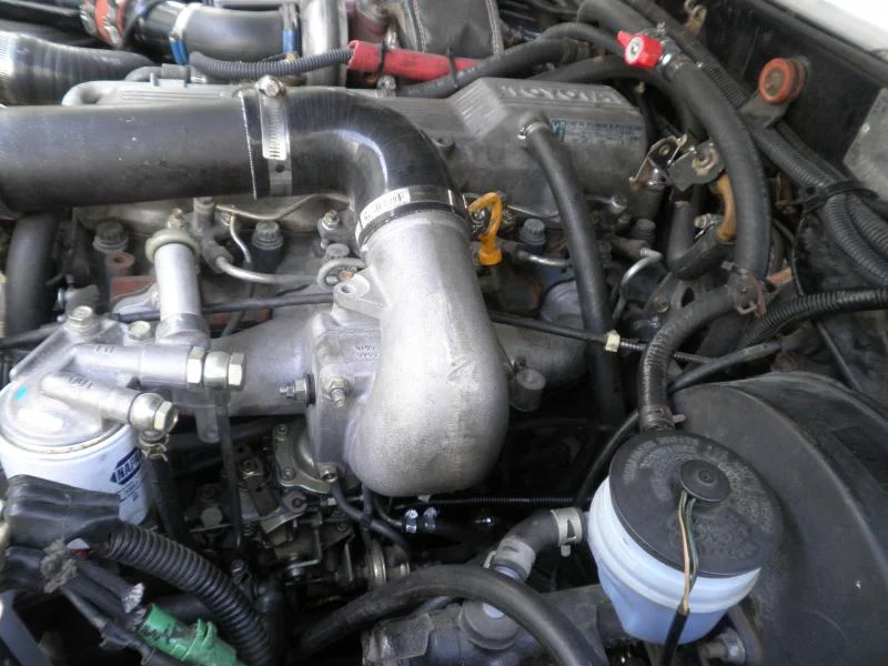

Here you go..
It was good to finally meet you Rob.
Great meeting you also Dave, small world you being friends with Lee Armstrong and Cruiser Crap guy Mark?
That 14BT was inspiring, looked so good under the hood.
Rob
Wow ! Electric fan and a breather tube that doesnt foul up the intake plumbing. As long as it doesnt get below 20f you dont really need your element heater in your intake plenum. Wow again! a 14B-T has 20+ more HP @stock settings and something like 40ft/lbs of torque. Same bore as the 13B-T and a slightly longer stroke to make up the 200cc
