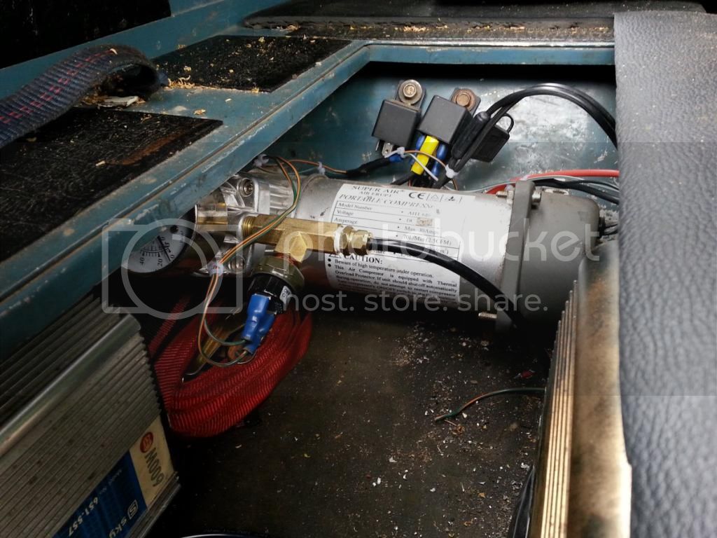

I have the pressure switch right at the outlet of the compressor on a T-piece. I don't use a tank.
I flick the switch on the dash, compressor runs...fills the line and shuts off. As soon as I open the chuck to inflate a tire the compressor starts running again. When I close the chuck it takes a couple of seconds for the compressor to fill the line to max pressure before it automatically shuts off again.
Works like a charm.:clap:
Do you have a picture and would you mind posting it?
Thank you,
I can try to take a picture of it today but the compressor is quite well hidden inside a wheelwell compartment together with two inverters.

Didnt get round to take pics today. Will take some tomorrow
