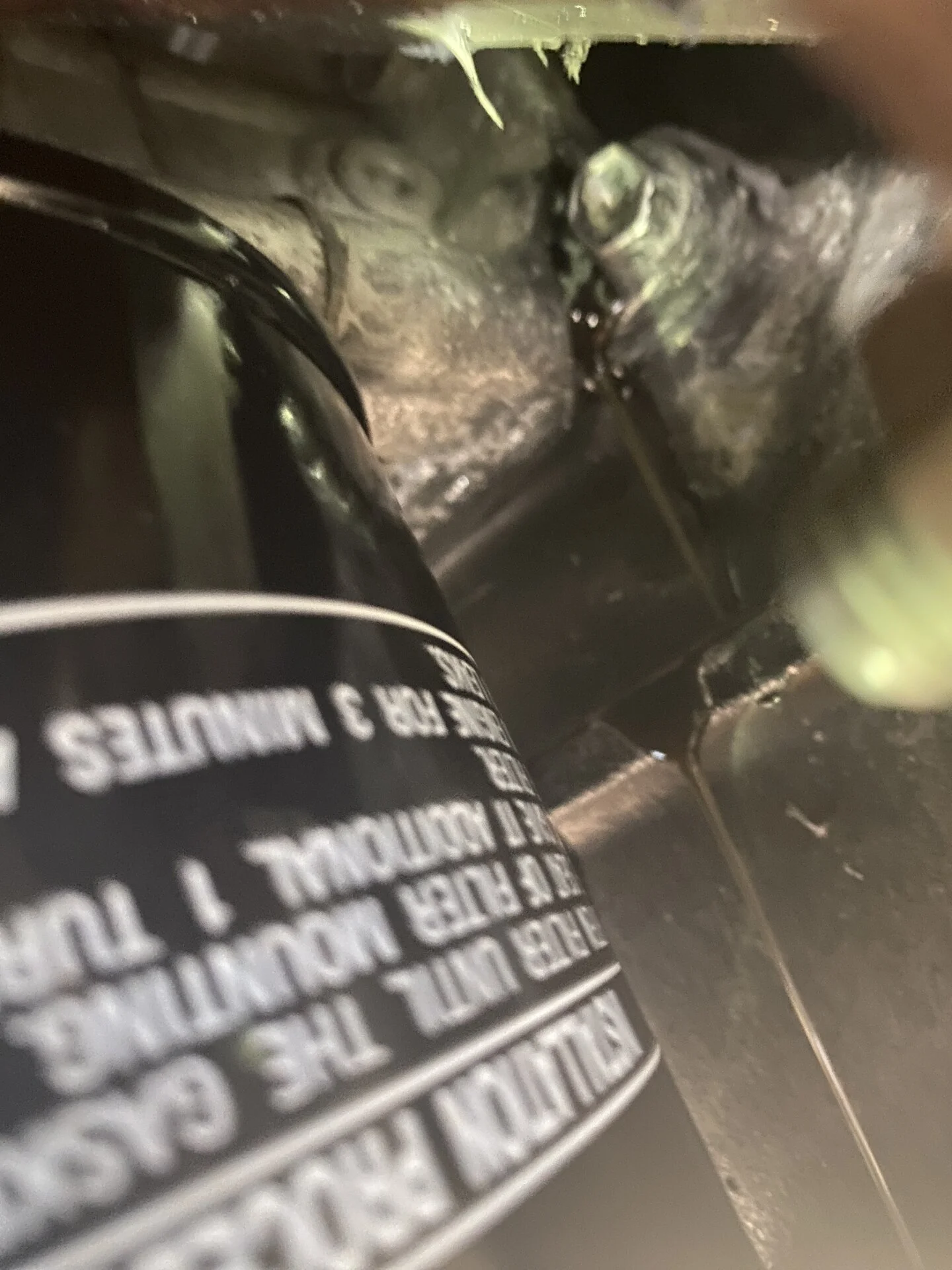

Here are a couple of crappy pics of the leak, and one of a couple of weeks back on a Friday afternoon on the beach about a km from my house…..

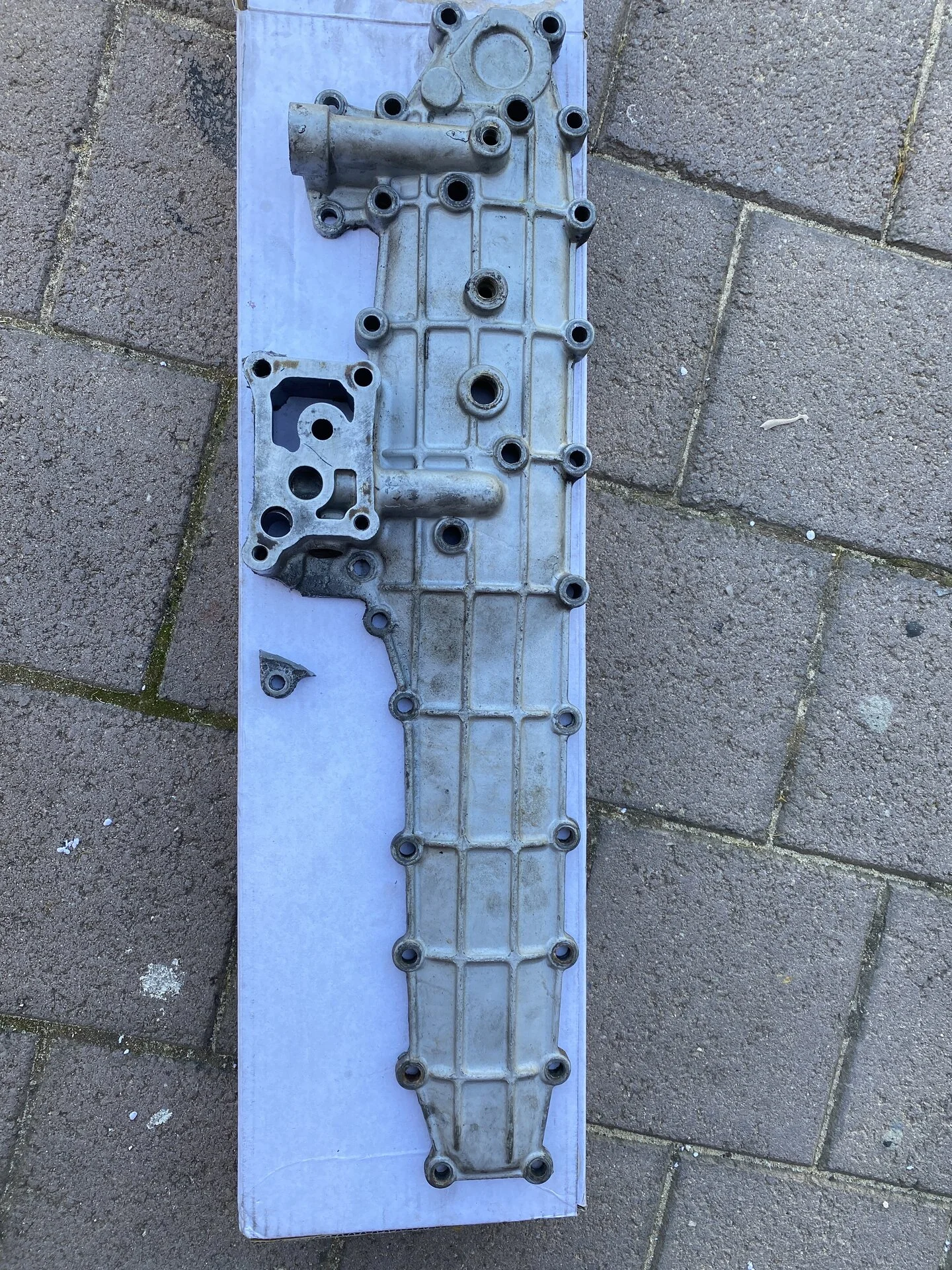

Just be aware that if your "new" housing is in fact a Kilkenny Castings product that it may need some finessing work before fitment. Given the level of work required to change out this cover I would honestly seek out a late 2H second hand housing in good condition before fitting the junk one that Kilkenny Castings sell. Their products are absolutely rubbish compared to OEM.

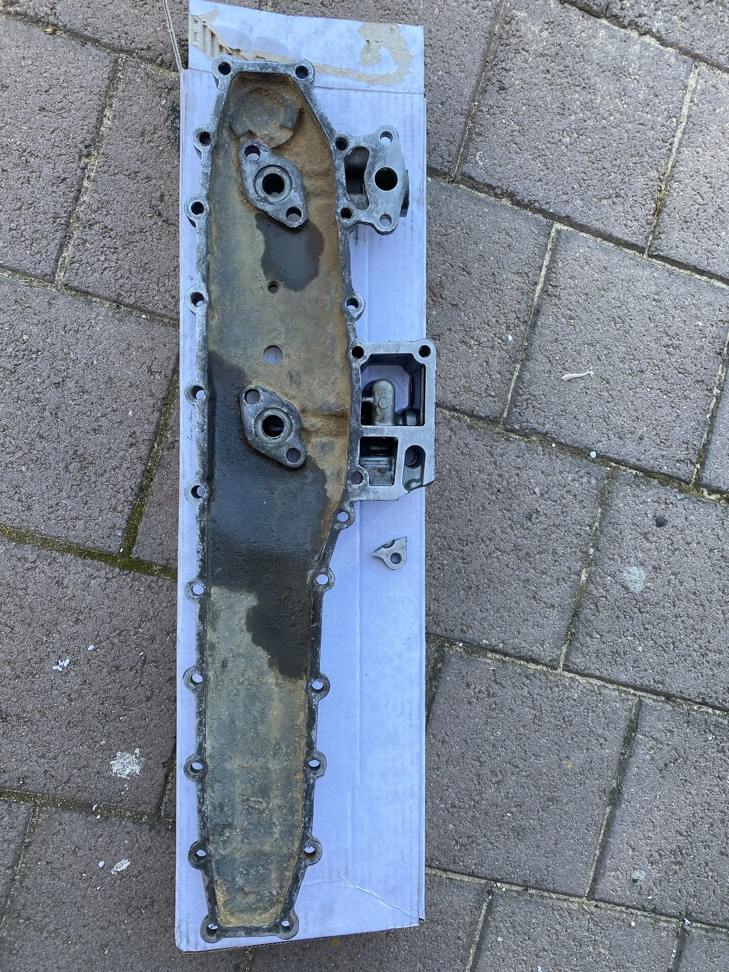

Also great photos of that crack (hornbag of a 60 too)! The lobe for that housing bolt really looks like a weak point in hindsight doesn't it. The earlier cover had a LOT more meat at that point, a comparison of the two covers below.

What a bummer. Dirty aluminium just does not repair well. Good heads up upon the kilkenny's quality, seen a few ads for them and they are not shy of asking top coin.

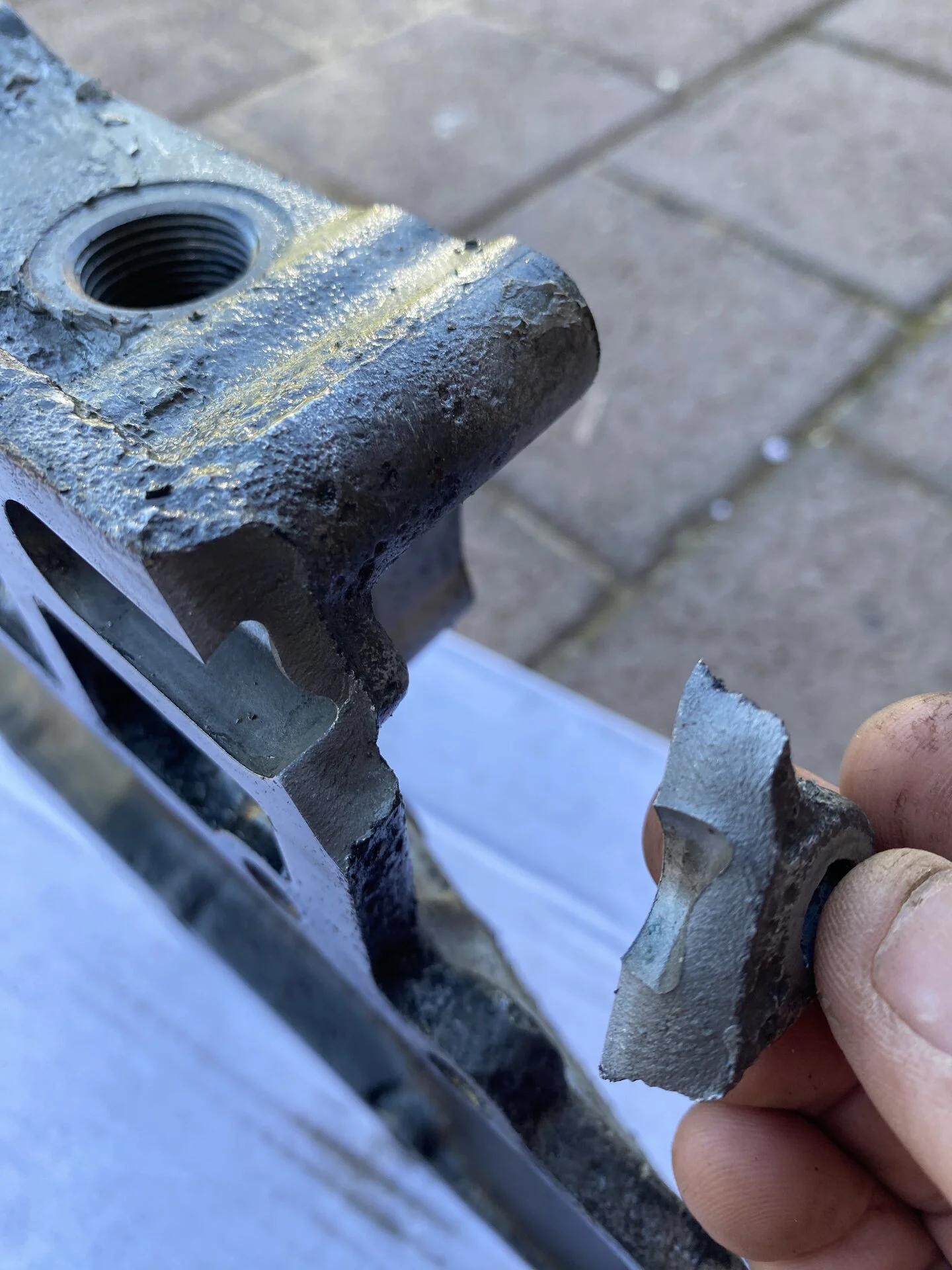

The section of the original oil cooler housing with the crack in it fell off when I gave it a bit of a wiggle once the mechanic gave it back to me… I will post photos later as it looks like a bit of a design flaw to me…

Don't like using the sad face emoji, but it is sad. It would be very difficult to repair that, all those tiny open pores in the casting would be holding dirt, grime, oil and coolant and any amount of vapour blasting , wire wheel or grinding would not remove all the muck in the pores, which would lead to a pathetic weld repair, popping and sizzling blowing out whilst welding. The bummer about old casting of aluminium. New clean aluminium is lovely to weld. alas
More I look at it, it looks the same actually..I have pulled about 6 x 2h oil coolers, at least 1/2 are badly pitted from poor coolant maintenance, it is also a classic place for the bolts to corrode and snap when removing the lower ones.

It is hard to see in the photos, but if you zoom in you can see the lighter coloured area of where it cracked. The darker area must have been cracked for quite a while I think… another 1000km trip starting tomorrow, so hope all goes well as there should be some good 4x4 tracks!!
