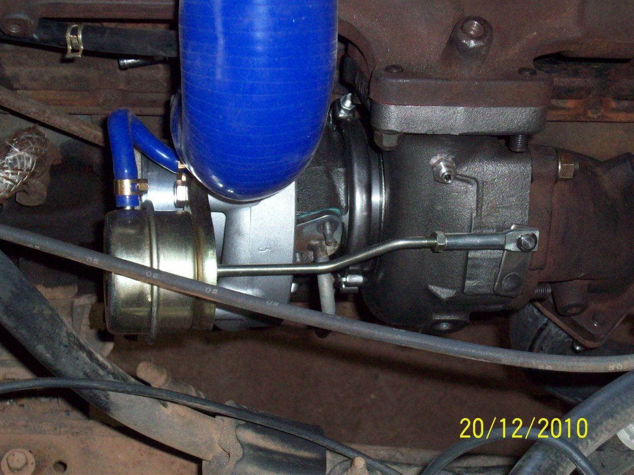

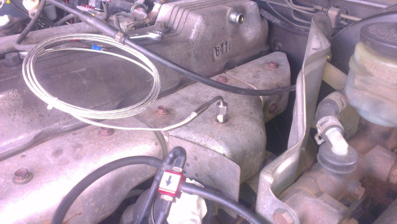

here is where i installed mine, as you probably know there is a "vane" i installed it in such a way that it is catching the heat on both rear and front of the manifold :cheers:

Rideglobally, from your pics i can't understand how you would be getting heat from the front & rear cylinders?
In the first pic it looks as if you've drilled it right into where the vane is?

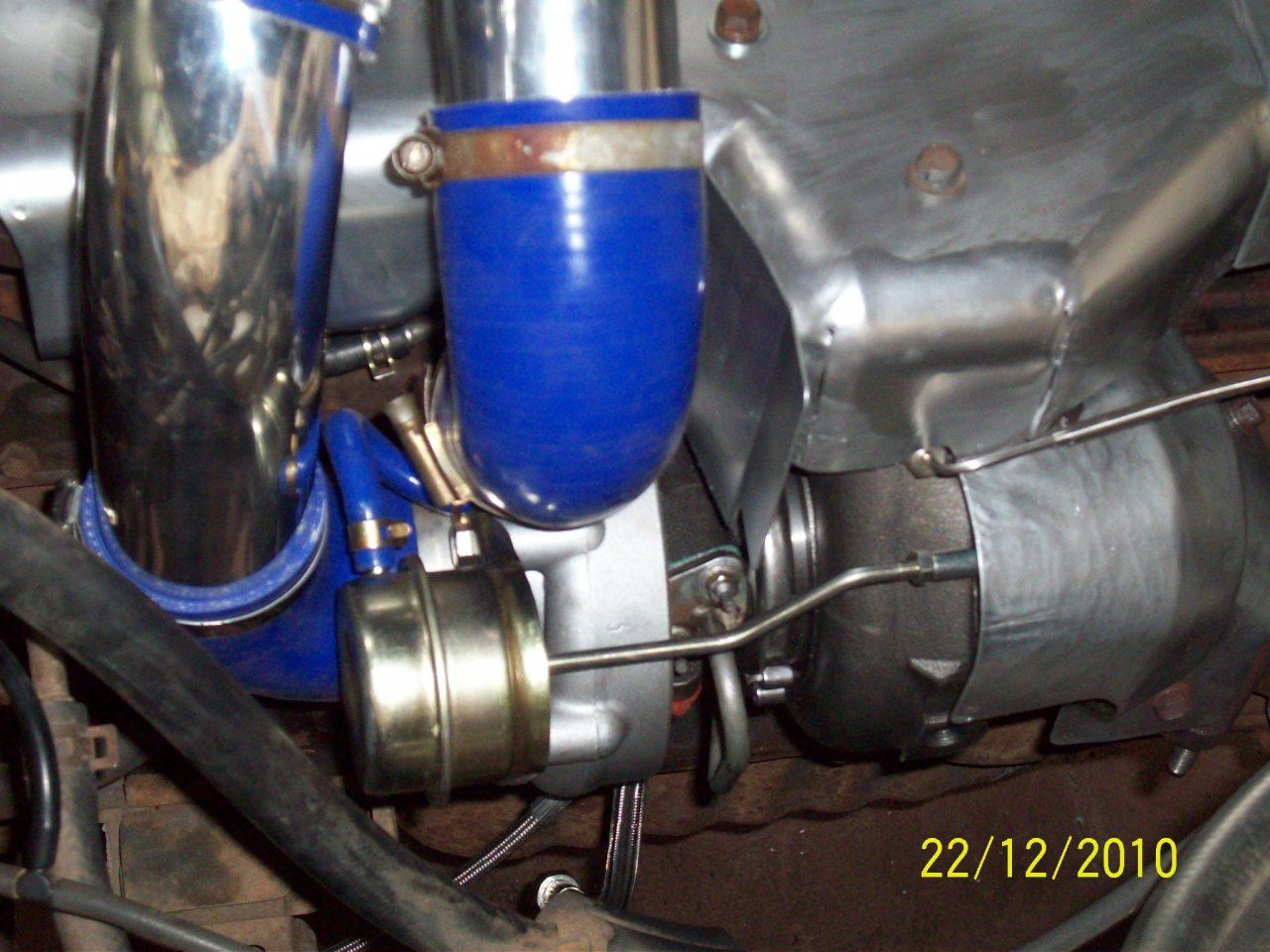

Old thread I know, but it turned up during a search and helped me some and might help others in the future so I add my own solution to the problem as well :)
Drilled and taped the heat shield screw hole. Take note; you will need an extra long egt probe!
I drilled at least 40-50mm before I got trough.
Only downside; with a turbo change you need to drill and tap it again. This is the reason why I chose the manifold :)
