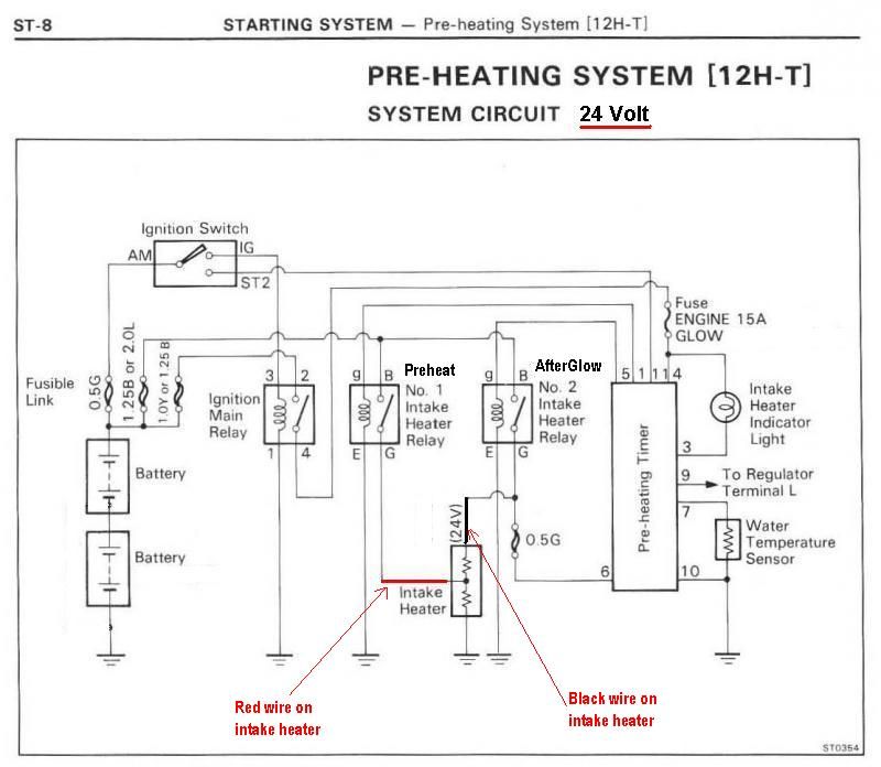

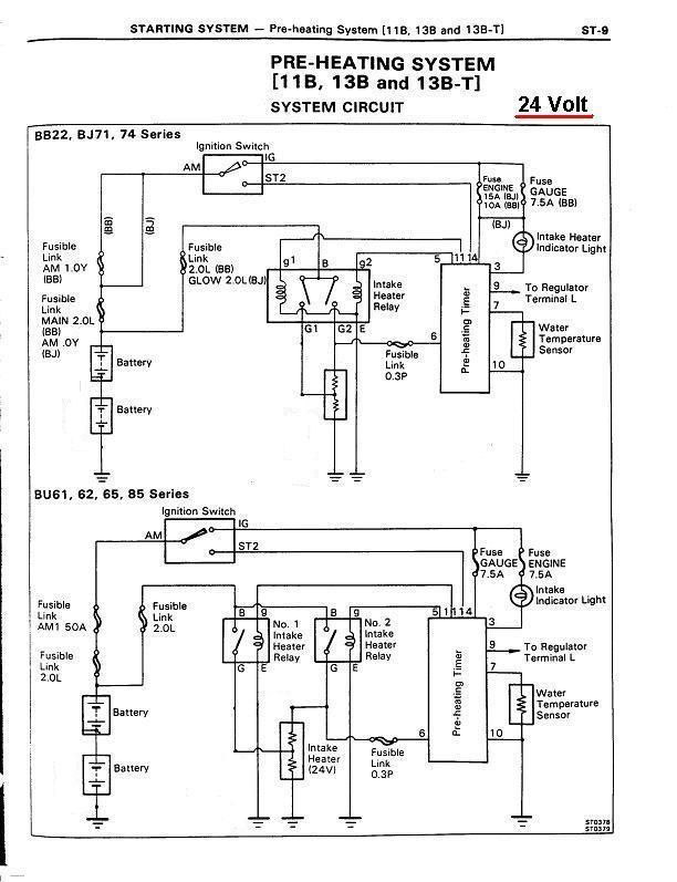

Has anyone compared the wiring diagram to a 13BT diagram since they both use a screen and are 24V system.
I still can't get my head around how 24V is being reduced to 12V for each side of the screen what would be the purpose why would it not just use the full 24V like a 24V GP system.
After figuring out where the confusion is in the Toyota way of making a diagram for both 12V and 24V systems in one diagram and showed them in post #17, I did the same for the 13B and BT in this picture. I removed the 12V set up out of this diagram so it's now a 24V only diagram, and (almost) equal to the 12HT diagram.
Does this help?
Rudi

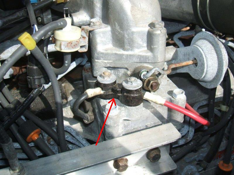

But this still doesn't explain that wierd bakelite-type bridge between the two intake terminals as shown here:
I think Lasse has a good point in that there could be a diode within that.
Or do you think this INSULATOR is just made like that so that it gets supplied as one part rather than two separate parts?

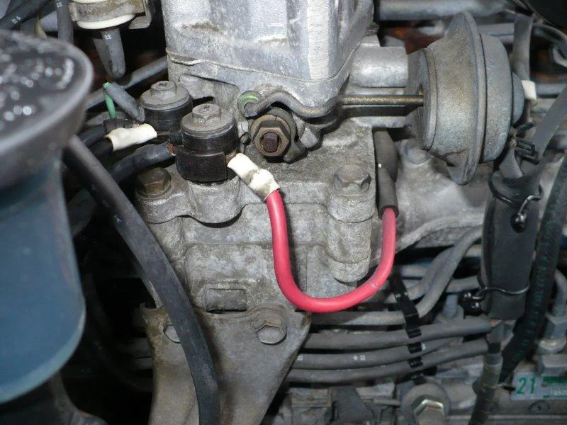

Oh and here's another pic thrown in of a 24V version already connected up:
1. The insulator.
I think it's just what it is. An insulator. Could also be 2 separate insulators but for some reason Toyota made it a double insulator or in other words 2 connected insulators. I think it's just the design. I don't know how to describe it different.
And NO, I don't think that there is a diode inside (see below).
2. The double intake heater element.
When in the pre glow situation the current goes through the #1 relay and through the lower heater element for 14 seconds. Lets say that element is 24 ohm just for the sake of explanation. 24V / 24ohm = 1Amp = 24V x 1amp = 24 Watts.
Let's assume that the upper element is also 24 ohm.
In the after glow situation the current goes through relay #2 and now through the upper AND the lower element for a time between 0 and max 70 seconds depending on the coolant temperature (water temperature sensor).
Now we have 24V / 48 ohm = 0.5 Amp = 24V x 0.5Amp = 12 Watts.
For reference:
Amauri wrote:
Reading section EM-13 in the 12H-t manual, you can see that the automatic system turns on solenoid #1 for 14-seconds during pre-start heating and up to 70-seconds with solenoid #2 for afterglow once the engine is running.
So at start (pre glow) the bottom element produces a 14 second heat boost and when the engine is running (after glow) both elements produce each 1/4 of their power assuming that both element have the same resistance of course.
Maybe somebody can do an ohm test on the intake heater elements?
What do you think Tom (and the rest of the Mud gang of course)?
Rudi

I wasn't disputing that using only half the element length could produce twice the heating power Rudi...
I was just thinking that it was a little odd to be using only a fraction of the length when you're needing maximum heating output.
But then I suspect there wasn't much logic in my thought anyway...
I'm now revising my thinking to believe AFTERGLOW full-element performance is more important than PREHEAT full-element performance... based on the following reasoning...
There's no air turbulence around the element (because there's no piston-movement) during preheat because you're not even cranking yet.
So the only air movement during preheat is the result of convection currents around the glowing section of the element. And the intake manifold (and connecting air hose) above the intake heater then accumulates "a warm slug of air" to help the engine fire when it enters the cold cylinders during the first few engine revolutions. (So using just a small part of the overall element-length for this job is just as effective as if you were using the lot.)
When you look at it this way, having the entire element in use for afterglow makes more sense because at that time (ie during afterglow) there's more need to heat the air throughout its volume (because it's moving fast) as it passes through the intake throat.
But wouldn't it be nice to see one of these heaters glowing ... first with 24V on the black wire and then with 24V on the red wire ....just to see how much of the overall element-length works during each test.

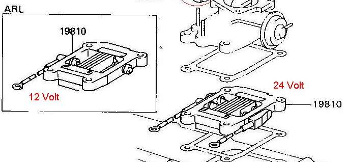

Here is my theory:
One day the H engine was born with a glow screen/intake heater instead of glow plugs. This (first) engine was 12V.
Later on there was the need for a 24V version. No problem, all electrical parts can be made in a 24V version except this glow screen for one or some reason. This screen was designed to fit between other components and there was not enough room to change that design.
By making this screen a bit thicker and changing the first (lower) element to 24V and adding a second (24V) element the problem was solved. Just re-designing this screen, add a wire, et voila. Mission accomplished. New order for Nippon Denso, no big changes and costs for Toyota.
In my previous theory I assumed that both element have the same ohm value.
But it can also be that the first (lower) element has less ohms than the second (upper) element as in a 30/70 or a 20/80 ratio to reach the desired effect. Who knows? An ohm test can shine a light in this matter.
Just my 0.02 cents.
Rudi
Just to clarify a little. Since I last suggested the insulator might be a diode I have bought myself a HJ61 and have had the opportunity to experiment a little.
The studs that the terminals are tighten down to are a part of the intake manifold/butterfly valve construction and derby are grounded. So this insulator are a simple plastic insulators to avoid grounding the terminals. I measured a 0.1v potential between the studs and battery ground but that I blame poor grounding of the intake manifold for :)
The mathematics of BJ40green is correct. Connecting just one yield a higher amperage drain and higher power draw. Connecting both in series will result in lesser amperage draw and lesser power.
If you are in a really cold climate and struggle with cold start you can modify the circuit so that you connect both in parallel for super glow and one for afterglow.
Then you will have 4x more heating power on superglow than what you had on afterglow before or respectively twice the heating power in superglow and afterglow compared to oem design. Just account for higher amperage draw and that wires and solenoid are designed for these loads.
