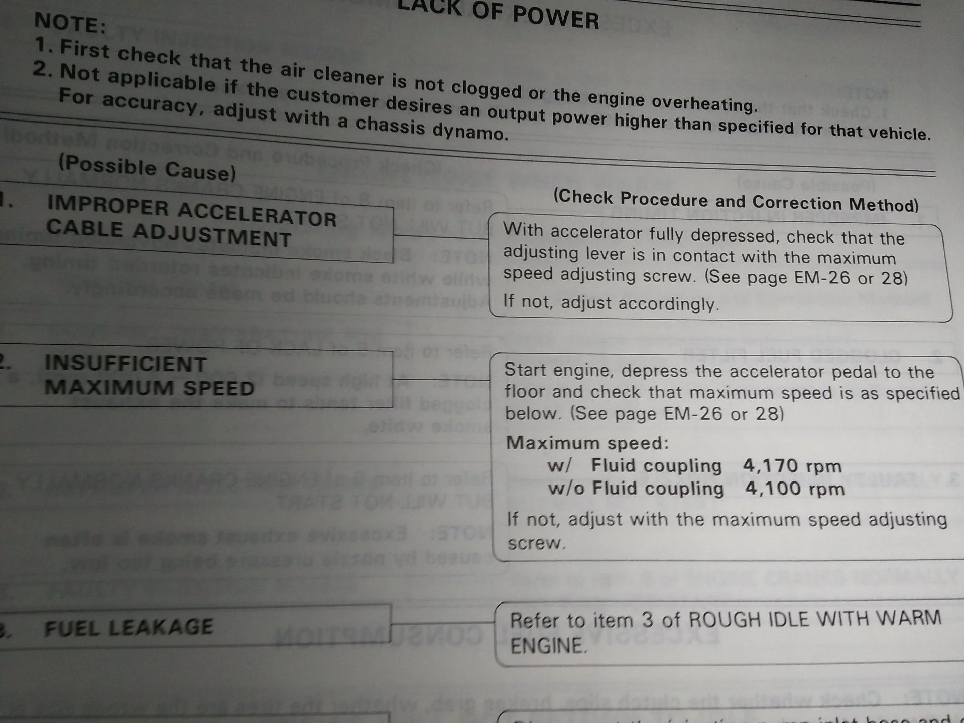

The Toyota diesels all have a procedure in the manual where they should have a max rpm speed in neutral. Its about 4200 for all of them but you would have to check the manual for the 12HT. From memory its in the Fuel Injection part.

The governor should limit max rpm before red line, but for most people, your ears and the pucker factor will cut rpm well before the governor does :lol:

Revving it to 4200 just tells you the fuel pump and injectors are working ok. You are a baby.

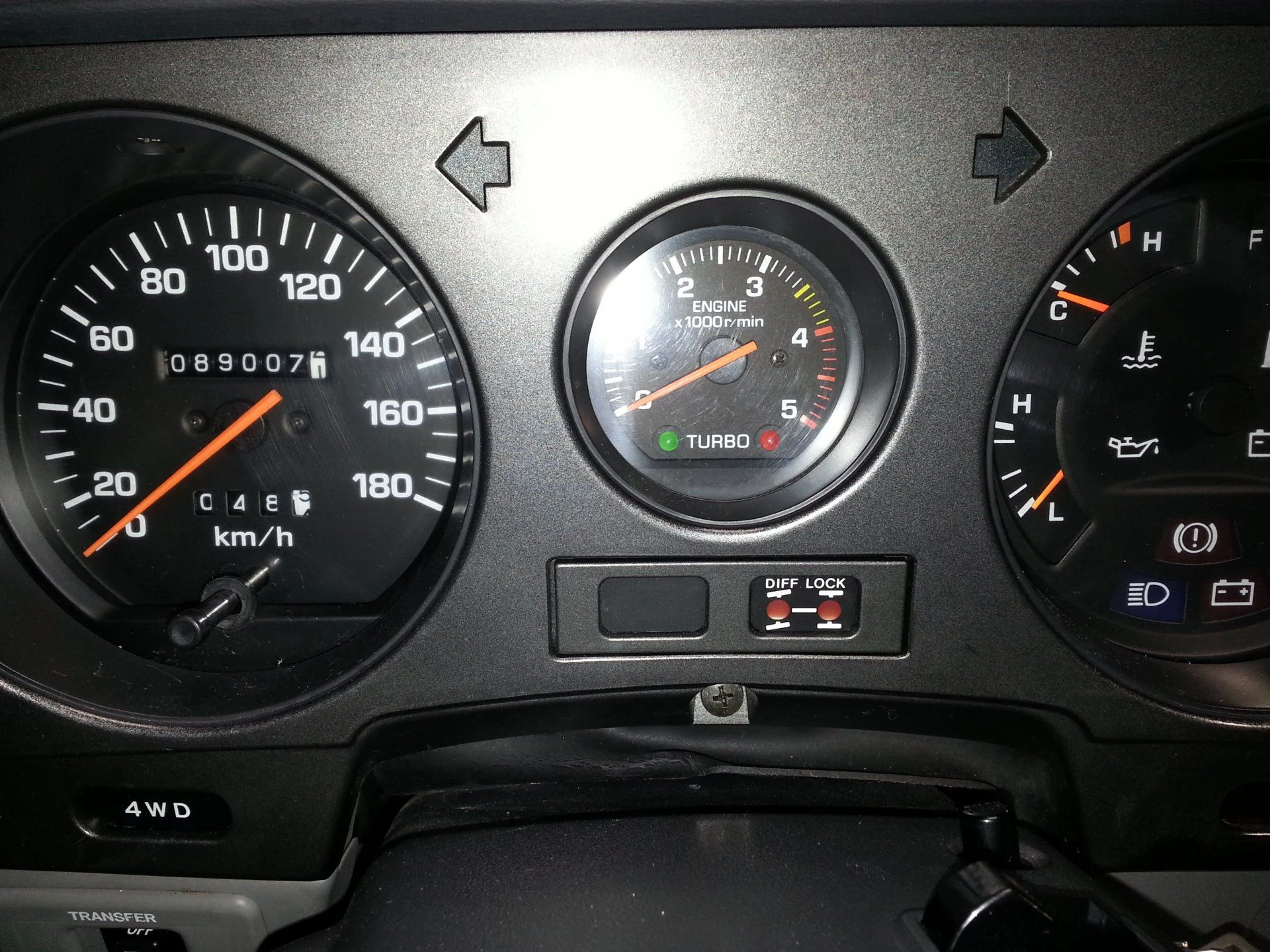

1987 HJ61 tach:
I think most of you missed the point of my post about revving it to 4200. It is a test outlined in the manual to see if the engine is getting enough fuel. You don't need to hold it there for 10 mins, just a few seconds.
Yes I have done it. For the doubters, look in the good book for yourself.
Its a quick easy way to check it. The other way is to put it on a dyno @$200 an hour. This test is applicable to all Toyota diesels but check the RPM specs

Why would I want to routinely do it? Its something you do as a test when there is a problem.

Its done in neutral, did you read the post? The test is telling you that if it reaches 4170 or 4100 rpm in neutral, then you will have enough fuel under load in gear at normal rpm range.
Its a simple concept.
Whats that got to do with it?
I simply posted it as a reference. The "yellow" zone is 3,500 to 3,900 RPM and it turns red at 4,000. The original poster may not have seen an OEM 12HT tach before.

Yes I read the post. I also wasn't replying about your service manual reference.
