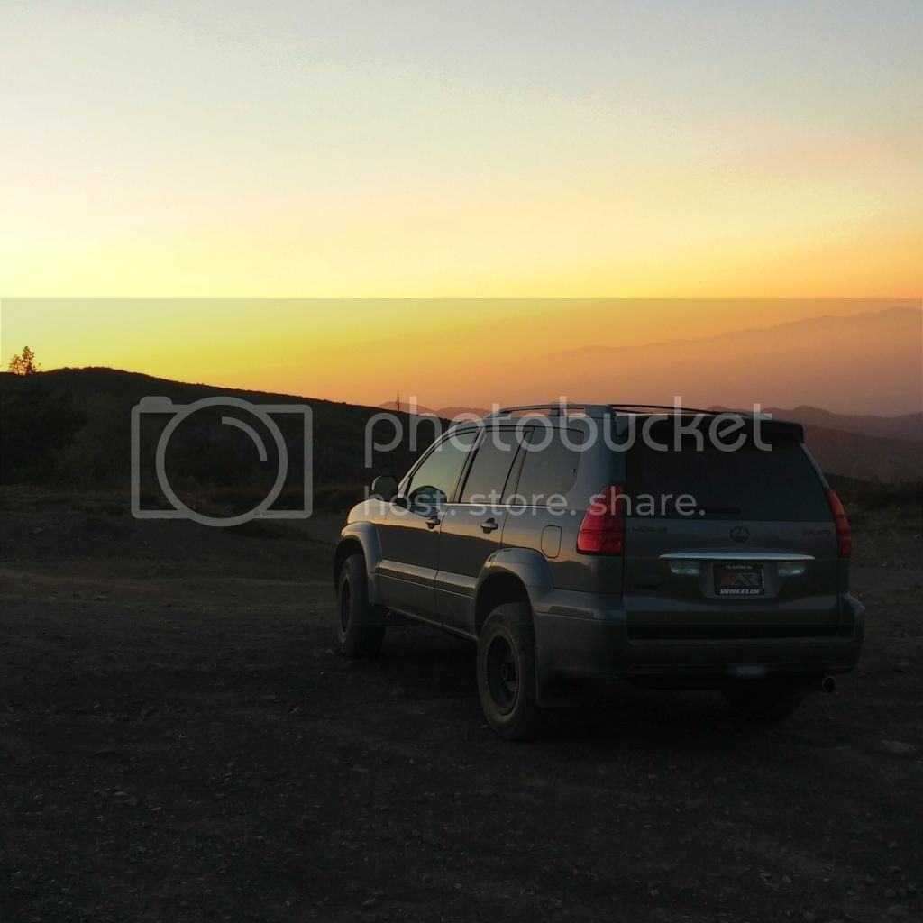

2004 GX470. ExPo member TexGX built it. I bought it. Blacked out the rims (Plasti Dipped), relocated the backup camera (custom tire mount obscured it) and just driving it for now... More to come...
