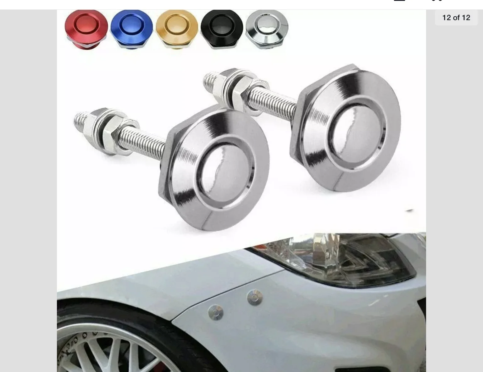

Has anyone used this method of fixing the fender issue?

I, of course, have this same issue where the bumper upper corner keeps popping out on the passenger side of my 2013.
While I like the idea of the flat aluminum plate added to the grid area of the mount bracket, it doesn't look like this has done much to help that upper corner to stay tucked in. Do you all think that's more a result of not counter sinking the aluminum into the bracket? -- like, if that lower area is pulled in closer, the corner will also pull in closer, so perhaps will do the trick?
I have previously tried 3M VHB tape right at the corner, by it didn't help. I now have the bumper all the way off for installing a Victory Strike bumper, and I'd really like to get the upper corners of the factory bumper to hold tight right there. -- especially since I'll be chopping off most of the lower portion of the bumper to make way for the Victory one, so basically all that will be left is this upper corner section that already doesnt want to stay attached.
(In hindsight, I wish I went with a different after market bumper that replaced the OEM bumper all the way up to the headlights. )
So after the Victory bumper install is done and the original bumper chopped to fit, its been a couple weeks now, and the plastic seems to no longer be popping out under the headlight like it used to. Lucky me. :P (Sorry, I know it doesn't help any of ya'll with full OEM bumper still.) I do feel like it will just come back again though.. and if it does, I'll be trying the flat metal idea like was posted.
