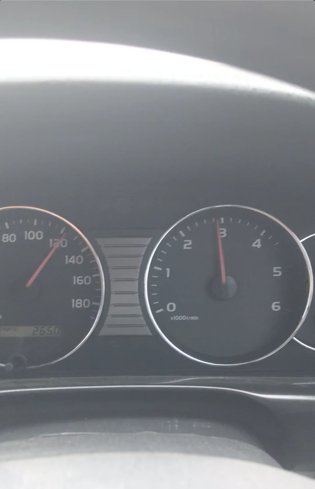

Photo from my 2005 105 check the rpm at a little over 120kph. It has 1HZ engine.
My 105 would be about same revs, on 285/75
