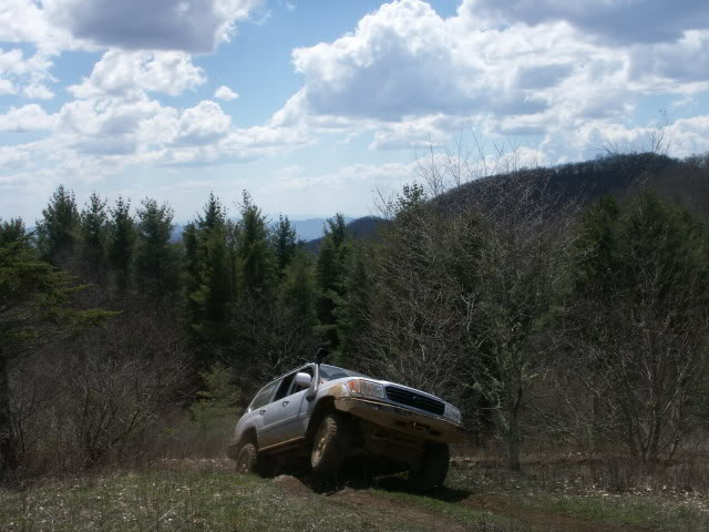

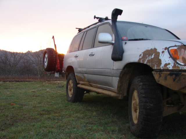

Couple of pics for you...

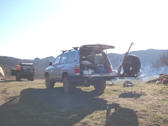

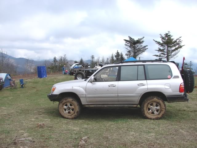

Thanks. i love your Cruiser. Anymore pics?
Not great about keeping pics, but here are a few...
