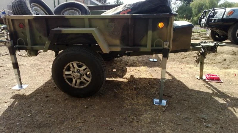

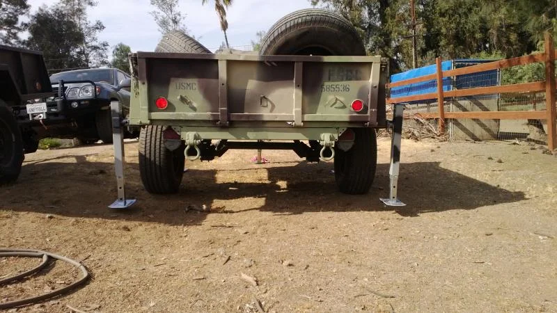

I did this mod already. converted a M101 A3 to use my Factory 100 wheels. My neighbor made adapters to convert from 8 log to 5 and retain the factory m101 hubs.
A few pics.
The adapters in this thread are currently for sale...contact wngrog
These work for the Military 5 lug to the 100 5 lug. The later 8 lug Mil trailers (M101a2, a3) need a different solution.
