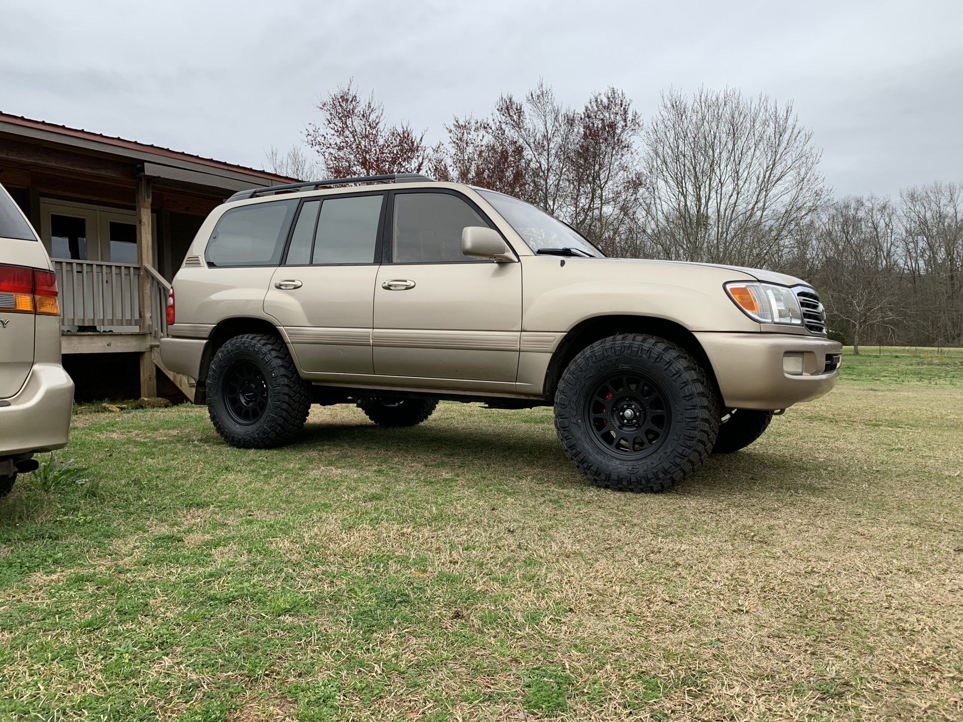

17” Method 703’s, +35 bs, very slight rubbing at the back when turning, heat Gun fix to “mould” trim to the pinch weld, didn’t have to mess with pinch weld. Haven’t really had a chance to stuff it up all the way yet but a quick trial at home with enough flex to loose traction on one rear wheel resulted in no issues, made sure I turned wheel side to side, no issue.Looks great man! Are those 17” or 18”?
any rubbing issues? Lift details?
@sholie
Oh, no lift.17” Method 703’s, +35 bs, very slight rubbing at the back when turning, heat Gun fix to “mould” trim to the pinch weld, didn’t have to mess with pinch weld. Haven’t really had a chance to stuff it up all the way yet but a quick trial at home with enough flex to loose traction on one rear wheel resulted in no issues, made sure I turned wheel side to side, no issue.
