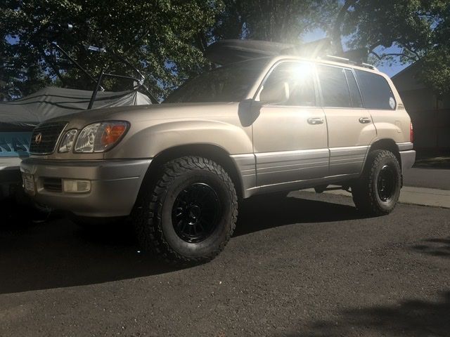

I just purchased a 2005 LX and looking for wheels/tires. These look great. Do you happen to have a pic of the whole truck from the side? I'm assuming no spacers? And if I keep the factory side steps on there (for now), do you think that will create a rub situation? TIA
I got very minor rubbing on the plastic mount shield with 285/75/16 tires. I just heated it up a little with a propane torch and now no problems. No spacers. I’m happy with them.
Hi there, we offer our line of wheels in the 100 series 5x150 fitment. For the 17"s, we have a 17x8.5" (+15mm and +35mm offsets) and 18x9" (+25mm offset) fitment. If you do want to retain the center cap, you will have to run at least a 1.25" spacer for the center hub to clear. Pictured here is our 17x8.5"s (+15mm) using a 1.25" spacer, if you have any questions let me know!
both offsets fit without spacers just without the center caps?

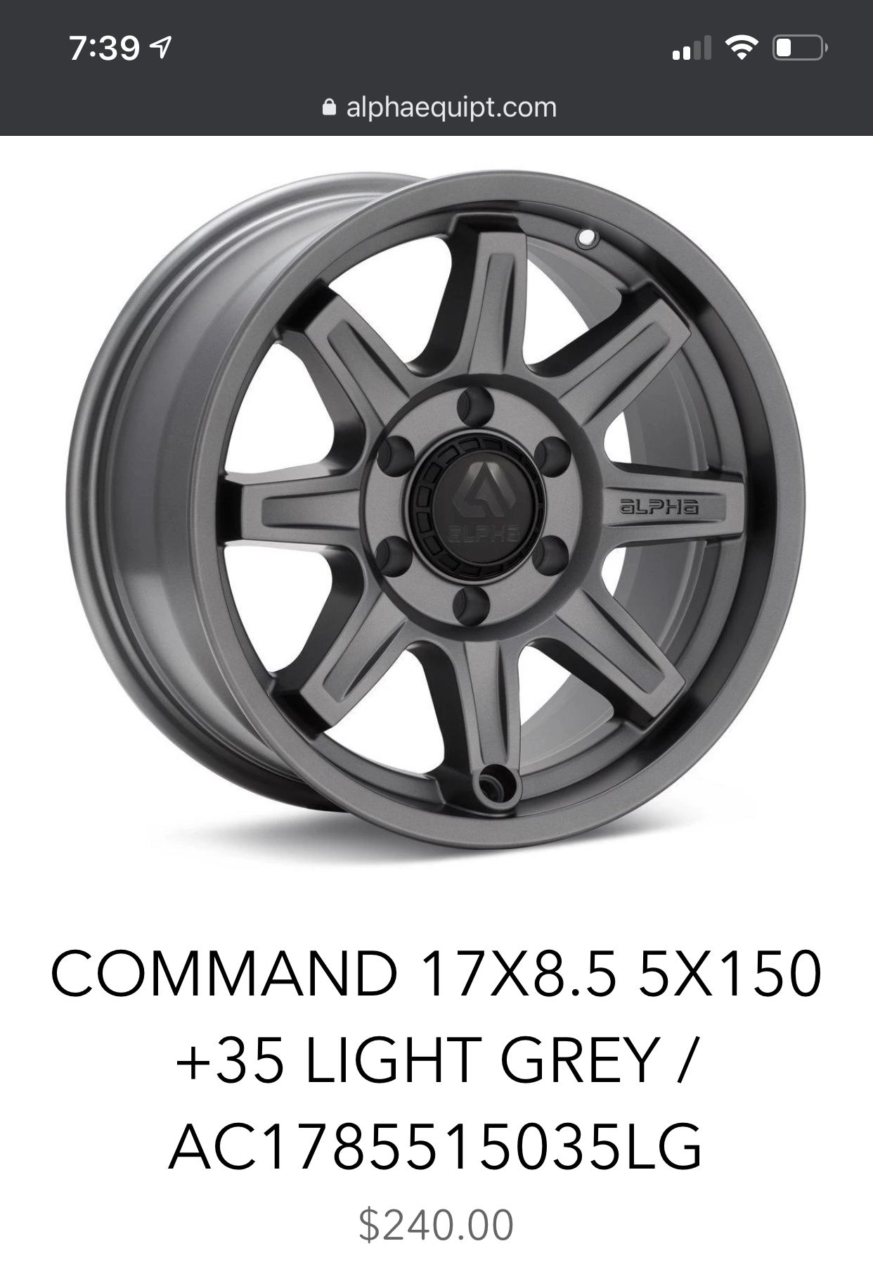

I think alpha wheels offer that offset. I looked at method’s website and didn’t see that offering you mentioned. Where’d you get that info? I’ve been itching to get wheels and was going to compromise with icons...
4wheel parts list them as “new” on their site, been searching for a week or two for something I liked and ran across them today, was going to settle for Icons in +25 until I saw these.
Nice. I think I recall that method mentioned that offset when they announced the wheel. I’ll have to give them a ring. I was interested in the 703s and it checked all the boxes but didn’t want the zero offset. Thanks for sharing.
