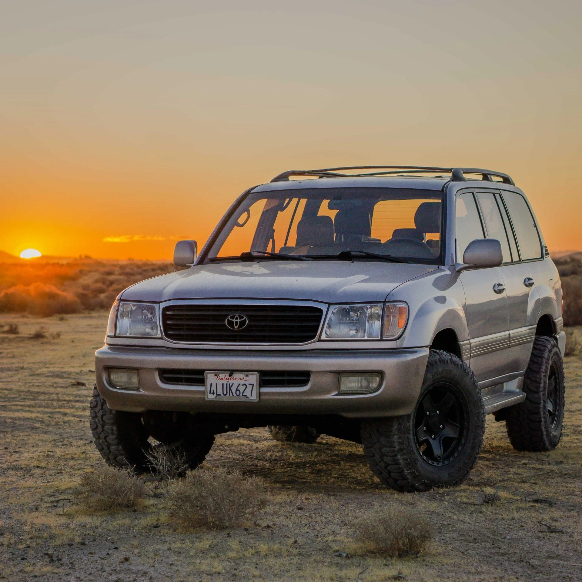

Hi there, we offer our line of wheels in the 100 series 5x150 fitment. For the 17"s, we have a 17x8.5" (+15mm and +35mm offsets) and 18x9" (+25mm offset) fitment. If you do want to retain the center cap, you will have to run at least a 1.25" spacer for the center hub to clear. Pictured here is our 17x8.5"s (+15mm) using a 1.25" spacer, if you have any questions let me know!

Hi, I actually put you on the list. However, I think there's a lot lacking on your website. There's no specs on your wheels listed on the website that I've looked at or perhaps I'm not looking at the right place. Are these hub centric, what's the center bore, and what are the load ratings? Kind of important for people who are looking at wheels for more than their looks.

Good looking wheels but you gotta offer 16” for the hundy crowd.
