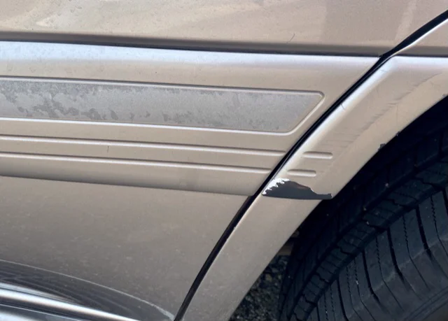

Hey guys, new to the forums. Just picked up my first Cruiser this week, an ‘05 1-owner with 130k from TX. really excited, but the exterior paint, particularly the plastic trim pieces, is rough in spots.
  1. How do I repair the plastic spots where the paint is peeling off outright?
  2. Is there anything that can be done to the fading, scratched trim pieces to make them look better?
Thanks!
Since you haven't gotten any love...the palstic trim can be painted to match the body, or any other color for that matter. You MUST use adhesion promoter to get the paint to adhere, though.
Check post #288 I think it was.

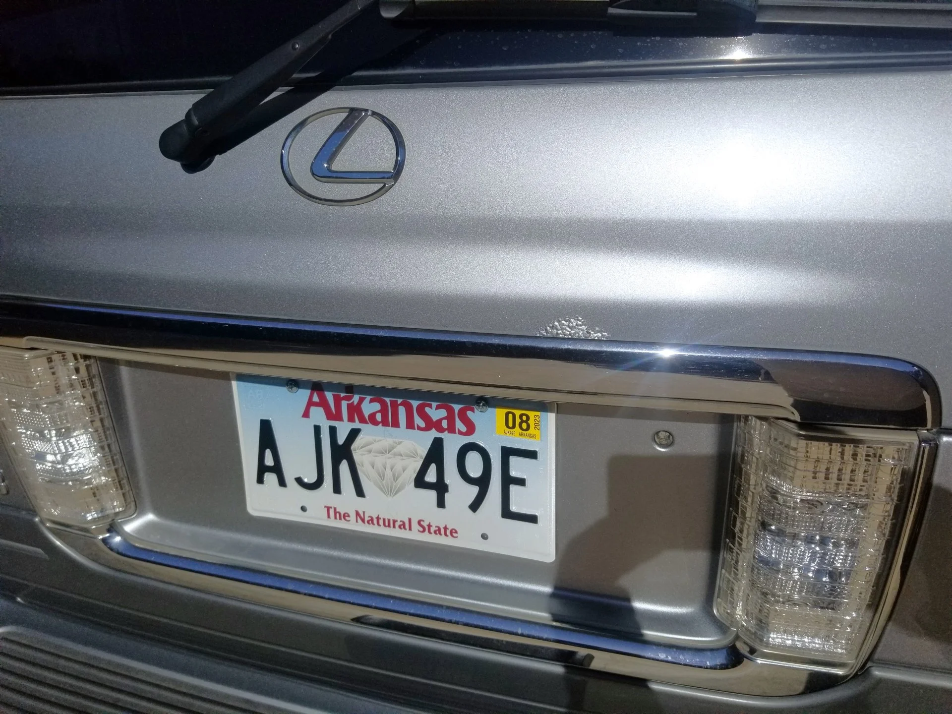

Not specifically your question, but wondering if anyone has any tips for removing the bottom chrome piece from the upper rear hatch? You can see the small rust bubble that I would like to address, but need to get behind that piece of trim. Is it attached by clips, adhesive, double sided tape or some combination?
It's a combination of 3m double-sided emblem tape and two plastic clips. All clips were accessible from the inside on the inside of the tailgate/hatch or from tag lights. The lower portion was a combination of buts, clips, and tape. I used fishing line (80 lbs test) and a heat gun. It took me about 30 mins to get the tape to separate. Then I used a rubber wheel from 3M to remove old tape along with acetone. Wrapped in satin black and reinstalled. Didn't like that so I removed it and painted it.
Thanks, that really helps. Had to replace the headlights, and cracked one of the front trim pieces, which has made me a little hesitant.

Biggest piece of advice I can offer. Not an expert or anything here but be patient. Go slow. If you think it's too slow go slower. It will come off with gentle pressure and patience. Or you can just buy another one from a junkyard and rip yours off. Haha
