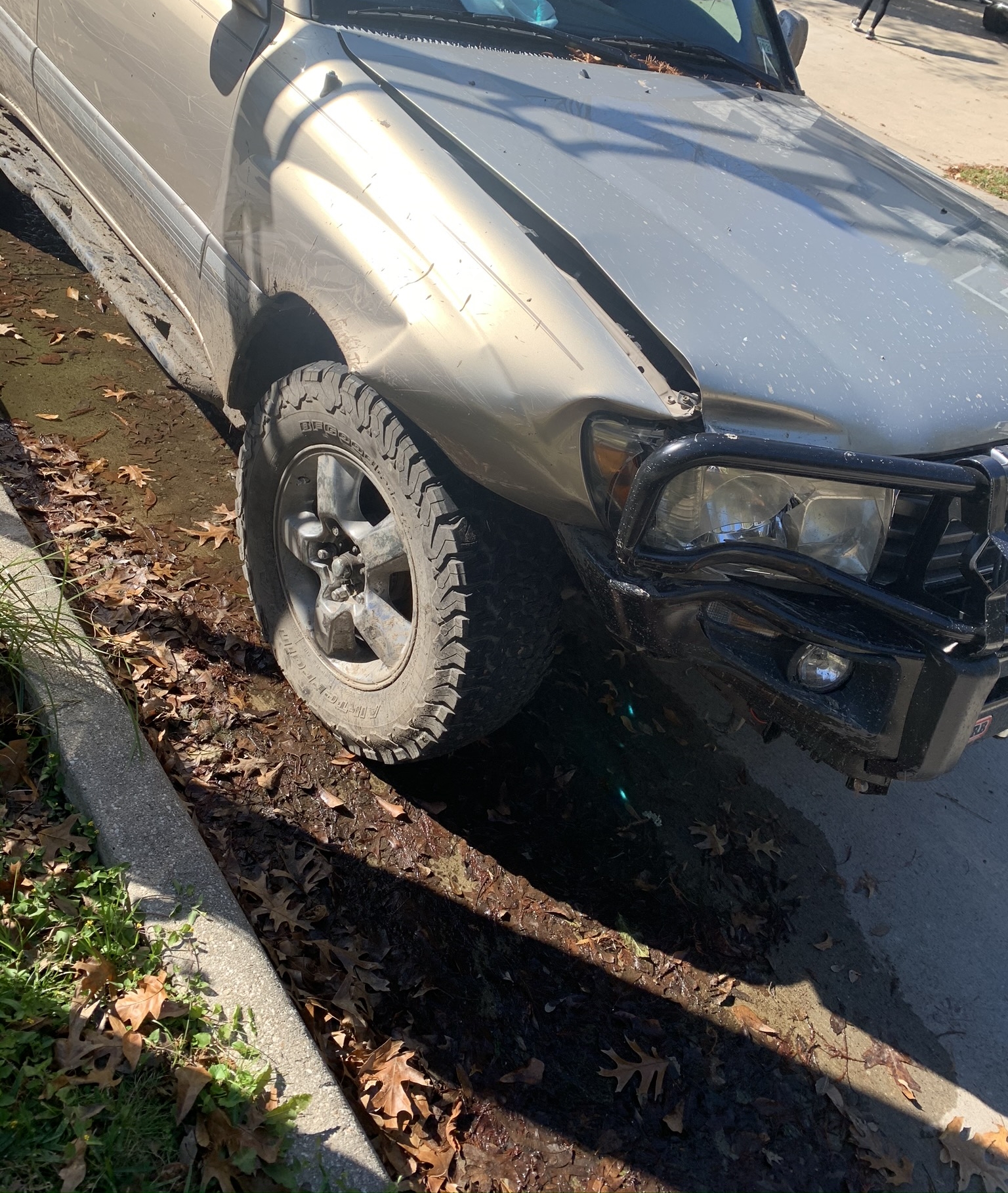

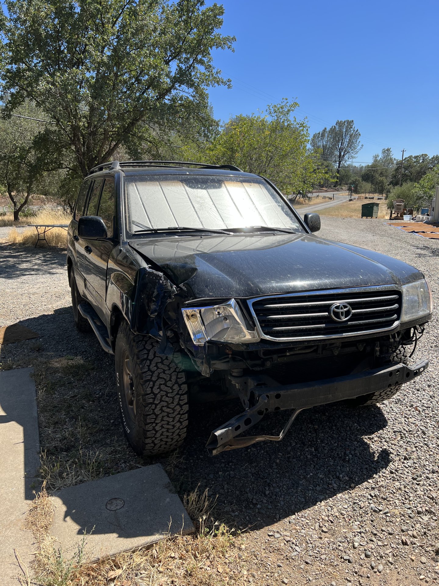

As the title states, 2000 LC picked a fight with a tree and lost, so I could use a little help on diagnosing which parts I’ll need for repair, if any members might have some of those parts, and lastly any shops that I can trust.
From LA area but have been living in Chico (NorCal) for a few months which is where she’s been parked. I’ve called junk yards all around from Chico, Sac, LA even down in San Diego and so far no luck. I found someone online but they’re in Washington so them or having parts shipped online would be plan B. I did manage to find a shop in SoCal called TJ’s Auto however I’m not sure she’s in good enough shape for the 8+ hr drive down there (the air intake fitting is broken and misaligned)

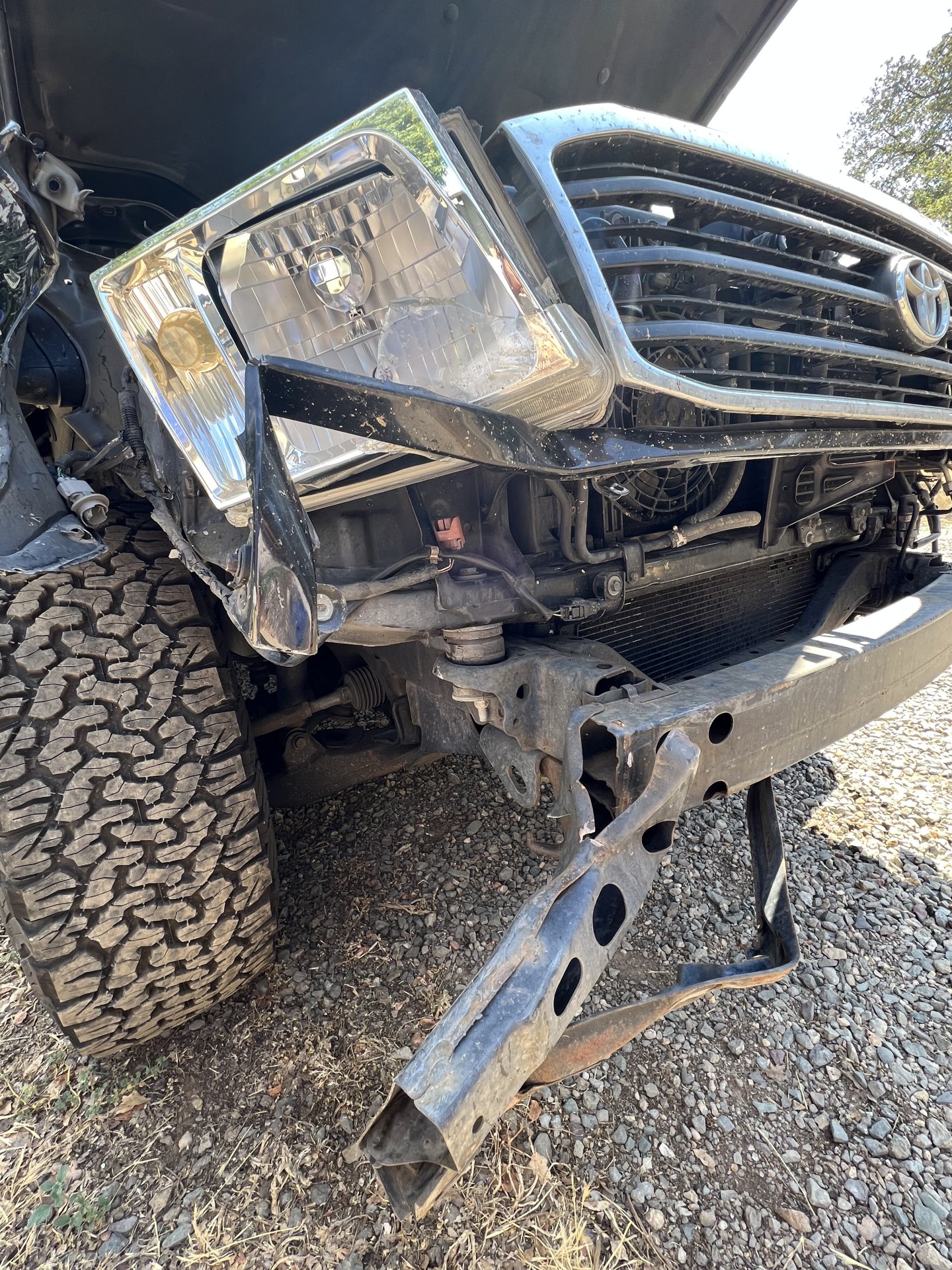

Don’t know all the proper part names but so far I know that I need:
-windshield (can get that done anywhere)

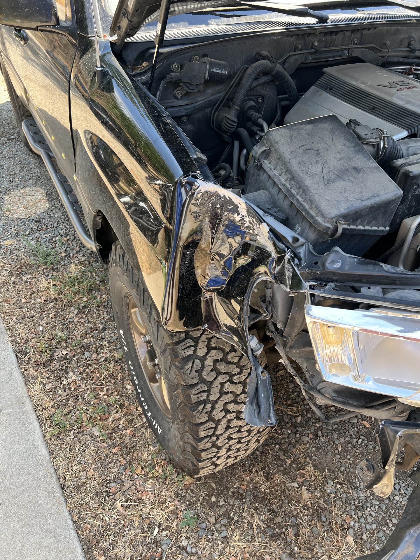

-passenger fender
-plastic inner fender guard
-turn signal light
-passenger headlight
-metal trim piece (goes under grill and headlights)

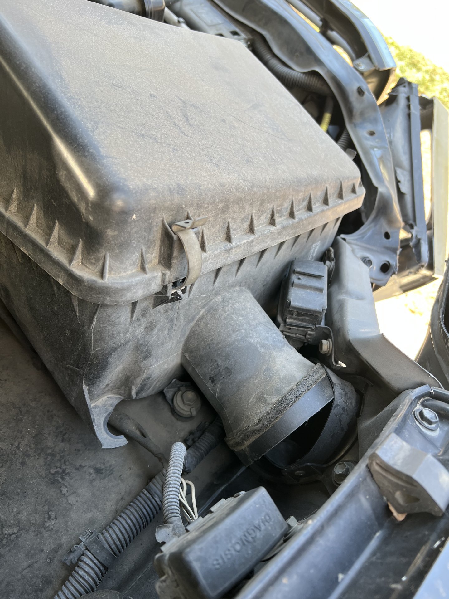

-plastic airbox (tabs broke from crash)

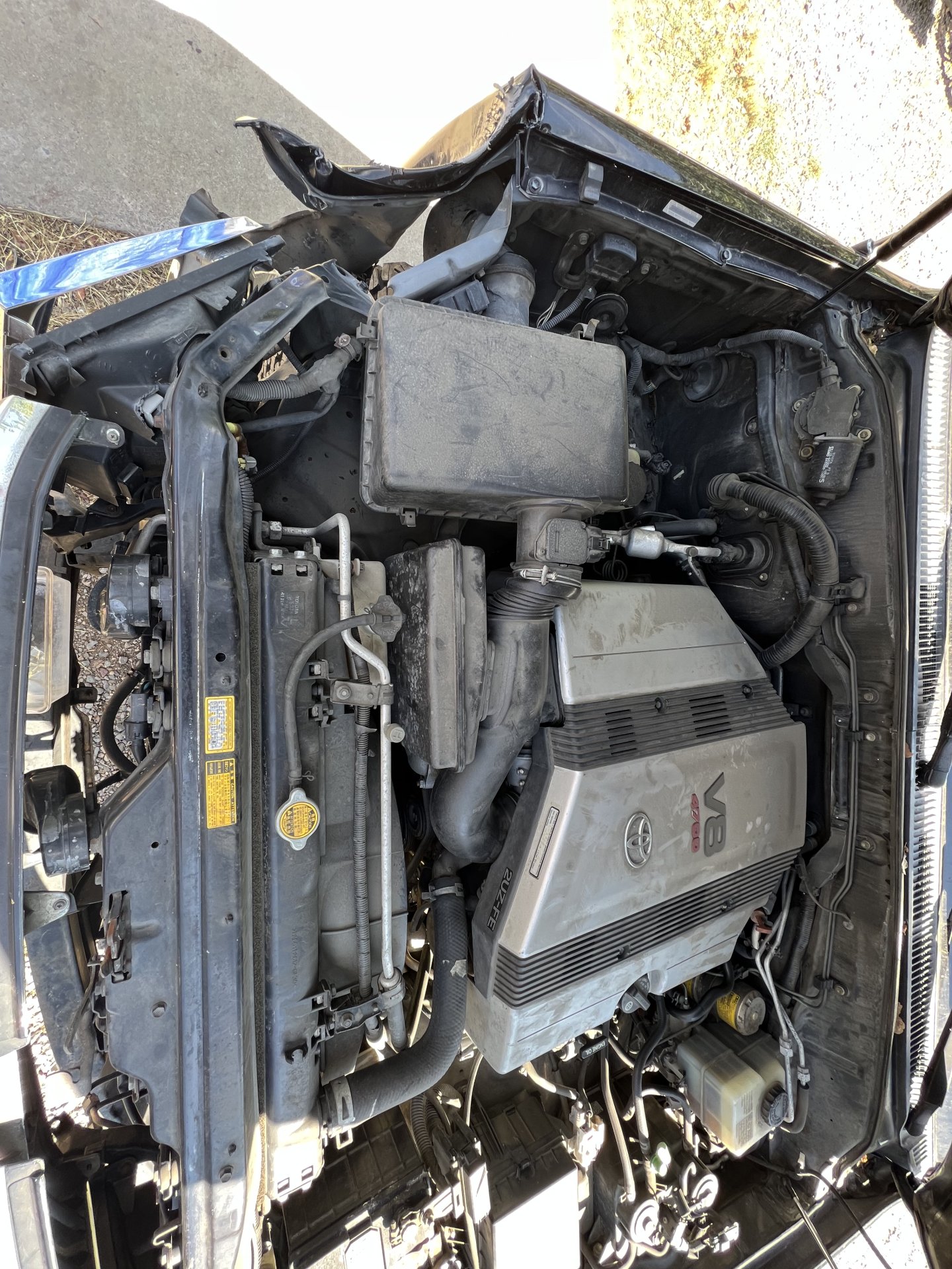

-metal radiator mount/panel (passenger side got bent unless that can be bent back?)
-metal piece that goes on the side of engine bay (behind passenger fender, what parts bolt onto inside engine bay)
-hood (not sure if worth replacing or maybe having body shop fix/bondo dent and repaint?)
-bumper (was thinking of maybe installing a dissent bumper so I’m not as worried about it)
I appreciate any leads on parts, shops or overall input on how to go about fixing her up.
Thanks in advance, wish it were under different circumstances I was making my first post 🤷🏻‍♂️

Fortunatley many of the body parts are avalaible aftermarket.The radiator support and inner fender/apron are not avalaible to my knowledge. the radiator support for later years is avalaible, and I can't think of why it wouldn't fit but they claim different part numbers. Those are your two big ticket items, costing at least 500$ each.
-passenger fender Aftermarket available
-plastic inner fender guard Aftermarket available
-turn signal light Aftermarket available
-passenger headlight Aftermarket available
-metal trim piece (goes under grill and headlights) Front end filler panel 5390360040 Aftermarket available
-metal radiator mount/panel (passenger side got bent unless that can be bent back?) Radiator support 5320160140
-metal piece that goes on the side of engine bay (behind passenger fender, what parts bolt onto inside engine bay) Passenger inner fender/Fender apron 53710-60210
-hood (not sure if worth replacing or maybe having body shop fix/bondo dent and repaint?) Definitely replace, Aftermarket available
