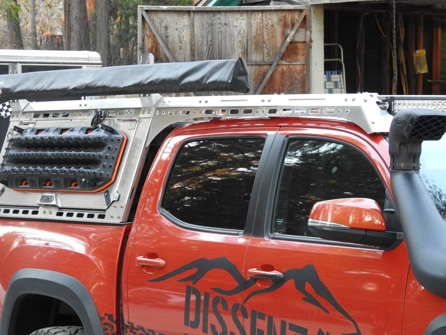

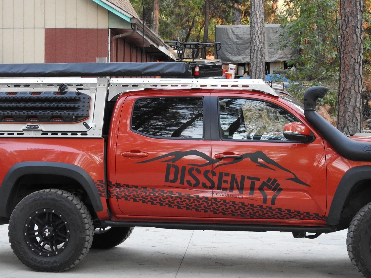

Here is a teaser of the Tacoma rack. The 100 rack will be the same basic design.
Stay tuned.
Pardon my French but...........HOLY CRAP! That Taco setup looks ridiculous! Can't wait to see what you're cooking up for the LC/LX. Inching closer to my "creative" accounting freeing up the necessary funds to order my LX Bullbar bumper from you @benc
Thanks guys!
I know this thing has seen many different styles but this is the one I'm sticking with.
Originally I was going with t-slot extrusion but decided against it for cost and weight reasons.
As with all my products the rack has slots and holes all over for endless accessory mouting options. I ended up going with a full side skirting but extending it out past the roof a bit to allow a clean look but still allow snow and debris to drain off. There will be 3-4 main load bars and several ajustable load bars. It's completly bolt together and all hardware is pressed into the rack so no need to hold the nuts on the back side when installing or adding accesdories.
Once done there should be very little lead time as there is zero welding so I can ship out quick. If all goes as planed I will have one mounted on a 100 by the end of next week.
