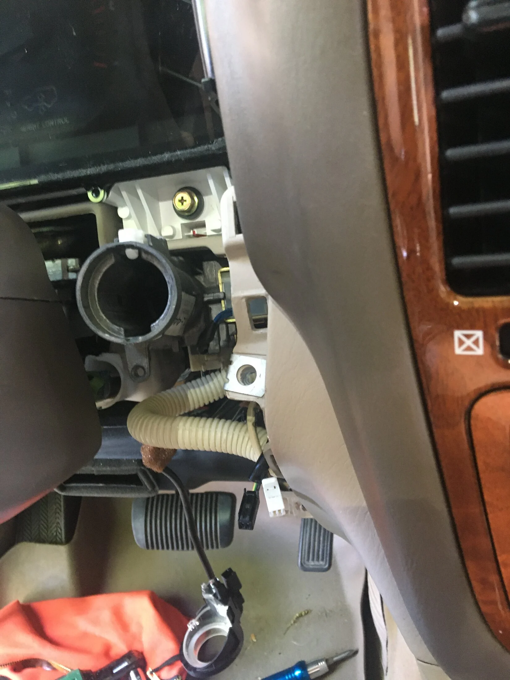

I had something similar on a 2001 LX. It’s likely the key cylinder rod (see pics). It’s a cast or potted part that gets lots of use starting vehicle. There is no OEM part for this and is sold as new cylinder for $200-400. You can replace this rod w aftermarket part from eBay for less than $30. Note the position of cylinder and rod as you remove as you will want to put back in same way. Fish out broken part of rod.
Here is a video for repair and brief description
Once you get the panel under steering open, you can remove key ring light. Feel or look under cylinder and there should be a white button you can press in w finger or screwdriver and the key cylinder should release and can be pulled out gripping the key.
