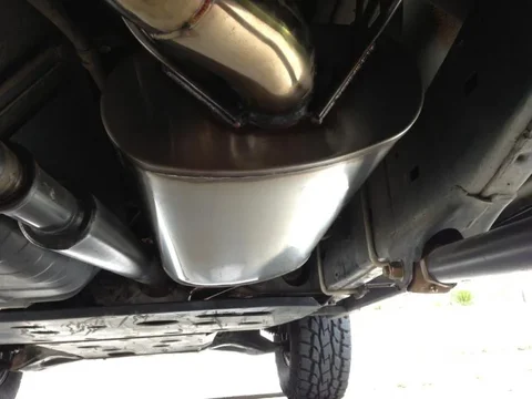

Recently installed my EMS Cat-back. Everything bolted up extremely easy and I think there's even more clearance from my Slee belly pan than there was with the stock exhaust.
