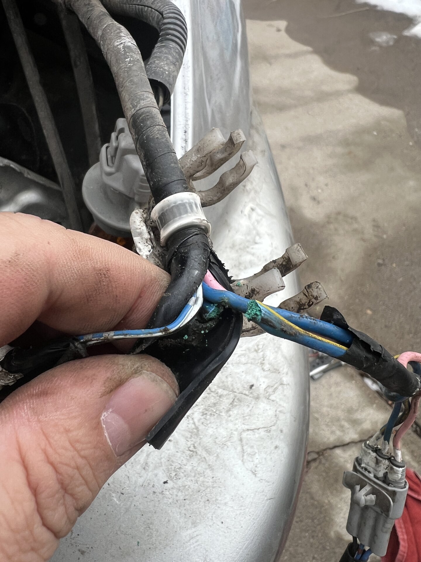

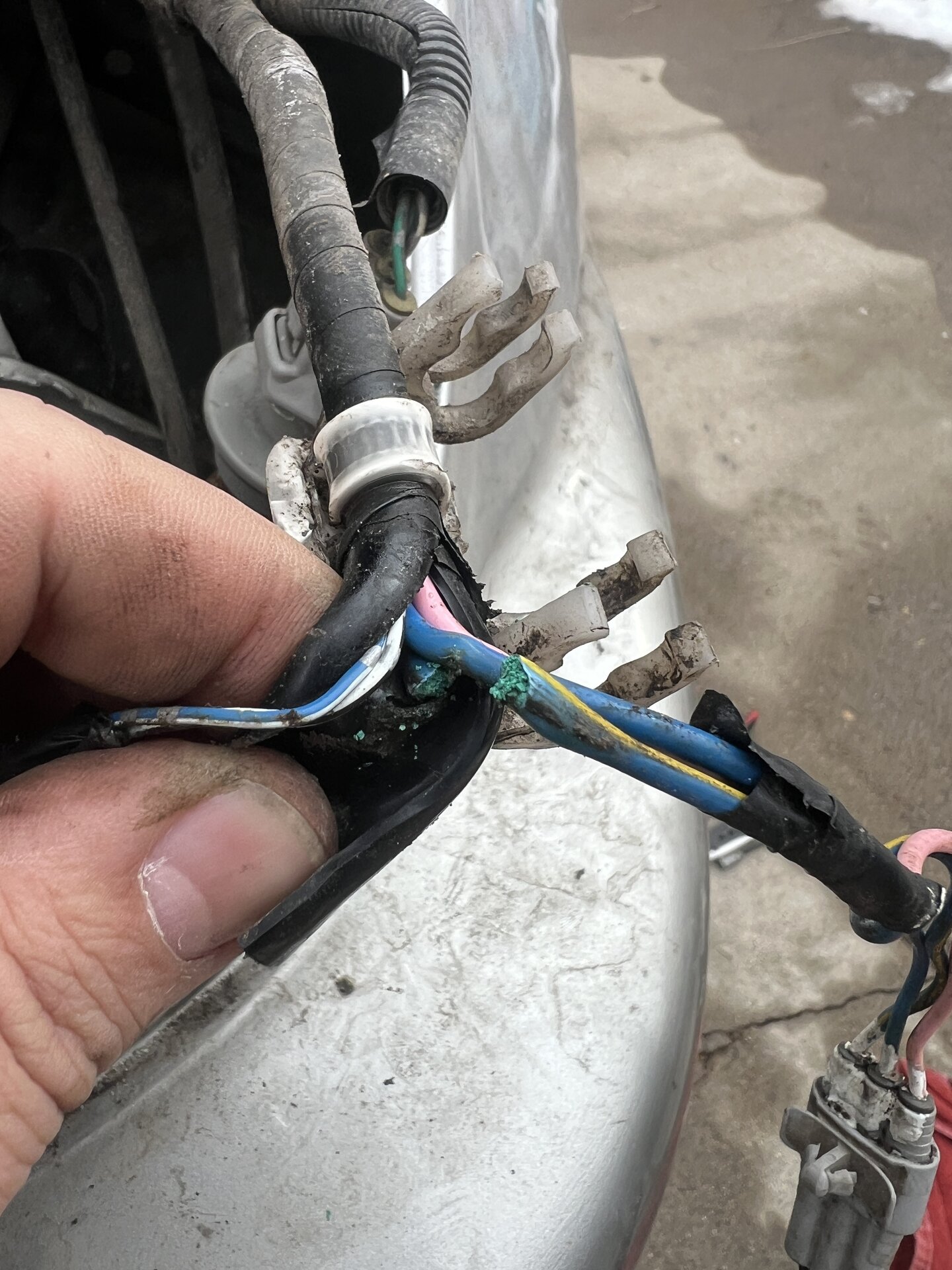

just an update to what the cause and fix was.
my truck was involved in a minor front end collision prior to my ownership. the ensuing damage destroyed the front left fender, bumper cover, L head lamp, and the washer fluid reservoir. I bought the truck with only the headlamps and fender replaced. I thoroughly inspected the wiring for the wiper and washer system with no signs of shorting or breakages in the circuit. with all that being said, the washer system was absent from the vehicle with the exposed electrical plug to the washer motor. Mind you, this issue only presented itself when it was raining in below freezing temps here in NC. This led me to believe that the surface tension of rain water on the washer motor plug was shorting pins to activate the washer system over and over again. I replaced the entirety of the washer system and restored my wiper washers successfully. After this repair I have never had the issue again and I am in the exact same conditions at the exact same time of year. The lesson to be had here is that these trucks have electrical components that are extra sensitive to water ingress and can contribute to some wild electrical gremlins. Inspect all electrical plugs and panels for failed weather seals or signs of corrosion. I drove with this issue for a year straight and have finally put it to rest. i hope this can help others who are having weird electrical issues
Update to my wiper issues. It was a “broken” wire about 10 inches into the harness. Looks like the wire cracked, and water/mag chloride got in and corroded it to the point of it turning into a green powder. All had been returned to normal.
Wow my truck developed this exact problem for the first time ever last night while driving on the highway in a bad snow storm. Interestingly my truck was hit in the driver fender/bumper last year and these were replaced but I have yet to reinstall the washer fluid reservoir and fender liner that are sitting in my shed.
I will get all this re installed and inspect wiring and report back if it resolves the issue! Thanks for posting, if I wouldn’t have found this I’d have been tearing into the wiper motor like other threads suggest.
Only dealt with it for about 2hr drive last night but honestly impressive just how annoying this problem is when it’s happening.
