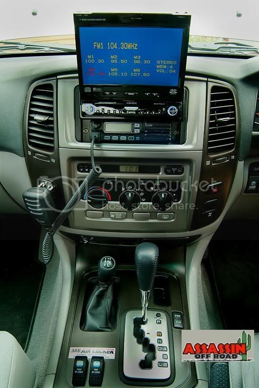

We have also installed a fold out screen/tv/dvd player/am-fm radio, with DIN UHF but yet to install the camera for reversing as yet, until it had the rear fitted, but the screen auto opens when you select reverse.
and open

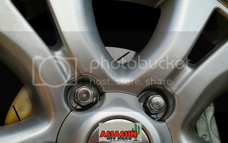

to this truck, to go with the 35' tyres, we have fitted slotted rotors all round, and Bendix titanium pads. We find these pads to work well round town, and cold, with minimum pedal effort, and they are gentle on the rotors. For constant heavy trucks we sometimes go to the Bendix Heavy Duty, but they do need some temp in them to be effective.
