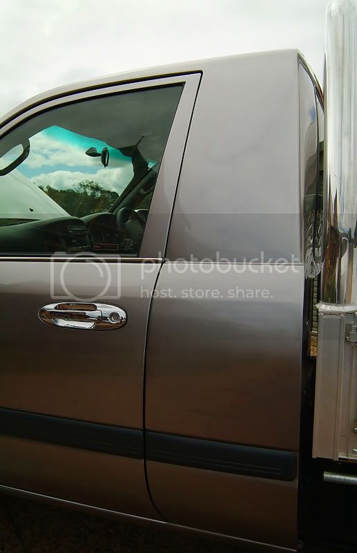

that's an awesome build! I really like the way you incorporated the rear hatch glass/hatch. Do you have a pic of the corner, not hidden by the chrome tube? curious how you resolved it there.

below is a pic as requested, of the area where the side joins the rear panel. The rear panel is pressed with the curve in it to join up, and square where the tray meets down.
And below is an interior shot of the way it finishes off, with carpet and trim

thanks for the pics, really nice bodywork and very clean. I like how well resolved and tidy the bodywork is! Those details seperate the amatuer from pro jobs

We used a profesional for the work required in that stage oof the build, and with the camper going on the back, should be able to do afew per year, is our hope.
